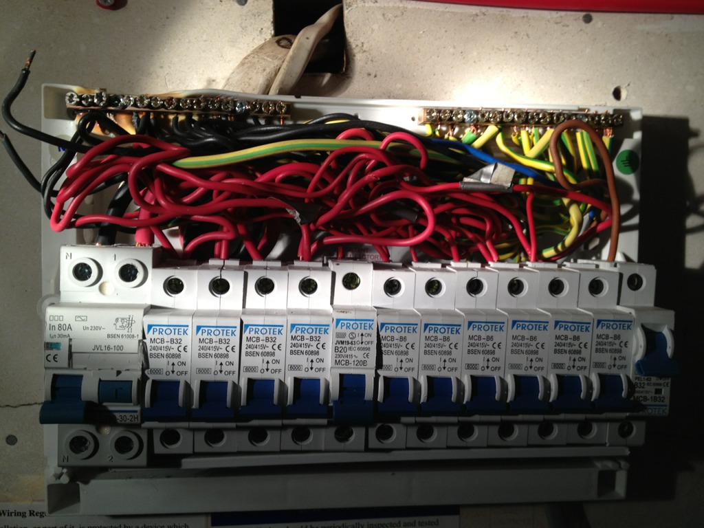

Called out to a job because the fuseboard they installed themselves started buzzing and glowing blue when the lights were off!!!
ImageUploadedByTapatalk1348844044.530750.jpgImageUploadedByTapatalk1348844062.281847.jpg
On inspection the neutral from the Rcd main switch wasn't done up in the bar and had burnt through. So no contact to the circuit neutrals.
Not bad for a 3 month old install!!
LOL
Three month old install but with old colours? That Protek rubbish would have probably set light to itself eventually anyway, lol.

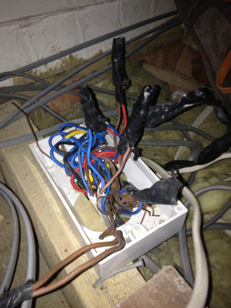

Been to a job today, Romanian sparks maintenance free JB. The whole extension and existing houses lighting not a single screwed terminal used other than at the fittings and switches and no earth cont anywhere lol.
Quality:)
