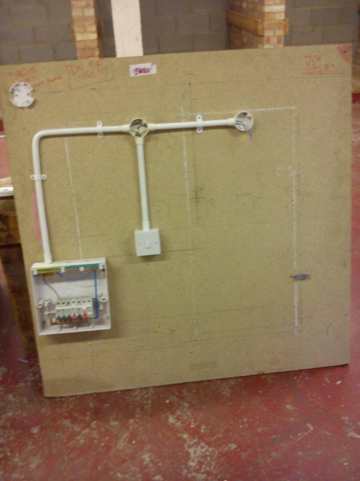

First ever set up
16 year old
First ever set up
16 year old
Great effort for a new starter aged 16 well done, almost perfect. Stick to the chalk line :wink: bit of a tip for you. Measure the distance from the CU to the bend, make the bend, cut off the few centimeters of the extra conduit and have the perfect length.
Nice work Millwall, keep the pics coming and I'm sure more little hints and tips will be posted up.
Not my chaulk lines its a old board only lines I did on the board was to get a plum line to get the CCU and light switch flush :) iv got some other feedback about the saddles to keep them less spaced out too and after a while hopefully improve my condriuit bends and doglegs
You will have to do a lot worse than that, you are showing me up as the bodger I am!:)
You can't go around making other electricians look bad.
Wish I could find a fault on it.:devilish:
Ahh well, I have to say a nice bit of work there mate, well done!
Thanks for all the comments everyone. :)

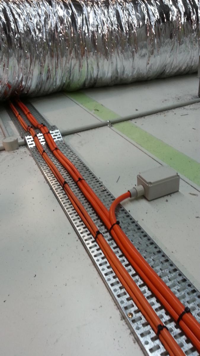

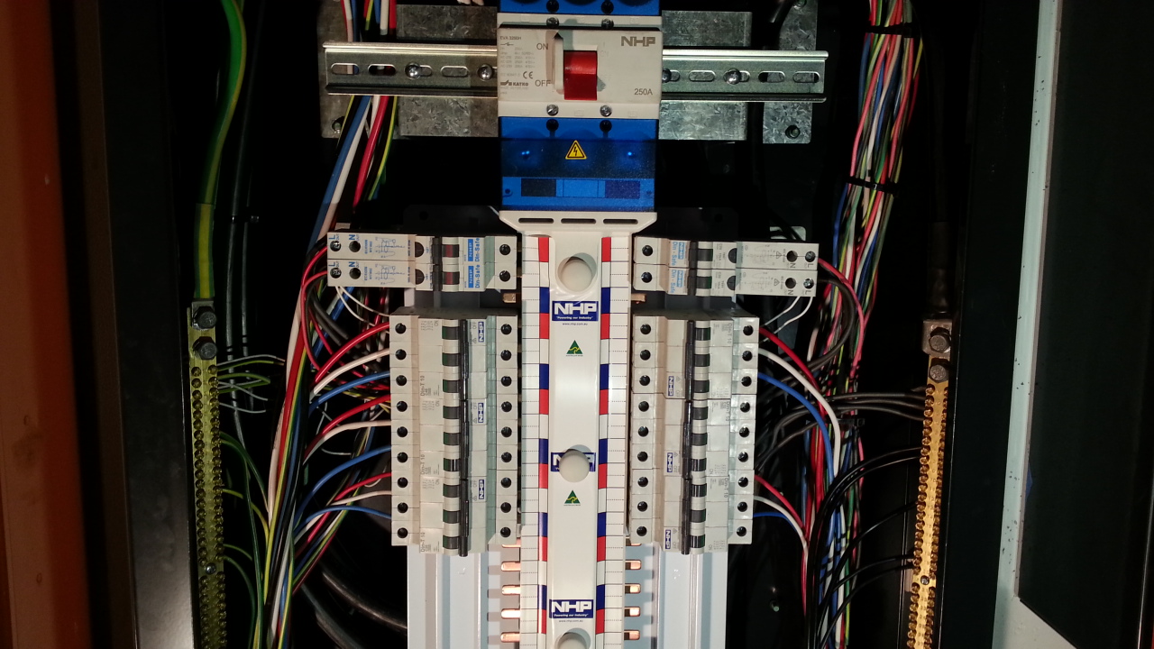

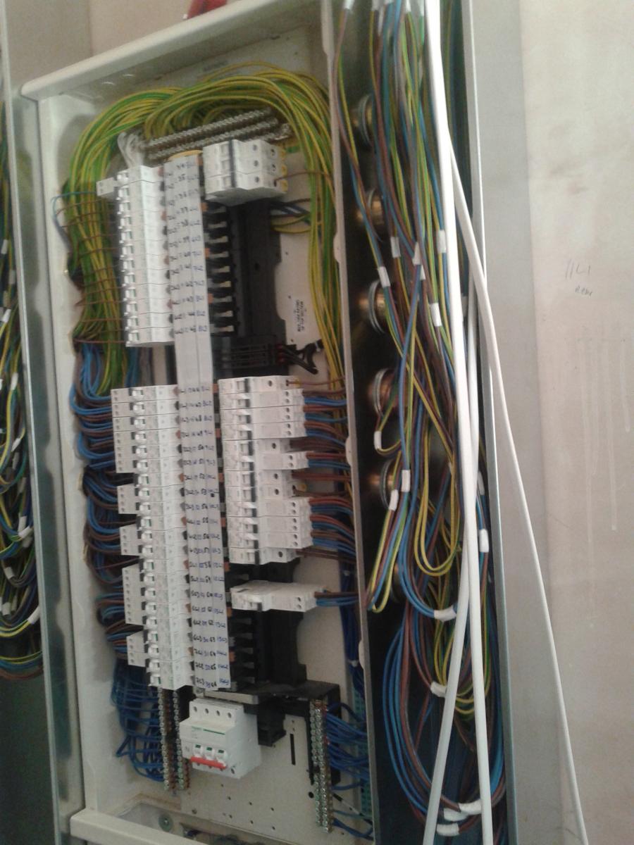

Seen as others have thrown there pics in i thought i would join in, this is a 3 phase board on a new build school there are 5 of these, done this from start to finish containment, cables pulled in, board and trunking mounted and terminated.
Thanks lads I enjoy this stuff a lot more then domestic dis boards haha I am starting the dead tests on this board tomorrow which will be fun

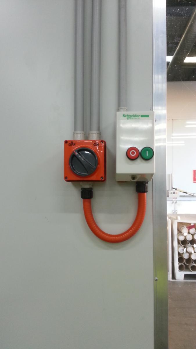

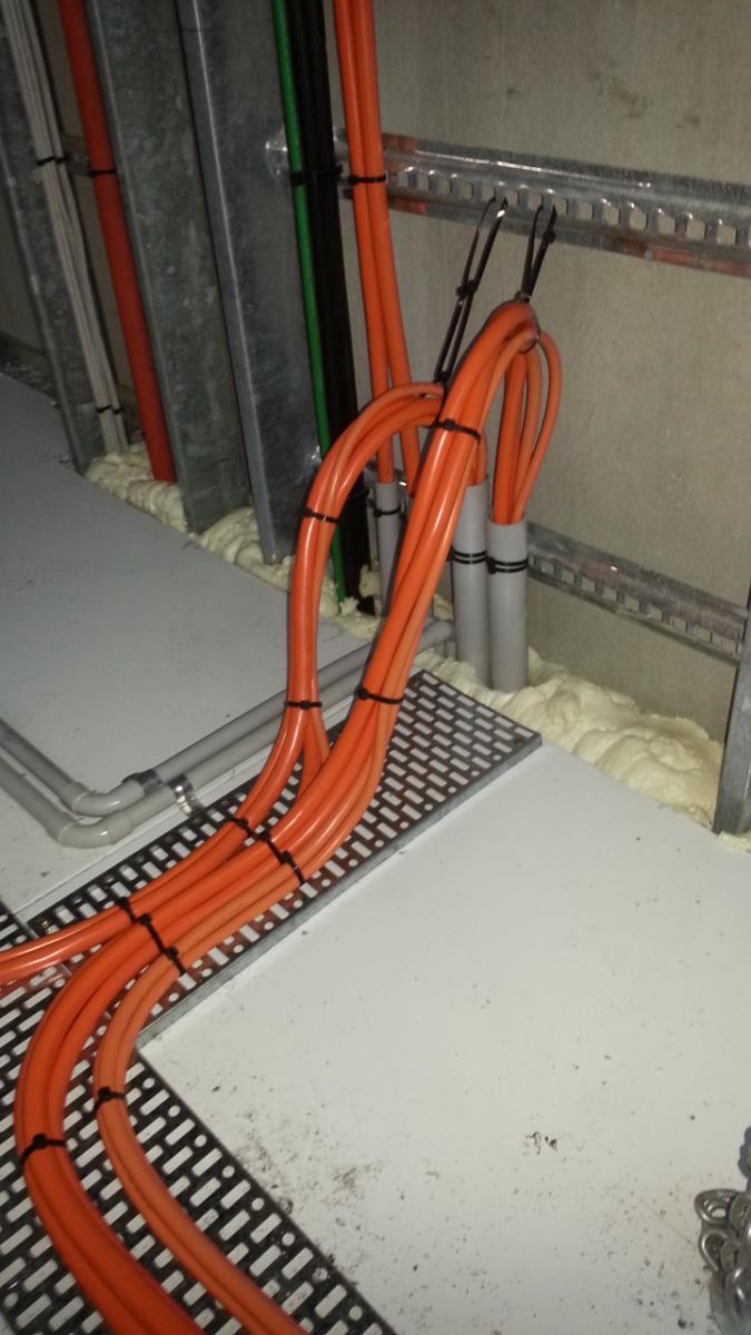

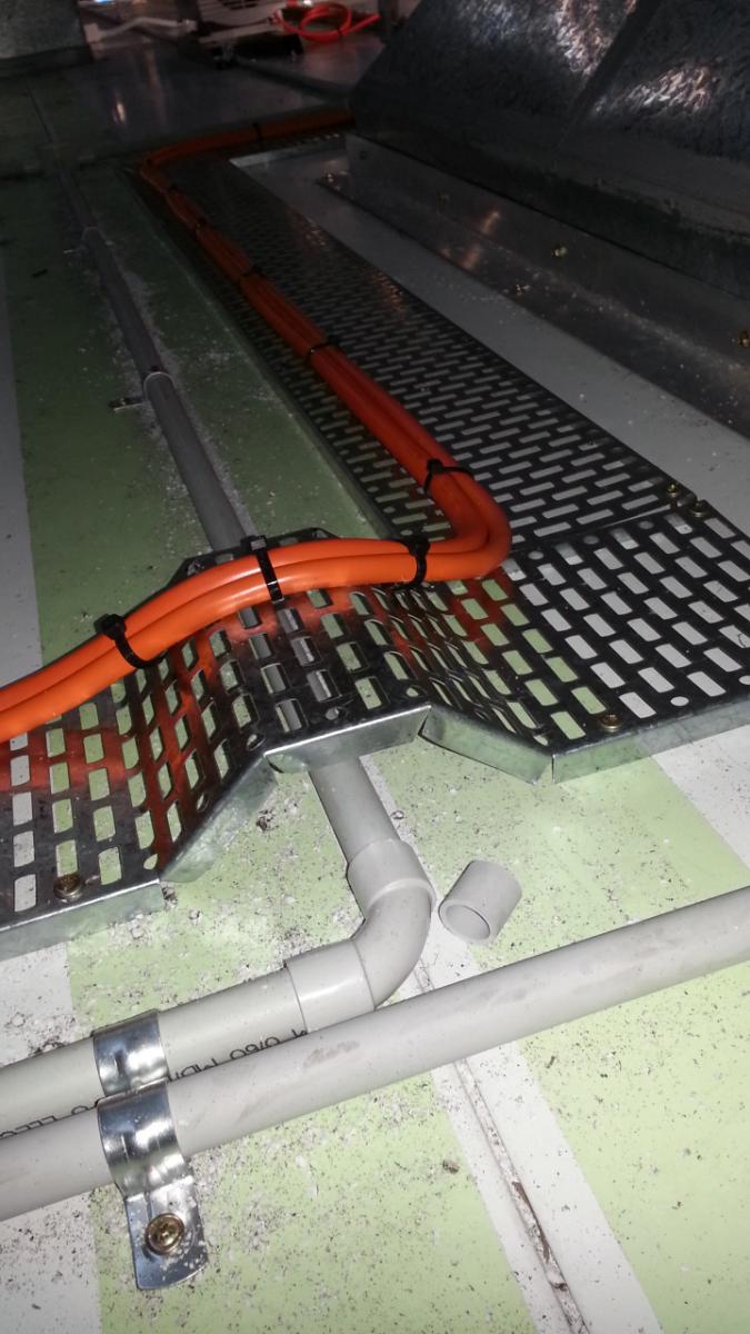

erm,,,,, this is not really my normal type of install, but I have to show it.
This is in a refugee camp in France. Some how got involved into building a school/classroom for the children. We took solar panels with us and a few lights, some how we end up with this.
1st pic is 6mm DC cable from the solar panels to the Iso then to the inverter/battery location. 2nd pic is the solar sparky throwing loads of cables together in the dark in the hope that it will work lol :rofl: We got it going, just!
I've posted this up because I want to drive into any Trainee reading this.... STANDARDS.
The above is a refugee camp, there are no standards, there are no laws/rules/regulations! Basically we could do the install any bloody way we liked regardless of anyone!!! BUT.... We are Electricians and we do the job correctly and with the skills we have gain via tuition.
Would you be happy with that cable clipping in your home? I would and this is a site with no laws,,,, but we have standards regardless of the location...... Just food for thought lads.

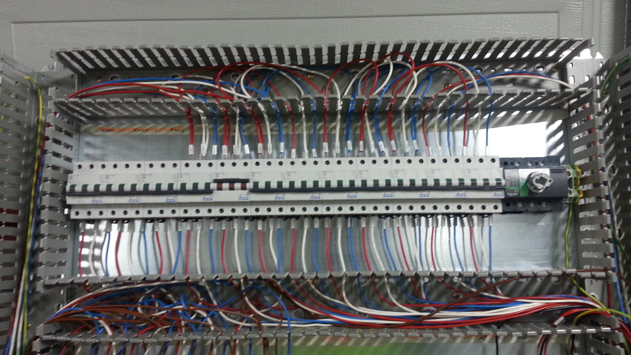

Sorry did try to rotate but phone isn't listening, not my choice of board would of preferred a single row of breakers

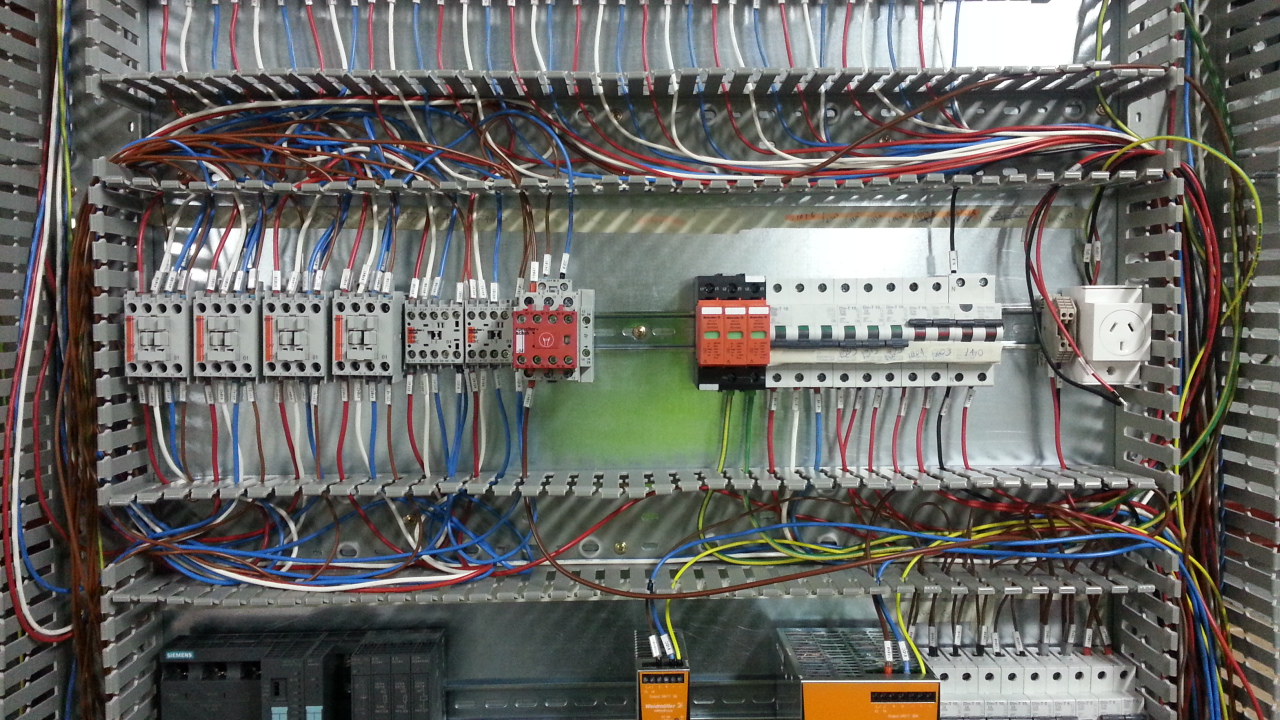

Been a while with no new posts, time to add one I think.

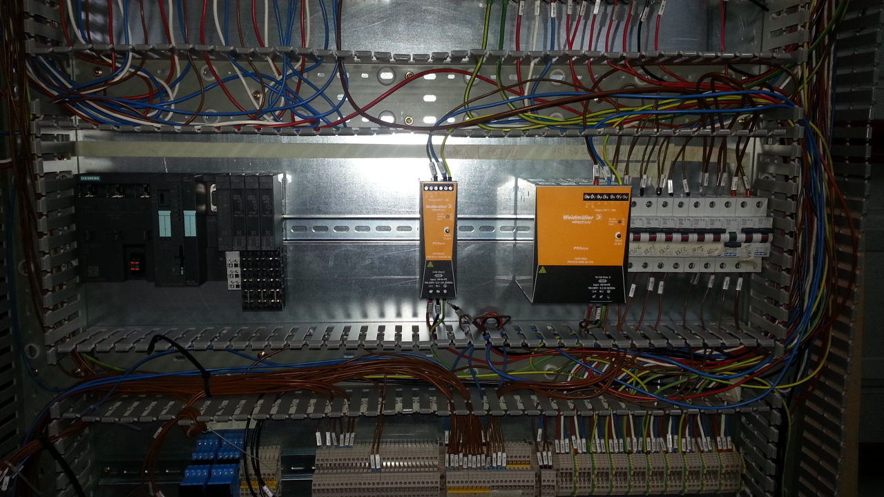

Just wrapping up this panel now, exhaust setup for the carpark of a block of flats. Master had me design and layout from scope of works, once the building is ready I'll be top man on site for the install, looking forward to it.

Basic operation is controlling speed of an exhaust fan based on CO levels in the carpark. Also controls a vent fan in the garbage skip storage room, with external fire alarm trigger to change fan behaviour. I'll track down and post my controls schematic, that may help.
Super cool, ElectroChem! :)
How long did that take you to design and build?!
Inspiring stuff... cheers for posting! :)
Design about 3 hours, plus a bit going over options with the boss. Building the panel about 20 hours. Apologies for the rough drawing, this was my modified-as-I-go working notes.

Was going to comment on several points ElectricoChem then noticed your Sydney based thus I have no clue what regulations you follow for panel building (I only comment if it's destined for the EU market ;) ),
Although I must say you need to work on your Schematic - I can't make it out, it's illegible :oops:
If I was going to give any constructive advice then I would say this panel wouldn't be legal as there is no cable marking, thus compliant schematics cannot be drafted and as far as I'm aware there are similar 'universal' regulations that all countries tend to follow and I would say your panel is in breach of a number of them. I'm not saying it won't work, most of my comments would be cosmetic issues.
What does worry me is the task the panel is undertaking, as it is undertaking 2 safety critical jobs and I assume is interlinked with the F/A system then I cannot see how as a design you could comply (even without knowing your regulations), this in anyway is no pop at yourself, but do question the company you are under instruction from and been taught by.
As the panel goes and your Trainee status, I can admit it looks alot better than my first attempts back in the day ;)
I seem to recall a similar conversation the last time I posted a panel. I do actually have a colour scheme for this one:
Red/White/Blue/Black - 415V 3P+N
Purple/Grey - +24VDV/0V (earthed)
Orange - VSD I/O wiring
White/Black - analog wiring from CO controller to terminals (shielded 2 pair cable inside the ducting)
I'll tidy up the schematic then we have a guy to properly draft it in CAD for delivery to the client.

I added to my post if you want a re-read it, I cannot comment on colour coding as ours differs so much:-
-Blue - DC control
-Red - AC control
-Black - Power cables
-Orange - Cable that usually have external power source or ones that are tapped of the incoming side of main switch meaning they are not isolated with the switch (Cab lighting as an example)
We do not use phase colours within the panel exept for the actual power supply itself.
-We would have to segragate the low voltage terminals and the control terminals and not be next to each other.
-I assume the VSD motor cable are connected direct to the drive not through any connectors, usually you would use DIN connectors for all external cables and the drive output cables would be integrally screened, a screening clamp would also be waiting for the motor cable to terminate.
-The cable I'D (numbering) is missing as already mentioned.
There are a few more but I'm only comparing with our reg's here and in part I know some will be different but in other areas it's clear you must be breaching local regulation.
My biggest concern here is these fans are acting as a safety system or react to safety critical systems but I see no allowance for that in design, I see no redundancy in design if the function of these fans is to exhaust the build up of gasses or to limit the effects of a fire by use of the extract system. - like I said before, its no critisism to yourself as you are under instruction here but such a control system would need to be carefully designed with the input of regional fire service and building control if it was over here, in the event of a fire it may often be the case that the drive goes into a burn out mode and will ignore all overloads etc to ensure the fan operates until destruction (Omron model you have doesn't have such options if I recall).
Example - your garbage fan is switched off on the panel, the fire alarm indicates a fire in the garbage area, the Fire panel should then relay a signal to your panel to over-ride any normal status and bring the fan on to do what has been spec'd by the local safety authorities... as it stands it seems your are building a stand alone system that would just get a preset speed command if the fire panel sent a signal, this could only work if the selector switch was in the correct position.
Apologies for the listings here but building various panels for decades means I pick up on these things at a glance and hope you take them in the constructive context they are meant :).
What it comes down to is, if your boss is happy then your --- is covered but just have a seed in the back of your mind about the points I make, maybe further down the line you can start bringing up these issues and score some brownie points.
Oh I certainly do, please don't worry on that score. You raise good points and some of them did come up in the design process. There are no set regs for colour coding of panel wiring here, it's often left up to us or the client may have a site spec. One common one I see is orange/grey for 24V with blue/white for PLC I/O and red/black for 240V.
Would have liked to properly label wires, but no room in the quote. If the panel were destined for one of our industrial clients then absolutely would be.
Good point on the terminals, I may well pop a divider in between the garbage fan and control terminals just to be safe. The outgoing motor cable will indeed go straight to the drive, I've seen braid clamps and personally like them but they seem much less common here than on Euro gear.
On the safety system side, the panel has to respond to the alarm but is not itself part of the fire system. I've integrated a fire alarm healthy relay that is held on by an external contact (or I'll rewire if the health signal is a voltage). If this is lost it will cut the garbage fan and lock the exhaust on bypassing the panel switch. The inverter does have an override signal, Omron doesn't make it obvious in the manual as it voids warranty.
Thanks for the feedback, as you've noted the same principles of good design apply whatever the specific laws concerned.
