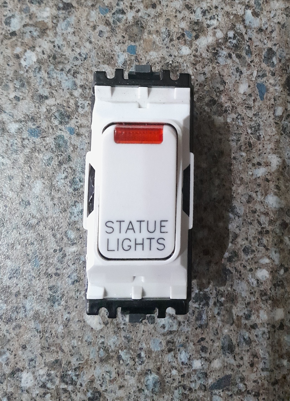

I engrave stuff a lot, this is in my hallway. To make this more discreet I could have filled it with white wax, the white wax colour is different enough that you can read it up close but from across the room it looks unmarked.
That looks good, I spoke with Hager to see if they did custom labels, but unfortunately not. They recommended some key cutters do engraving. I'm gonna try that. Where did you get your engraver, how much did it cost, can you do switches instead ?

The engraving machine is just a cheapsih 3040 type Chinese CNC mill similar to this one. The largest cost is the licences for the CAD software and the MACH software to run the machine.
I've never tried to engrave the switch rockers themselves I might give it a go. Most manufacturers screen print the markings for their switches. Years ago we had Crabtree mark a load of switches for use in a housing development. I've no idea what the cost or minimum order was though.

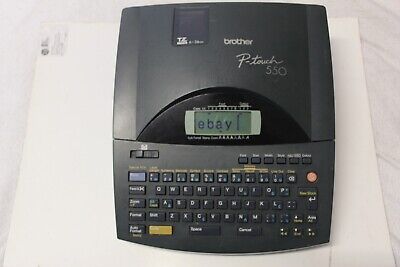

Makes my Dymo look very inadequate

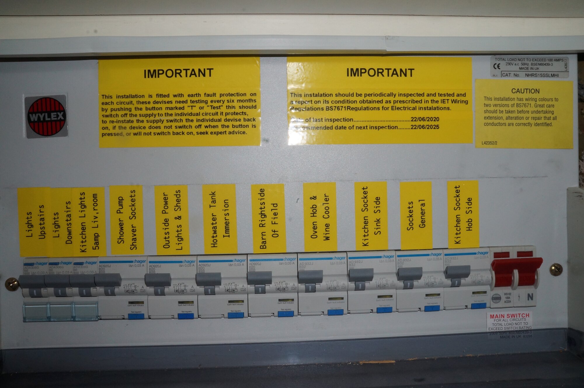

It even make my Brother PT550 look a bit sad, but I am happy with it, better than a Sharpie by a long way, reminds me must make a sticker to go over the Wylex Logo. 🤣DSC01993.jpeg

Doesn't instil much confidence have you printed a lot of those labels ?
It even make my Brother PT550 look a bit sad, but I am happy with it, better than a Sharpie by a long way, reminds me must make a sticker to go over the Wylex Logo. 🤣View attachment 98840
Something that's intriguing me
Kitchen socket sink side 32 amp
Kitchen socket hob side 32 amp
3 ring finals ?
4mm radials ?
pt550 doesn't like printing "sockets"
If you had one of those in the 90s you would be the bees knees :)
