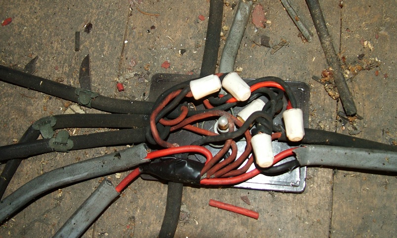

Had a feeling that was the case from the setup in the picture and the description of the property. How 'north' is north? East or West? I've had to contend with a few similar properties. I presume this isn't a crofters house - they wouldn't willingly pay for smoke detectors :) and crofting properties are rarely of concrete construction. Somebody mentioned earlier that the smokes were on the heating board, is it a THTC board?
Ha Ha! - It's on the Western Isles, mate. It's not a crofter's house as such, just built in that 'style' in one of the small townships that abound. The man of the house passed away quite a while ago and I think his wife ordered or was persuaded to upgrade the smoke detection and heating. It all seems reasonably sound, but I'll find out more next week. The smoke detectors are on the same circuiyt as water boost and a couple of other things (can't recall of the top of my head), but aren't on the same circuit as storage heating. The ring, radial and lighting are in a mess though. It isn't the lil (little old lady) ordering the work though, it's her son I've been dealing with. Fairly sharp bloke, except when it comes to wiring a plug.

The pics not great, but the board does look like a THTC setup, if so they have potentially taken the smokes off the perm live feed, which isn't allowed under Hyrdo/SSE rules. If things are that messy, it sounds like a rewire is the order of the day. Good job for you :)
I would definitely suggest a rewire. If you are saying these sockets are wired as a radial then the protectice device cannot be rated at more than 20A.
If the sockets and lights are missing earths this must be sorted to meet the standards of current regulations. BS7671. If it is a conduit system then the conduit could be used as a means of earthing. That way a seperate c.p.c is not required.
My advice would be to rewire the radial circuits and create a ring circuit instead. Definitely check out the JBs as you often find all kinds of things in there!

Thank You, Dave. My intention is to totally replace D/L Lighting, U/L Lighting, Upstairs Ring (lounge, Bedroom, Hall), downstairs ring (Bedroom, Kitchen, downstairs hall), Cooker, (new) Shower on separate radials. Main Bonding needs to be upgraded too - the existing cable is painted, plastered into the wall in the bathroom. C/U unit will (obviously) be replaced. My only question is whether I have the small Kitchen d/w and washing machine on the same ring as the bedroom and kitchen sockets (6 doubles in total - which COULD mean, at worst, microwave, kettle, d/w w/m and a telly in the bedroom being on at the same time) or to put the w/m and d/w on a separate one... I'll look at the diversity calcs and have a good think about this - there will certainly be plenty of space on the board for me to split them out if I want/need to.
