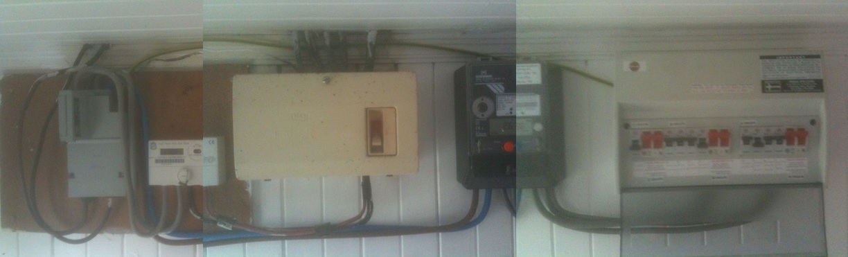

Hello again everyone - I've been asked to assess a small old house pending the possible (ok, probable) replacement of the old CCU.
I've attached a composite picture of the two boards currently in place at the site. The new Wylex to the right was installed about 8 years ago and has circuits for Heating (Dimplex storage heaters), smoke alarms and heat alarms and so on.
The older CCU is a MEM (I think) with 6 ways, 2 5A (only one used) and 4 15A (only 2 used). No RCD or ELCB. It has an (I think) 6mm-ish unsheahed earth conductor and twin neutral and live tails coming into the unit from the meter.
I've climbed up into the draughty old loft and traced all the cables and have confirmed there is a single lighting circuit and three radial circuits to socket outlets in three different rooms.
The wiring is sponsored by luck it seems - The lighting circuit and two of the radial circuits are all routed through "custom made" JB's smothered in insulating tape. None of the lighting circuits have earth conductors, 1 of the radial circuits has an earth connection at one outlet, but not at another. 1 of the others has an earth connection, the other does not. In short, it's a mess.
My question is - How do I go about testing this installation (or do I even NEED to - should I just recommend the client gets an isolating switch/meter fitted and get the house rewired asap?).

I'll try and post the photo again - You'll just about see the unsheathed earth conductor to the old box behind the one to the new wylex.
In regard to testing - my question is what exactly I CAN test and record?
Ze, PFC, Continuity (between line conductors) and Insulation Resistance (live only, mostly), Polarity... - sure, I can get these. I can get and R1+R2 value from one of the radial circuits, but not from the lighting circuit.
I guess I'm being put off by the lack of obvious consistent earthing in the installation.... but now that I've listed what I CAN do (!), I guess there's quite a bit ...
Are the posters basically saying ... 'Look, test, record the results and basically use it as pretty clear evidence to suggest a rewire'?

Always test before a cu change, i'm in the middle of an eicr at my mrs' old mans place and its a nightmare, the house is huge, lighting partly earthed by other circuits, class 1 brass fittings/switches everywhere, borrowed neutrals on 3 circuits. He said yesterday " how long do you think it will take to sort as i only wanted a new fusebox" , the place needs rewiring in my view but i don't think he'll go for that, it would have looked very bad if i'd quoted to change the cu's and then found all this after,bloody house stinks of dog **** too :(
good luck with that one. relatives always expect it for nowt or a few quid beer money.
Test everything, make a note of every fault or issue.
then give them 2 quotes, if you are realistic with your prices for the remedial work, you'll find the rewire comes cheaper, with the benefit of extra sockets and switches.
as said before your certificates will back up any quotes
Thanks everyone - I'm taking my Kewtech for a run out on the house next Monday. one strange,curious thing I found is that the walls are cast concrete, then external walls there is galvanised steel floor to ceiling, then wood cladding (tongue and groove). internal walls are plastered. my spidey senses are worried about the largely inaccessible steel walls though in terms of earthing/bonding ......
