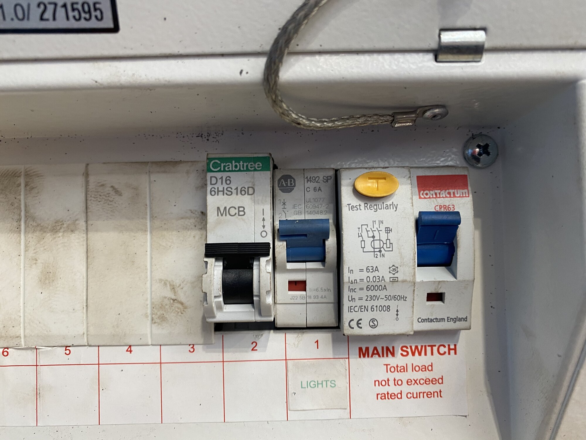

TV distribution in a block of flats. The green and yellow wire was left by the aerial installer for us to connect to the main earth terminal.

I wondered where all the driver bits were disappearing to!!!
  • Funny
Reactions: 1 person
Could have waited till the last digit was zero.
Reactions: DPG
Agreed.

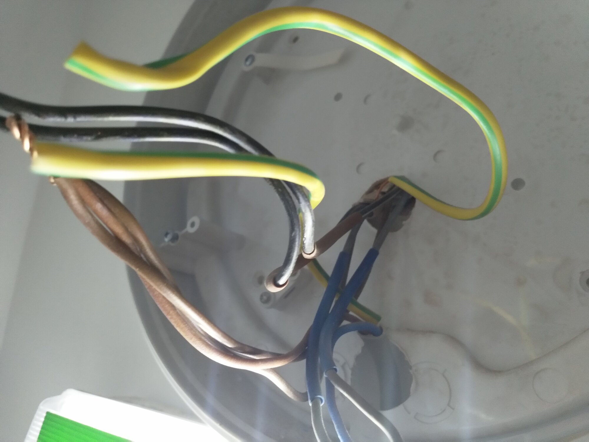

There's a good reason why you should avoid working LIVE! :D
that's horrific everything out the window there in terms of safety. whoever fitted that was probably dead proud of working out the loop in/out part, either that or trial and error at work
  • Agree
Reactions: Baddegg
So close though! Looks like a twin red for the switch wire so that flylead one hole over and everyone would have been happy, even his wife! But - because he got it wrong, he gets no cocoa!
Reactions: johnduffell and DPG

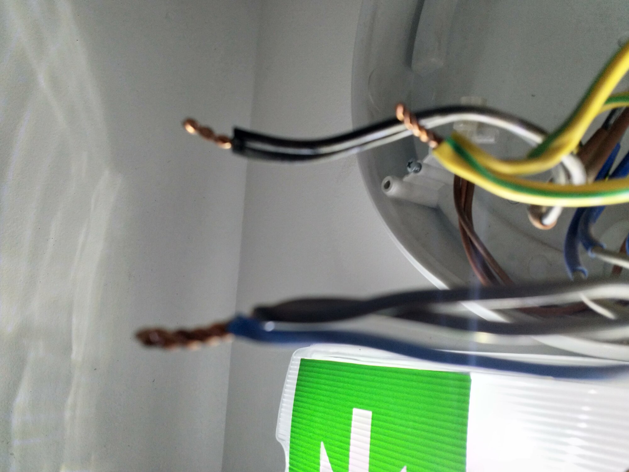

Another reason to isolate the lighting circuit before working on any light fittings!
I spent ages looking at that thinking "Why??? What's wrong with it???" I've just looked again and seen it.
OMG!!!
  • Funny
Reactions: DPG

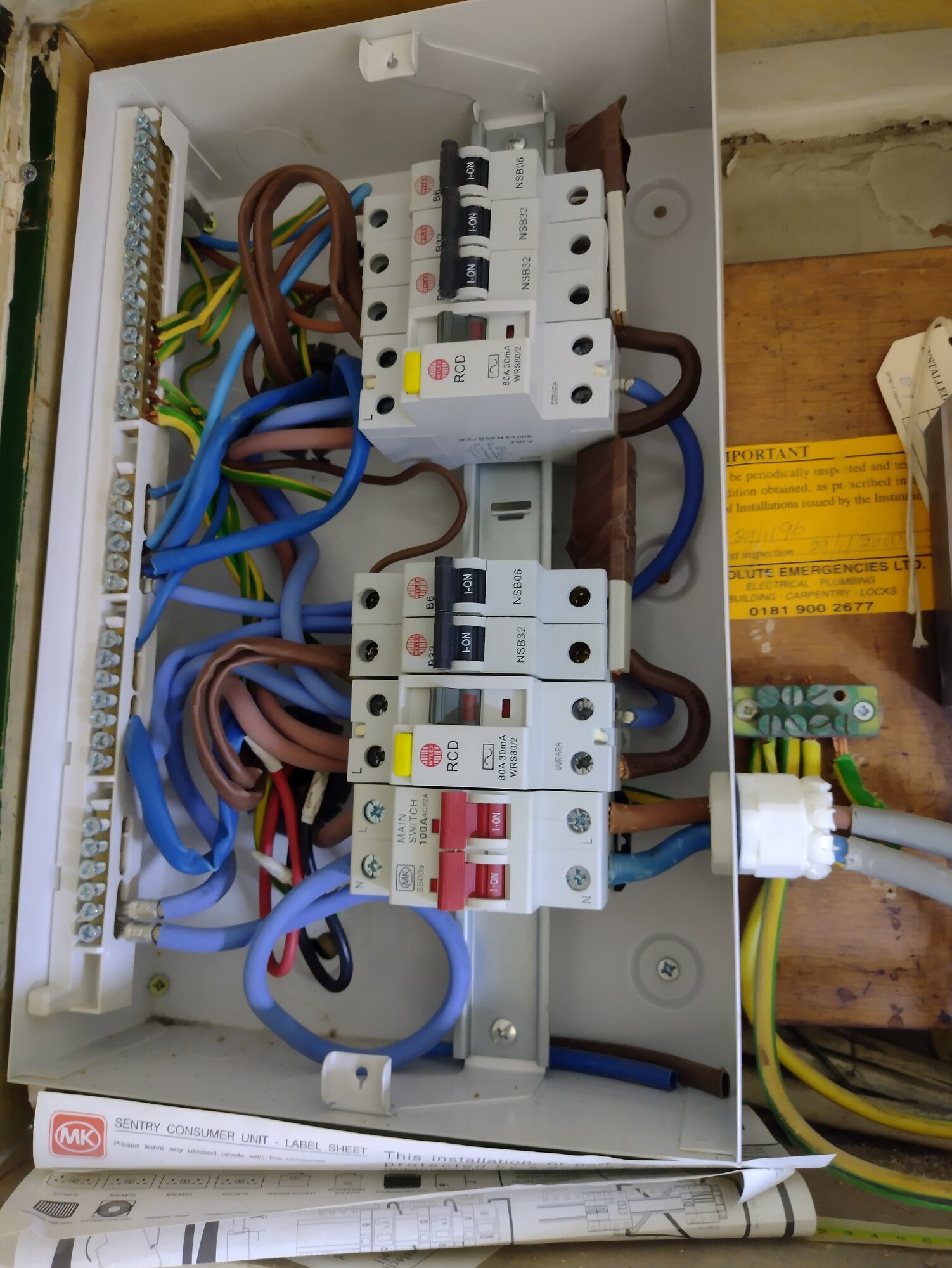

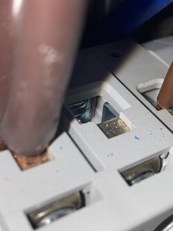

So got called out today... cooker circuit tripping the RCD. Turns out, it's cooker, sockets and extractor hood on a 16A breaker, with washing machine on one, gas hob, electric oven.
Get's it down to a L-E short on the cable from the CU to the SFCU that has the hob and oven connected to it, yes... both of them on one. Turns out there are two sets of cables in the conduit, great I think, pull some slack through and use the other L... except that has a L-E short as well. Ok, use the neutral and sleeve it... Couldn't get any movement on it and it's snipped off close to the wall at the far end... nightmare.
But check out this quality work...
Lovely bit of arson there from a gas fitter.
The conclusion I've drawn is (because apparently the RCD tripping has been going on for a while getting more and more frequent) is that some plum has hammered/damaged the conduit and consequently the cables and it's finally given up. Would have been grand if I could have pulled the slack through, but as it is got to run a new cable and make it safe. What a bloody lash up.
F%^& where the timber is! Luxna say it should be 75mm from timber, not in it!
And that's 'allegedly' a MF JB in the back ground
