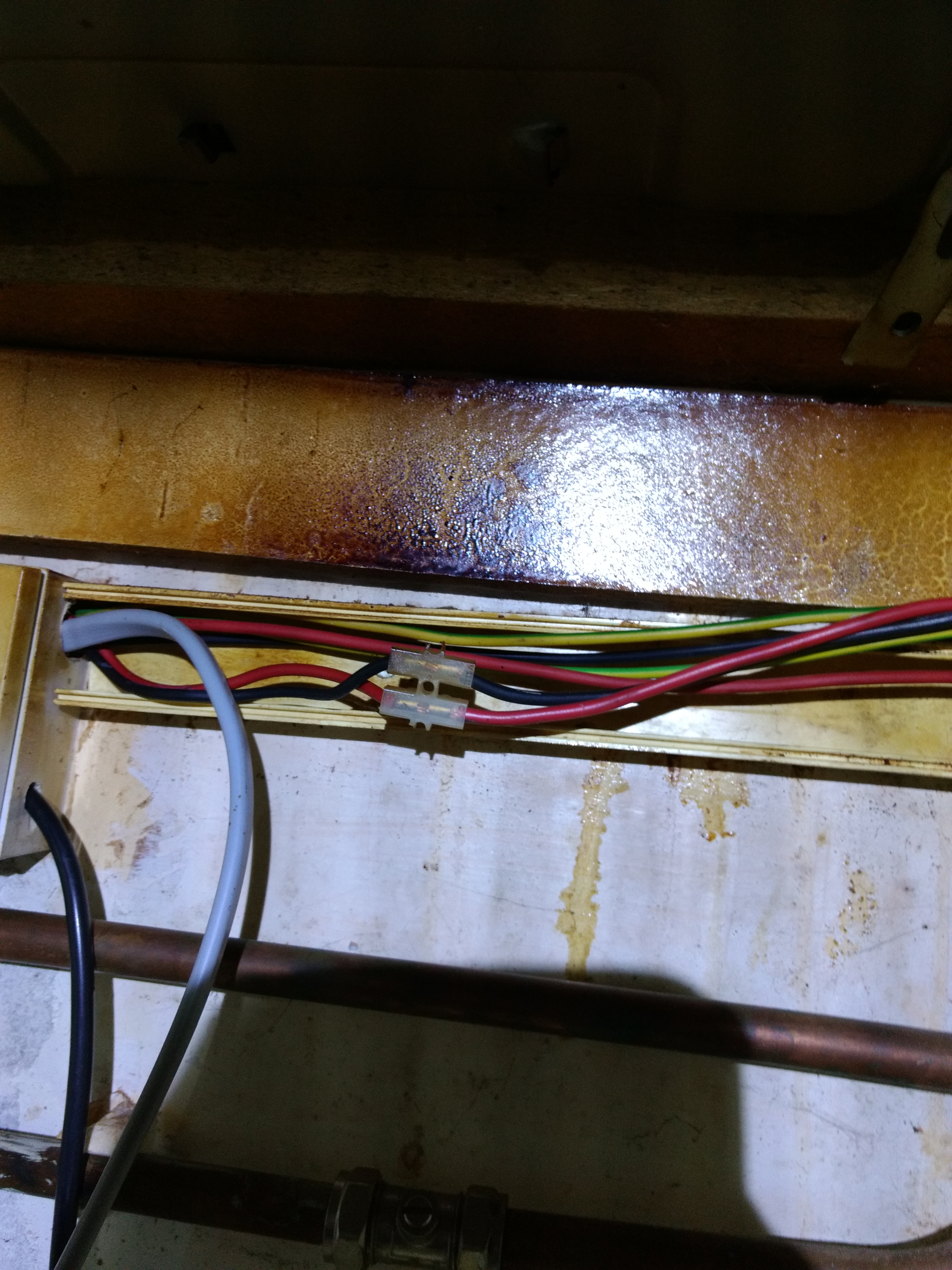

top pic next to the attempted arson. are those blacks charred? if so looks like the wet-pants is the culprit.
Reactions: GBDamo
Yes, they are nice and crispy and actually have a lovely stylish moulding in the insulation where they've sat on the pipe whilst it/they were still hot :)

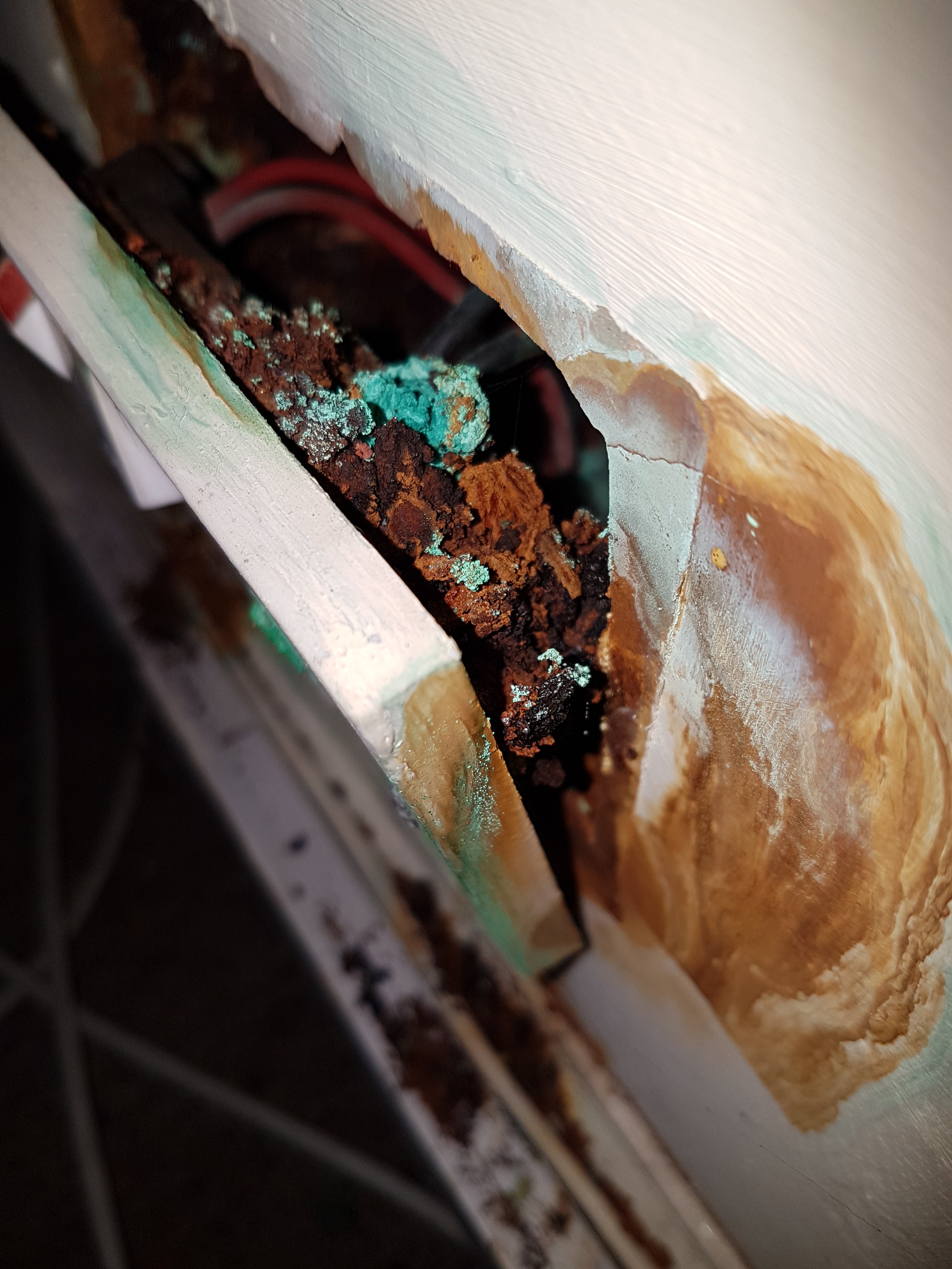

Slight corrosion to a socket back box. Cpcs are totally gone and only the lines are still connected and yes it is live.
That's bad damp that.
The back box is all but gone. Wagoed the conductors which were still there and a couple of layers of heat shrink.

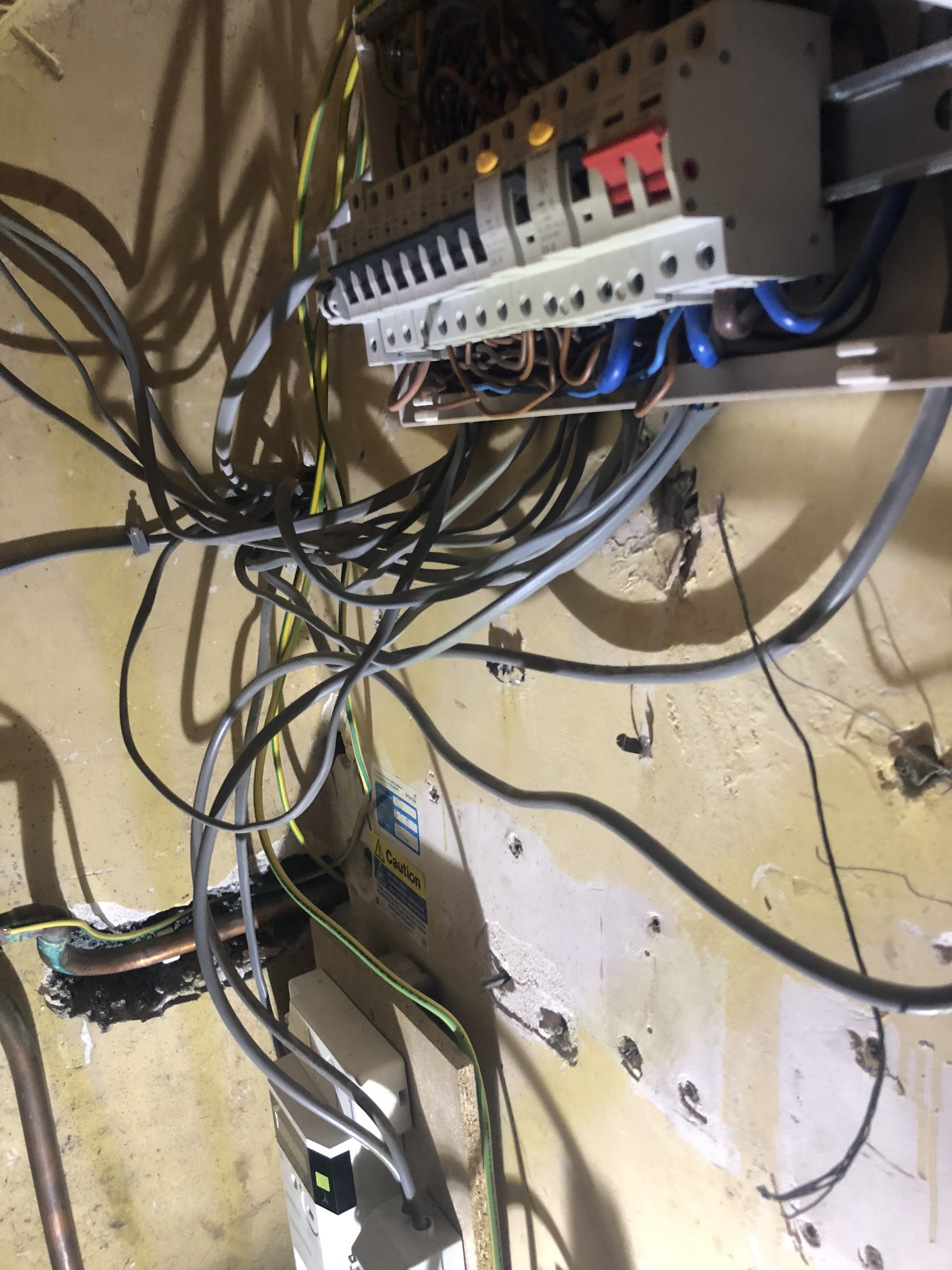

So got called out today... cooker circuit tripping the RCD. Turns out, it's cooker, sockets and extractor hood on a 16A breaker, with washing machine on one, gas hob, electric oven.
Get's it down to a L-E short on the cable from the CU to the SFCU that has the hob and oven connected to it, yes... both of them on one. Turns out there are two sets of cables in the conduit, great I think, pull some slack through and use the other L... except that has a L-E short as well. Ok, use the neutral and sleeve it... Couldn't get any movement on it and it's snipped off close to the wall at the far end... nightmare.
But check out this quality work...
Lovely bit of arson there from a gas fitter.
The conclusion I've drawn is (because apparently the RCD tripping has been going on for a while getting more and more frequent) is that some plum has hammered/damaged the conduit and consequently the cables and it's finally given up. Would have been grand if I could have pulled the slack through, but as it is got to run a new cable and make it safe. What a bloody lash up.

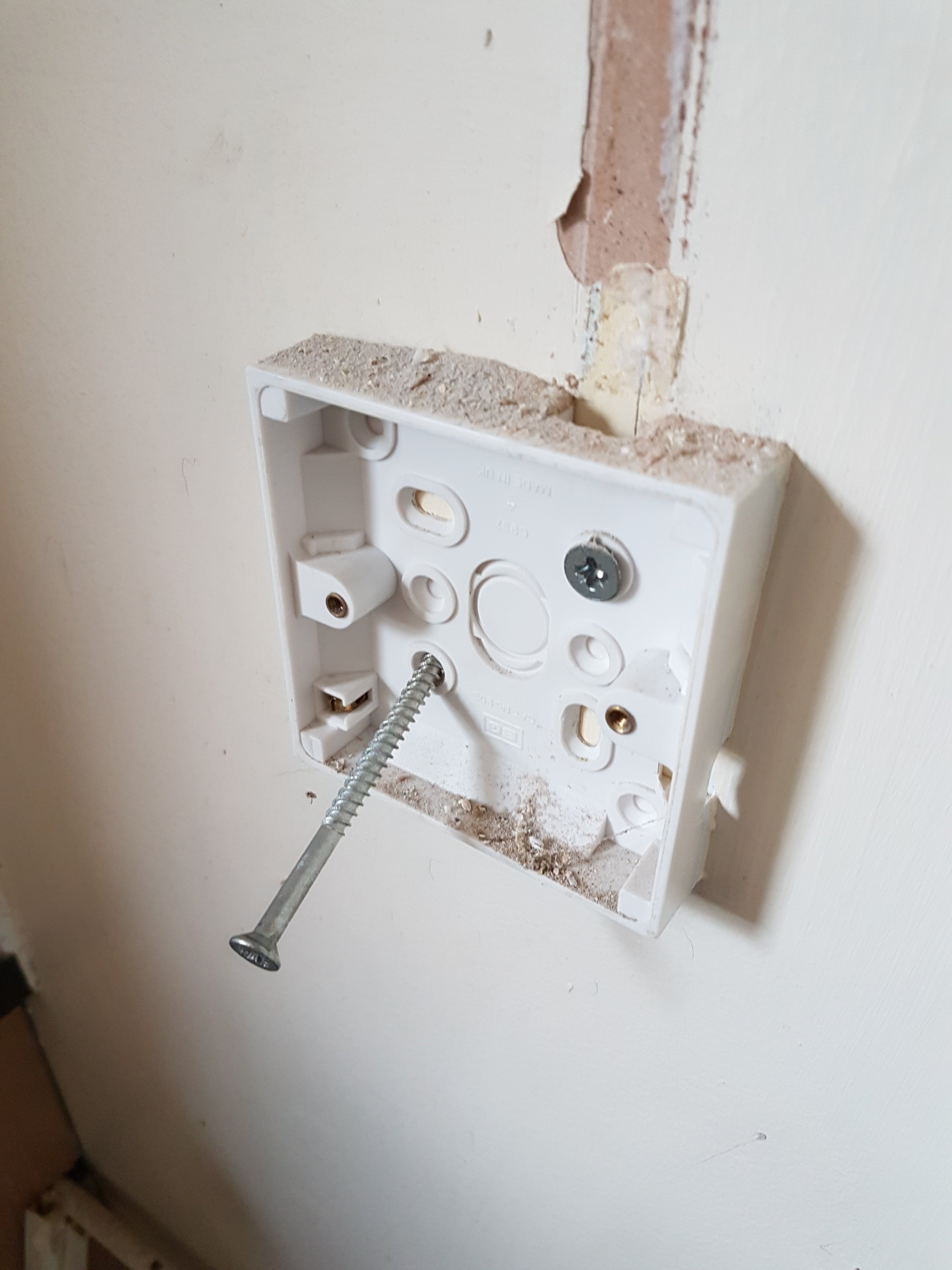

Is that going to take a triple gang line in and out intermediate dimmer switch?
Deleted. Too many beers. Dry January has just been subject to a monsoon :confused:
2'' 12s yep that should fix
That's no good i use 10 inch bolts right through to the other side of the wall
Does mean you can see where the sockets are from outside the house

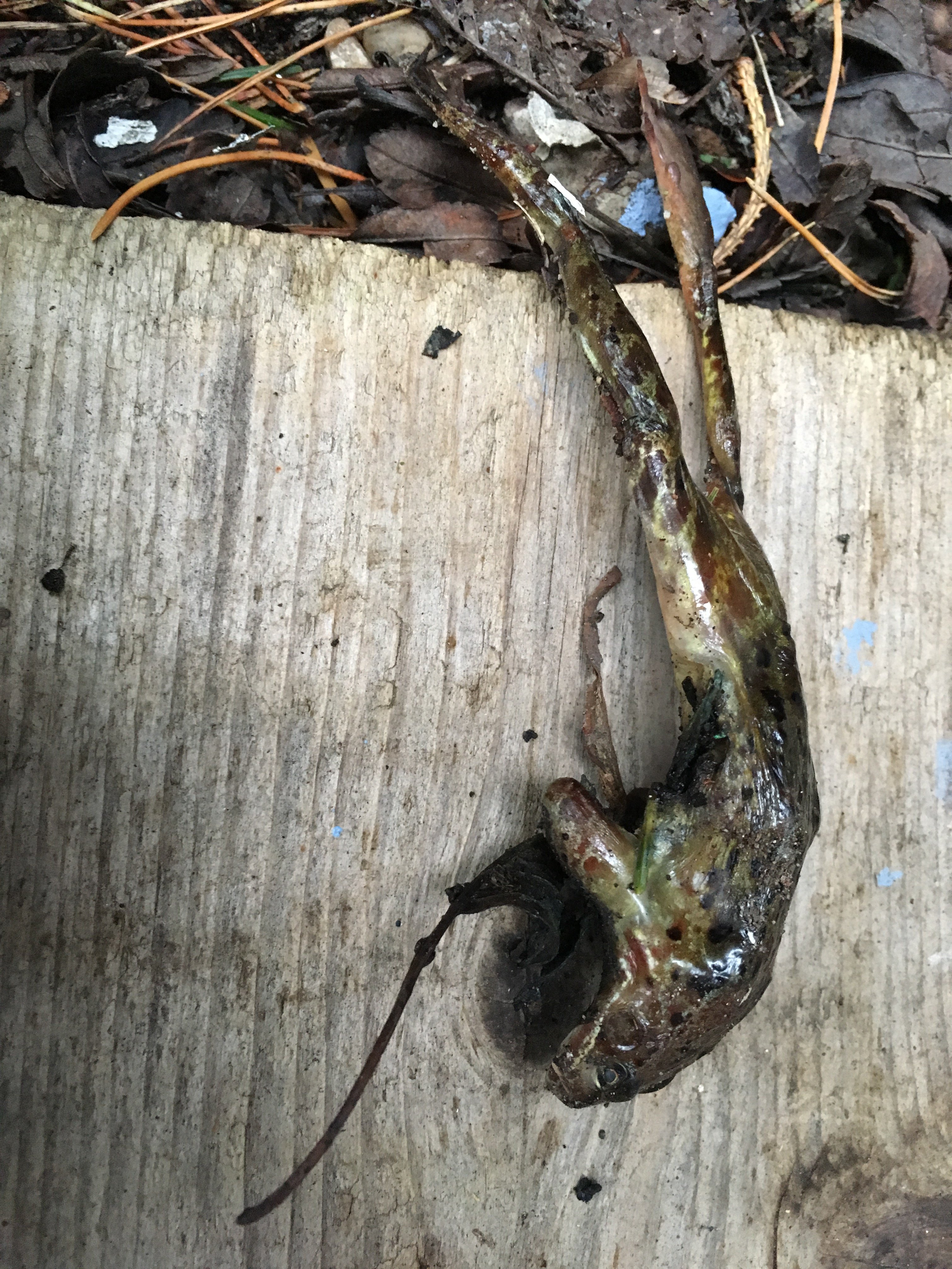

Call out the other day. Old 3036 rewirable. Fuse blew on lights so customer tries replacing it several times. Each time it blows again and again!! Pig of a job to trace fault. Removed all the lamps and IR tested less than 1Meg ohm. Start undoing switches and battens to find CPC's randomly missing. Looked in attic under 2 foot of insulation and found an old 30A JB used for lighting with about 10 cables crammed in so the lid wouldn't fit. Loads of vermin damage to cables observed. We were scratching our heads when the old lady mentions a cable out back that's been dangling down onto the ground ever since they moved in 18 months ago. Upon inspection we found a toasted frog that had clearly bridged the line and neutral (cable had no CPC). 'Do you think thats the problem' husband asks? 'Well given that you have a fried frog welded to the end of the cable I'm guessing so' I answer.
All made safe but place was an electrical
fire waiting to happen.

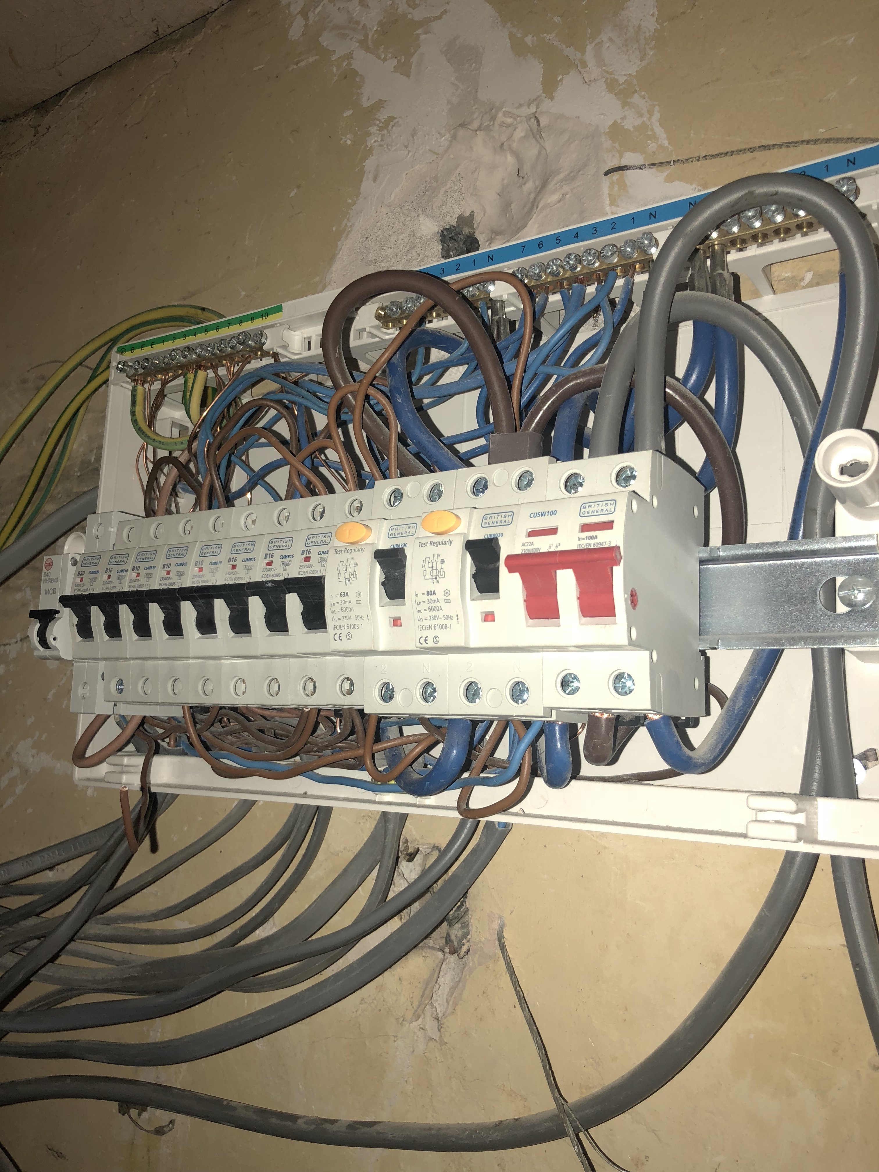

This caused me a headache today...
If it wasnt a regular customer who had just moved house, i would have walked!
A new C/U will be going in on the weekend, extending and connecting the earths in the light switches which are snipped off!, and fitting earth sleeving throughout all the sockets.
I dont think im going to get much of a weekend for myself...
However im going to be a bit different and use a busbar to connect my RCBO’s together.....
