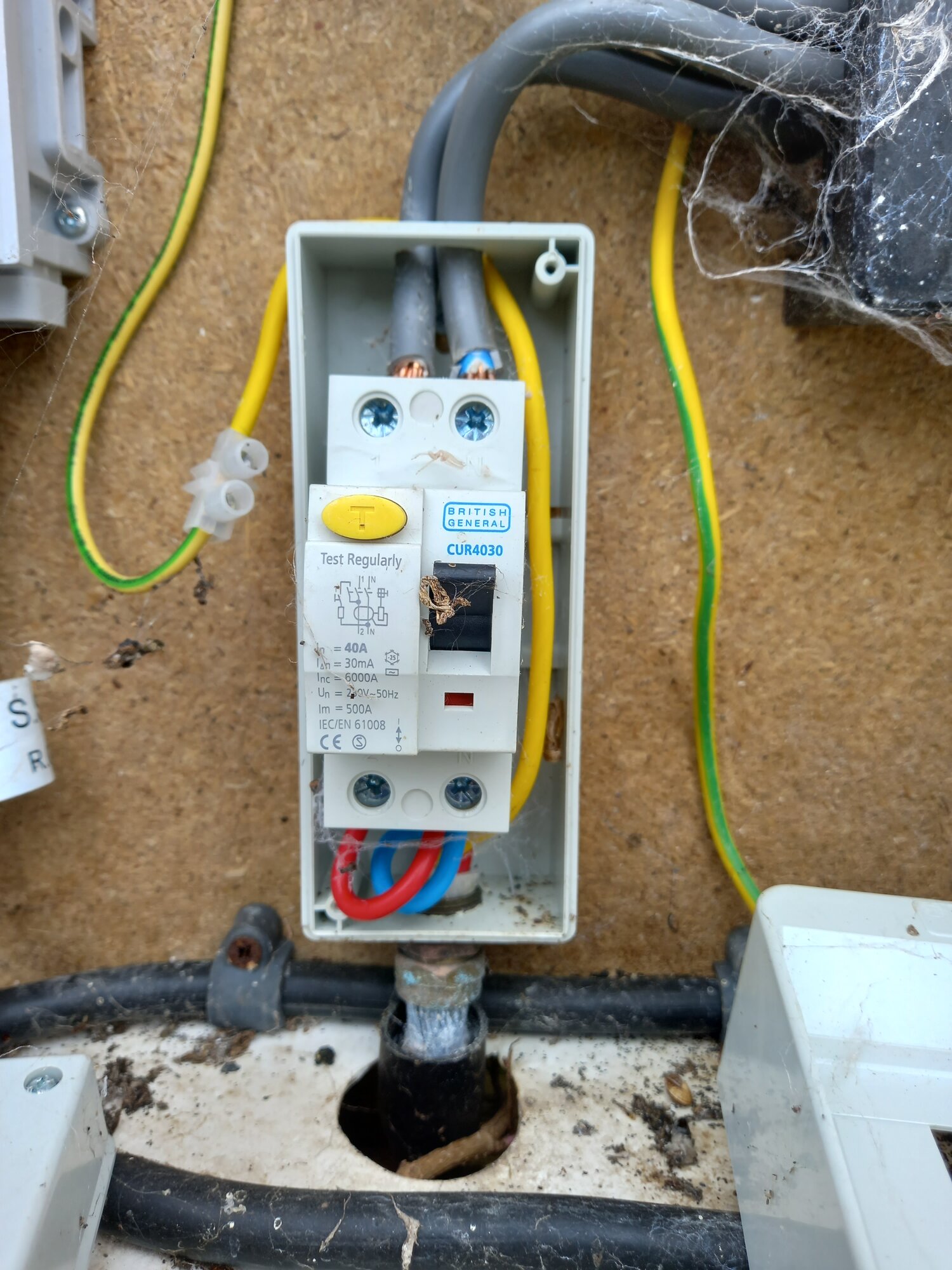

Is the heavily taped up cpc of the blue/brown T&E disappearing into the ceiling being used as a perm. live/switched live to the fan?
I’ve not untangled it all yet. I’ve got a number of points from this inspection and the list of remedial work keeps growing.
Landlord asked why I was taking light fittings down and sockets off as his last EICR was done in about 30-45 mins and never did any of this, I’ve been here 3hrs so far! 🤔
So I showed him this and said ‘that’s why, along with the fact you have a broken leg of a socket ring somewhere, no earth bond to your gas (meter was moved outside around 2yrs ago he said and it appears it’s never been re-bonded) and there is a socket being spurred off the shower so far. 😂
....and there is a socket being spurred off the shower so far. 😂

However, open question to everyone, just what exactly would be wrong with taking a socket outlet off the shower circuit (or anything else such as ufh, or similar); if electrically it had the usual stuff right such as rcd, Zs within limits etc.

You can’t run a 2.5mm spur from a 32A 6mm shower.
Not matter what the Zs is. The cable is only rated at max 27A.
So unless you ran it in 6mm, which would be some effort for a 2g socket 😂 then it’s not going to be compliant.

Ah you never said it was in 2.5mm

That is exactly what my head said at first too.
But....
Overload protection - each appliance and supply cable protected by 13A fuse in plug. OK, two at once would be a bit interesting but unlikely.
(In some circumstances overload protection is allowed downstream - I'd need to read that bit again to comment further.)
Fault protection - it's RCD protected.
It's a truly horrible design but is it actually non-compliant?

What about shower running at same time as someone has plugged a heater in?
Im just thinking, if the shower and heater together were above the MCB rating, but not enough to trip it. Just thinking out loud.
As a B32 wouldn't trip at all with a load of ~46 amps, the question is how hot does the 6mm get for the duration of the shower.
It would trip after roughly 15 minutes with a 50A load.

Nope, 2.5mm^2 would be fine, the maximum load could only be 26A max for a double socket outlet, and realistically 20A , so some if not most installation methods would have the capacity, exactly the same as a spur off a RFC.
Would not have to be 6, or 4mm^2, and if it was a single socket or FCU probably 1.5mm^2 would be ok from a load perspective.
I ask the question, because one's initial thought is to object, but is it actually wrong?
I know it's unusual and unexpected, but perhaps more compliant and less unexpected than some things we see!

The way I’ve always had it explained to me is that a spur off a RFC is fine because they’re in a ring and the socket won’t pull more than 26A. This is assuming cable is clipped direct.
However for, in this case, a shower circuit it’s not in a ring so the full load of 32A can go down it and overload the 2.5mm.
More than happy to hear other explanations and I’ve got my annual assessment next month so I’ll make a point of asking about this very scenario with the assessor as it will be interesting to see what their take on it is.
Not for a single or double socket as they have the 13A fuses limiting long-term loads to 13/26A (in fact most double sockets are only rated at 20A by specification).
If you have multiple sockets then yes, the feed cable had to be rated at the supply MCB to avoid overload risk, but for a single fused load it is limited by design.

As said by pc, this part of the circuit is the same as a spur, the only current which can go down it is that associated with the load on the end of it.
If that is a fixed value, or load limited by a fuse etc. Then no more than load current can flow unless there is a fault condition.
I can see us all grasping to try and back-fit some genuine, or invented regulation because it feels wrong.
I have no doubt that we all object and then actually struggle to justify why we object.
Which is why I asked the question, the example achives ads (assuming Zs is ok), has overload protection inherent due to single socket or fcu, has acceptable voltage drop, rcd etc.
So is compliant - why do we object?

The 2.5mm2 cable to one single or double socket isn't the problem. The problem in practice will be the size of the cable common to the shower and the socket, and the rating of the circuit protection device not being high enough for both.
As I said in my statement of the question, cable sizing, protective device sizing, Zs, rcd, ads etc being OK.
(The question is equally applicable to an fcu with a 1A fuse added to a 7.5kw shower supplied via a 40A mcb - with 10mm^2 cable)
What is the reason we try to find objections?

You've got me thinking - why do I hate it? I think it's because I have a sixth sense that the unusual nature of it could create safety issues, as others have said too. Hopefully not for sparks, though we do all make mistakes sometimes especially when tired. I'm thinking more of the DIY hero, or those that know enough to be dangerous.
So how do we feel about two rather predictable regs:
314 Division of Installation
314.1 Every installation shall be divided into circuits, as necessary, to:
ii) facilitate safe inspection, testing and maintenance
vi) prevent the indirect energizing of a circuit intended to be isolated
One might easily turn off and lock off "upstairs sockets", try a few sockets, and on a bad day having found every other socket upstairs dead not check the one that matters carefully enough. This might be construed to contravene indent ii).
It could work backwards too, you check that one and assume the rest are dead.
Unless there is space to adequately label the circuit, one would not expect the Shower breaker to be energising a double socket.
Another thought is 538.2. - saying that devices for isolation should be clearly identified by position or durable marking. If a shower pull cord isolator isolates a double socket, that probably contravenes this concept.
The question is, are these nit-picking issues from the regs book which are all open to interpretation legitimate enough reasons for the situation to worse than a C3?
