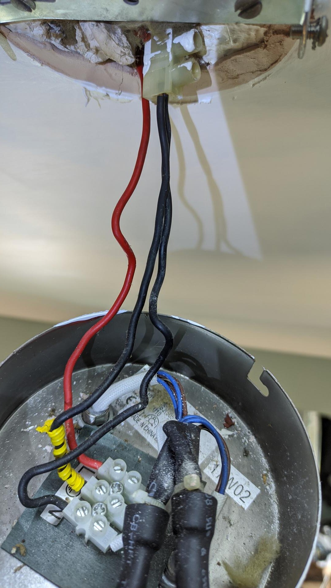

Is that a looped N ?
I have seen some very strange lighting where you have 1 SL but a pair of Ns at the light
I didn't have time to investigate fully in the loft, but seems to be a junction box above, with SL and N coming down, and then the extra wire from the N block to the earth block on the (metal) light fitting.

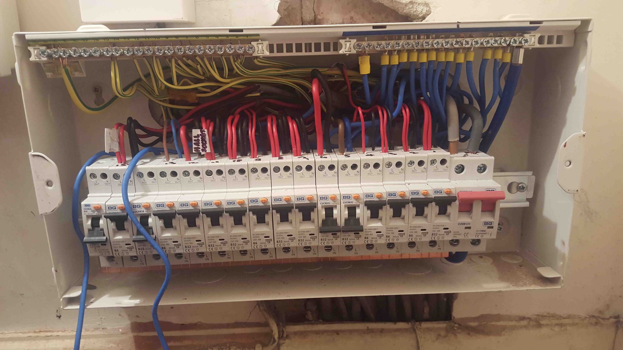

Half of the property in VIR that is falling apart, and the new part with all CPC cut short, or not connected at source.
Fortunately a bungalow, so lighting rewire should be relatively painless.

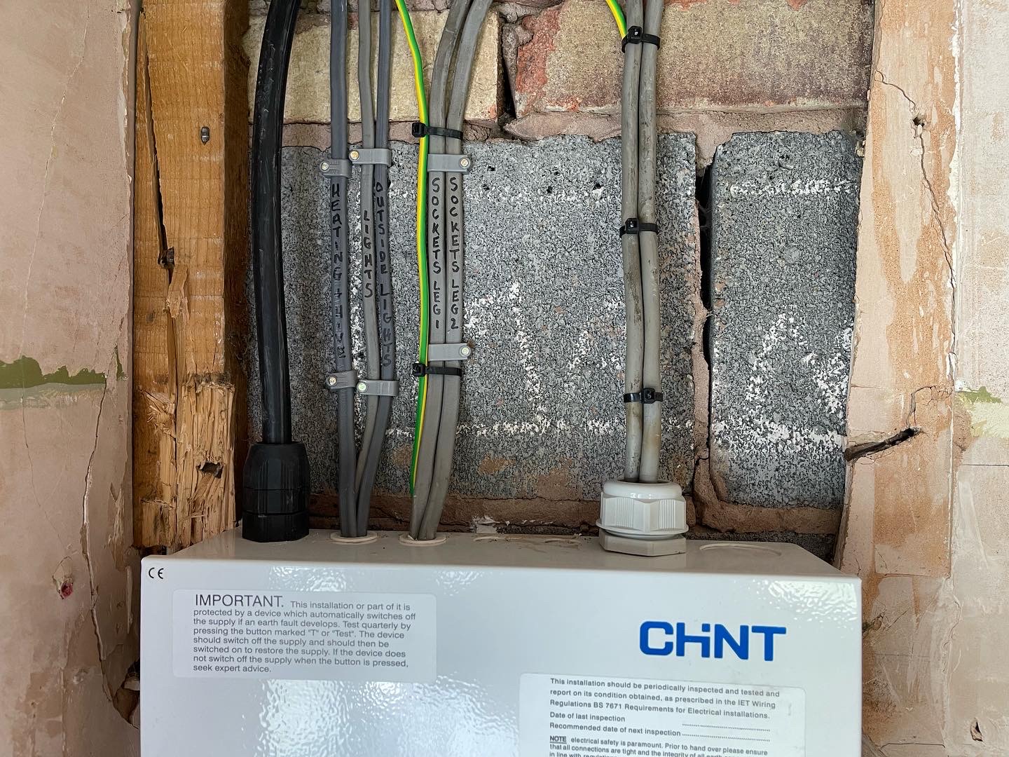

Just a general enquiry, who else thinks that bending cables at right angles is not a good idea?
If you’re referring to the cables that are supplying the RCDs etc that are at 90 degrees. They’re like that from the manufacturer.
As long as the bend radius in relation to the CSA is ok then I don’t have a problem with it.
It’s when you see them almost folded in two. But then it is deemed good practice to do so with a single 1-2.5mm CSA conductor to ensure a good electrical contact.
Never understand why that’s ok but but you couldn’t bend the cable back like that elsewhere.
So bending a multi cored cable or a solid core which is worse, bending a solid core at right angles introduces massive tension and compression to the core which would be spread over a multi core cable.
Considering they are made to a specification which is approved for sale in UK, ergo conforms to safety standards, I’d suggest they’re compliant.
Unless a defect is found, which given the amount of Chint boards around would likely have happened by now if there was.
It’s no different to these busbars in Schneider boards that are formed into a U-Shape to go around the neutral conductor in the main switch.

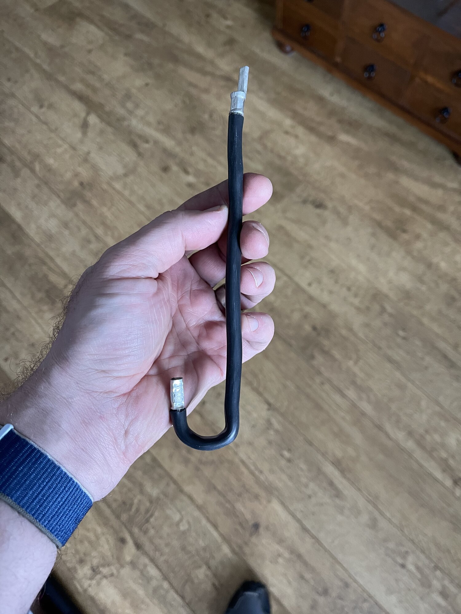

I also removed this from a board I changed today.
I think you have just proved the point of how much stress is put on a core when bent at right angles, I wonder how much cracking has happened internally when bent the once, would be interesting to set up a test rig and measure the resistance between straight and bent at right angles or a radius once or twice.
I’m sure the boffins already have given the amount of bent and right angled cables and conductors out in the wild.
