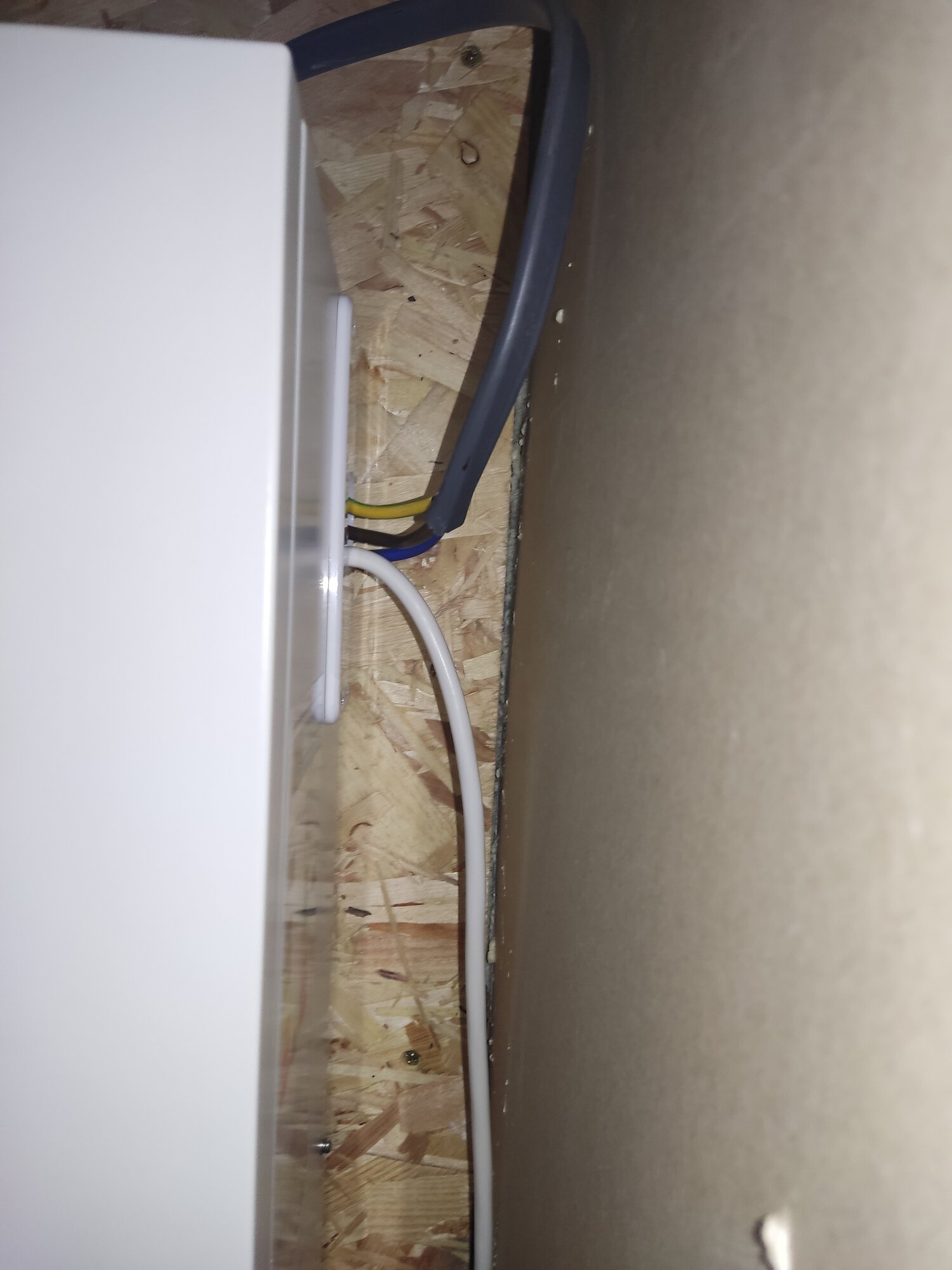

Slow to the party, going back to that fire alarm…
1- I wouldn’t want to be that last one that touched that.
2- isn’t there also a band 1 and band 2 voltage in same containment issue? 24v dc and 230v ac in same trunking?
3 - as above the sounder circuit setup isn’t correct
4 - Hope it’s on its own circuit. At least stick it on an unswitched spur - you don’t want someone switching off the fire alarm. I’m out of date but I believe Bs5389 mandates a red key switch these days?
The alarm monkeys should be putting this right and taking responsibility for it!
2- isn’t there also a band 1 and band 2 voltage in same containment issue? 24v dc and 230v ac in same trunking? OK as long as all cables are rated the same voltage. i.e. in this case 230V+
Panel should have been mounted uo against the trunking, allowing just for trunking lid. then no unsightly FP drops.

missed out on a EICR as himeowner's insurance insisted on NICEIC or Napit. he missed a couple of things, this being the worst.
So likely didn't remove cover at all then!
(and thanks for reminding me that if the cable is insulated to the highest voltage present that reg is satisfied.)

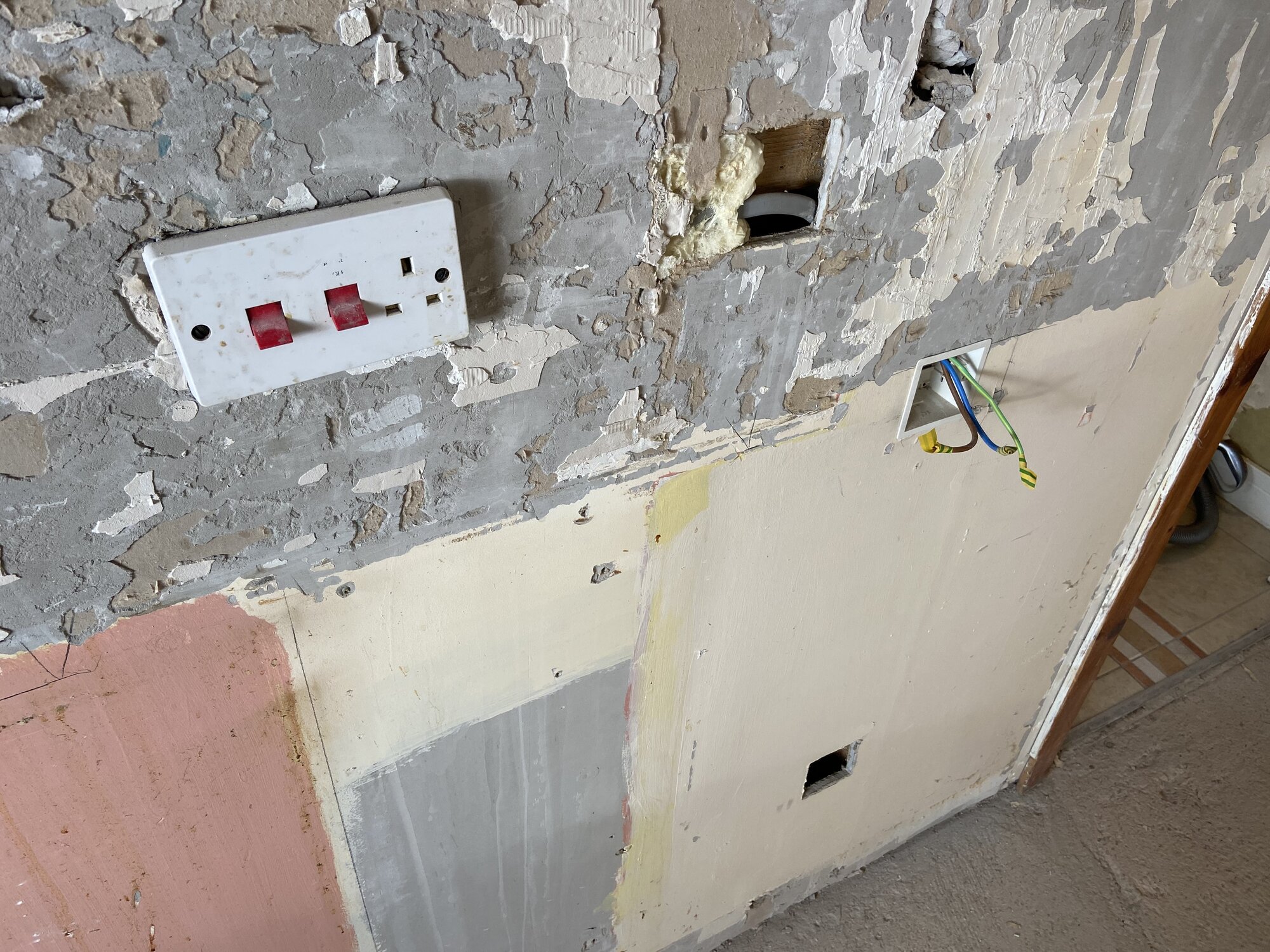

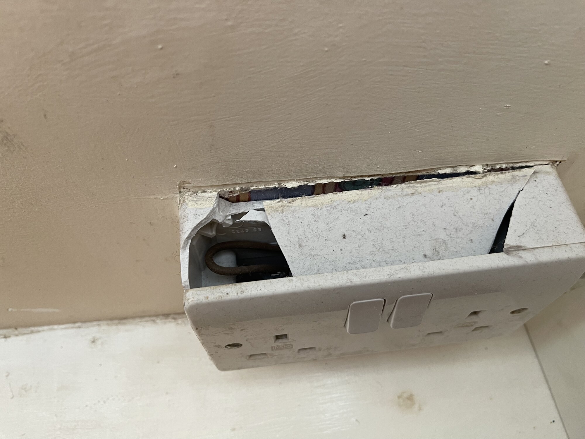

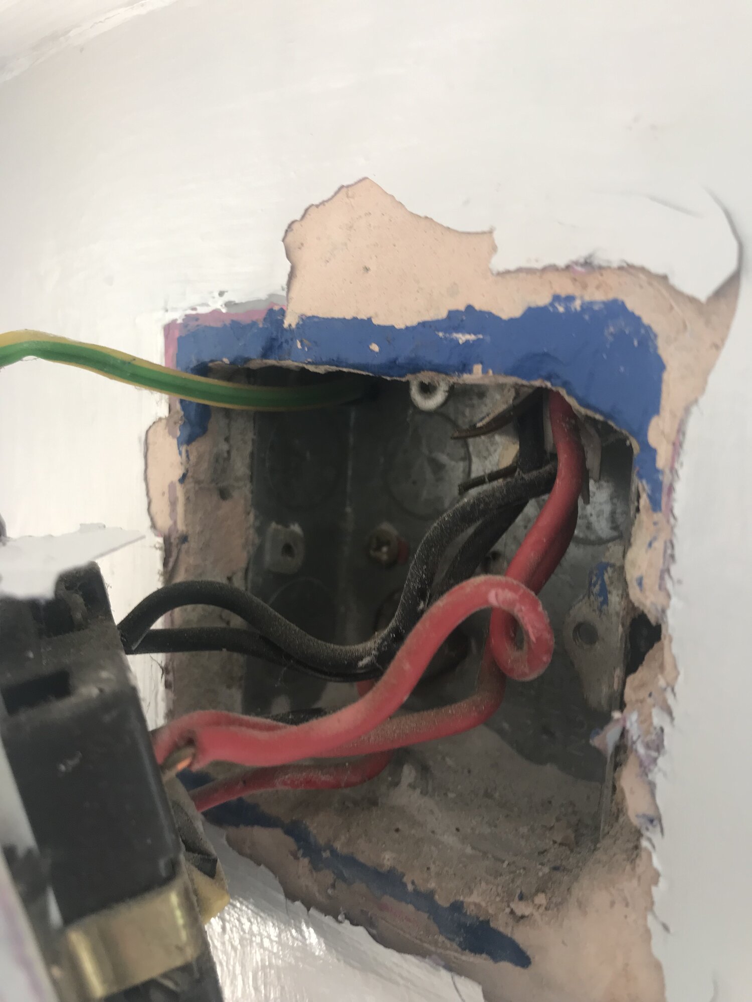

Back to work after Covid, and started on a kitchen that should have started last week.
Builder has already been in, ripped out the the old kitchen, tiles, flooring… the lot.
Which left the electrics in not the best condition.
The owners have moved out, so there was nothing stopping him attempting to turn things off at the board…

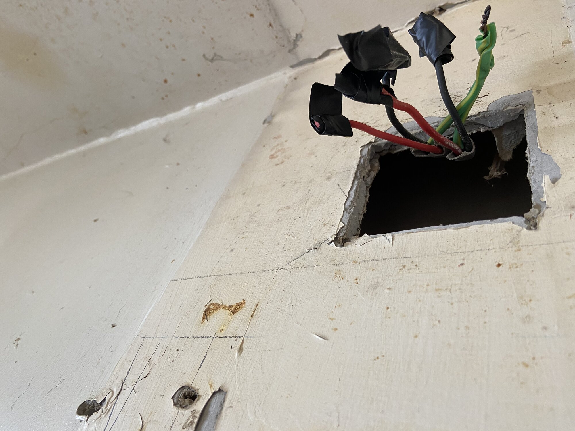

Switches and sockets hanging on cables where he’d taken a wall down… other sockets broken where he’d struck them with a hammer when taking tiles off…. And taped up cable for oven, with the cooker switch on!
Oh, and old extractor point removed… cables taped up separately…. Leaving the rfc as an incomplete ring.
Zoom in on the pic with the cooker switch…. Over to right. The outlet has been taken off and wrapped in tape. The tape has come off a bit and there is bare, live copper showing.
I suppose saving grace is a full RCBO board had been fitted earlier in the year….

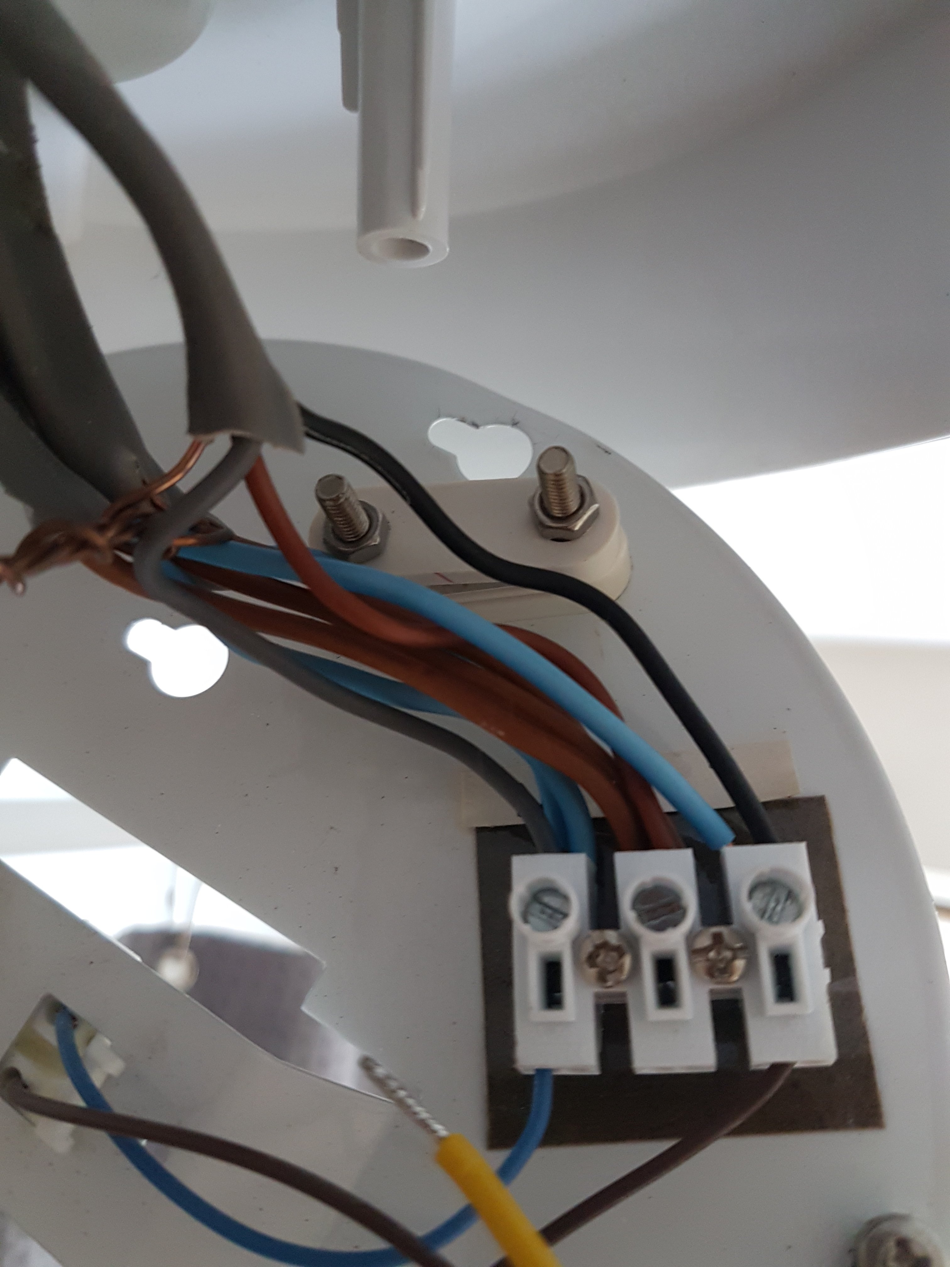

Fortunately RCD protected but a nurse thought she'd help out by replacing the diffuser on this light.
I've a real concerns when it comes to old fluorescent lighting, the heat generated eventually perishes all the plastic components.
In this case its the permanent live terminal that has just crumbled away.

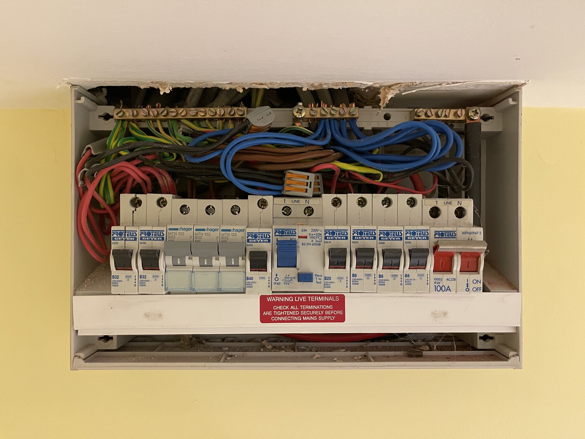

I love it when I get asked to check a board and when I arrive I get told the kitchen fitters did an outstanding job with the electrics...
Well they thought so until I started to point out a few 'anomalies' 😇
CPC's in the way? Just cut them short..
It's in a cupboard so it's ok....
Underfloor heating doesn't work for some reason.....
Lets see now:
Mixed MCBs,
4 conductors shoved into one MCB - though they are all held tight. Not sure if it's the clamp of the fact the cables have no space to move!
End MCB split
Not a lot of room for cables and I'm guessing they don't understand what happens when cables are loaded and they warm up!
And they clearly haven't heard of diversity for that RCD!! Which is supplying:
1 x 40A Shower
1 x 32A Induction Hob
1 x 32A Oven
1 x 32A Kitchen Ring
1 x 32A downstairs ring
1 x 32A upstairs ring
But they have used Hager accessories to match the MCBs and the finish in the kitchen was quite nice....🤨

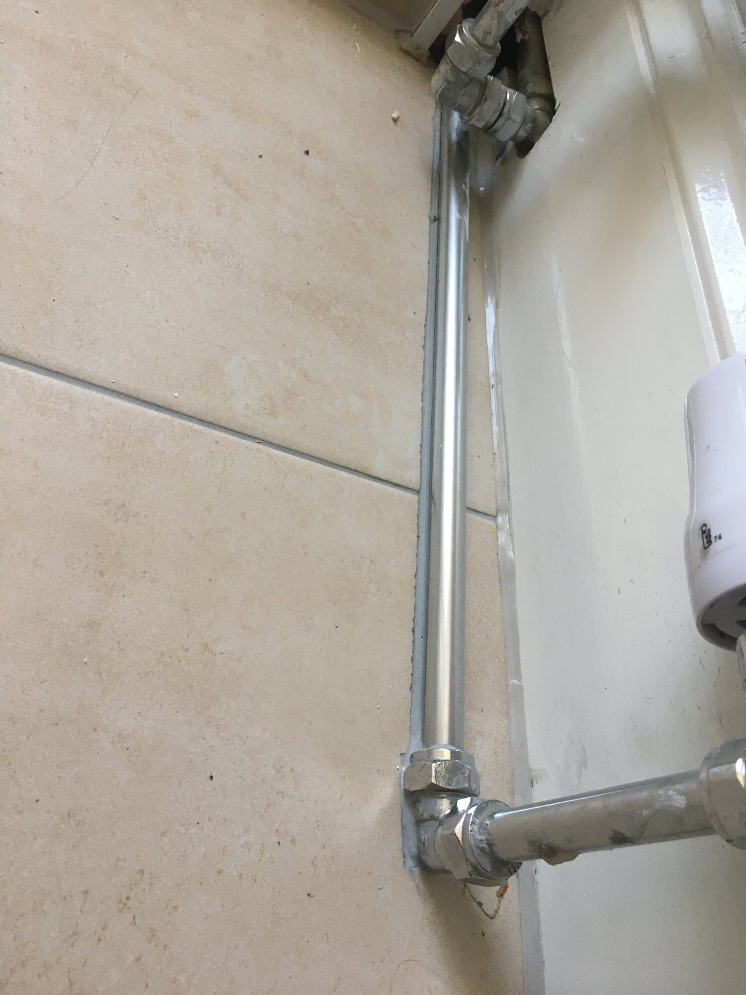

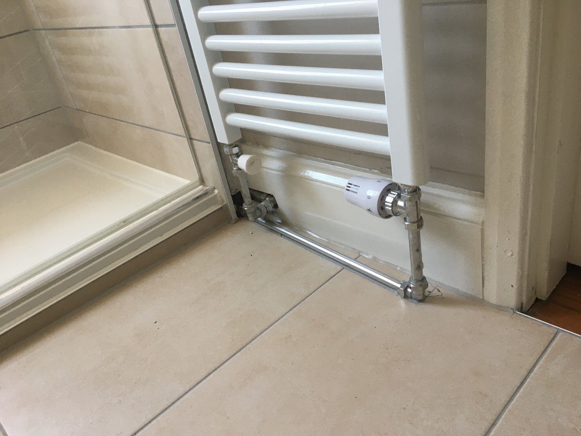

Took the trouble to cut the tiles to get the pipe in! would have been easy enough to box in the pipes instead, reverse the flow and move the thermostatic valve to the other end, towel rails are not bothered by the flow direction.

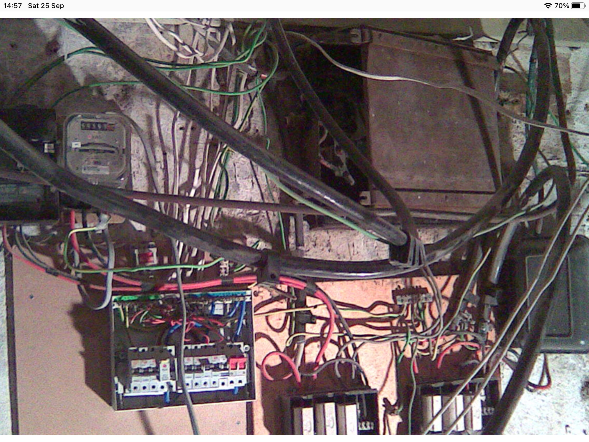

Today's EICR. I was looking for the breaker that supplied the 2nd consumer unit. I couldn't find it.
Then I saw this...ah....right...
Supplying this:
100A supplier fuse, and used to have 25 sq mm tails before 2 cores didn't fit.
16mm T+E to next board. 85A CCC. PME supply. etc.
As far as I could tell the reason it was done is that the top Legrand board is almost totally inaccessible behind a garage door rail (I could only just get the cover off), and the tails entered from the cavity at the rear. The new extension would have required RCD protection for lighting. Most frustratingly the problem that someone didn't feel like the pain of changing the CU has only led to it being more urgent that someone changes the CU.
Somewhat ironically a further fault is that the Proteus RCD didn't trip at x1, x5 or when test button pressed. So all that effort to hack RCD protection in amounted to nothing anyway. The white cable bottom left is a spur to the socket under the board, into which was plugged a granny EV cable.
Found these today whilst on another job.
Module cover held on by a piece of tape and falls off as soon as you lift it up, nicely exposed busbar (which I covered with a blank) and mixed MCBs
