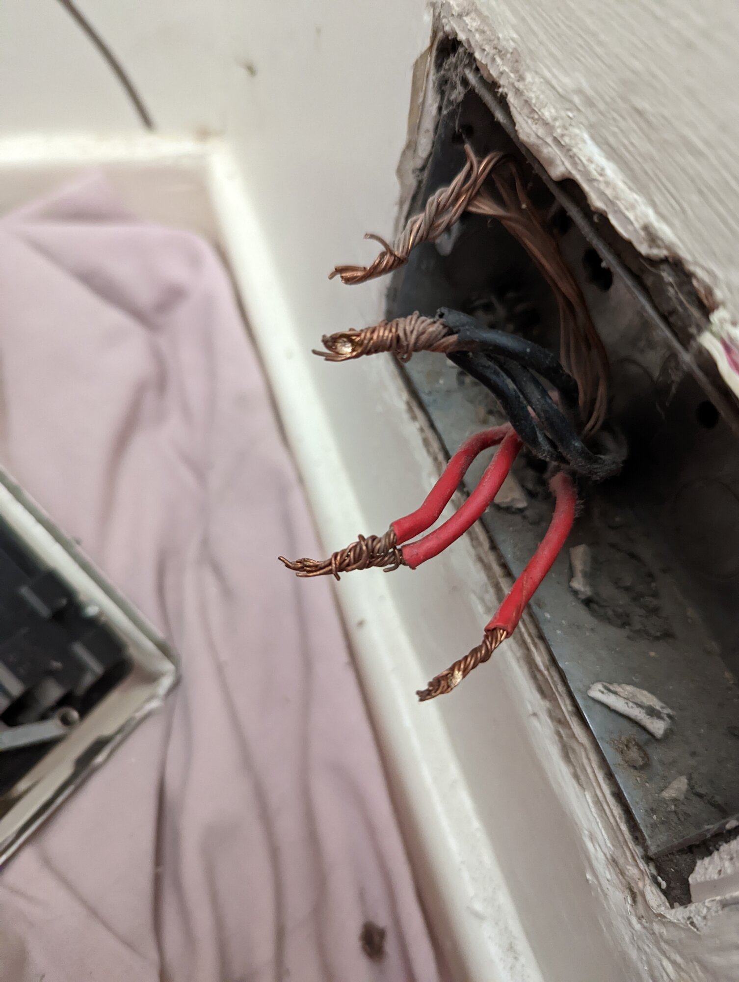

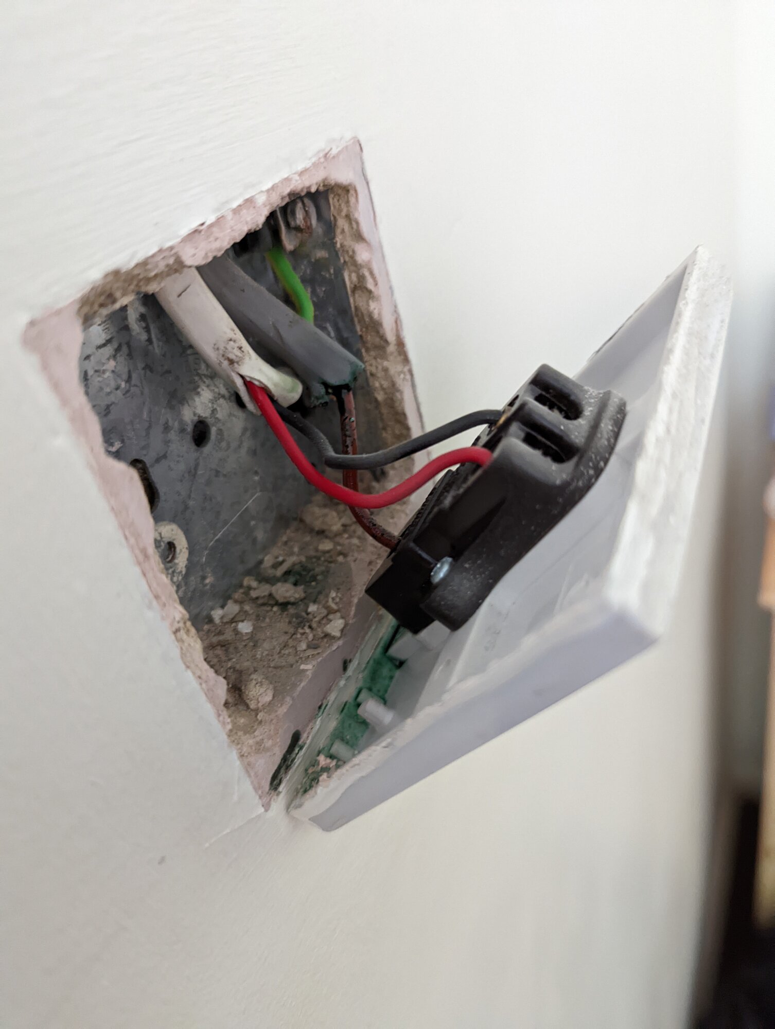

Was only replacing it for a usb type. Managed to squeeze some wagos in there. It's a pain in the --- for dead testing having them all twisted like that.
combi drill in reverse, soon untwist that pile of crap.

I didn't think of that. I was slightly concerned the wago's weren't going to fit and I didn't have any extension things with me to just hack them off.
Did Wago's grip the stranded cable ok?
id have cut off and restripped a clean bit of conductor... twisted them individually, and put the 3 into the back of the socket.

Im sure they are fine for stranded cable, but freshly stripped back, clean and neatly twisted stranded cable..... not that!

Pretty sure they should not be twisted after stripping if putting into a Wago?
Yeah I use the 221 5 ways, you have to use the lever instead of forcing it in with stranded. I cut it back and it was twisted neatly when I stripped it. The conductors weren't long enough unfortunately so needed extending. Technically it was two spurs from one point I suppose and I could of used lots of two way ones.
You should always use the lever with a Wago that has that facility, the days of forcing in a cable are a while ago and the old type of Wago, in fact I don't think they make them anymore, certainly I can't find them on their web site, but TLC still have them, in preference I would always use the lever type.

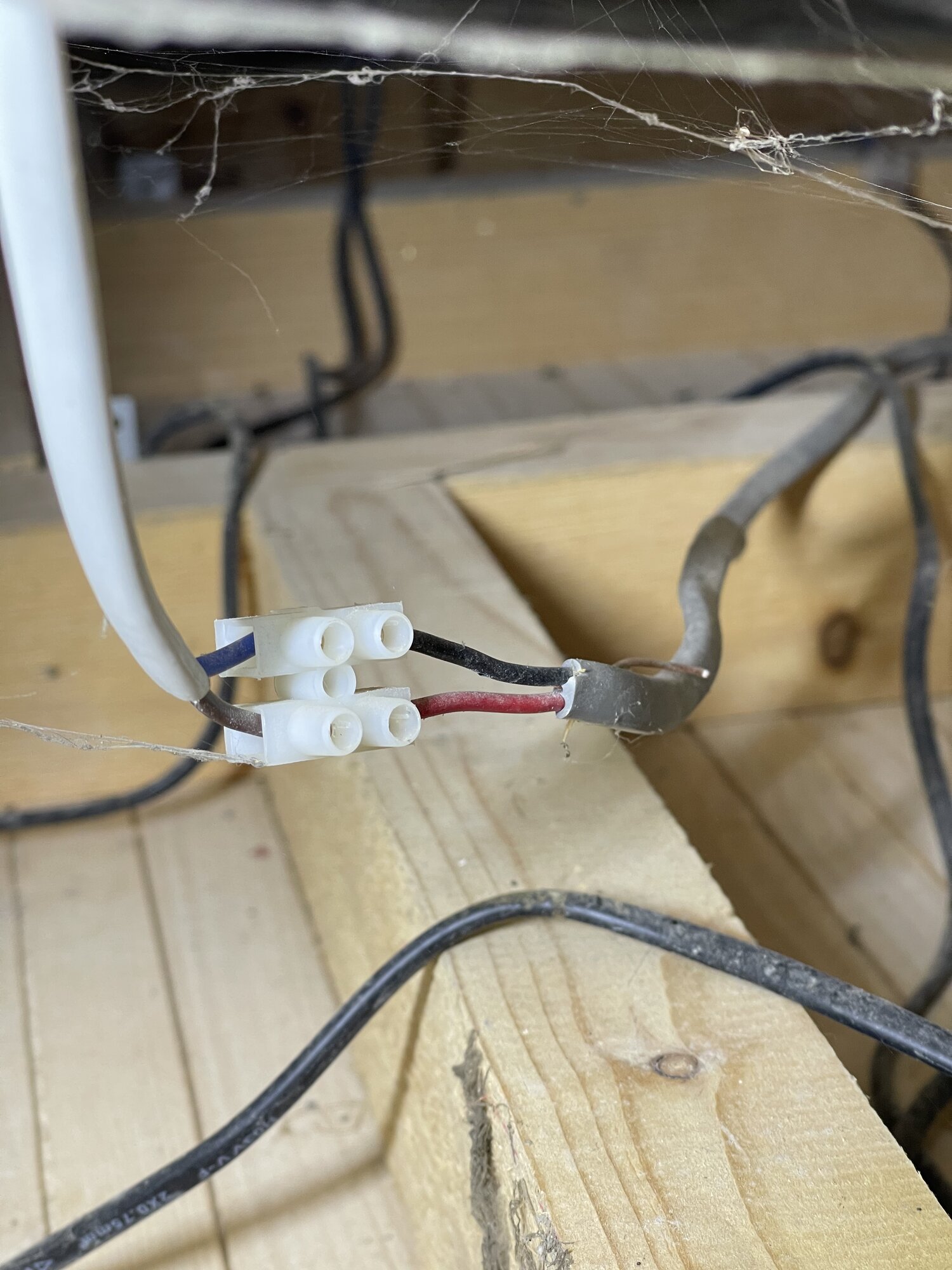

Yeah, it's on the banjo, I know...but it does look like it screws into the solder..😀
It is a banjo a strange set-up but it is rock solid. Look lower down there is the original braid.

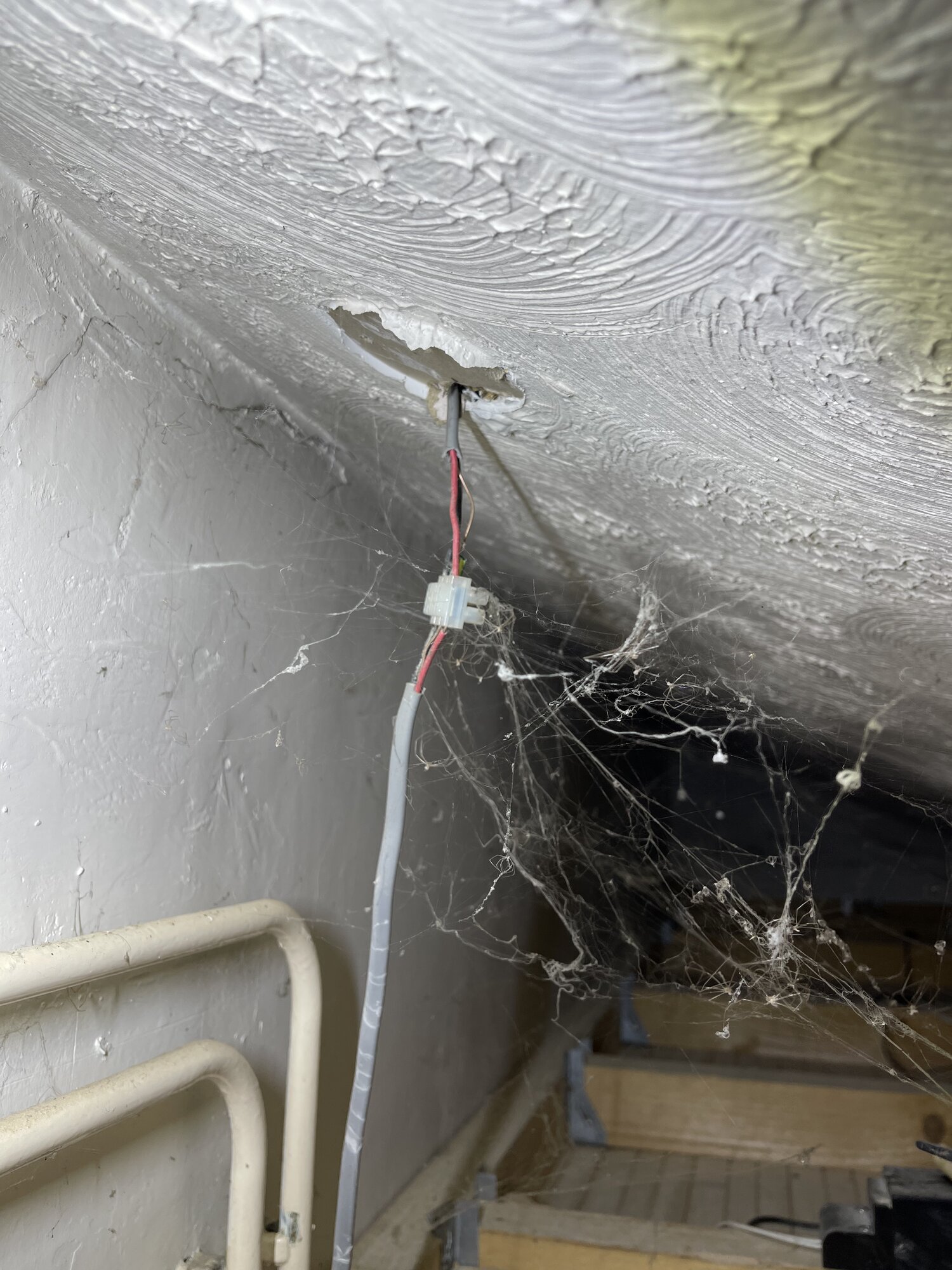

It’s a good job I’m only 6ft and 15st. Otherwise it would have been a really really tight squeeze to sort it. Instead of just the really tight squeeze it was! 🙄
But I did just about did it, without cutting the ceiling. 😇 Now I just need to clip the cables with some fire clips as best I can and wire in the new downlights.
I’m 6’, and there’s no way I’d be fitting in there without taking most of the ceiling down….
Hope that Artex did not contain Asbestos. 😱
