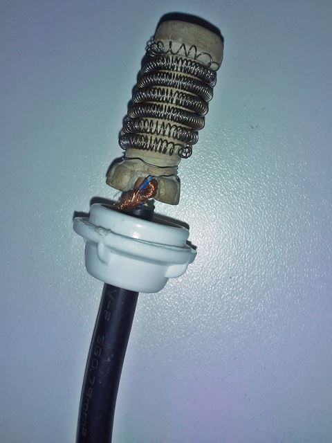

I do the Western Union and only add solder when the wiring goes inside appliances, there's almost no regulation on electrical work where I live so most self-proclaimed "electricians" use random wires and do simple twist splices and cover it with tape.
Here's a dodgy thing, minus "protective" cap. Guess what this is.
If you said mug warmer then you're right, it makes your tea/coffee/beverage of preference boil and could make your mug explode if you leave it plugged for more than 30 seconds, but does the job.

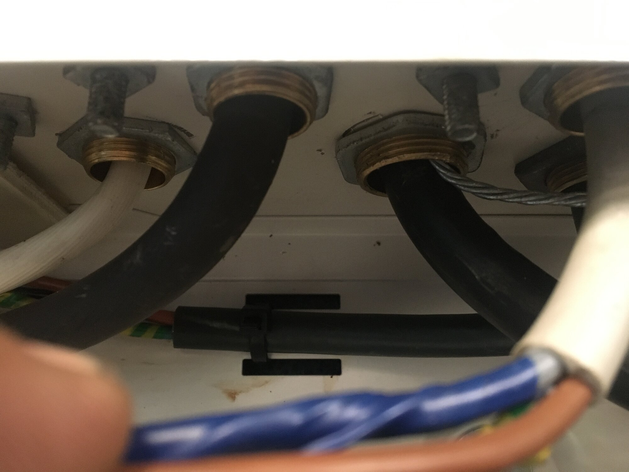

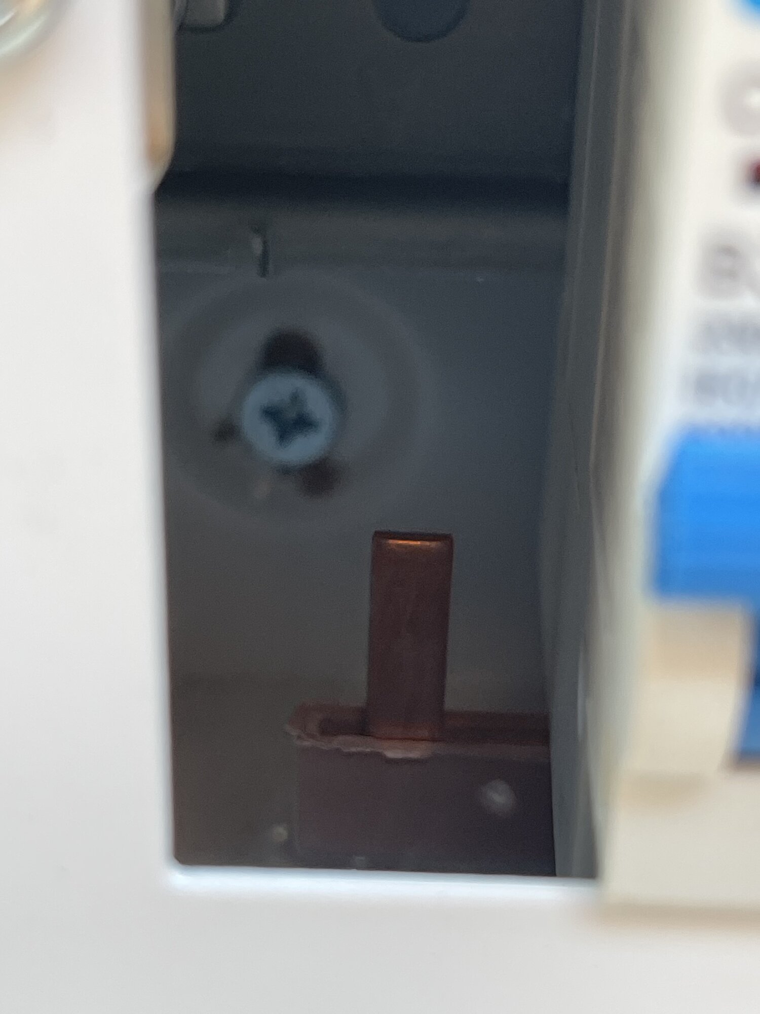

I have seen SWA made off like that quite afew times but normally when its made off into a plastic gland and the sparks winds the armour together like that parking it to earth
I don't like seeing SWA made off like that into a plastic box / plastic gland with the strands earthed like that but like most things its probably a new fangled way of doing things
Under certain fault conditions, the current flowing through those few strands of steel could be sufficient to heat them to a dangerous level. Not acceptable.
As it happens, I was removing it anyway and replacing with bigger cable that is correctly glanded and bonded

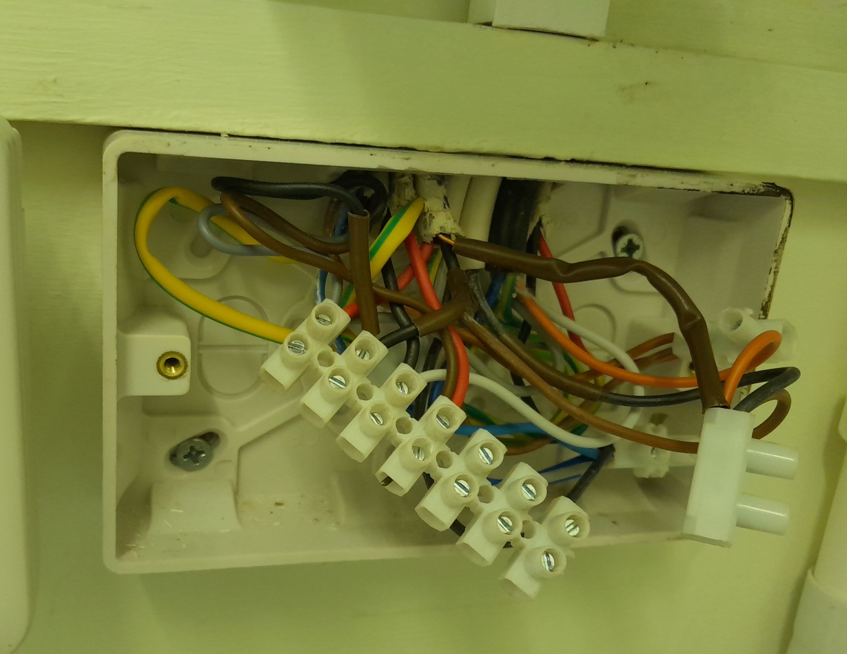

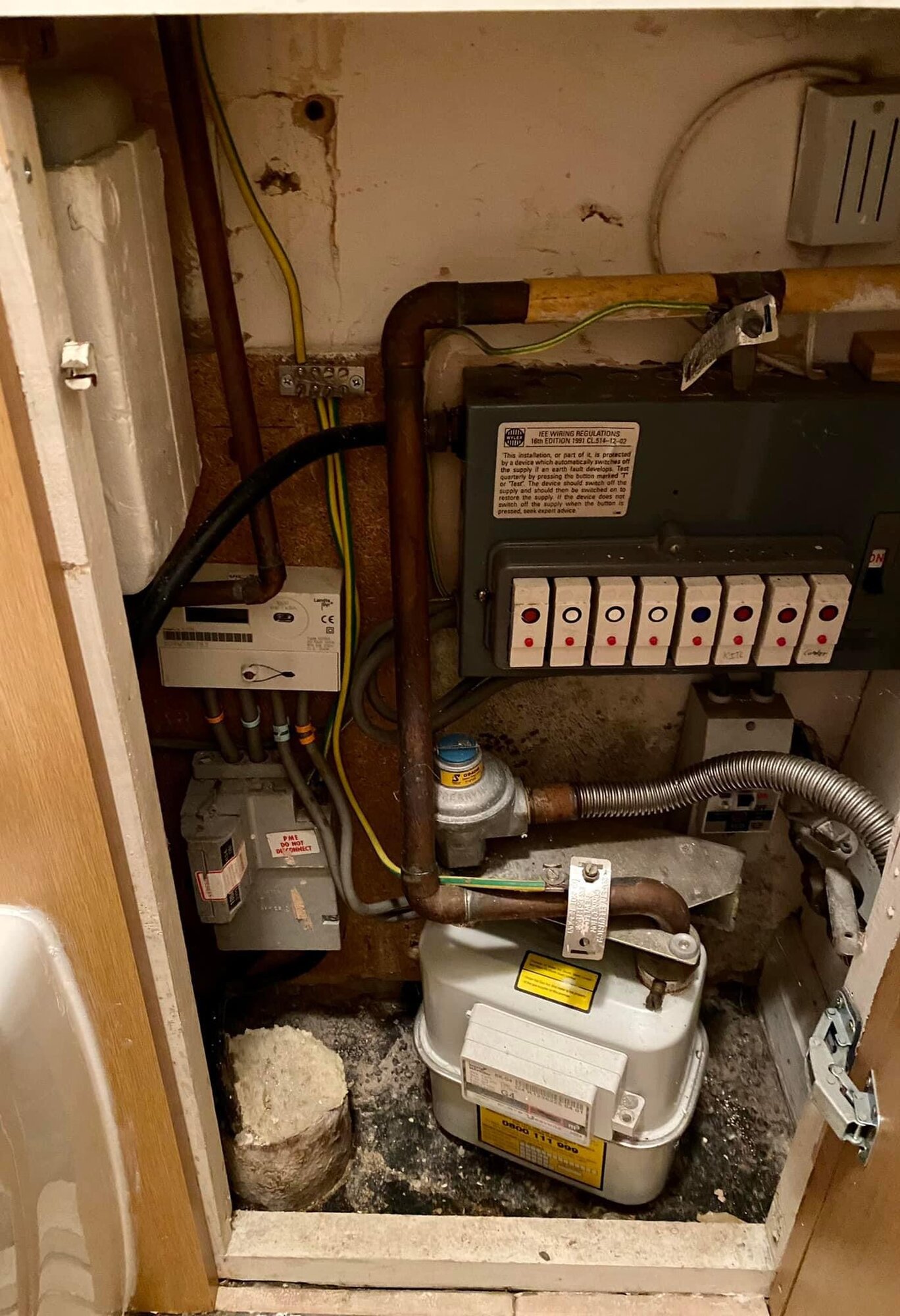

No prizes for guessing the issue here. 🙈
Yes, your right, The henly blocks are upside down. WHY WOULD SOMEONE DO THAT!!!
at least whoever put the ct clamp on recognised what the true purpose of the cable was whilst ignoring the tape.
brown to the right
blue to the left
and anything else in the middle.

I reckon it's the coloured cable ties that are wrong, not the tape. Meter looks newer than the blocks.
Most meters, the phase in is left, phase out is right.
N in and out is normally in the middle left and right as per the lives.
however the N are normally just jointed in a short bus bar with a fly lead for the meter electronics.
isn't not also reverse polarity?
Correct.
Reverse polarity, undersized tails to a EV charge point & upside down connector blocks.
This was done when a EV charger was installed. The guy said the installer made a right mess and he had a load of issue since and they wouldn’t come back.
I thought no one could be that stupid to cross the polarity. But they had. 🤦🏼‍♂️
