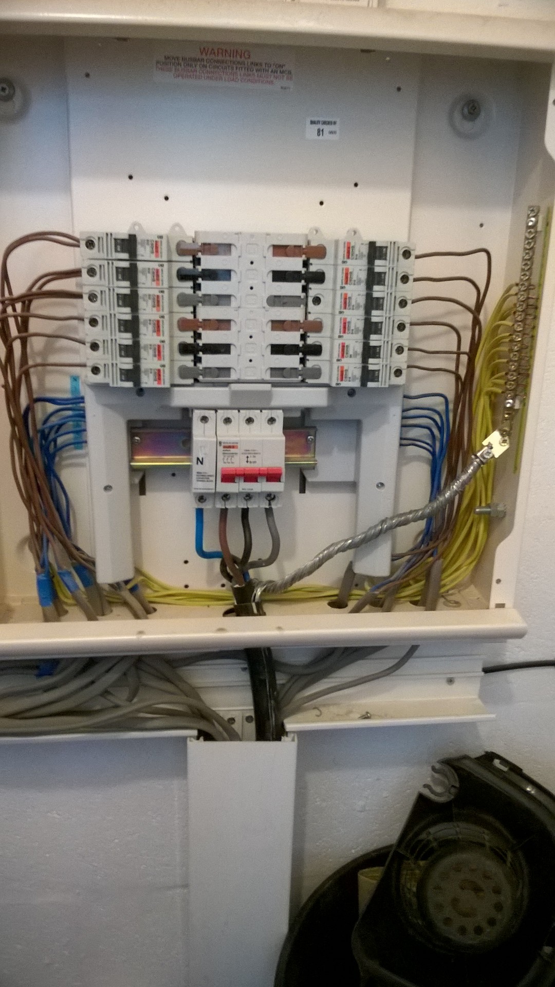

I stuck a board in last month, it was only a basic one in a detached garage but I still took the same care as I would anything else. Feel free to criticise!

Very Nice.
Just wondering....

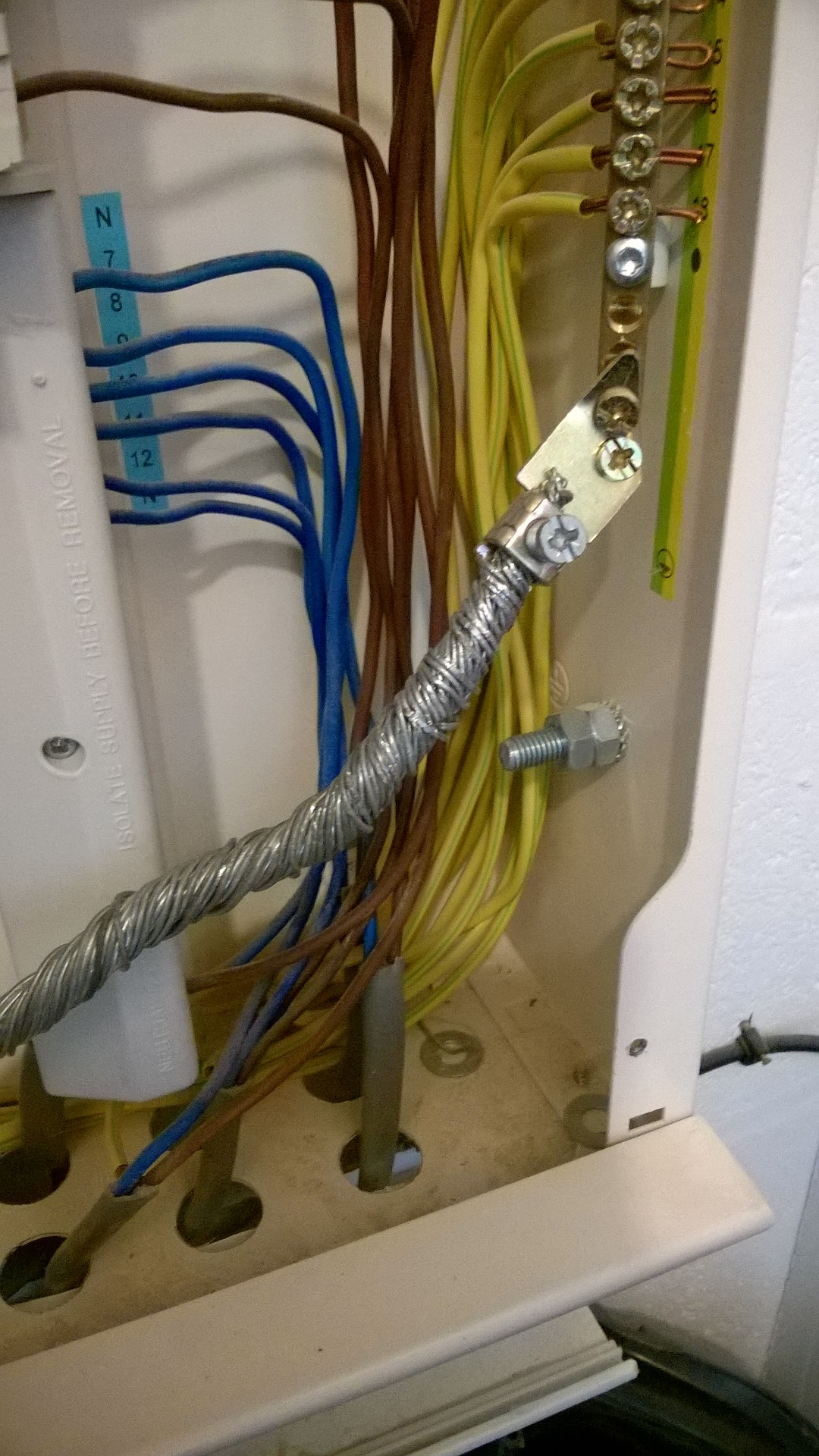

Does that say armour on the sleeving of that cpc? How have you attached to armouring, is there a banjo on the outside of the enclosure?
Also, where is the 2nd neutral for circuit 2 - cant see it in the bar or is it just hidden behind?
Are the neutrals in ferrules? if so why have you used them? Aesthetics?
The neutral for circuit 4 looks larger than the live? in fact they all look the same size, is there a joint somewhere behind the breakers?
What is the 45A breaker supplying?, is it a hot tub or something?
Not being critical at all - nice work, obviously some care and attention to detail
It is written on the conductor attached to the banjo. The CPC is wrapped in G/Y tape as I ran out of sleeving large enough to fit. :(
There is a gland and the banjo is on the outside of the enclosure, connected with brass nut and bolt, outside so all brass in contact, better than a possibly rusty steel locknut in contact with the banjo.
It's not in the neutral bar it is in the neutral terminal on the RCBO. It is hidden behind the line conductors.
Yes, the neutral flyleads from the RCBOs are in ferrules. I have used them as I shortened them to save space in the enclosure, which of course involves cutting off the manufacturers ferrule. Fine and very fine stranded conductors must be fitted with a ferrule unless the terminal is specifically designed to accept such a conductor, the flyleads are very fine stranded so ferrules must be used.
The neutral flyleads from the RCBOs are all the same size, the circuits neutral is connected to the RCBO it's 1.0mm, no joints in the consumer unit.
It's 40A (CGD don't do a 45A for some reason) for an instantaneous undersink water heater.

Thanks for the comments!
@Harwoodandy - Not sure what you are viewing the picture on regarding freddo's post but most of your questions are answered in the PIC, I can understand missing the flylead on the SWA on a phone sized screen but asking if the N are Ferruled when its more than obvious they are has confused me a little as did a few other questions you asked did o_O

Thanks for the input....
My question was to the OP - when viewing on my phone screen its rather difficult to tell, if it was more than obvious I wouldn't have asked would I. Perhaps you are easily confused? Perhaps I should just ask you in future?
No worries
That makes sense - I agree with you on the ferrules, easy to have stray strands - hadn't realise they were RCBO's, viewing on a small screen, thanks for the reply

I wasn't trying to get your back up here and maybe you read my post the wrong way but I would appreciate you don't reply with an attitude as regardless whether it be to staff or any other members we frown on such responses, it helps no-one and usually drags the thread downhill, I asked because I was genuinely confused, and no, I'm not easily confused, been on this forum for over 7yrs and and an 11,000+ post count so I tend to have got the jist of how and why people post and respond, I even viewed it on my phone before I posted and it was very clear hence why I queried it. TBH I was rather expecting you to say you left your glasses somewhere or you were looking at a different pic by mistake as the thred is full of them.. that's why I commented to check you were seeing the same pic really.
You have answered what I asked and thats is all I was enquiring about, thankyou. :)
