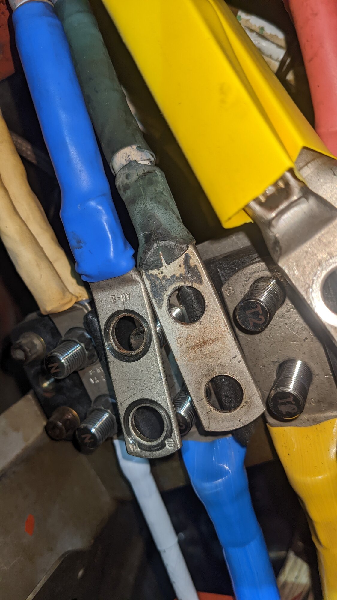

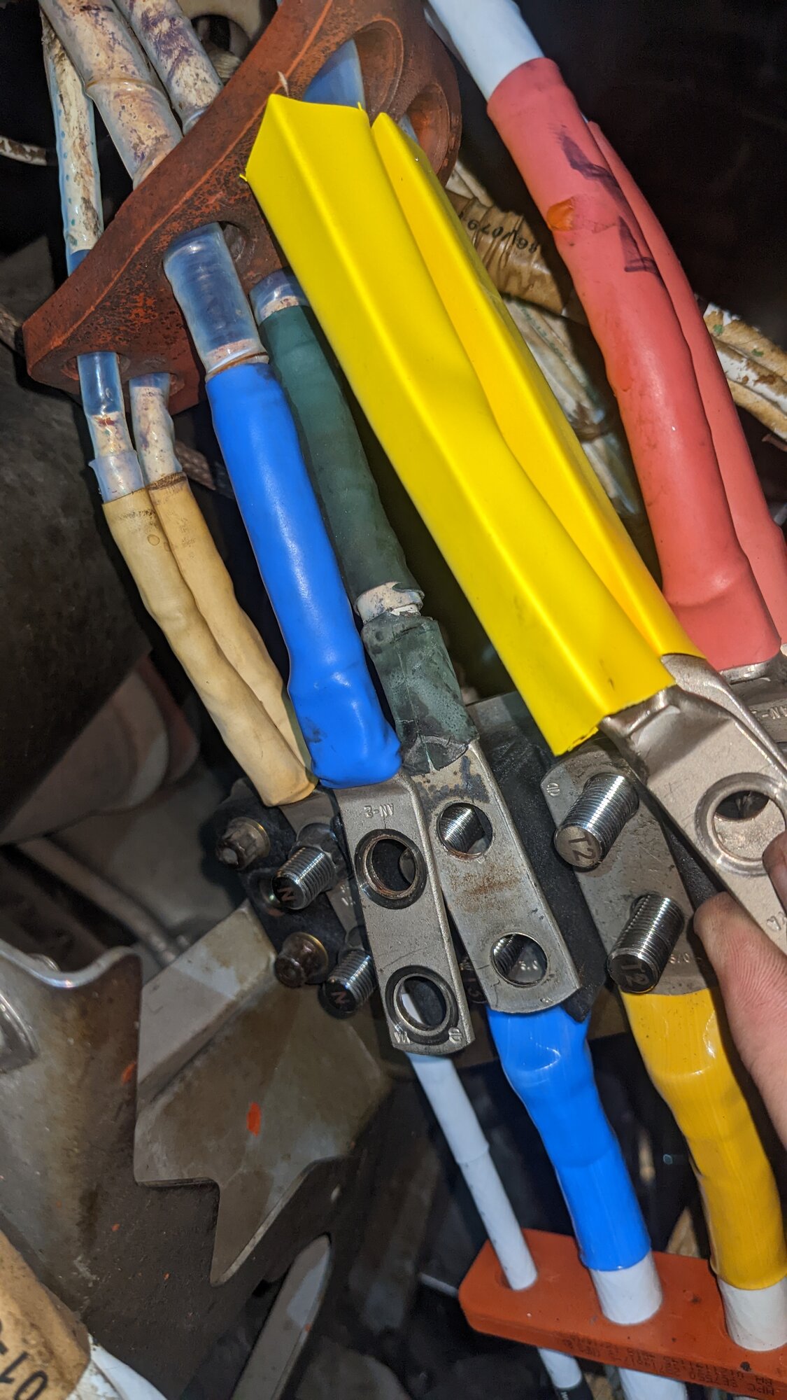

Somebody had previously put heatshrink to low on the lug resulting in two phases getting very hot!
Cleaned up and put back

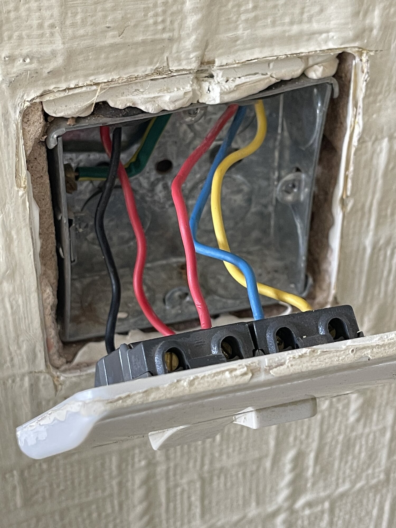

Umm, that’s not how you do 2 way wiring for a downstairs to upstairs switch…. 😂😂
Couple phoned as they moved in just and every time they turned the lights on for the hall or landing at the bottom 2 gang or upstairs 1 gang both light circuits tripped.
Upstairs 1 gang
Downstairs 2 Gang

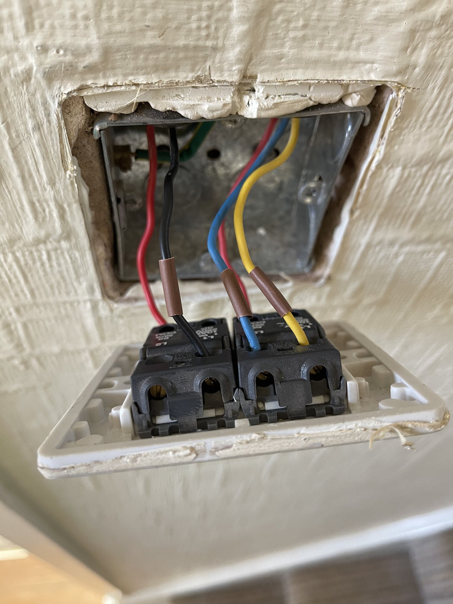

Upstairs after
Downstairs after

You need some red sleeving.
  • Funny
Reactions: nicebutdim and DPG
I think he means instead of the brown to be more inkeeping with the old cores
Ahhhh.
I’m sure most electrician will know what brown means. 😂
Then again…..

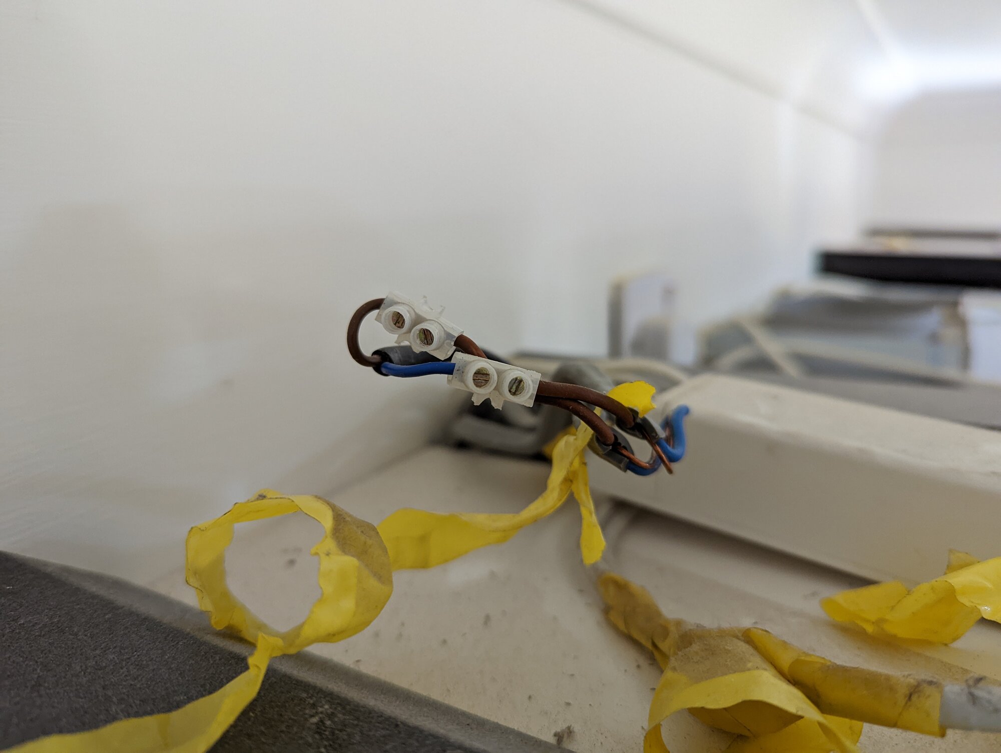

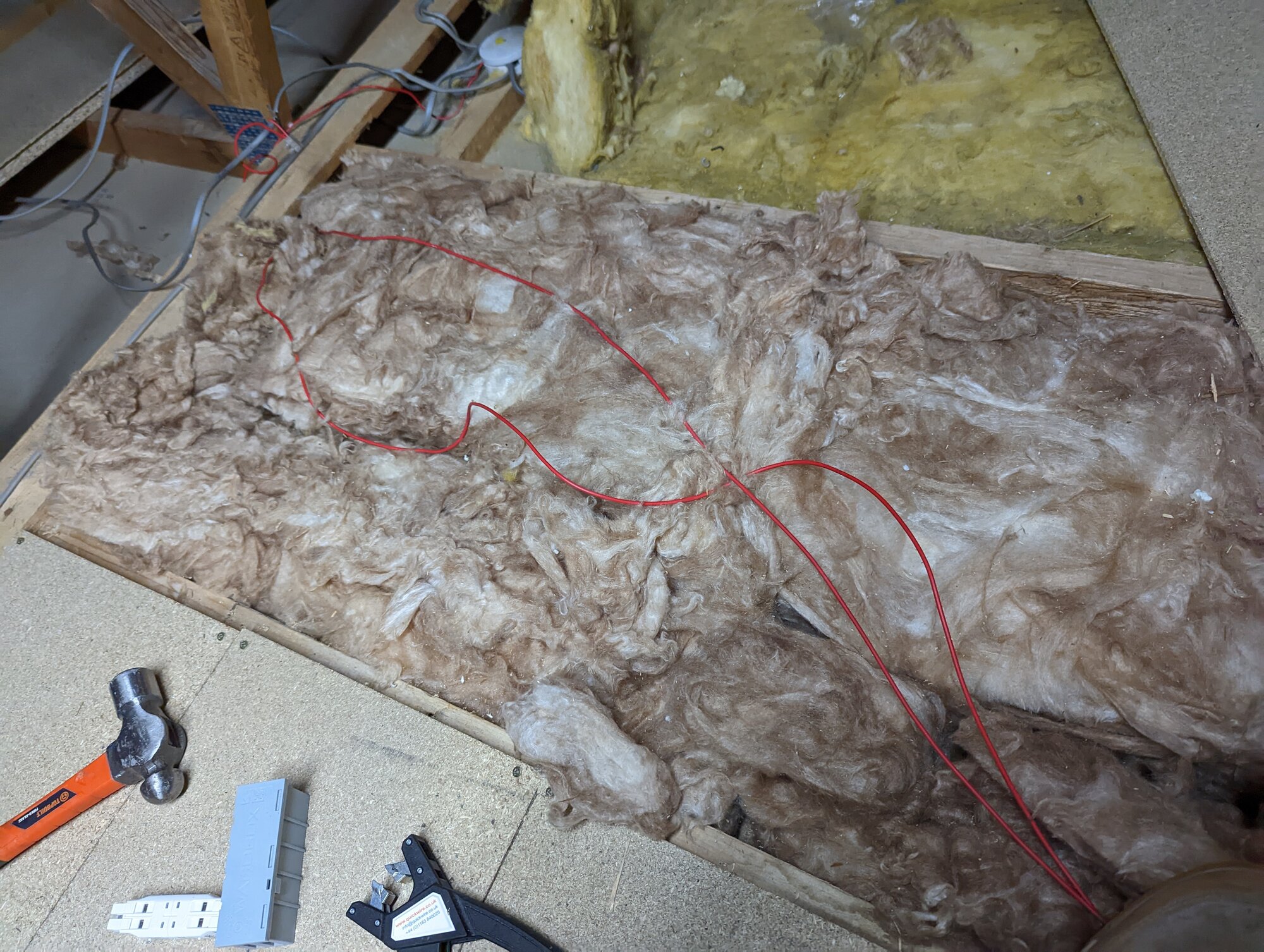

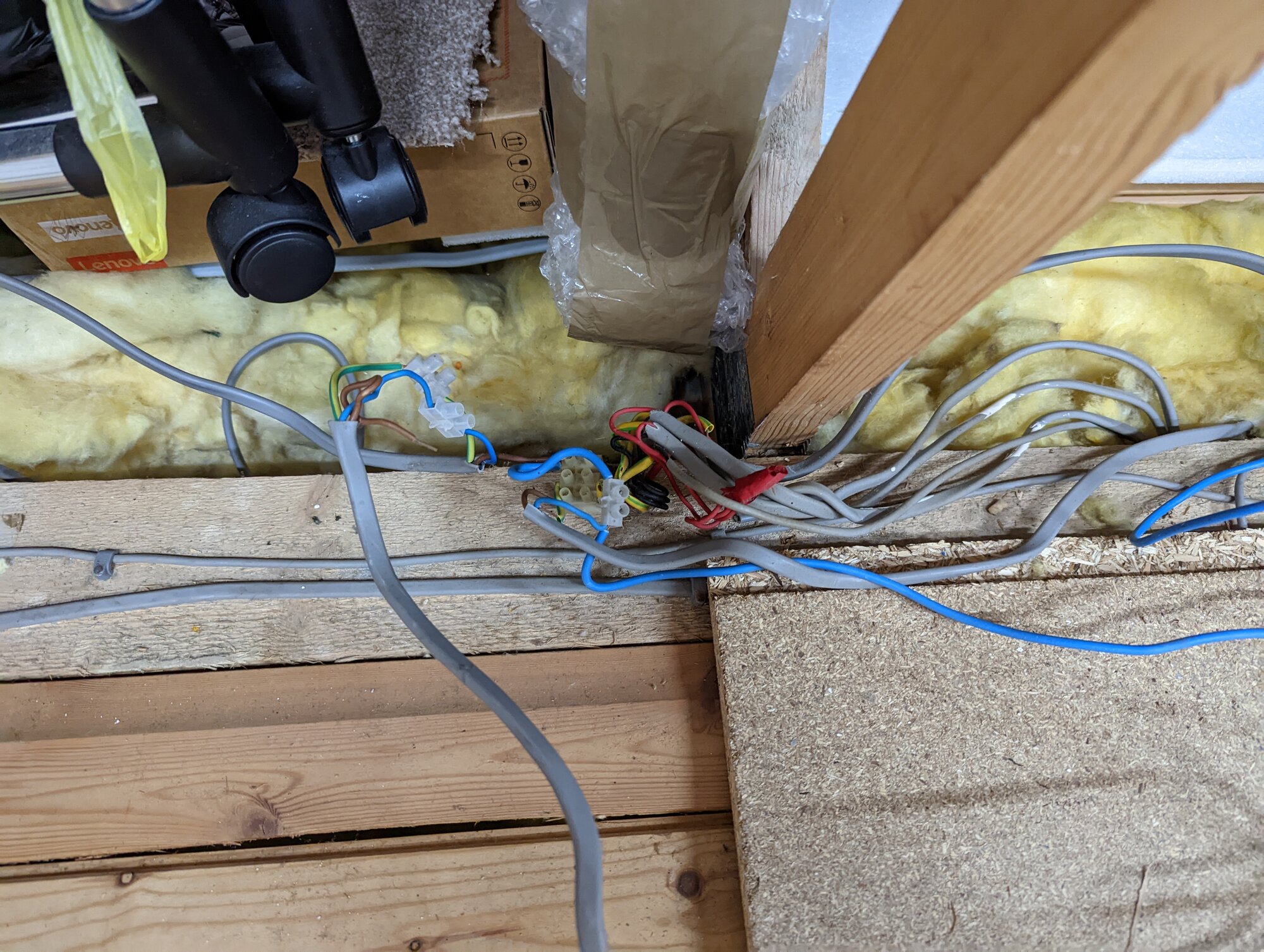

I found this while fitting some spots in another room. I can't explain what they were trying to do but the singles went to a light switch. Another electrician had already disconnected at the switch but left it live in the loft.

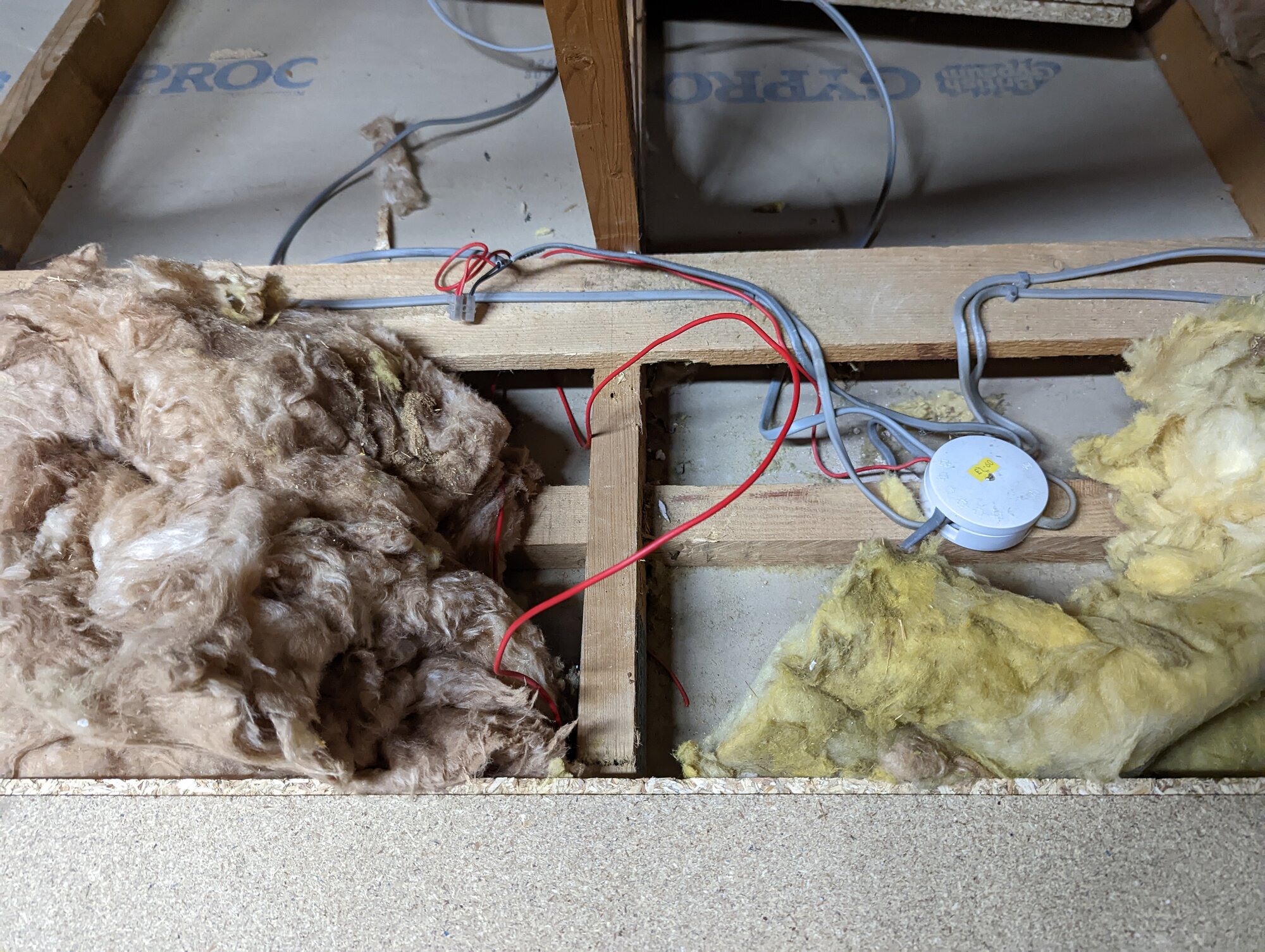

Its tricky when you keep uncovering things not related to the main task, I found this mess in the same property. It takes longer to trace when it lacks logic too.
There's a brown core used as a neutral feeding some under cabinet lights with the line from elsewhere, I'll need to check it's not connected to another circuit when I do second fix. All lighting is on one breaker, perhaps this is why.

Well, they're not much of an electrician, then.
Maybe he was going to run singles in conduit but never had time to finish it, maybe had to go home to wash his hair or something.
Reckon there could have been kitchen fitters in the vicinity, or what? 😏

I would had liked to have blamed them but the old spots in the bathroom were the same odd methods (t&e used as singles, stripped sheath and leaving the earth intact) and the singles were run to the landing light. Shame as the original wiring looks neat, clips in the loft and sleeving seems to have been used.
Suppose he could have been a kitchen fitter...

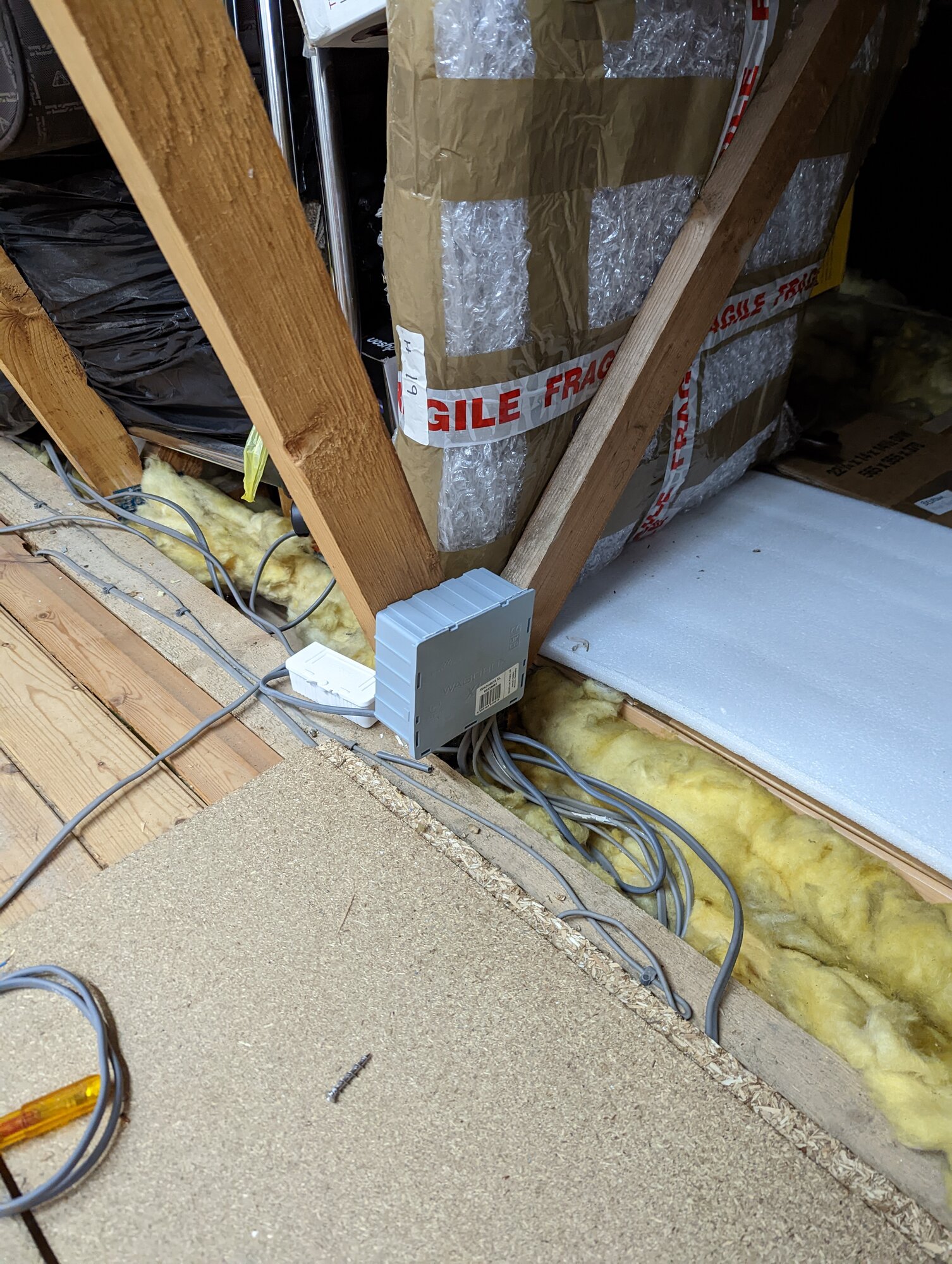

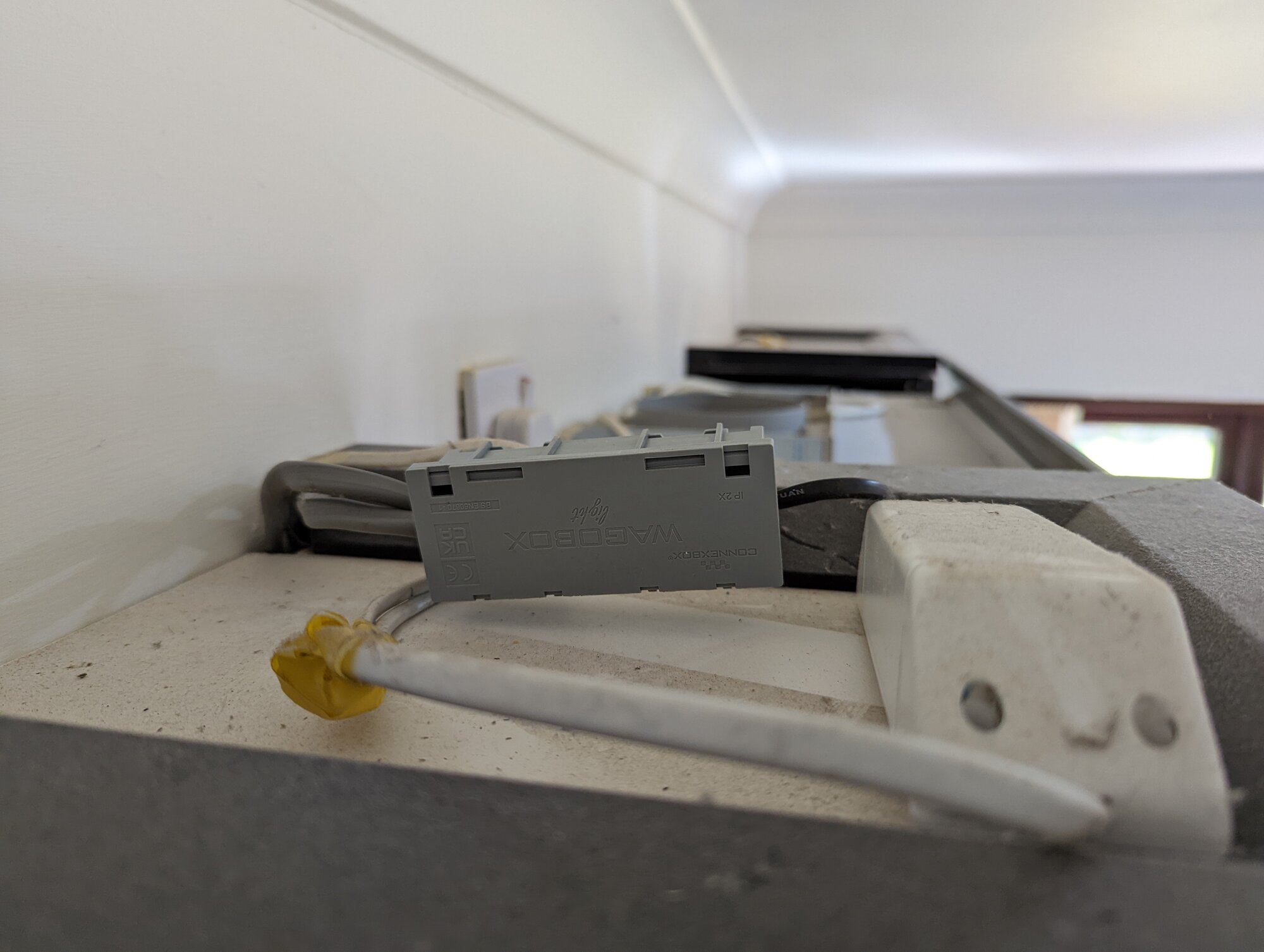

The (presumably) lighting multi way connection box, I like, and have used on many occasions, but WHY did they mount it right down on the deck like that. Surely a couple of metres of extra T&E to get it up to a comfortable working height wouldn't have broken the budget.
The wago XL and light box were me, the XL could have perhaps been a little higher, some cables were short though. I would assume there was a round JB there at one point. The deblock box was also me as those cables didn't reach at all and hopefully, its rewired to the XL when the kitchens done.
