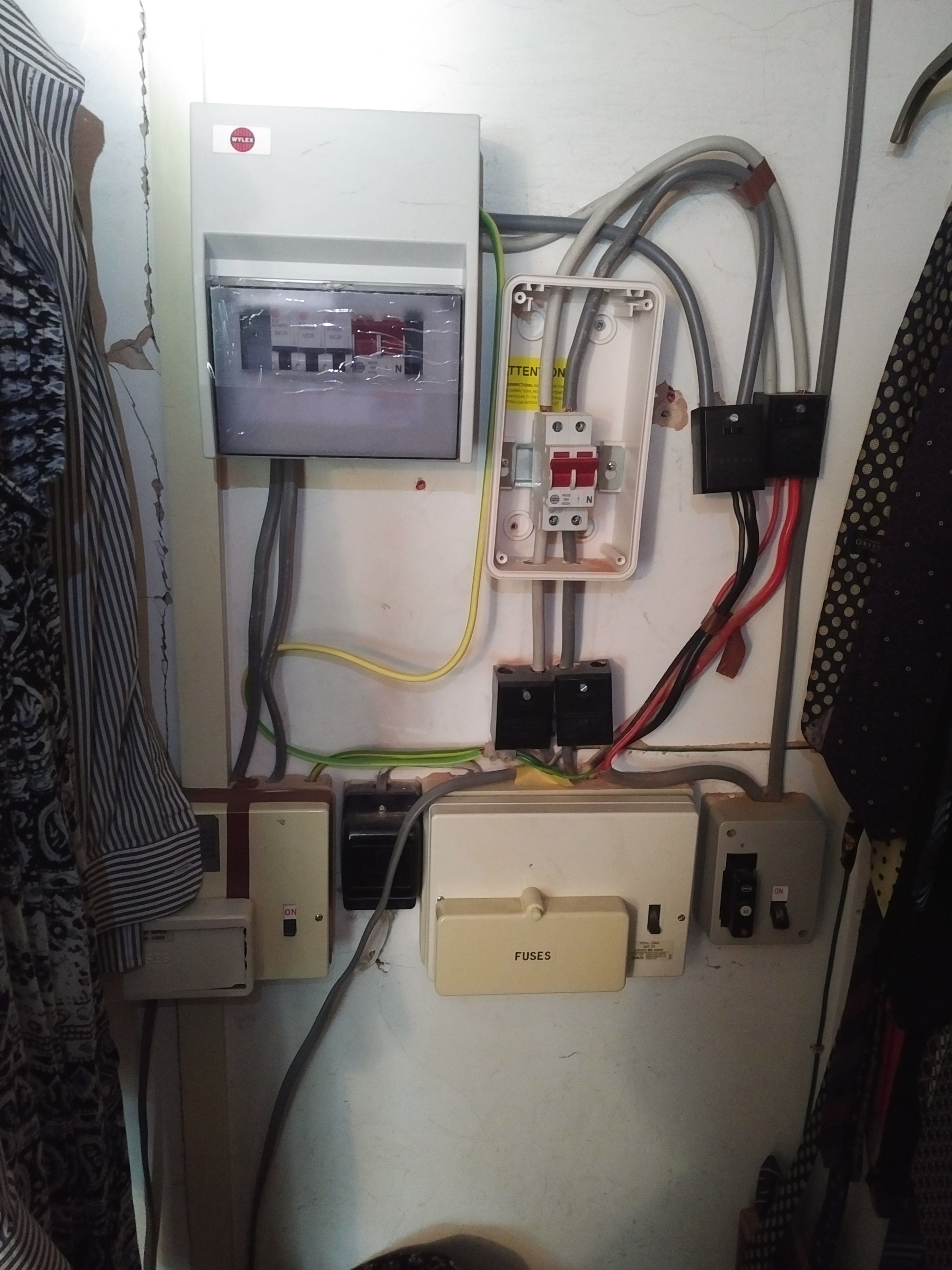

Here is a little peach I found today whilst attending a faulty immersion heater, work was done only 2 years ago by a big national company fitting new heaters! Nothing seemed to be fixed back properly and the lid fell off the isolator as I took the clothes out that were hiding it! :(
@Dustydazzler
Yes that is correct then they have been neccy blocked to the original cables to the heaters in the old wylex unit below, lovely job!
  • Agree
Reactions: SparkySy
Yes the other cable has been pulled back up in the trunking, why the other 2 couldn't have done the same as they all came down in it!
It was one of those jobs you wish you could unsee!!
Reactions: freddo and DPG
Been asked to sort this lot out at a well known uni. Data engineer got a shock pulling new cables in. All singles just in trunking. No lid.
Reactions: freddo
@ChrisElectrical88
The main tails used to come into the lower right hand old wylex, they have been pulled out and put in Henleys then to the new main switch, then out to more henley blocks and then to their respective final con units!:eek:
you want an EICR on this?????

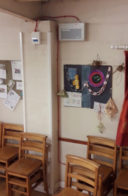

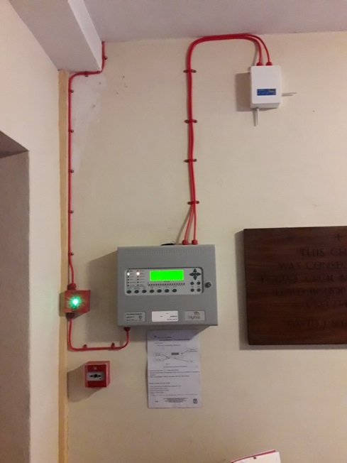

I installed the mains supply and isolator for a future fire alarm system. We recently went back to the location to see the fire alarm system had been fitted. Thank god the system was wireless. Don't know why I bothered measuring the fixings, neatly dressing the cable and making sure all the slots in the brass screws were at the same angle.
Seems they needed a repeater, cables lashed into the nearest socket circuit.
Geez... It’s really not hard is it? Some people give me the shits. Can’t take the time to adequately measure a few Double P clips.

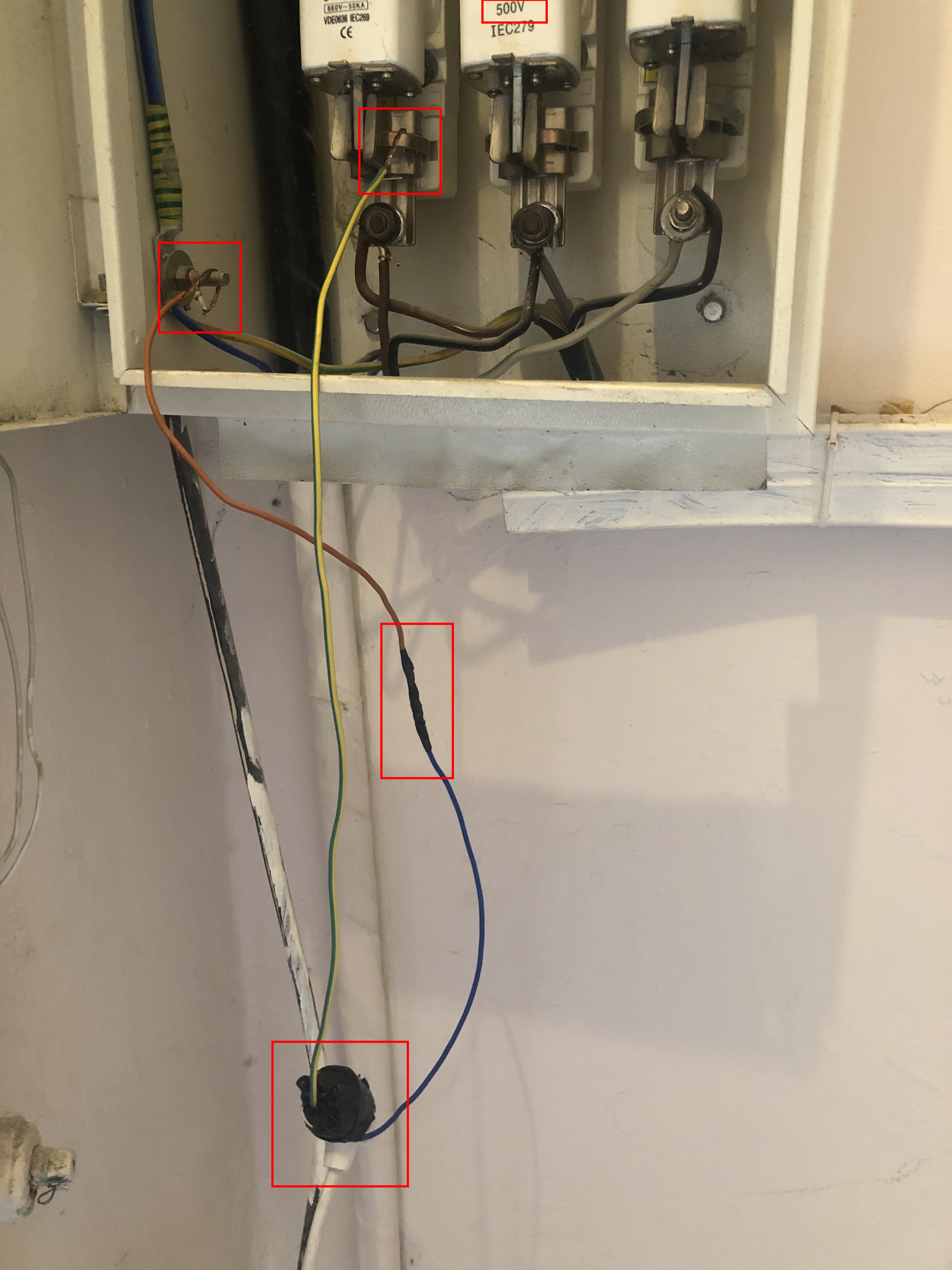

3ph service head in clients "storage cupboard" a few months ago... Yup 415 between those exposed conductors.
Its UKPN here so hopefully by the year 2055 they'll send someone out with a tube of superglue to "fix" it, in the meantime I've asked him to maybe not clout the cupboard contents of his metal handled mop, clothes airer etc etc etc into it

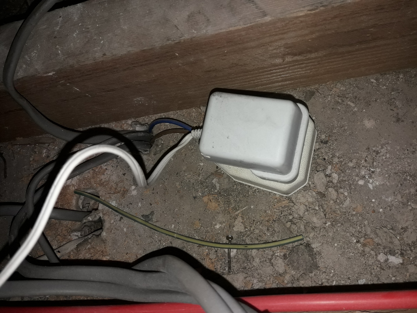

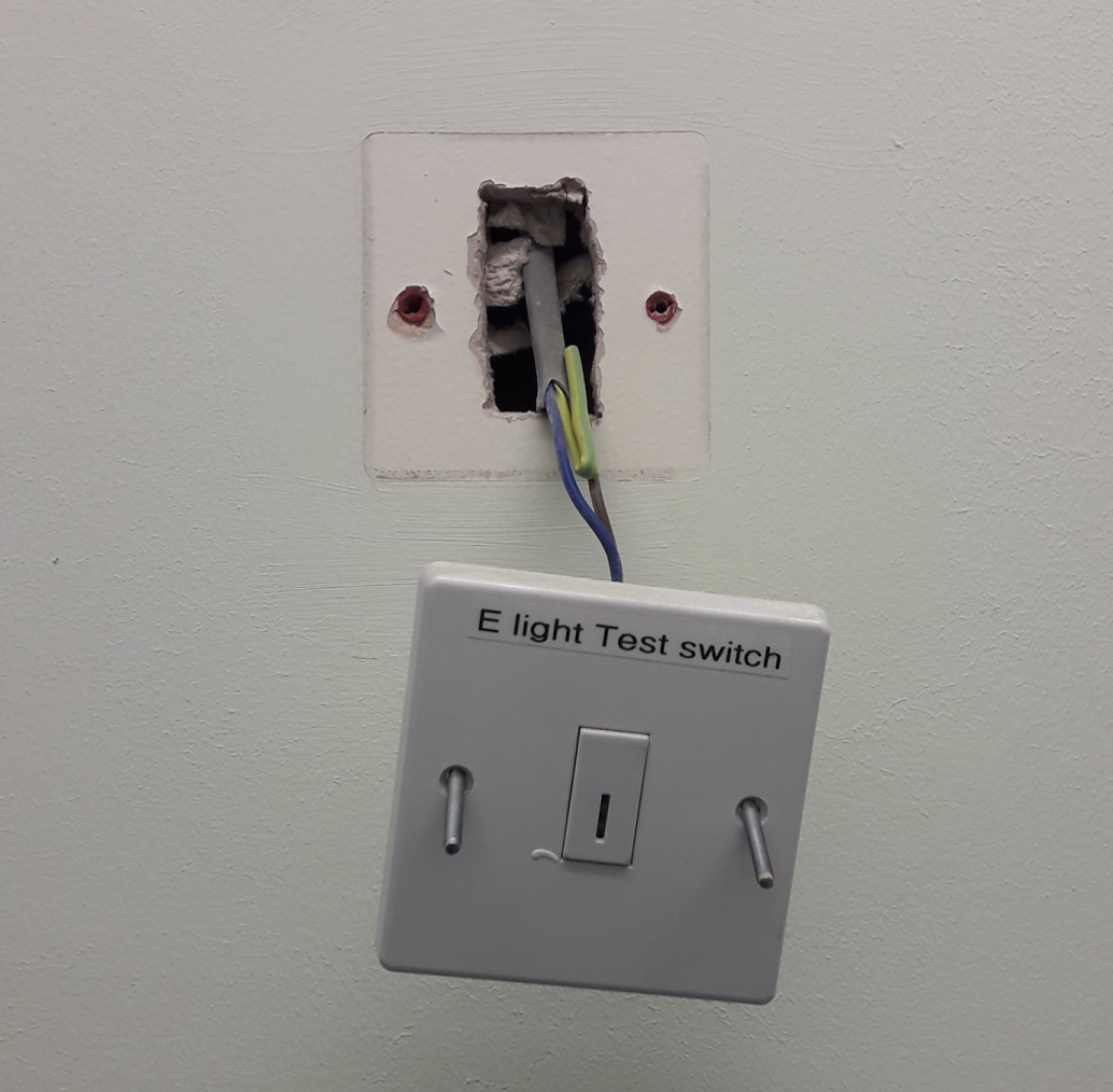

Found today and disconnected it! Book case will have a new 4mm back put in to hide the hole.
Creative wiring, the switch was on the landing, the trailing socket in the roofspace above feeding a CO alarm.

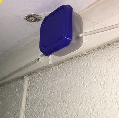

In a lovely old pump room [may share photos in another post if anyones interested as it's generally in excellent condition]. Lighting still wired in VIR singles. More recently someone has spliced in with harmonised singles to supply a row of T5 flourescents in an adjacent building...see the crushed and sweaty looking VIR neutrals below.
Reactions: freddo
Saw a load of old conduit wiring and thought oh no rubber. It turned out to be fabric covered plastic insulation. The telephone cables hacked into the box and the earth tapped off of the lid screw were less positive. Insulation and earth loop readings were excellent throughout the installation.
Bet you'd get a prize from Tupperware for sending in the picture :)

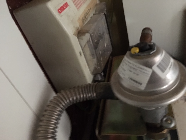

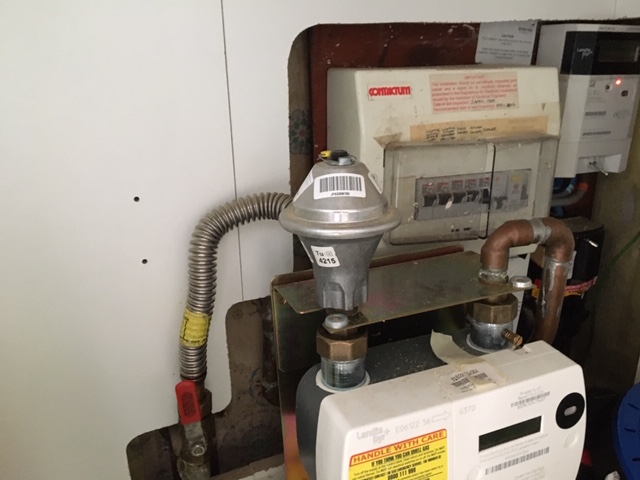

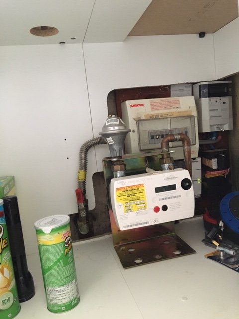

When you have to call a gas engineer to an electrical fault???
Do you reckon someone's done that as a DIY meter move? Can see the gas board doing that.
Reactions: freddo
Nope.
When I left today at about 3 o'clock, I told the householder to call British Gas and report it. It was changed a couple of years ago.
Got a call at 5.00.....they were on site changing it. What a response!
Only problem now is a L-E short on the shower circuit. That lot's low down in a kitchen corner unit :rolleyes:

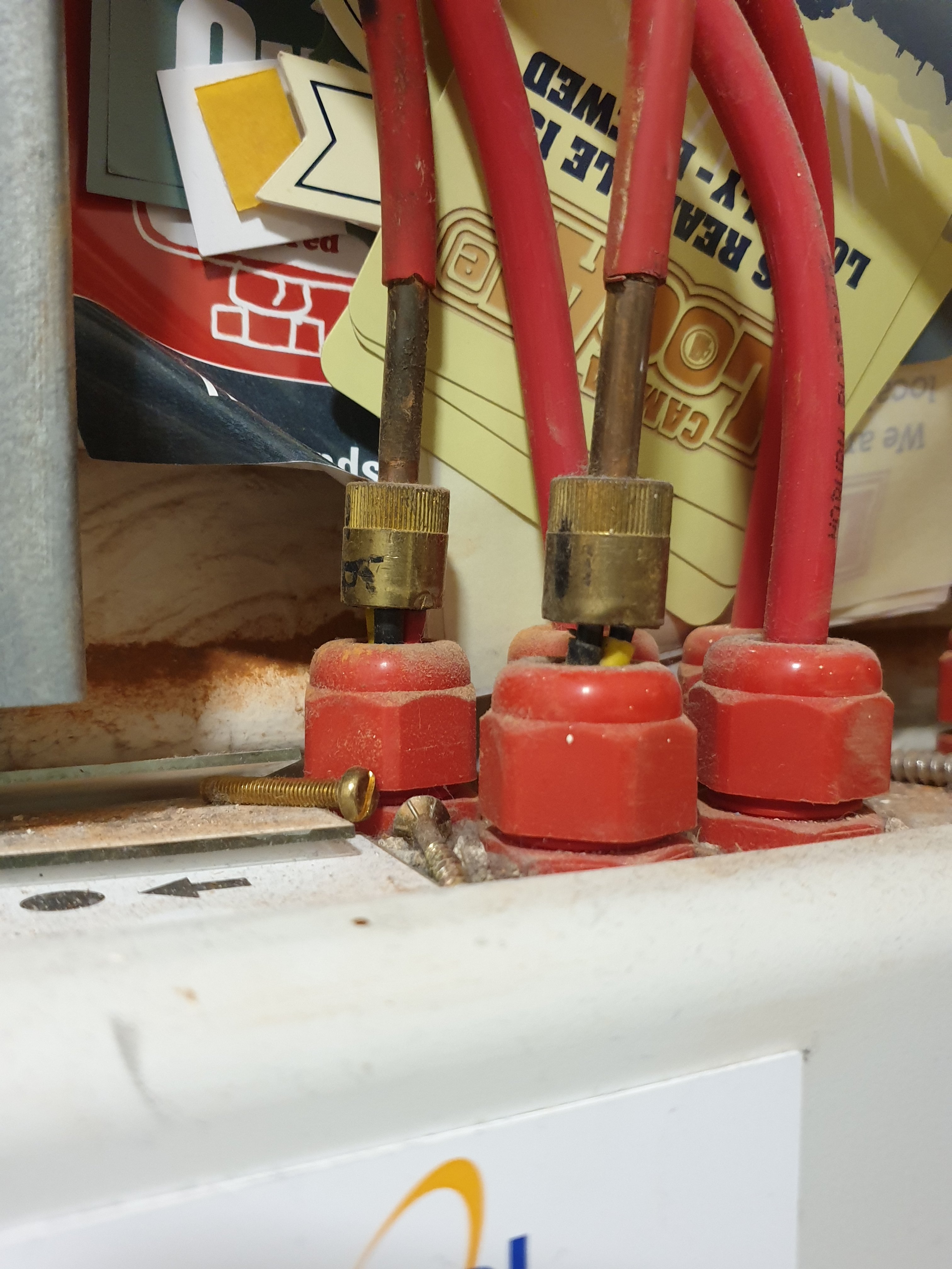

found today. new water meter installed. incomimg water is plastic. then copper from stop cock to meter. then plastic from meter to copper in house. united utilities installed bond from copper before meter to plastic after. fair to the guy who told customer it was pointless, but his boss says that's whathe has to do. .the mind boggles

Shocking really the levels of incompetence, he hasn't fitted the do not remove labels to the clamps.
Reactions: DPG
I should go careful there tel.
that looks like a witches broom in the corner, don't want to upset her and get turned into a frog!
So does that mean a C3 in an EICR for no "Provision of earthing / bonding labels at all appropriate locations (514.13.1)"?
