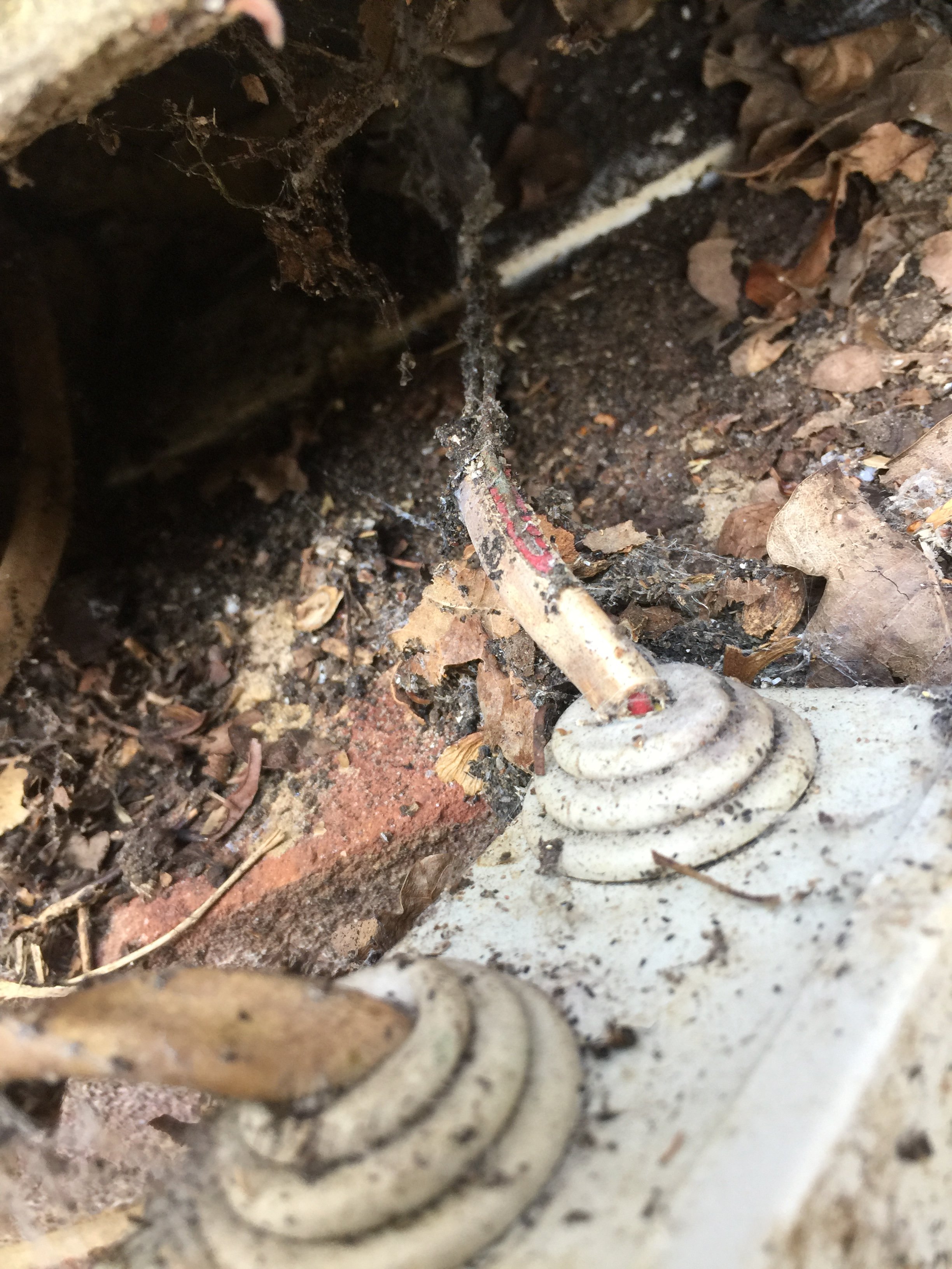

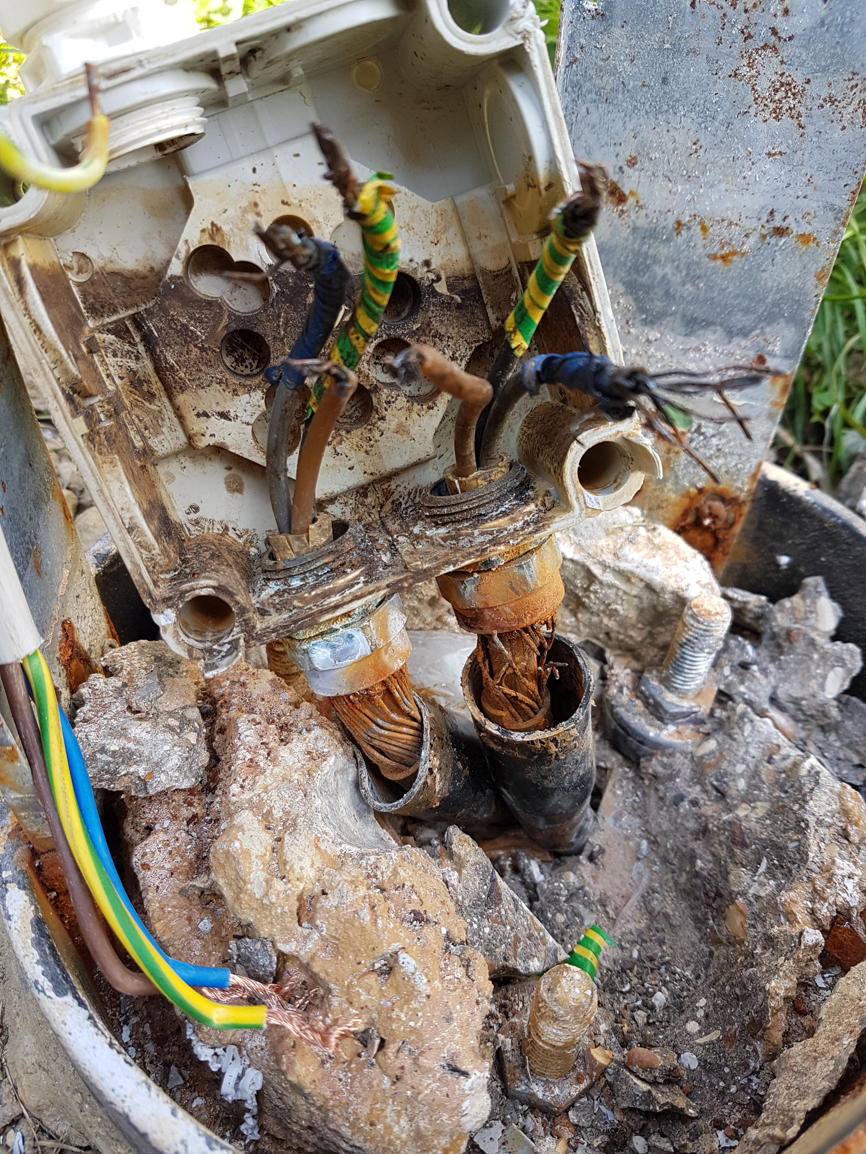

Spent most of the day reconnecting swa cables at lighting bollards as none of the armour has been earthed. Pretty straight forward cables plenty of length, the outer casings come off the bollards and the sun is out. Three to go then this, needless to say the circuit now has three less lights on it.
No chance. All the others are bone dry with lots of slack this one looks like it has been underwater.
time to get the kango out.
Reactions: brains-lans
Disconnected at previous bollard, client informed and on the road :)
Spent most of the day reconnecting swa cables at lighting bollards as none of the armour has been earthed. Pretty straight forward cables plenty of length, the outer casings come off the bollards and the sun is out. Three to go then this, needless to say the circuit now has three less lights on it.View attachment 51889
Same sort of problem...except this one was flattened and then run over umpteen times by drivers parking half on the grass. I was measuring for some sort of replacement until the client decided he didn't want a 20m trench digging for rewiring. Absolutely no spare length and solid through underlying concrete and in pvc tube. Isolated at previous bollard and left as.
Good example of why you should always use external glands outside, regardless of whether they are exposed to the elements or not.
Reactions: ashrow
That's the other odd thing all the others had outdoor glands on them.

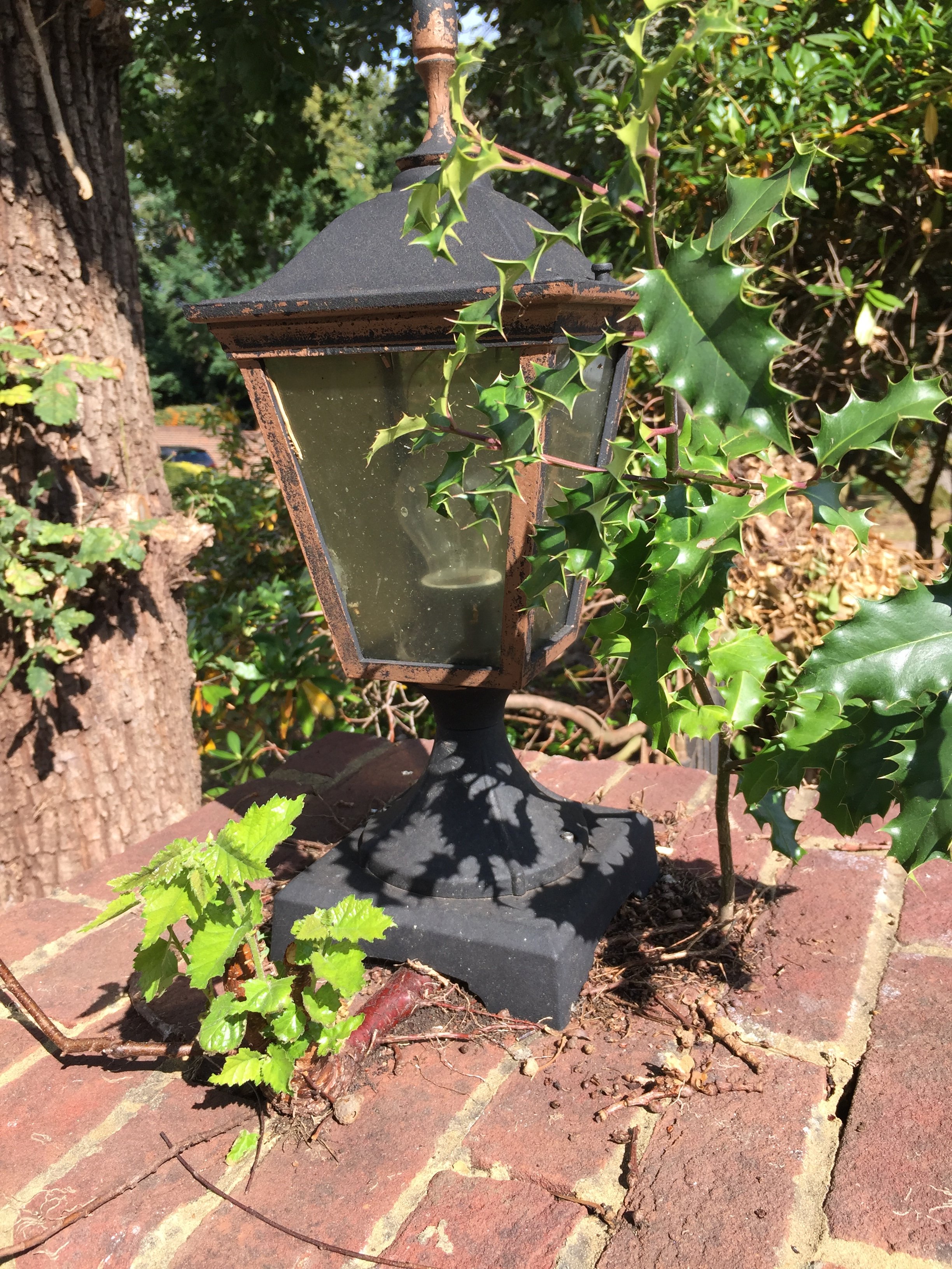

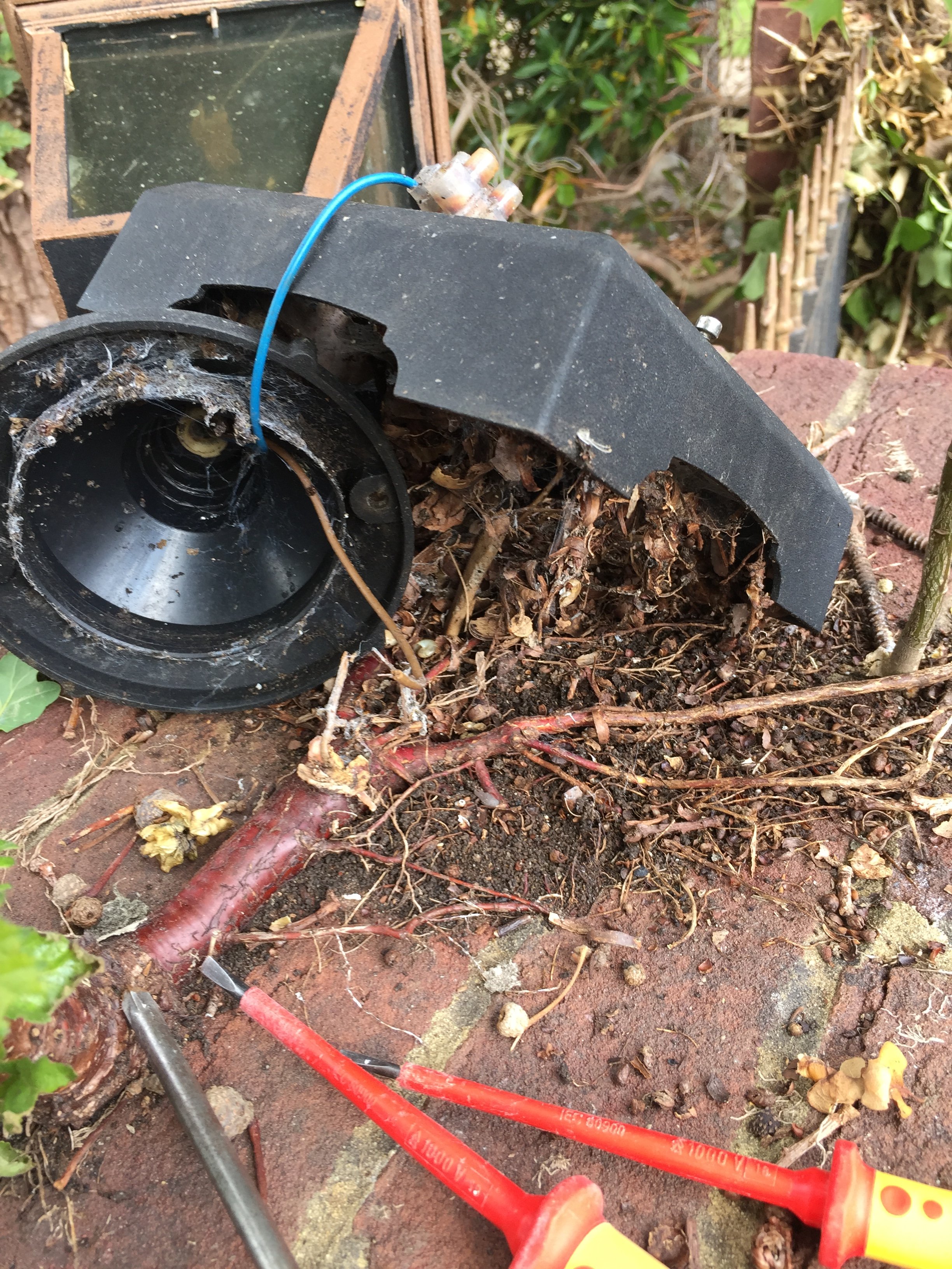

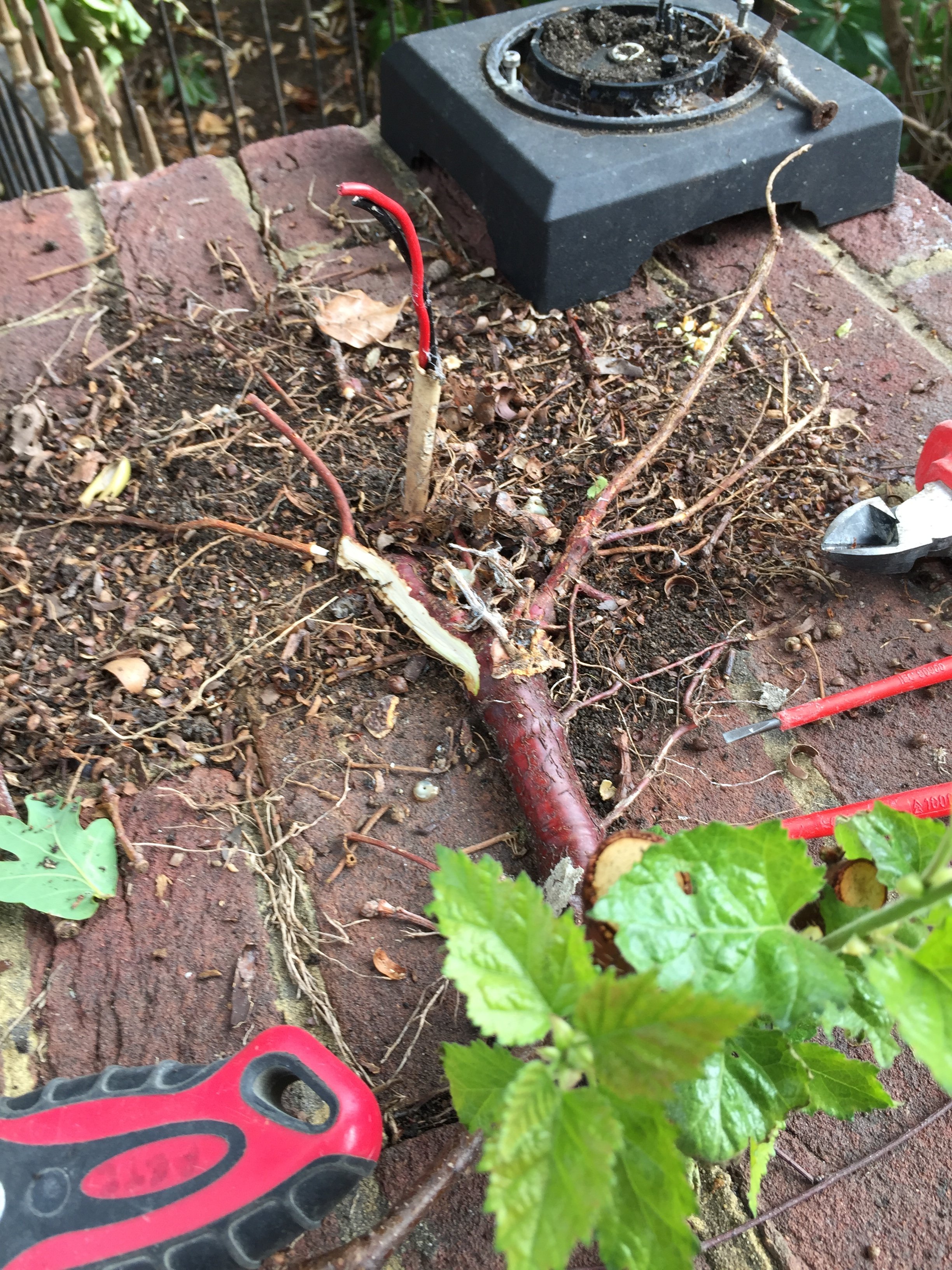

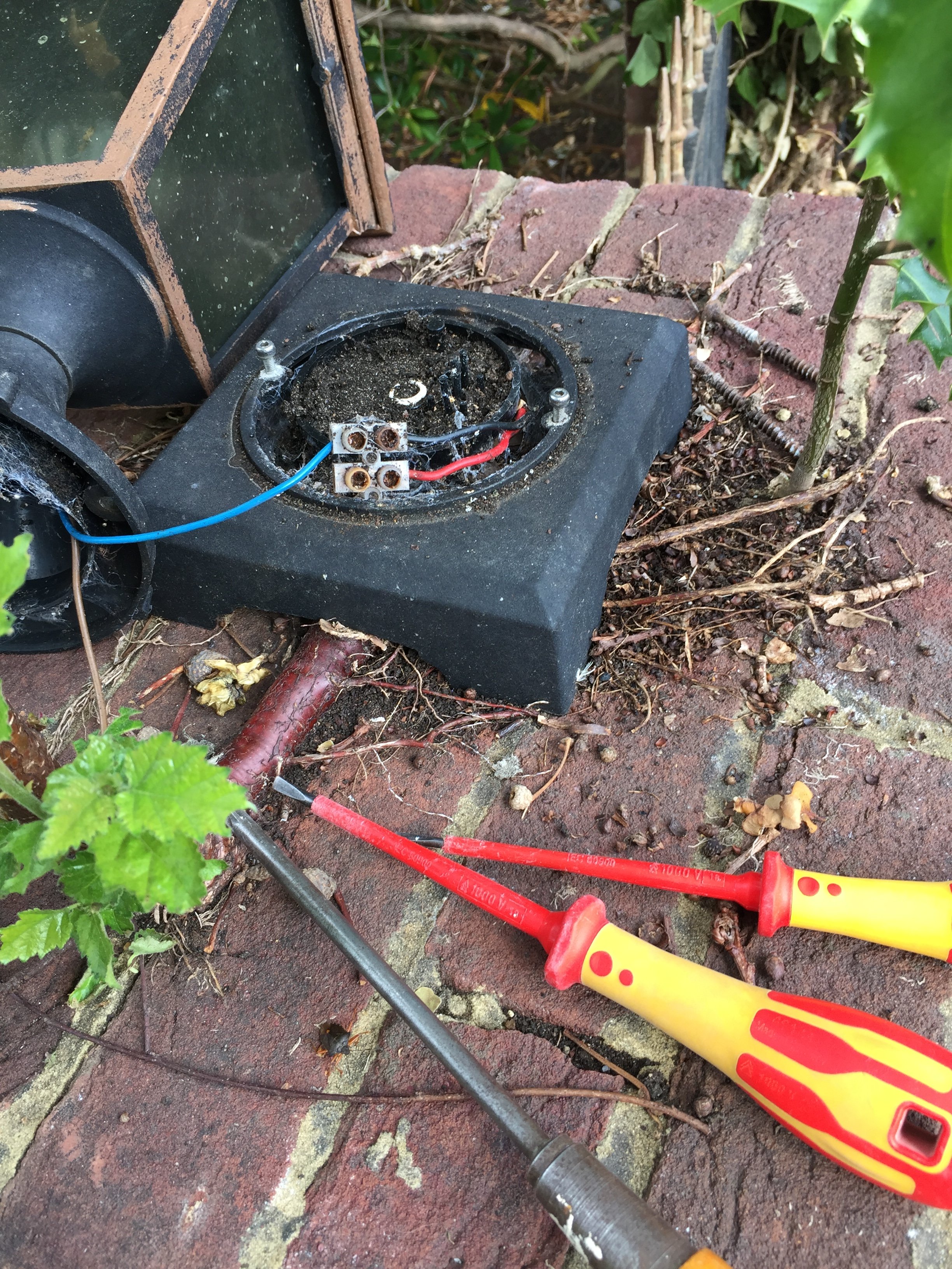

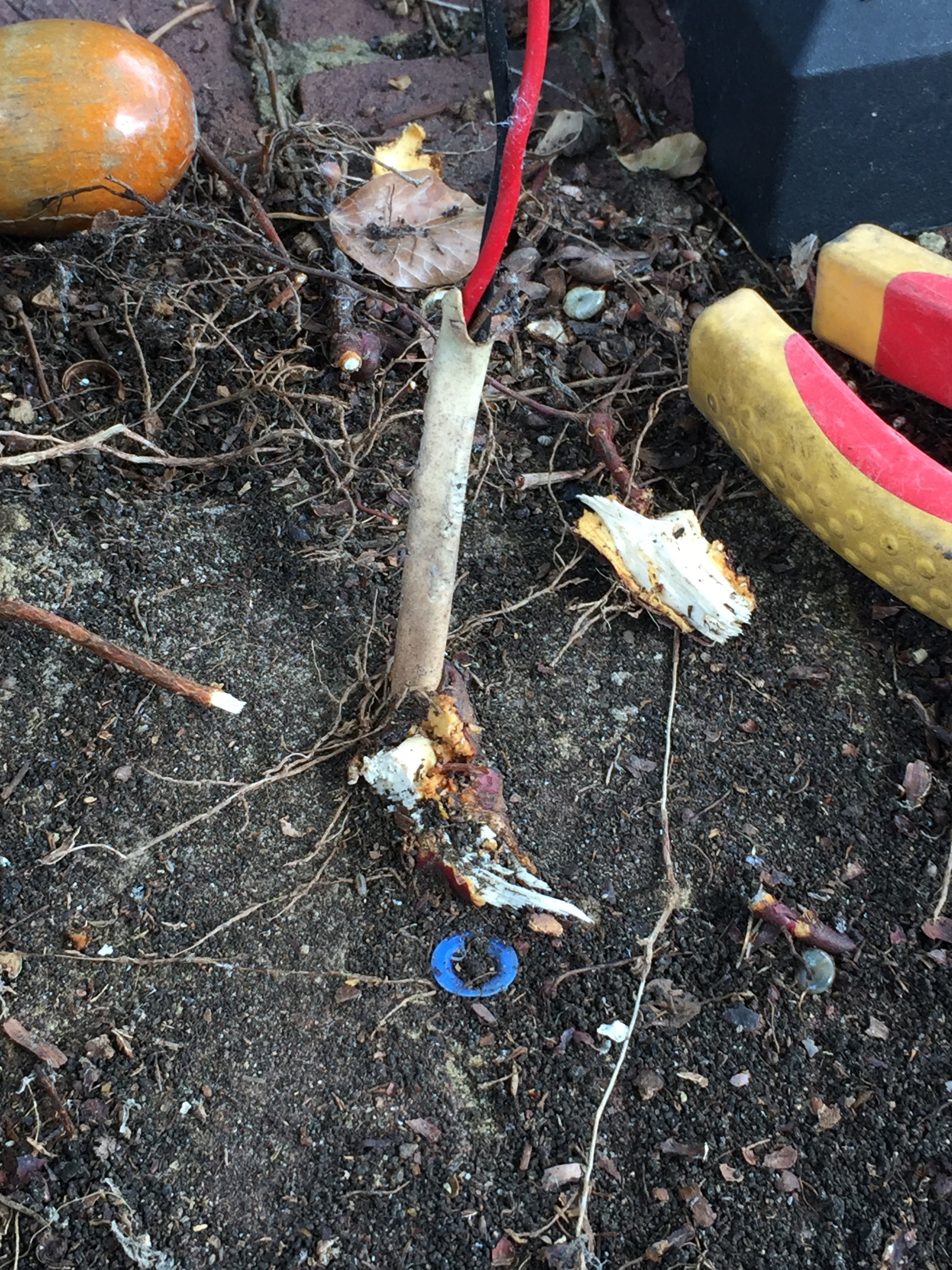

Customer with two brick pillars either side of drive entrance. Wants lights (which funnily enough don’t work) on top of each pillar replaced. There’s brick lights with junction boxes and T&E at the base of each pillar. See pic :rolleyes: I believe the main feed from the house is SWA so hoping with a bit of digging I can find the end but suspect the loop to the other pillar is just buried T&E so they may have two hopes of me sorting it without disturbing their nice block paved drive.
Customer with two brick pillars either side of drive entrance. Wants lights (which funnily enough don’t work) on top of each pillar replaced. There’s brick lights with junction boxes and T&E at the base of each pillar. See pic :rolleyes: I believe the main feed from the house is SWA so hoping with a bit of digging I can find the end but suspect the loop to the other pillar is just buried T&E so they may have two hopes of me sorting it without disturbing their nice block paved drive.View attachment 51900
Mean while at the top of the pillar we have a silver birch well and truly rooted into the light :rolleyes:

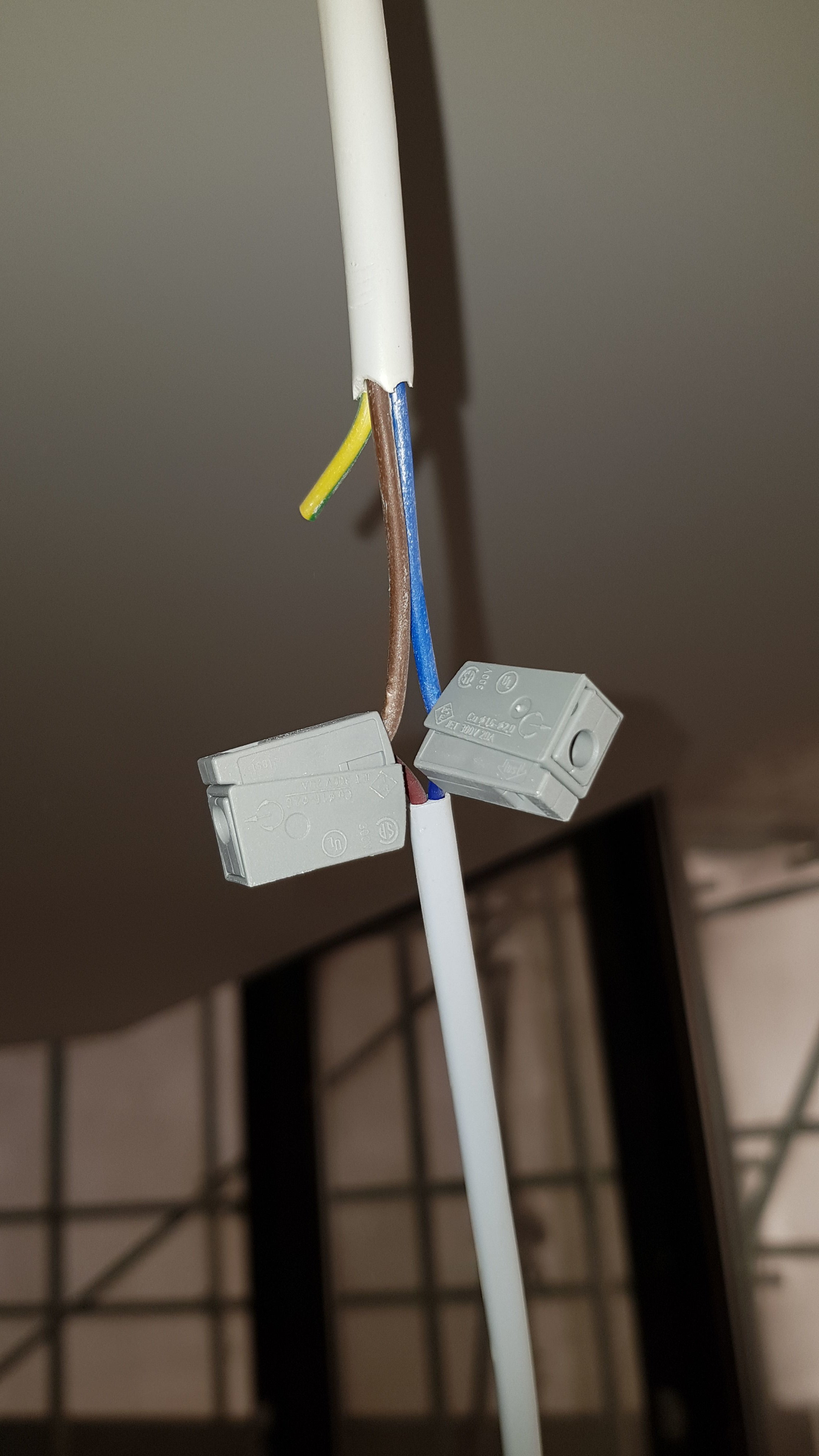

Every single floor installed with wagos without any form of enclosure. Just shoved into the ceiling. First time working in an commercial job site, alarmed at the practices. Not the fault of workmanship but the owner of the electrical company refusing to spend money on key things... even can't be bothered to buy brown sleaving for sw identification. Clearly some of the electricians failing to check connections if connections are tight and then powering sub mains board. This is how fires start.
Reactions: DPG and freddo
Unfortunately this is very typical penny pinching , I have done new builds where you would be handed box of Stuff to do a job.
No blue sleeve , no brown sleeve , no grommets , no nothing.
Just told don’t bother with any of that stuff and just chuck it in.
I have very often supplied my own grommets and sleeve just to feel better how I leave the job.

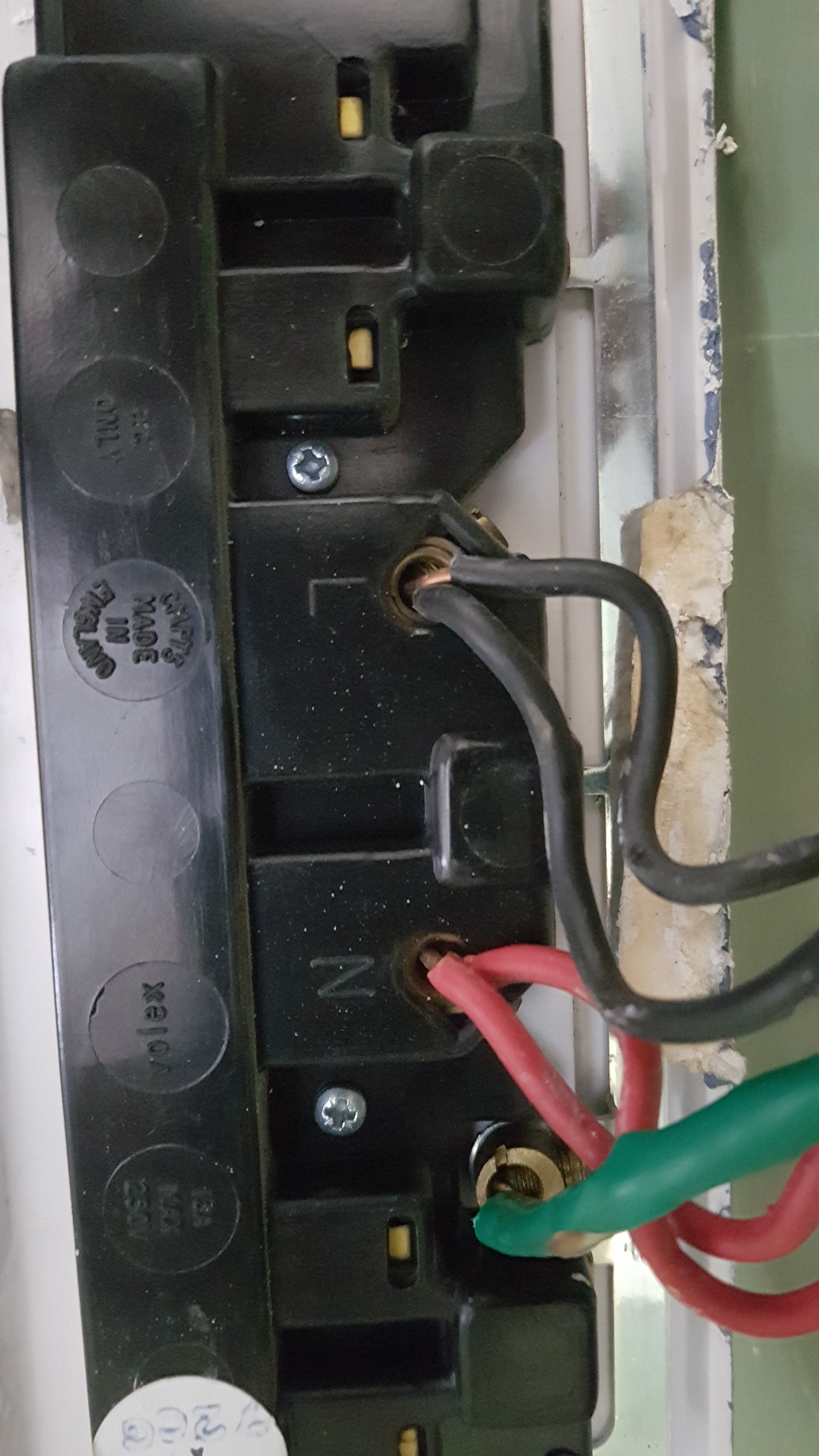

That last photo is a looped neutral, not a switchwire without brown sleeving. Or were you showing us a loose connection?
The cpc's should have been connected to the metal backbox. Why waste money on a bit of choc block connector when the box has one already there.
Reactions: DPG
These people are getting million pound contracts... awful practices. Need reporting tbh. I wouldn't want another glenfell incident on my conscience.
Showing loose connection. Board was live and signed off
Backbox not earthed either?
Is that a loop terminal for the neutrals ?
Well your common is your loop for lives.
Not seen those, though.
Looks like it's just being used as a one gang one way.
The back box should be earthed....just lazy.
The switch is poorly marked the Hager ones have an N terminal. I am pretty sure that Loop terminal is for the neutrals.

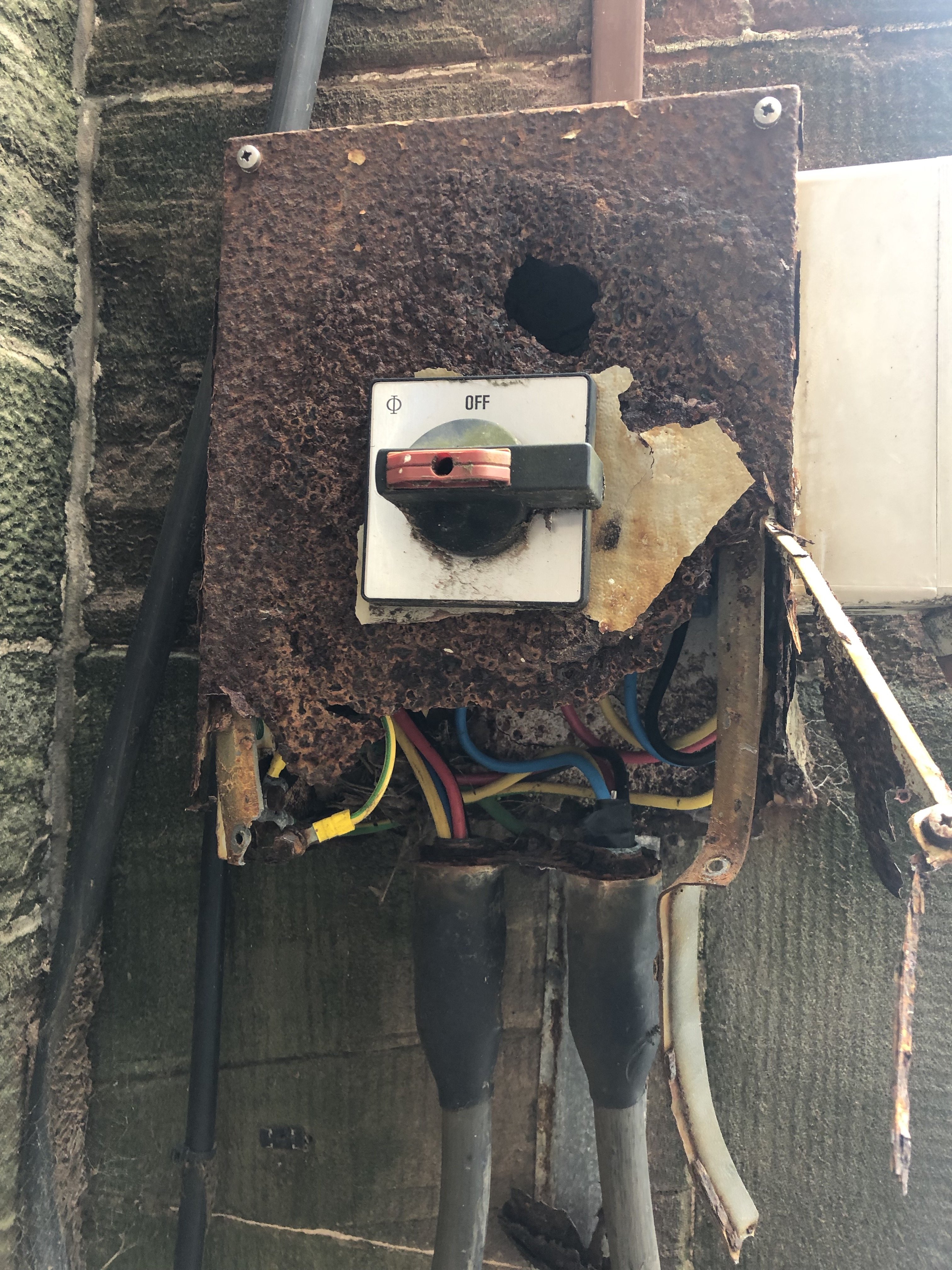

was still live, about 2.8M above the ground in a publicly accessible place.
Reactions: DPG
I think that is one of the best corrosion damage pics I have seen where everything is still in situ.
Reactions: DPG
Back in the UK’s pre EU days all Leyland and Dagenham made cars used to look like that after a couple of years. Good thing is there are probably legions of 70 pluses out there who are dab hands with wire brushes and fibreglass who could patch that up in no time. ;)
give it to Fuzz Townshend of car sos. he'll have a new box welded up and sprayed in 10 minutes.
