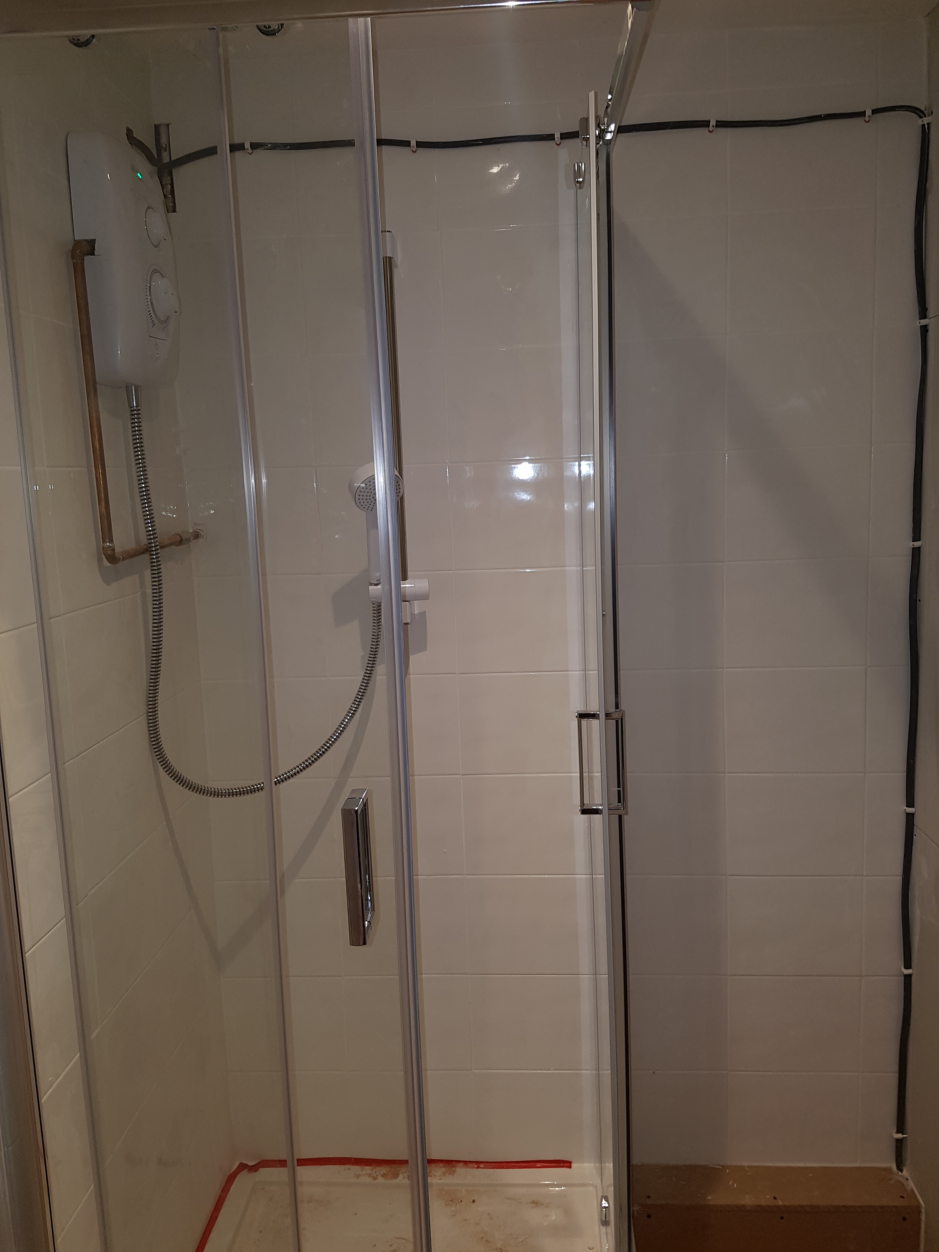

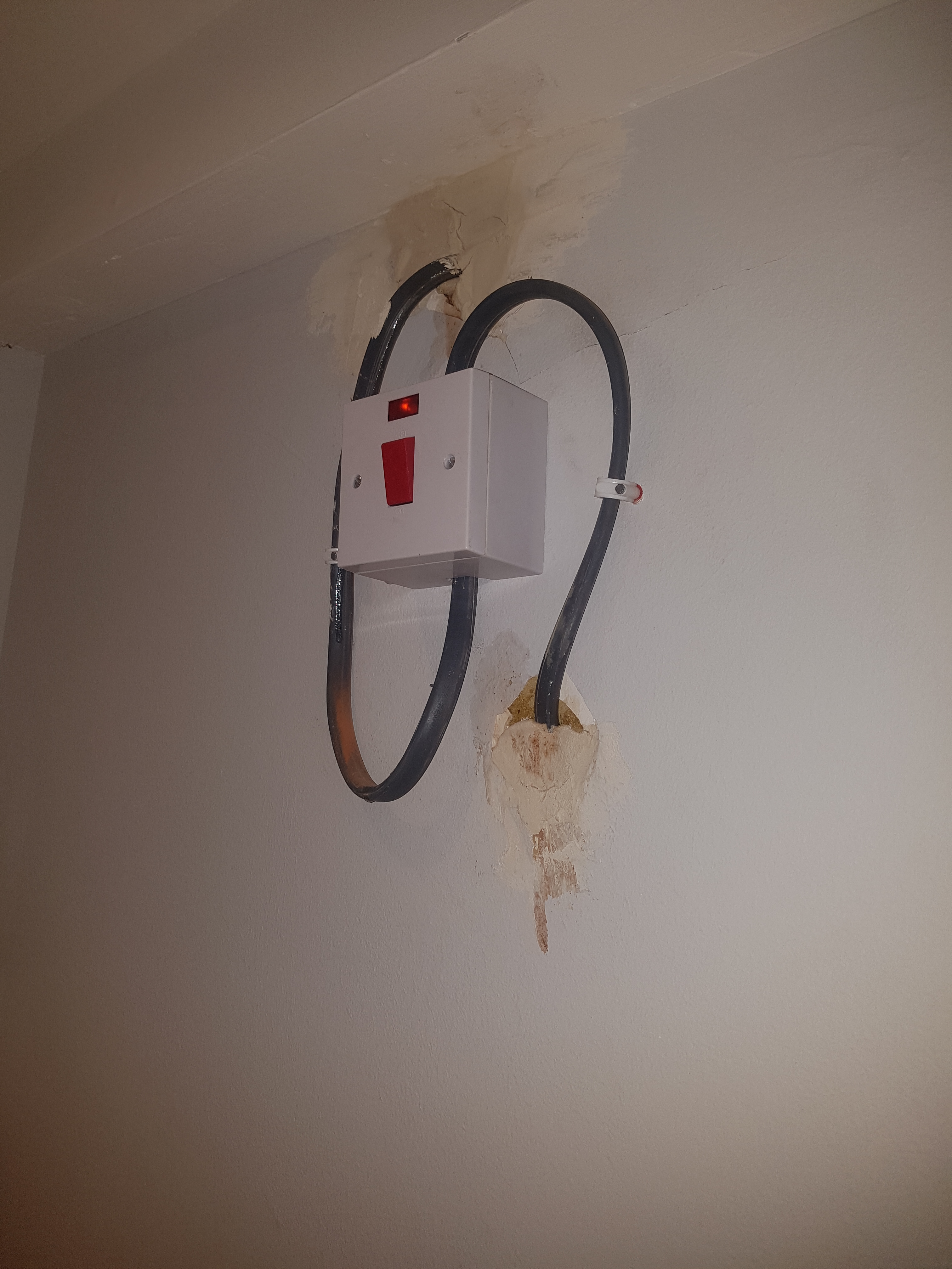

I like the way the wall is cut away to leave access to the isolator valve, right next to the shower unit.
Reactions: JOURNEYMAN and DPG
That t&e across and down the wall looks shocking as well. At least use a bit of mini trunking.
Also noted while I was there that the extract fan has no ducting to the exterior at all and instead vents through a 4 inch wall straight into the staff kitchenette via a shutter! There's a list of other electrical and building work horrors that the builder has done on behalf of the new tenants. It beggars belief what some people will accept and pay for.

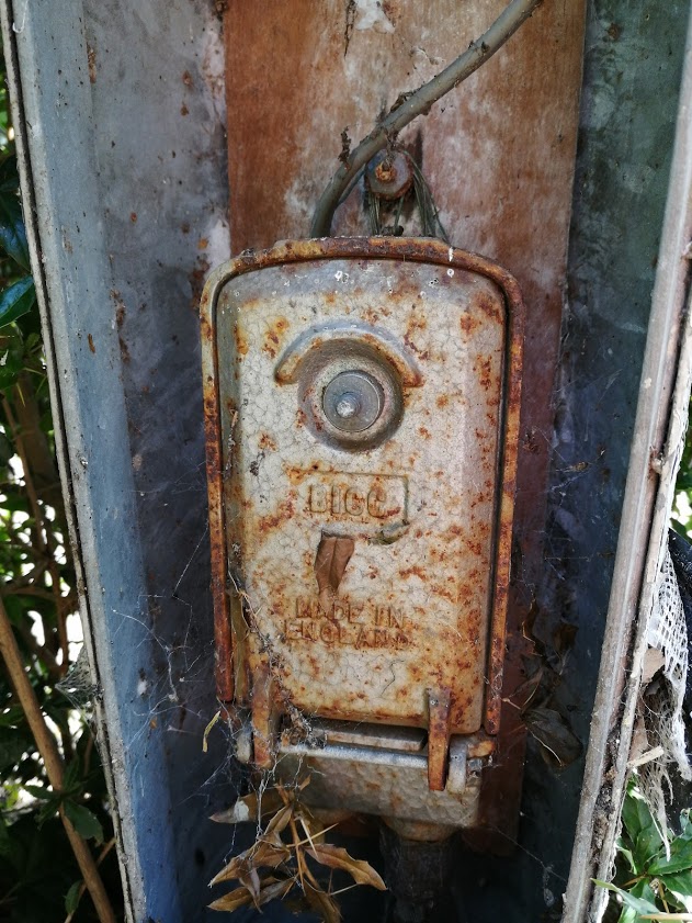

Another little one from me (but worth a mention). Old lamp column. BS1361 fuse clearly failed / lost an end cap at some point. Fuse wire wrapped around the old one.(NB I did replace with the correct fuse)
Reactions: freddo and DPG
That fuse must be an antique!
Reactions: DPG
If it didn't have the BI part it would be really old...
I imagine it's the original one! Cutout was BICC as is all the cable, all installed on 1963. Remains of that antique fuse is retained with my small collection of "antique bits"
Reactions: freddo
I've got to go back and recommision it tomorrow - I'll take a picture of the cutout.

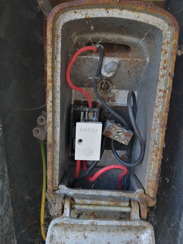

Went back to said lamp post today.
Also decided to look in the next one along. Not sure why and sort of wish I hadn't :confused:
Creative use of that MK fuse holder.

I have probably got in stock a replacement fuse carrier for that.
send me the dimensions and I will check.
will cost you a beer to cover the postage.
Will message mate - appreciated
Just big enough to get two 1.0mm cables through.
