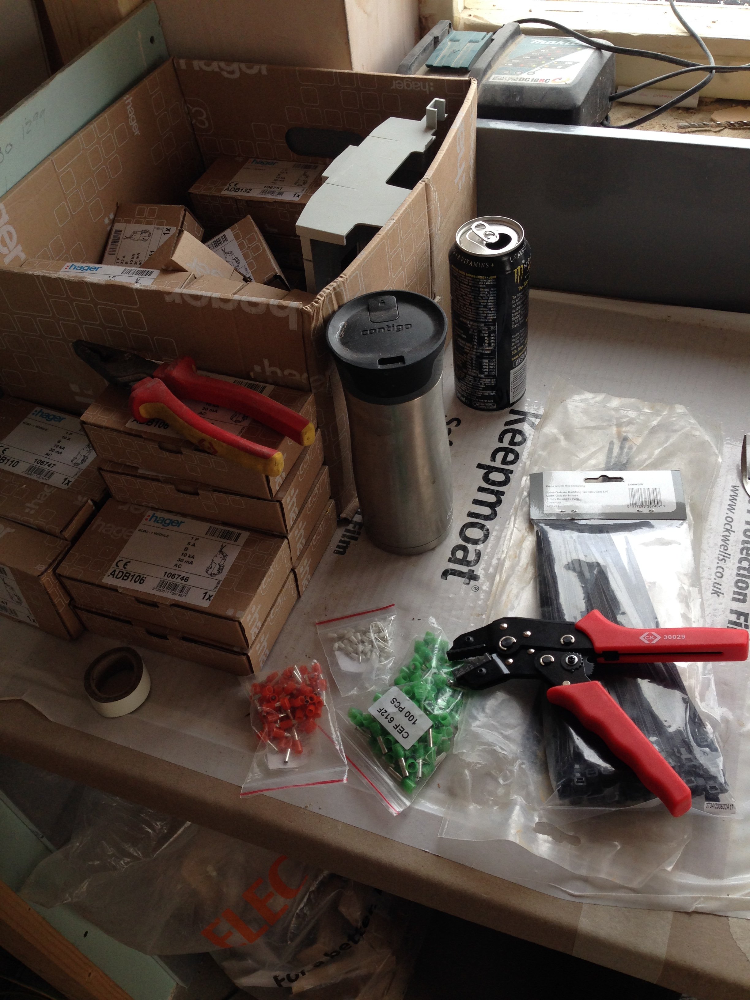

I cut and ferrule them...I'm doing a 3phase board today.
I use plain uninsulated ferrules in plugs and other accessories when building equipment in the workshop, but I don't lose any sleep if it's not convenient to do so out and about, as most plugs make a sound connection if the wire is suitably prepared. Some connectors like good quality IECs have conductor protection under the screw anyway and don't need ferrules at all. I first started ferruling in plugs after I saw sparks doing it in Germany in about 1989 when I was on a work experience exchange from school.
Re. RCBO FE flyleads I keep blue 0.75 and white 0.5mm² ferrules in the kit as standard.

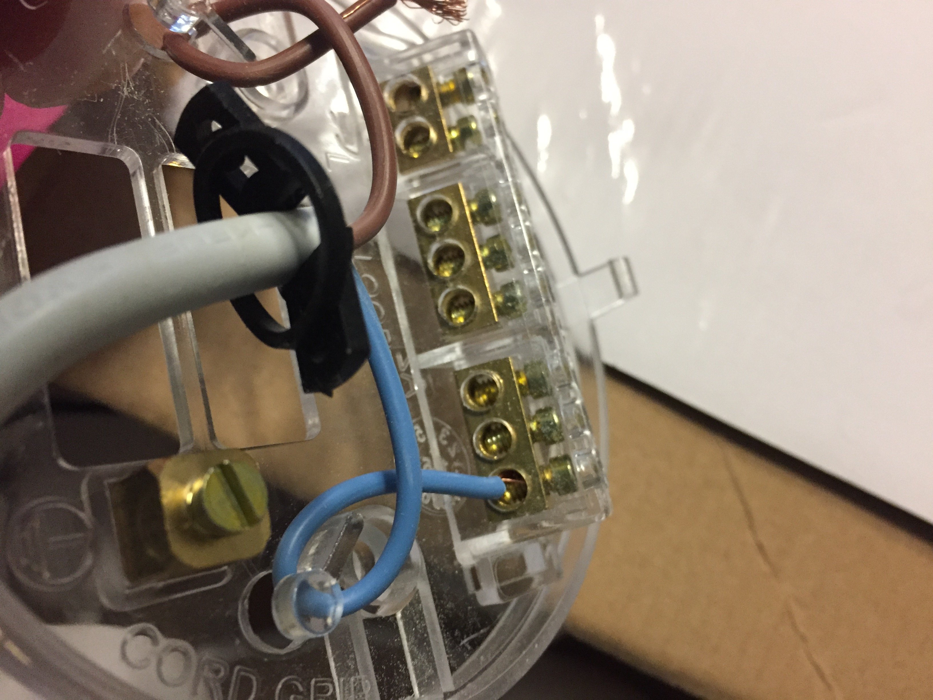

I can upload deta pendant if you like?
But I assure you the flex don't come crimped
Please do, is this a new pendant that hasn't been shortened or doesn't have specific terminations designed for fine-wire, if it is new and does not dress the fine-wire then it is probably in breach of their own BS regulations for such products... I am interested to see your upload as the last Deta I did was dressed cable ends but as they are uninsulated crimps you sometimes need to take them out to see the crimp.
Back on site tomorrow so I will do
And I use deta all the time
