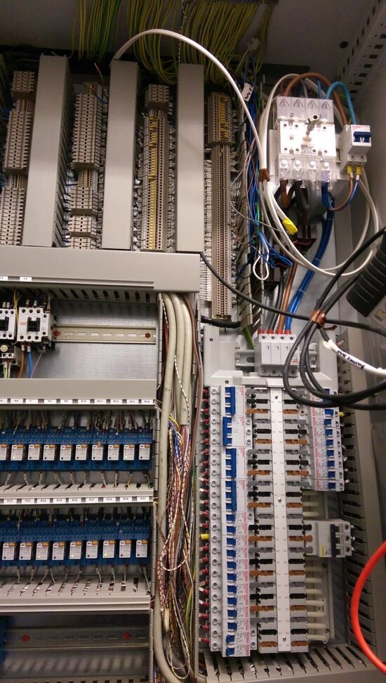

So I've done a full test of a primary school this week, I was handed Amtech Fastest loaded on a laptop which had all the cert data pre-loaded from someone else and I was asked to just test and fill in the blanks.
So a couple of things (bearing in mind the extent claimed 100%):
1 - Since when was it ok to 'tick' the R1&R2 having just carried out a Zs?
2 - Oh and regarding that Zs, don't look for the highest, or work out the furthest. Take it from the lowest ceiling.
3 - Since when was it acceptable to not even attempt to do IR?
4 - "Pump room? we don't go in here we just LIM it"
I've just completed a school for this company and have data they don't want because they have never had so much and don't need it.. or maybe know what it is?
I've measured current imbalances, taken thermal images and done power quality analysis on their BMS main control panels.
Oh and all the 'electrically competent person' observations I have made - that granted are not non-compliance's with BS 7671 but are non compliance's with BS 5266, The IET PAT CoP and BS 7909 to name a couple. They don't want to pass them to the customer either - probably because they don't understand them..
Basically I was given a week in the building so did everything I could in the time given. It was all tested by Thursday which left me with a day to go round double checking and carrying out inspections - but the 'QS' has chosen to change my IR readings back to LIM and my measured values of R1&R2 to 'ticks'..
What a douche!
Oh and Amtech Fastest software? What a restricting auto adjusting load of crap.
If testing companies are going to treat the testing work this way it's going to end up like PAT.
Oh, and one of the observations I made.. see if you can spot it.

Observations on the panel, random loose white cable taped over?
Change of phase sequence from isolator?
I would guess but hard to tell from a photo.. are those data cables thus where they are bared back they are not rated to the cables they share in the same trunking?
Also insulating stabs on the empty outputs seem to be for decoration as there are isolating switches for the busbar stabs.
Last be not least, the whole MCB section is upside down, now that might cause the electic to flow the wrong way :mellow:...unless your photo is inverted?
I see two orphans that are not connected to anything at the top of the board.

Is that panel CE marked?
Not sure what that SP+N is doing at the top right. There's no main MCB and it looks like a t/pole isolator toward the bottom right.
Triple pole breaker in wrong position involving 2ways.....G, Br, Bl ?....and Merlin
Is that a Merlin MCB on Neutral?
I work for a testing company and are constantly out priced by companies who promise the world and fail to deliver, the client is generally none the wiser. Is it that the distribution board is full of non compatible protective devices.
An "oh dear" moment just now when looking at the pic. I am seeing data cables in here - these go out to the PCs the kids touch - please someone tell me I'm wrong? Not to mention the IT tech who bumbles about with these cables from time to time. I bet they've no idea about live working or how to make safe. I hope I am wrong :)

Give them a practical on inspection. Print Widdlers picture shown above and tell them to identify all 12 faults. That should teach them some manners!
