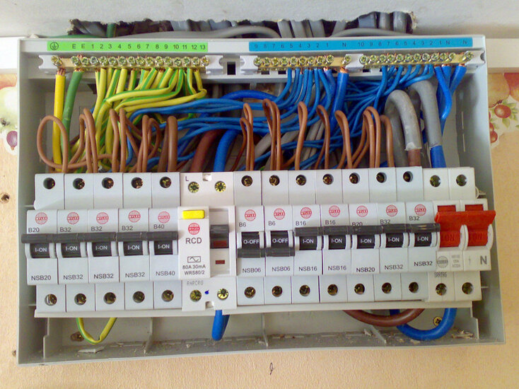

On closer inspection, why on earth would one show a picture of a poorly dressed, 16th edition 12 way board with doubled up lighting circuits, an iffy looking terminal 4 neutral connection and debris left in the bottom of the enclosure.
It may look acceptable to other trades/plumbers and joe public but to me it just looks a mess.
