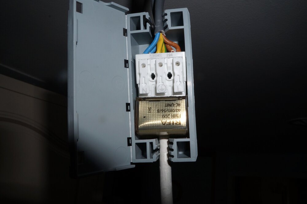

Dimmers can cause all sorts of interference problems because of their appalling power factor, high speed switching and harmonics. I know it's easier said than done but try to stick to known compatible dimmers on the same lighting final circuit. If you've got issues where one dimmer is causing flickering in another dimmer on the same circuit you could try stealing a suppression filter out of an old washing machine or microwave an install it somewhere near the dimmer that's suffering interference.

Either keep trying for compatible devices, or add suppression.
The easiest is small capacitors local to the devices - you could also try one or two capacitors from fluorescent fittings, but this isn't anything like as effective.
You can buy expensive suppression modules - but they are just a simple capacitors of between 0.22uF and 0.01uF rated for 350Vac wrapped up in a fancy package.
One small one at each device is better than one big one somewhere on the lighting circuit.

The ones I linked too are an easy fit into a Wago lighting box as they are the exact width of the box and the single cores are spaced at the width of a Wago lighting connector, I will pull one down from the ceiling later and post a pic.

Shunting the line and neutral locally with capacitors diverts the high-order harmonics and switching noise away from the circuit conductors. The currents still flow through the dimmers but not through the loop impedance / cable resistance common to the other lights, so it doesn't create the same level of voltage waveform distortion, so has less disturbing effect on other dimmers.
