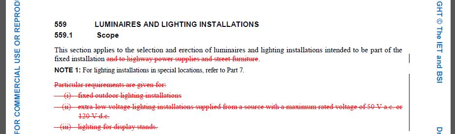

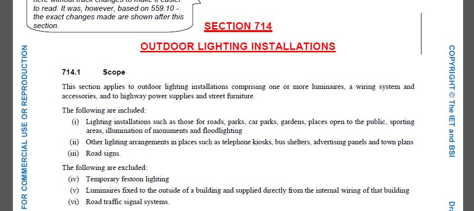

So according to the latest edition of professional electrician, stroma have said that outside lighting is notifiable because it now resides in chapter 7 of the regs.
As far as I can see in part p, they explicitely state that the building regs only recognise bathrooms and shower rooms as special locations requiring notification.
So am I missing something here or are stroma talking out their rears?
I brought this up on my recent Stroma assessment. I was told this same information and I queried it stating that the part P definition of special location differs from that of BS7671.
He didn't want to go into it at the time but said he would look at the wording of part P when back at the office.
I think it is flawed advice.

Outside lights are notifiable
