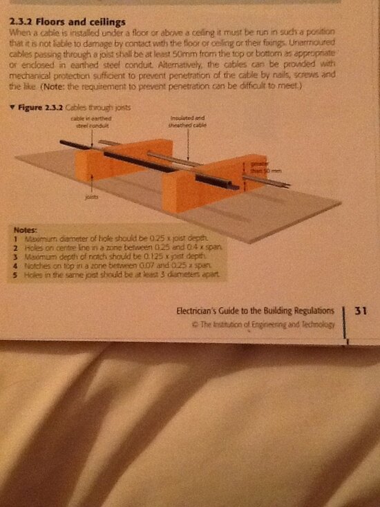

I think that falls under 'part A' so that would be a good place to look for the info
Electricians guide to the building regs.

Hey folks,
Whole system is using conduit wire ... but no conduit. Live loop to switches and neutral loop to roses.
No movement in old wires so cannot use them mostly to pull new cables through.
Was going to channel under joists but decided to cut long thin rectangles out of the ceilings for the runs where I need to cross the joists and drill through centres of joists as it is fairly easy then to cut new pieces of plaster board to make good.
One thing to mention ... got one of those wood beaver drill bits to drill the joists and I am gobsmacked at how good it is, it is awesome.
Also making small rectangle openings in ceilings where old switch cables leave walls and enter ceiling voids and for those I can mostly use the old cable to pull the new switch runs through.
Job not as hard as I initially thought so fingers crossed.
Thanks for all your help and advice, you've been a massive help.
