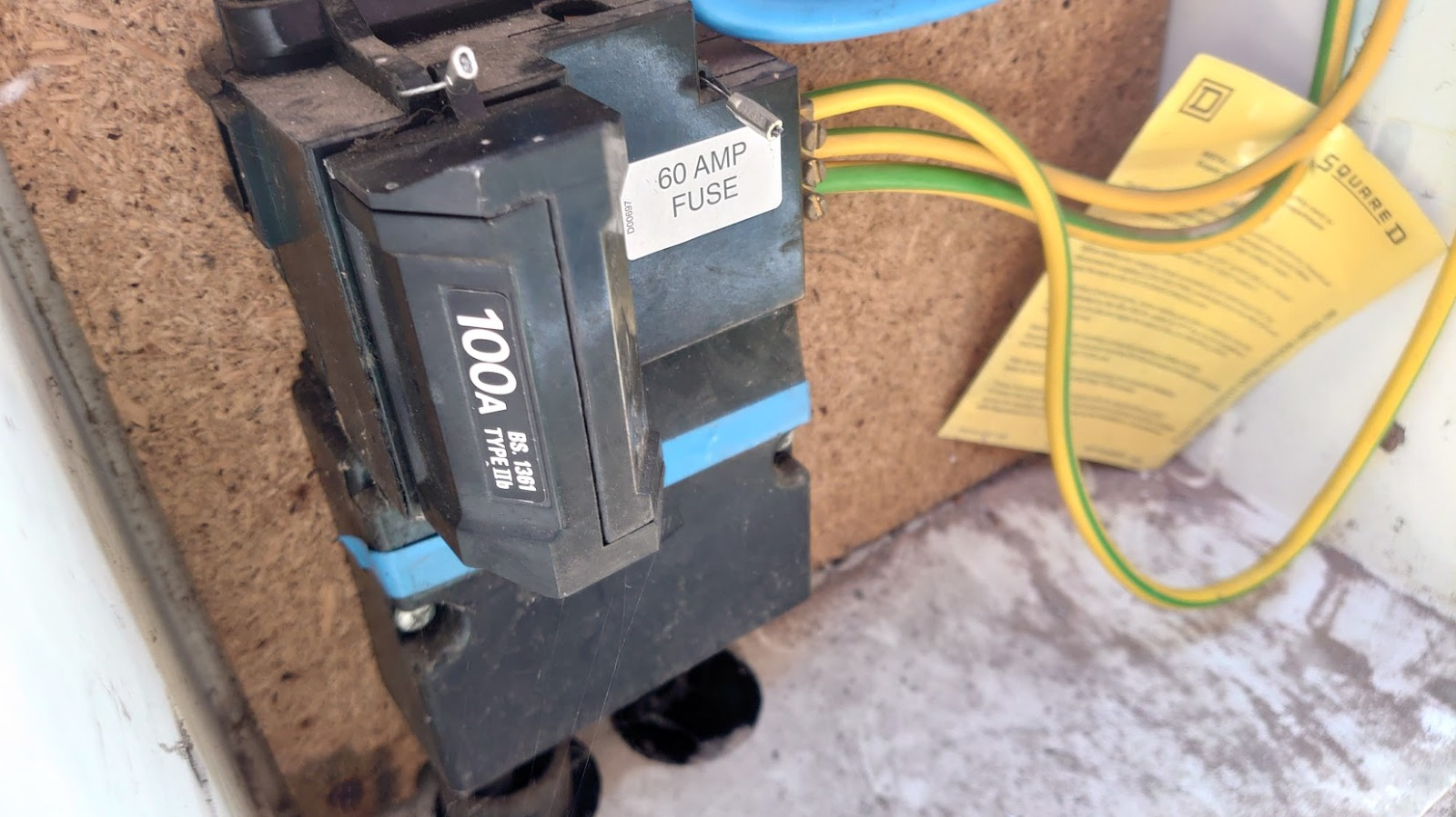

A relative in West Cheshire sent me this pic. He is contemplating having an EV charger and other electrical appliances fitted. He asked me if he has a 60A or 100A supply. From this pic, it looks like a 100A supply with 60A fuse fitted for some reason. He wants it to be 100A. Any ideas?

We can only go on the same info as you, and so I would agree - a 100A carrier with 60A fuse.
Get him to contact supplier to see if they can upgrade it
What a pity we’re (generally) not allowed to pull the fuse, open up the carrier and have a look.
I know electricians are supermen among tradespeople, but x ray vision is beyond even me.
Sometimes that pesky little fuse fairy helps us out…👀
I know DNOs in some areas were putting in 60A main fuses in 100A supplies. I assume to discourage excessive use as their system overall cannot cope. Like some here, I assume this is a 100A supply with a 60A fuse. So a 100A fuse would not harm anything.
If the DNO a number of years back did downgrade the fuse, then it would be matter of slotting a 100A fuse back in. Even if the DNO does not know. How naughty.
If the house was orginally 100A, then they downgraded it to 60A, then they have to upgrade at their expense?
I’m sure you/your relative are aware already, but if EV is the motivation then there are some pretty clever chargers these days that monitor the demand and only charge when the cooker/shower are not in use.
So all is not lost with a 60 amp supply. I still have 60A at my house.

Cut out might be rated to 100A, but if a 60A fuse is fitted it's a 60A supply.
In other news, I'd suggest not going down the route you seem to be headed - especially after posting images that identify the property in question to any DNO employees who might stumble upon this thread.
I’m never good at identifying earthing conductor sizes from photos - but they all look similar making me wonder if they are all 10mm sq mm?

No, it wasn't originally a 100A supply. It's just the maximum rating of the cut out is 100A. Just like the max rating of an isolator for example.

Every 60A supply I have seen had 16mm cable from the fuse to meter. This may have been an exception though.
He said he thinks that 60A label was put on when he went over to a smart meter. If you look at the seal it looks newish, which may indicate the fuse was downrate, being initially a 100A fuse.

They may well have put a label on to identify the fuse. They probably didn't change the fuse though.
Am I right in saying that some meters are only rated to 80A, so can’t have a 100A fuse.
Can’t tell from your photo.
Yes, although I think most if not all "smart" ones are 100A
My home "traditional" meter is 80A.
I looked at that and it looks like it is from the E470 series, which is 100A, but it isn't clear enough to see properly.
Ultimately the DNO is the only one to indicate what the max rating is, the size of the fuse carrier, cable, meter etc only gives a possible upper limit.
The capacity of the network, could also be a limit.
DNOs and suppliers/meter fitters standardise on ratings of kit, they stock only 100A carriers (to reduce stock levels), many now only use 25mm^2 so the meter fitters don't have to learn to size cables.
That intake has a limit of 60A due to the fuse, changing the fuse doesn't necessarily mean the capacity can be increased, it may be, but it may be it means something is unprotected against overload.

I think the newish looking seal is the give away. It would have been put there when the meter was changed. Nevertheless we do not know, until the fuse is looked at, and the incoming cable assessed of being capable of supplying 100A.

Absolutely. No way of knowing. Has your friend contacted the supplier yet?

It doesn't matter if the incoming cable is capable of 100A, it still doesn't mean that supply has a capacity of 100A.
DNOs apply diversity just as electricians do, the capacity of the distribution transformer determines how many supplies may be connected at 60A, upping some customers to 100A may well mean a larger transformer is required.
One cannot assume that because a certain size cable, fuse carrier, meter etc has been fitted that there is capacity.
I doubt the fuse has been changed, the meter fitter is likely to have removed the fuse, fitted meter, refited the fuse, applied new seals, and applied a label showing the fuse size.

Not yet, he is assessing what appliances he needs. He wanted a high kW five ring induction hob which draws a lot of amps. I told him to go for an Induction hob that runs off a 13A plug if he can only have 60A. He may have to use a Garo priority box to cut out the heating and/or EV charger while a shower is being used, etc. If he had 100A he would have no worries, now he may have to prepare to work around the limits of a 60A supply.

Something tells me he was downgraded - just a hunch. If he was dowgarded to a 60A fuse, which does happen, you will find the DNO would have marked out streets or an area then put 60A in the lot. Or ensured 60A was inserted when a smart meter was fitted, as take up may be enough to make a difference in downgrading in an area. They do it by stealth. This maybe in preparartion for the EV charger onslaught, followed by elimination of gas. Hopefully in the interim they put in enough electrical capacity.

I had the DNO out once to pull a old fuse, tails were 16mm between cutout and meter, from meter to CU 25mm, it had a 100A fuse, due to tails being 16mm he said he would have to down rate to 80 or 60. I said no thanks wait there and got some 25mm off the van, then changed the tails and said we will keep the 100A if you dont mind, he phoned the depot and begrudgingly put it back in... i thought it was a matter of principle
I’ve never known of a smart meter installer change a fuse rating, ever. I don’t think they are allowed to.
In fact they have a form for if the tails are undersized and tell the customer to contact a sparks. I’ve seen this a few times. In my area they kindly fit 25mm tails to an isolator too.
It seems rather pointless speculating about what might have been the case once, and which bunch of capitalists are to blame, the bottom line is it has a 60amp supply and if he really needs more then he needs to phone the DNO.

I can only speak as a former energy provider MOP, we were not allowed to down grade or up grade cutout fuses, cant speak for other providers.
