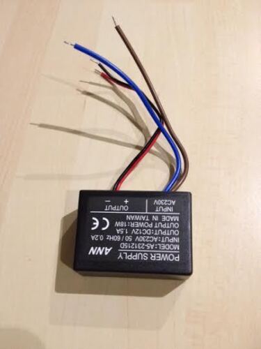

Hi Forum people. First time post here.
I have a pair of semi flush fittings that are currently 10 Halogen capsules per fitting. I want to convert these to LED at 2 watts per capsule. Space is a very limiting factor. Each fitting currently has a round transformer inside. I only have an 80mm diameter space to fit one in but if I go for a round one as soon as I opt for 20 watts the only options I can find are drivers with an output voltage of 21 volts upwards ! The led's wont run off the original transformer, thought I'd give it a go but they go mental !
No problem finding a rectangular driver but they physically wont fit, I did consider fitting a pair in there stacked on top of each other but don't have the depth in each fitting for two.
The missus doesn't want me to bin em out for new ones either so I'm gonna have to try at least to get this sorted.
Any ideas folks ?

I expect that the drivers you have been looking at are constant CURRENT?
You need constant VOLTAGE.

Thanks for your reply, however, this is evidence of the problem I'm having. Its either 12 volts but the wattage isn't high enough or if I want to up the wattage to at least 20 watts, then for some reason the output voltage goes up to 24 volts !!!, or more.
Just can't seem to find a 20 watt 12 volt one that's round or small enough to fit my fitting. Cheers anyway. The hunt continues..........

Howz about this one:
A bit expensive but a quality item and would do the job, assuming depth of 24.5mm is not too tall!
Or here's a possible cheaper option, if you could separate the wiring into two groups of lights, you could fit two of these, each driving half the bulbs, but I'm a bit wary of the suitability of the current rating for continuous use, the actual o/p voltage tolerance, and possible safety implications:

Thankyou for these, It's time to have a chat with the missus methinks. Nearly 40 quid is more than the light fittings are worth. Even she wont go for that ! The cheaper option comes really close though but at 18 Watts, they're just not gonna do it. From what I can glean from the net the wattage should be marginally greater or equal to the demand.
You get 3 of the little 18watt PSU's for your single purchase costing £7.50!
I intended to mean you put at least two of those supplies in each light fitting (ie giving you 36W of power) wiring each supply to roughly one half of the lamps in each fitting.
You would need to make two purchases (£15) and you would have 2 PSU's left over.
But if the wiring does not allow you to split the load like that, then obviously this is a non starter.
Sorry I wasn't clear!
