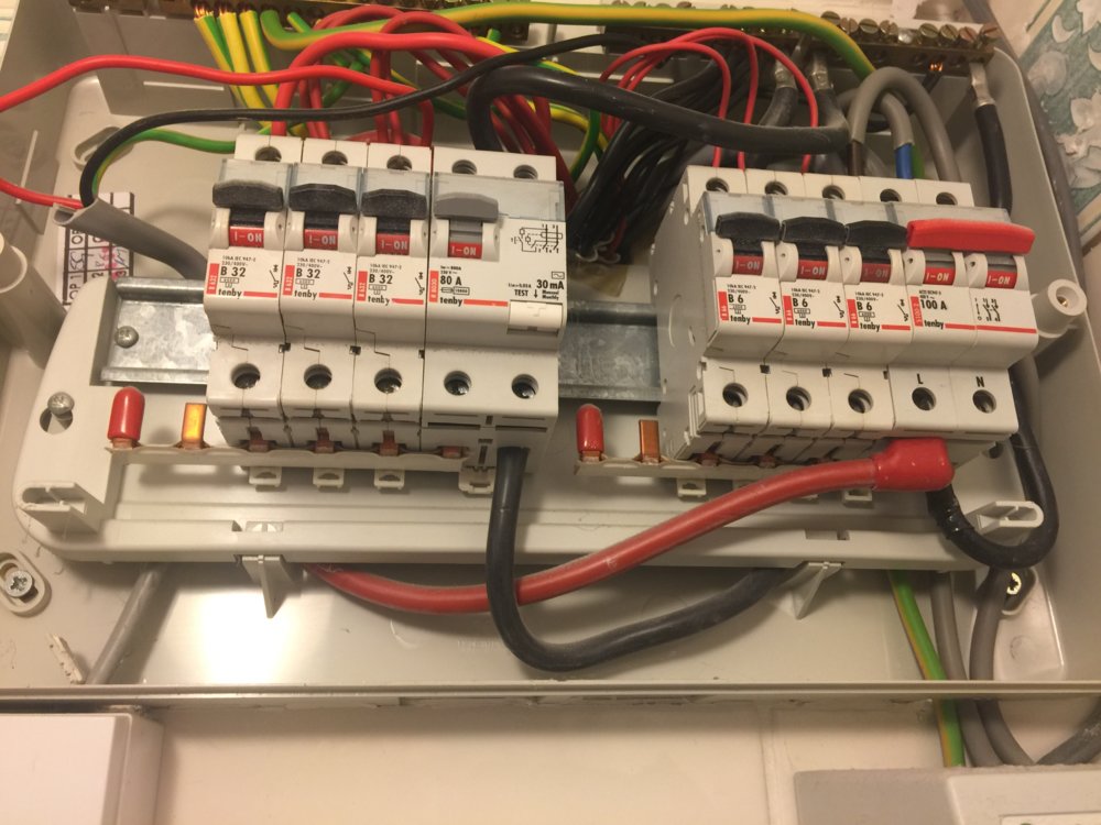

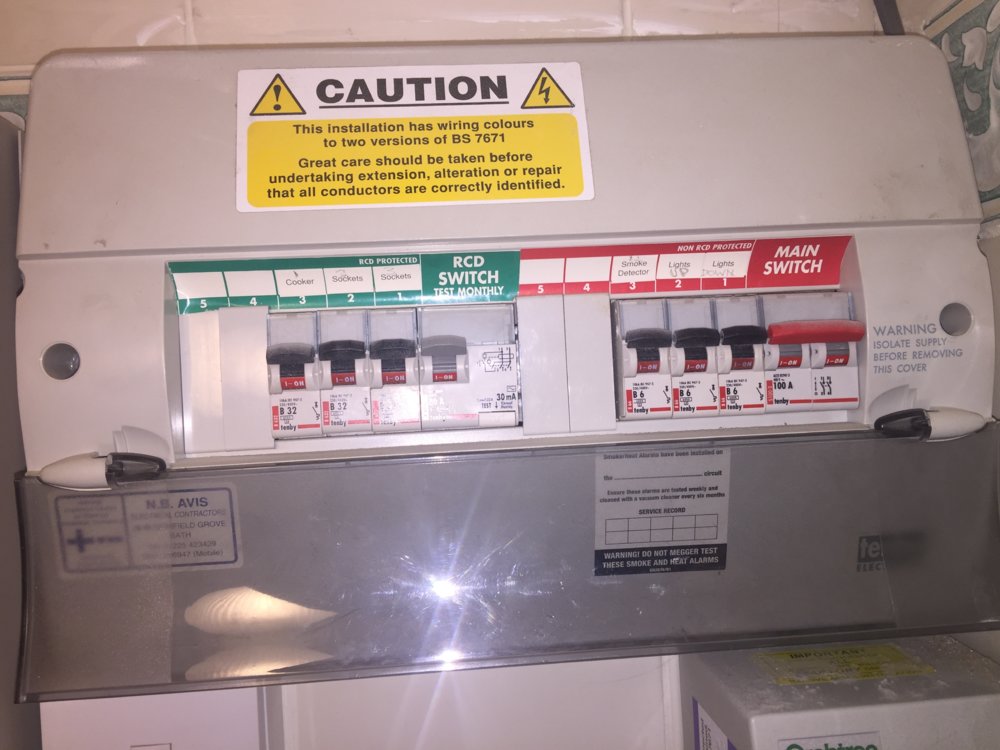

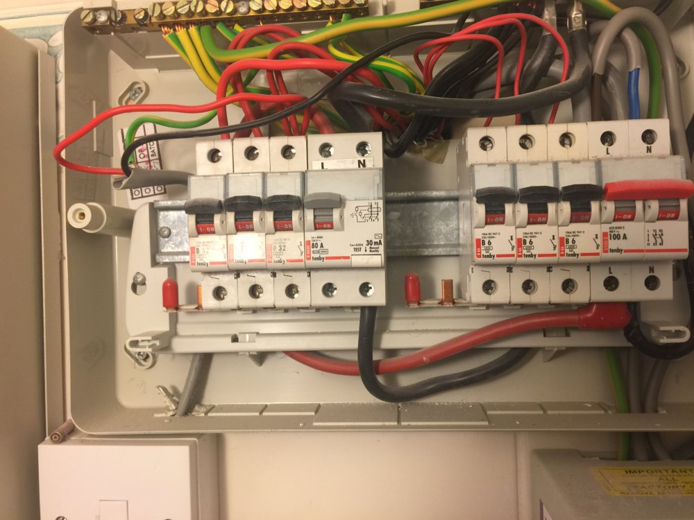

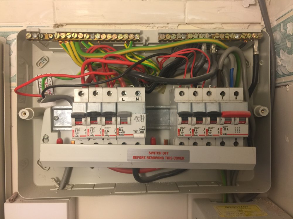

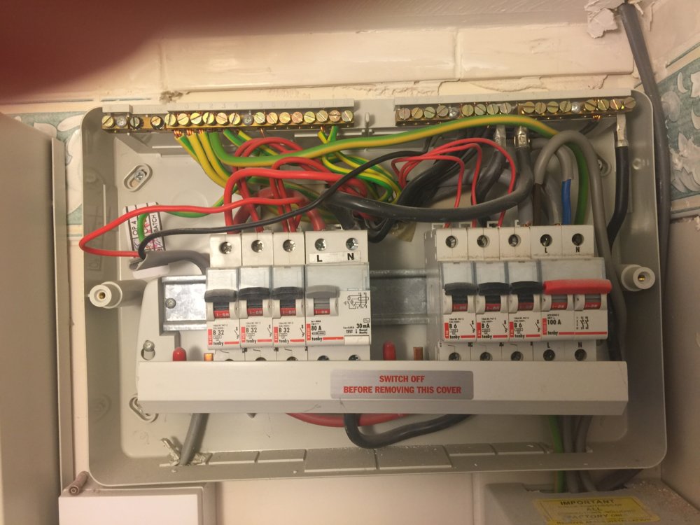

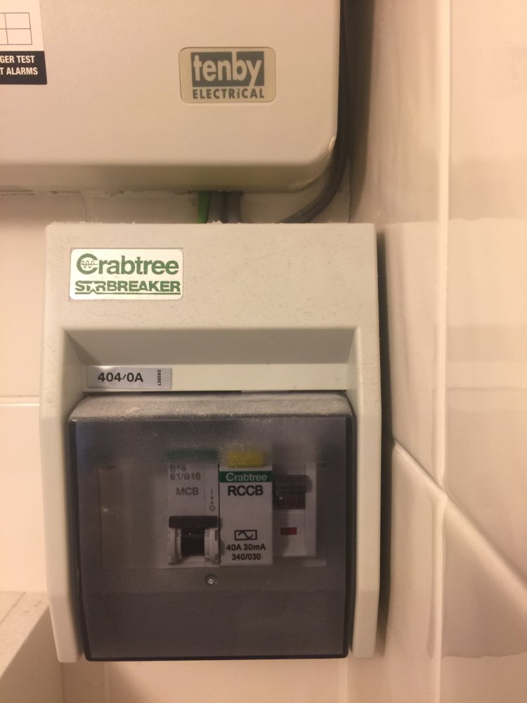

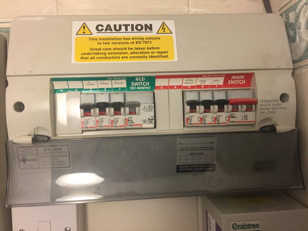

My house built 1993 has an original plastic 10 way Tenby Electrical CU.(see photos)
I want to replace it with an 18th Edition compliant CU. This should ensure there will be no problems when selling the property which we hope to do within the next 5 years.
I plan to replace the unit myself and then use Part P register Electrician to test and certify the installation.
My question is which is the best metal-clad board? and is it best to use all RCBO's?
I also need to install one of those Ring doorbell units which use a din rail mounted transformer which looks like it takes 2 ways. I also need to include an existing circuit for 2 power showers that are currently wired through a separate Crabtree unit.
Any help would be greatly appreciated.

To answer your question and to future proof the work? go with an all RCBO board, but I would say it's not really a DIY job.

As above - I don't see the point in changing the board just because you may sell the house.
You need to involve the electrician who will be signing it off at the planning stage of the job, this is a requirement of the third party sign off schemes.
When you say best do you mean the best quality board on the market, the cheapest, or the best trade off between price and quality?

I think you will actually have more trouble selling the house by carrying out the work as (unless you have a electrician friend willing to break the rules by certifying and notifying it) the work will not get notified so you may not have the relevant paperwork which the solicitor is FAR more likely to want than seeing a metal CU.
Are there any other reasons you want to change the CU?

Well I might be wrong but doesn't the 18th edition say all boards now need to be metal/fireproof to be compliant?
If a new board is installed then yes. It doesn't mean everyone has to rip out perfectly good boards and change them for metal ones.
In the last house I sold in 2014 the Solicitors surveyor raised an issue about the old Wylex fuseboard and its 3036 rewireable fuses. I had to pay a local Part P certified Electrician £500 to change the board for one with mcb's and then test/certify the installation before the buyer would accept it!

Yes best quality, but also most suitable, like cable entry knockouts in the back, wide choice of rcbo's, spd's. I'm thinking maybe Schneider, Hager, MK?

I recently went with a Wylex board that has SPD and used their RCBO mostly because they are 2-pole switching.
They present a load on the live busbar at all times (from the RCD electronics, I presume), so not only would an insulation test there show the SPD (if you don't pull them out) but you see the RCBO at all times. However, both L & N RCBO outputs are fully isolated so the more important tests later on any circuits insulation / isolation can be done without removing conductors.
Personally I would always use RCBO, to me having half you home go dark from a fault on just one circuit is too much hassle! Also you quickly find any muppet who used a borrowed neutral before you get a nasty surprise one day...
I know some recommend only MCB on cookers due to some being leaky if the elements have absorbed moisture, but as they often have a 13A socket for a kettle I feel some RCD protection is wise. My 2p worth again.

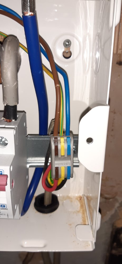

installed this beasty yesterday. tried the toolstation 3 pole connector as discussed on another forum. tug test fine, presently on a 16A MCB, so not fully loaded. noticed that on the meter the Nin and Nout were reversed. not my problem, and afaik, the N's are just linked in side the meter anyway. the seal fairy had been before. ......

nope, free in air. just got it in that position as thet was the extent of the 2.5mm T/E to a double socket out of shot.
i could post a pic with cover off, but due to most cables being short and stretched to avoid joins, it a bit of a rats nest.

Them ain't Wago's, nothing wrong with them I use them myself, came from Toolstation discussed at length on two threads and the only negative comment is that the centre lever is not striped yellow/green. :rolleyes:
FIO Wago do make a din rail mount to carry their connectors, used those as well.
i just bought a green sharpie. problem solved.
Looks like a hefty nick in your Brown cable there though:rolleyes:
only surface from being chucked around in the van. i did check it for any damage. that brown is 2.5mm single. quite robust insulation.

Fair enough, but for such a short length of 2.5 single I'd probably just have chopped it at the nick. Probably just looks worse in the photo
