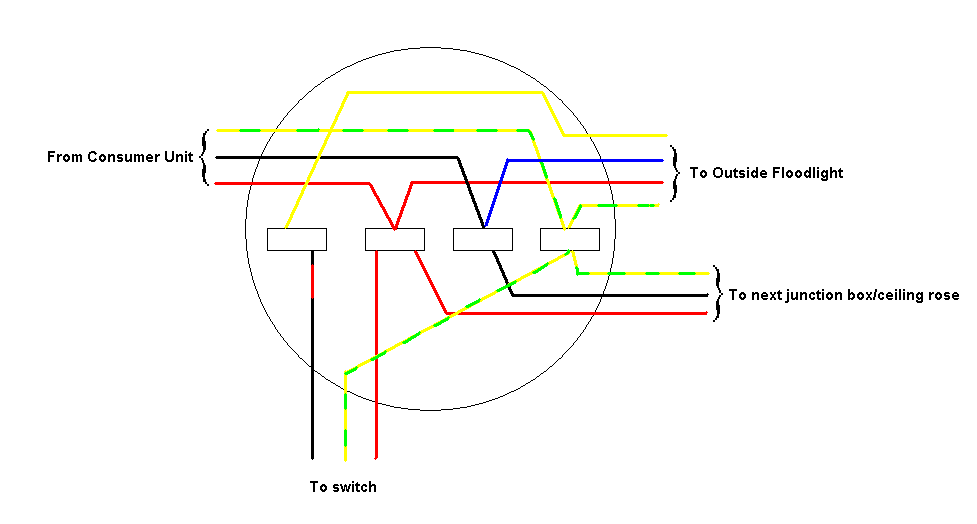

I've tried to analyse the wiring in the JB and would guess that it looks like this:
If this is the case, I don't understand how Lenny's answer applies?
I would guess hifly's point about spare conductors being earthed at both ends is so that in the event of a fault at one end of the conductor, the other end doesn't become live.
What I assume the OP has is a L&N supply to a switch by the back door and then a 3C & CPC up to the outside light. The red is connected into the common of the switch with the perm live supply of the T&E, the yellow will be the switch wire in L1 with black & blue in a connector.
Hence my suggestion of disconnecting the red core.
Re: Acceptable means of making a spare live conductor safe - inside external floodlig
all spare cores should be connected to earth, disconnect at the switch, dont have a spare perm live at the light.
