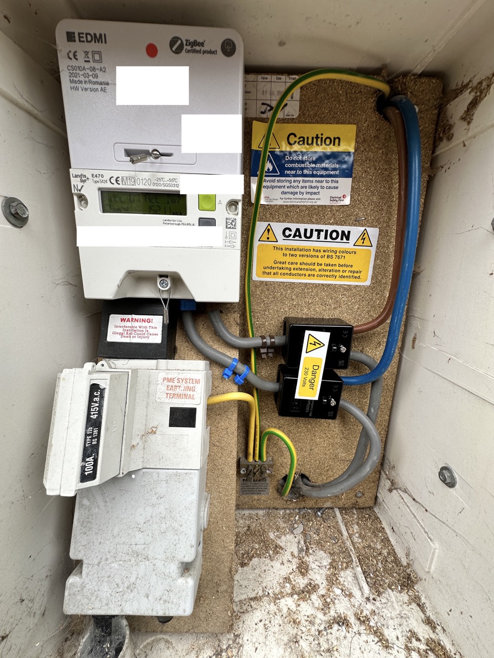

I can clarify that the new works are the Garo DB for a new EV charger (Tesla Wall Connector Gen3) and the SWA that you see going into a compression gland on the Garo board... I asked for the existing SWA going to shed from the main CU to also be added to the new DB, so that it's also PEN protected, as we're looking to install a hot tub from the shed CU and it would provide some protection for that circuit also...
A side note: It just occurred to me after someone noted further up - it doesn't look like the armour has been earthed if they've used a plastic compression fitting... probably something that also needs addressing I imagine, as I'd prefer if any SWA armour on the property is earthed for obvious reasons.
Correct, sockets are less of an issue honestly, but given that there's now the topic of adding additional protection in the way of conduit or a plywood box - I may actually shift them across and up to make covering the area easier, as currently, it's difficult to do that without blocking the sockets.

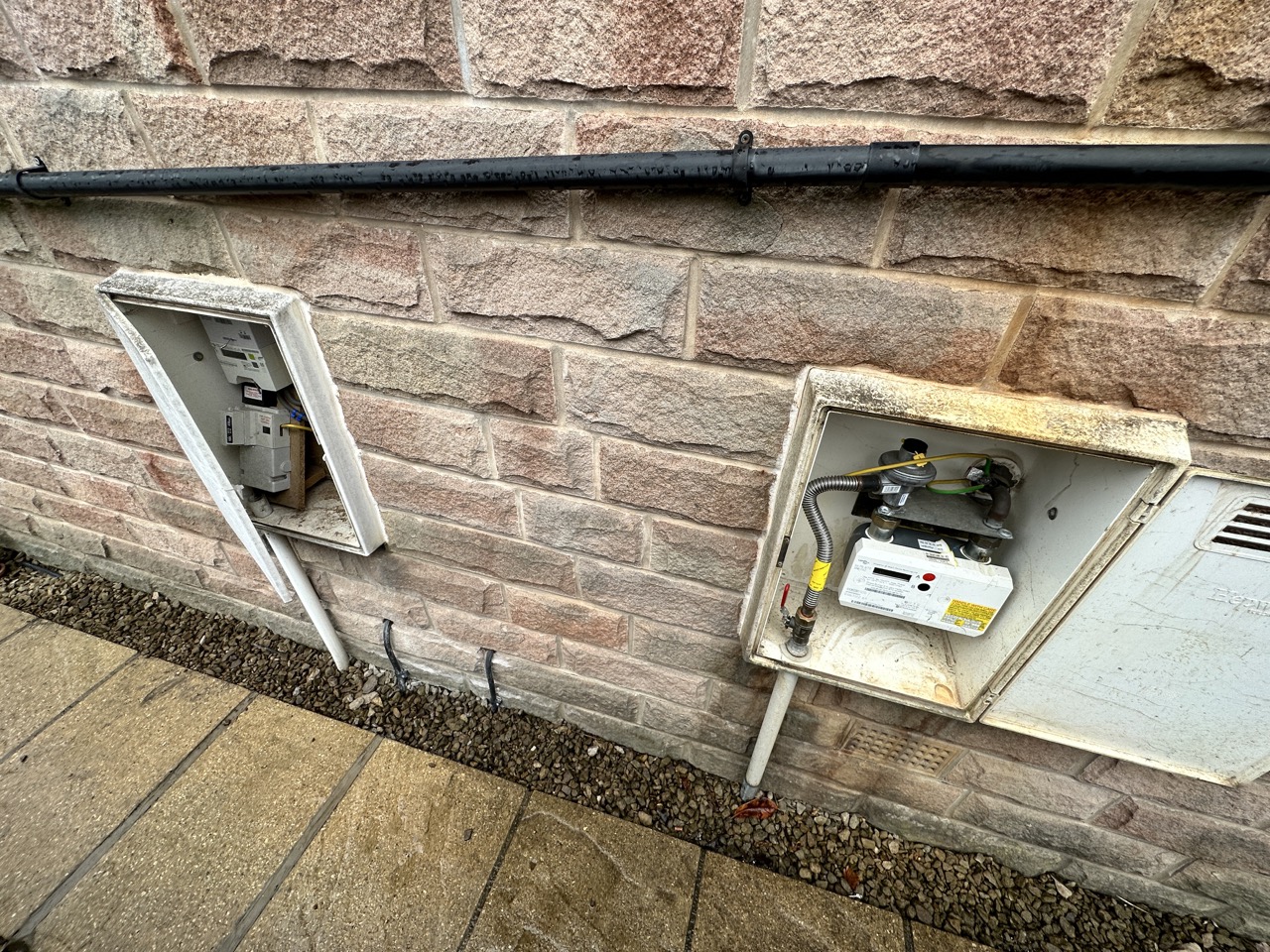

The tails come through directly from the very top right corner of the meter box directly on the other side of the wall. It was a bit of a drill and pray situation and the drill luckily came through just to the left of the existing SWA for the shed.
It's a bit of a long story but the guy wasn't very happy that I suggested to him that adding RCD protection to the existing shed SWA at the source (main CU) wasn't actually required (armour is bonded at source already and sub-CU has all RCBOs). He was adamant that all buried SWA had to be RCD protected... anyway, I digress... by the time we got the issue of the exposed tails - it was obvious that he was annoyed at me for second-guessing him, so I just stayed clear of him until he was done. He didn't actually add an RCD in the end, stating that "it's your property, so it's up to you".
Anyway, the plot thickens as I've realised he's reduced my shed feed from 63A to 40A (which gives me zero wiggle room for running my power tools in the shed when the hot tub is running) and I cannot source suitable Garo modules to support the higher rating... so looks like I'm going to get my regular electrician to put the shed SWA back into the main CU and run a new 6mm run to the hottub from the Garo DB. Hands are tied now it seems. I'll sort out moving the socket and adding from boxing to tidy things up.

Do we know for certain that this is SWA and, if so, how is it terminated at the other end? I would have guessed tuff sheath cable due to the compression gland and the likelihood of this cable run on the surface externally.
This may well be why the tails don't enter from the rear.
Although we'd be splitting hairs, outgoing 63A + 40A circuits would exceed main switch rating. I've no idea whether or not he may have had good reason for reducing the shed supply. Depending on cable size, length of run, installation method, voltage drop... there may be valid reason for doing this, but equally there may not.
Bonus question... 2x continuous 40amp loads running through a single 40A contactor? Is that right? Sorry, I'm obviously just an amateur but I feel like I'm having to second-guess everything at the moment.
The rating will be 40A per pole and this is another possible reason why shed supply has beed reduced to 40A.
