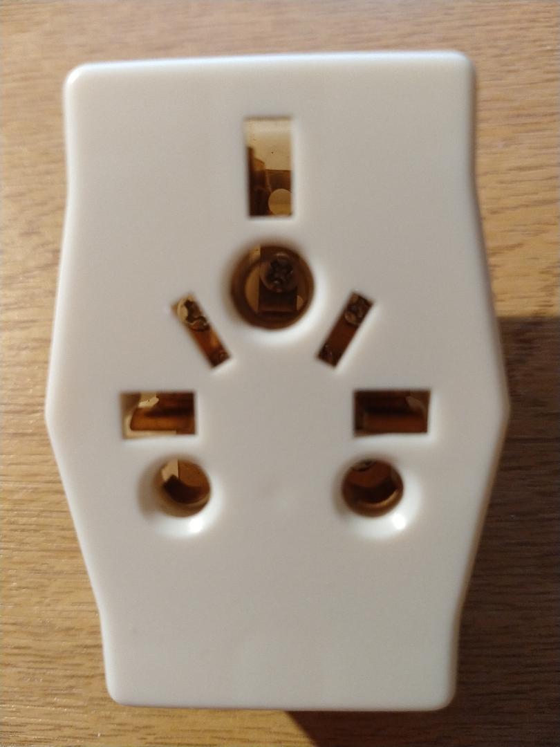

What in the name of everything unholy is this!!????
Just making sure we don't obtain continuity of the CPC!
And how the f could it obtain ce compliance to non-CE standards?
Got to love those plugs. I like how they go to the effort of partially sleeved live and neutral pins, but then get carried away and do the earth pin as well!
Yeah just ridiculous, but the biggest demonstration of the farce and complete disregard for compliance with any standards whatsoever is the "CE" mark.
Especially when it's impossible to comply!
Indeed. Some of those Chinese manufacturers really don't care.
Knocked up in some Chinese small factory, by people with only a passing idea of what the standards actually are and mean. Probably read that British plugs have to have sleeved pins these days - so sleeve the pins.
If it was bought via one of the online tat bazaars, then it needs reporting to the bazaar as a dangerous and illegal item - so it can be blocked for the few seconds it will take the vendor to create a new account.
If it was bought from a UK or EU seller then it needs reporting to the relevant authorities (Trading Standards in the UK) as well as any bazaar that might have facilitated it's sale.
Just out of interest, what are the pins like for spacing and dimensions ? I see stuff that's got really rubbish pin dimensions and doesn't fit the sockets properly. Had to tell one of the church wardens to "lose" the ultrasonic rodent repellents (cheap tat off Amazon) before I did any testing as they'd all fail due to that.
@Julie. What's on the other side, is it just a EU two pin convertor?
Nope, it has no shutters either, in all respects it is a bag of dangerous ****
Will dig it out of the bin and photograph later!
Insulated CPC - to ensure no earth connection is made.
No shutters - to ensure a child/irresponsable adult can make contact
Undersized connections - to ensure overheating and fire potential
CE marking - to ensure it is obvious it is non compliant
I have no doubt the plastic is unsuitable along with a whole host of other things...
My elderly neighbour brought me this to see if I would recommend it for her travels to Spain...
and the top and bottom both had this...
I think she used it in Bermuda where her daughter lived for a while...but I took it from her and added it to my collection of "interesting stuff".

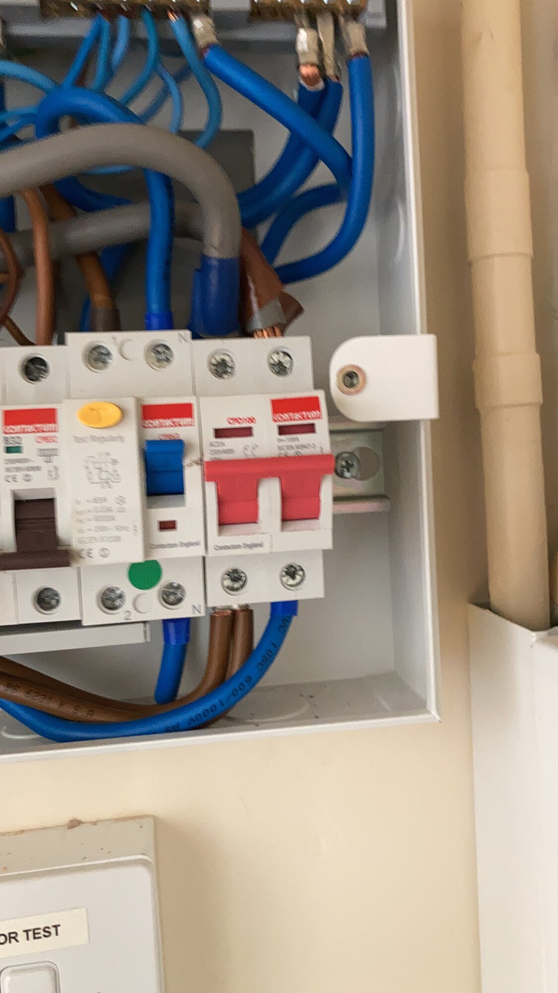

Probably got a bit lucky here. Did Zdb and didn’t visually see what was going on, been testing Easy 9 boards this week so the line on the right didn’t really click with me. Turned the main switch on to do the RCD tests and my eyes caught how the cables were coming into the back of the board so I was wiggling round right next to the neutral bar, then I saw it ?.

Nasty!
About 20 years ago I turned a Wylex off at main switch, cut through a T+E cable with damaged wire cutters, got a right bolt and blew the main fuse. Whole board was reversed.
Once bitten twice shy, and been sticking a 2 pole on the N and E ever since.
