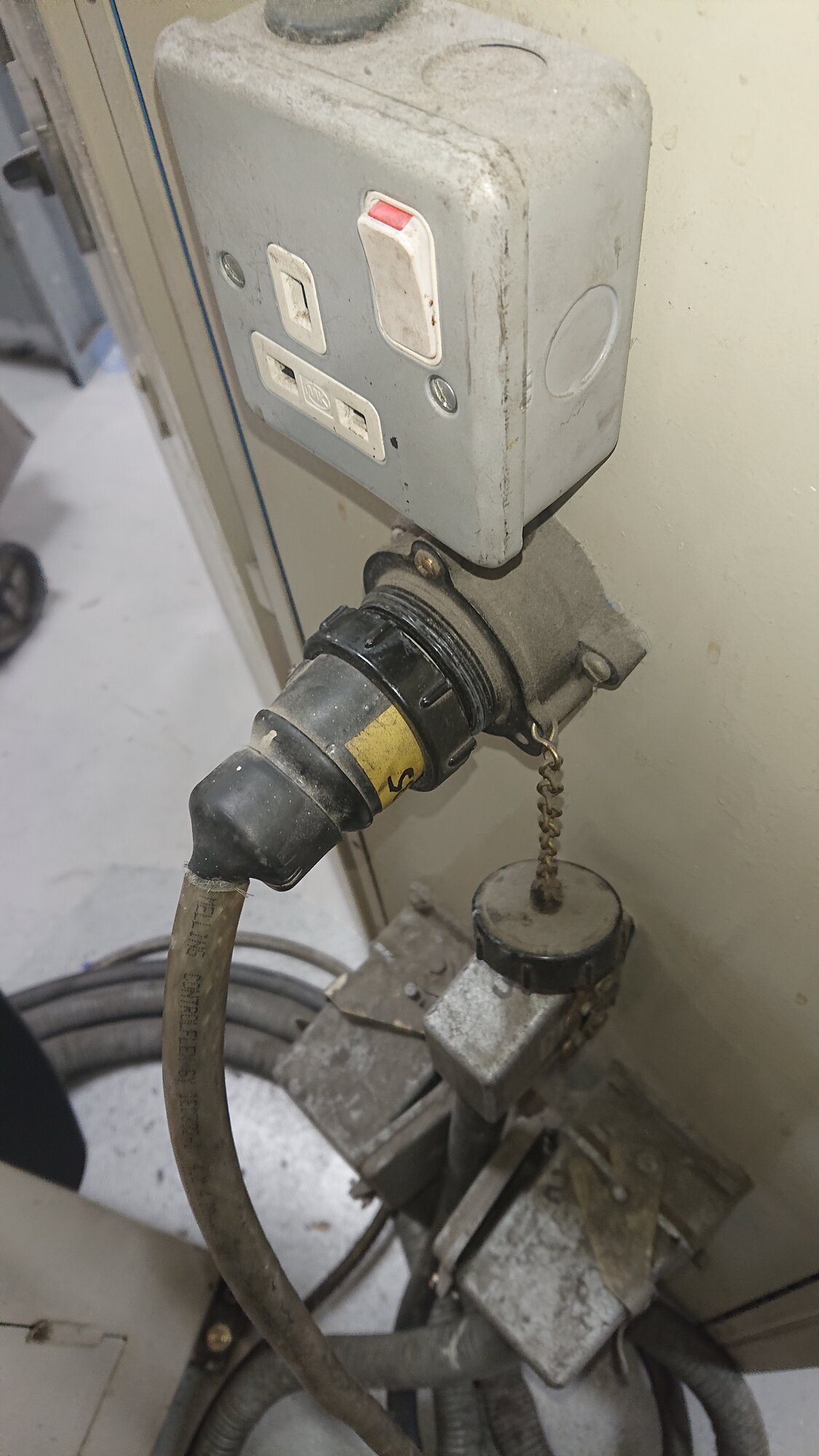

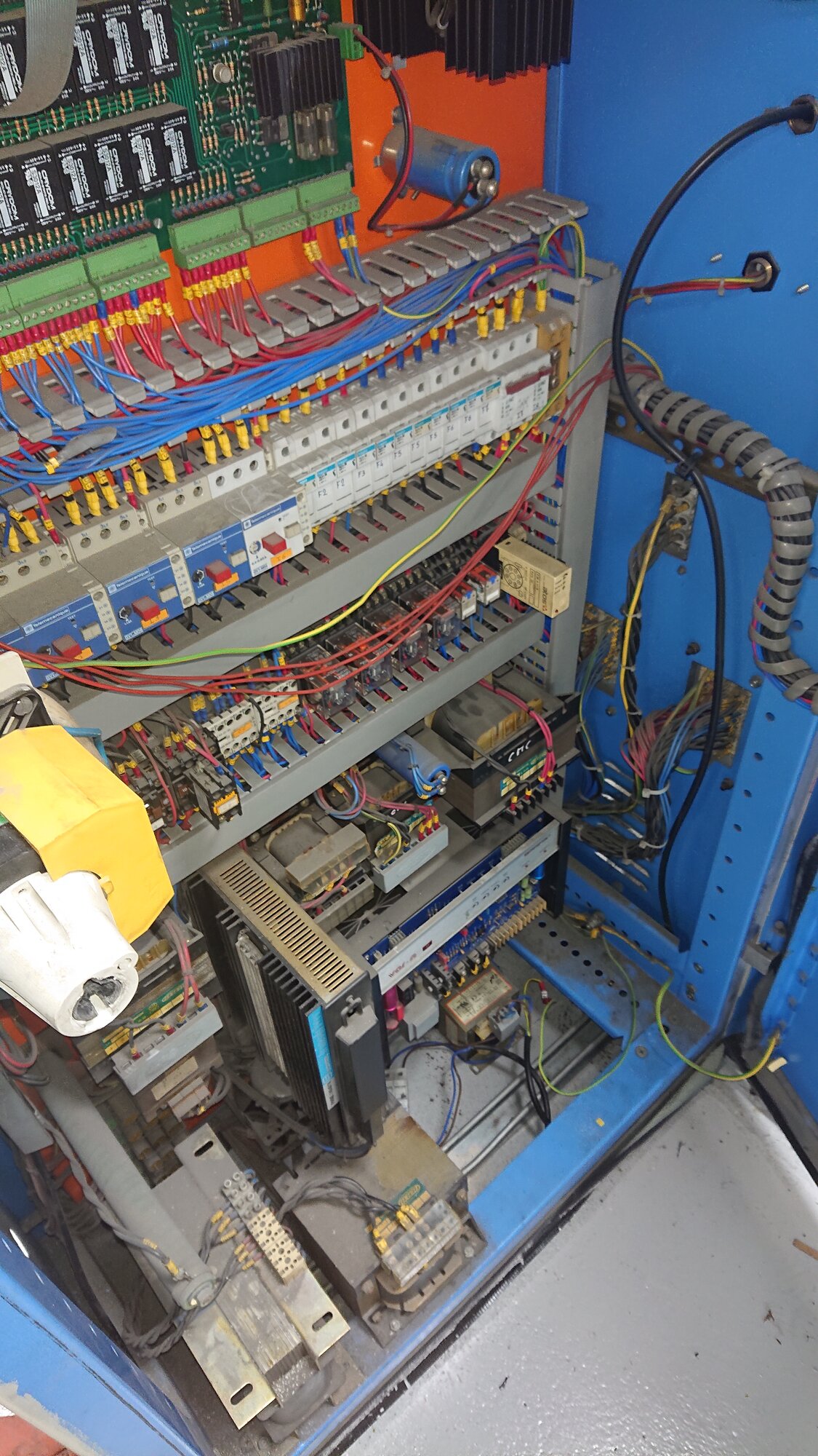

Cables live even with iso off.
Going to dodgy old style three phase plug.
Then out into SY cable.
All about to be removed and aux out going to the virtually empty DB above
Not even tried to put the live singles into the tray work
True but if one trips and DIY Dave starts to play around thinking everything is off then you could get a nice zap
I'd say that's Dave's fault. He shouldn't be playing about with it anyway, especially 400v 3 phase.

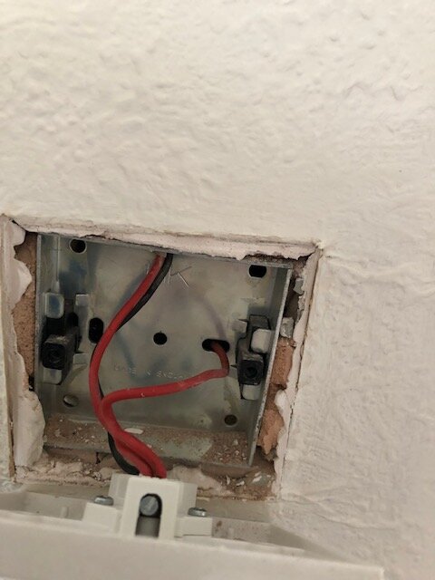

I don't think those boxes have a terminal to connect a cpc to. They are pre cpc metal back boxes, with insulated threaded blocks for the switch fixing screws.
I had a box of 100 Crabtree brass earthing terminals that I used to update the likes of these.
Well spotted, but why not use a connector or something. The main problem came with breaking the cpc. Half the circuit wasn't earthed (incl fluorescents)...linked the 2 earths and it was, so cutting 'em back broke the line.

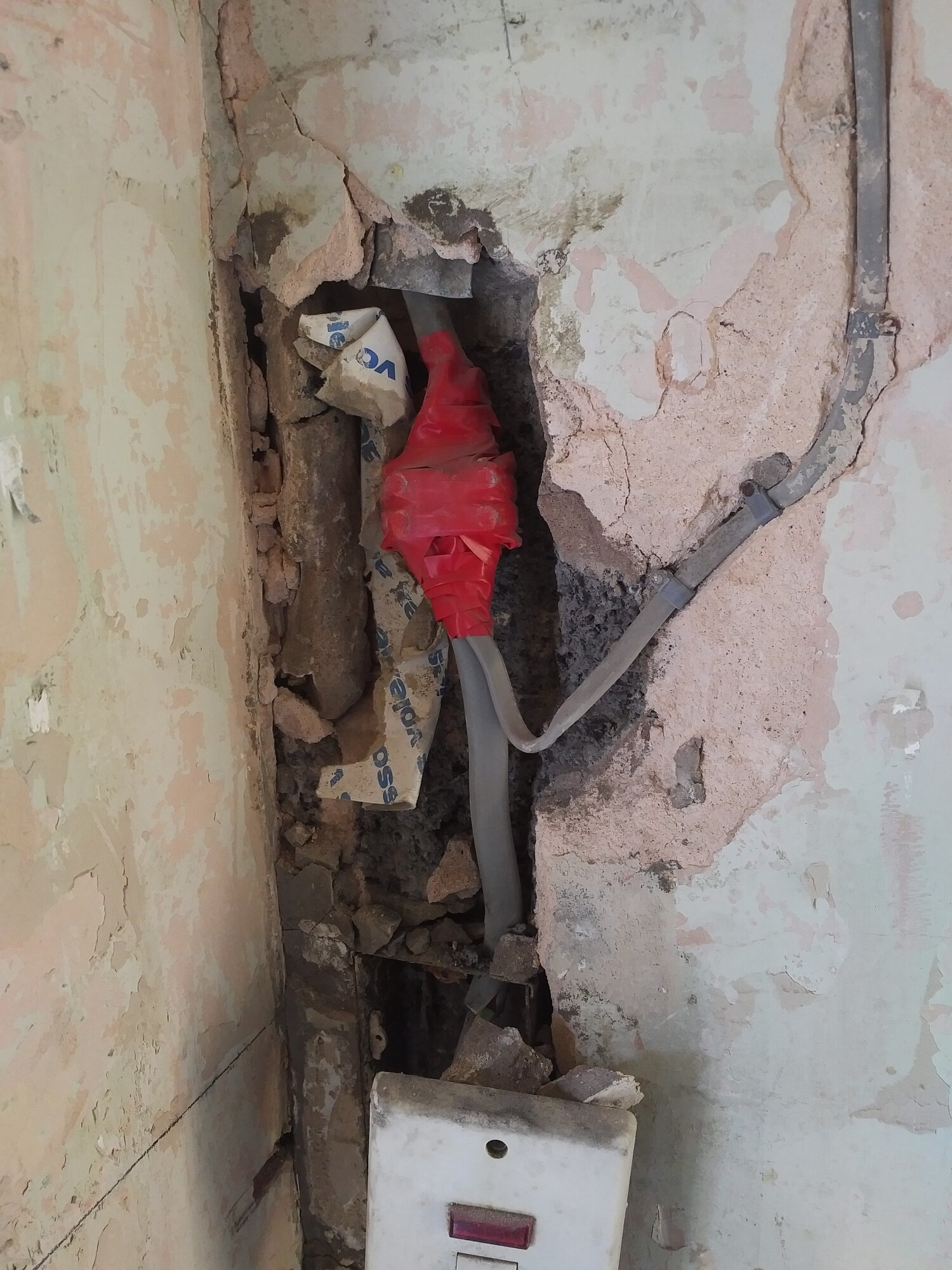

Been helping a friend out who has just moved into a 1970's built and bodged ever since house. Lovely consumer unit, sockets in the bedroom not working, (lost neutral) on closer inspection as the cable was only about 2foot long, this was the cause hidden away in all the gash wires looks like it was snipped off for God knows what reason when the con unit was upgraded, no faults found on the cable! Final one was ripping out the kitchen bodgery a rake of spurs off spurs and a cooker hood that went dead with the cooker, removing the isolator face and outlet plate gave no answers so out came the chisel and hello what have we here then!
