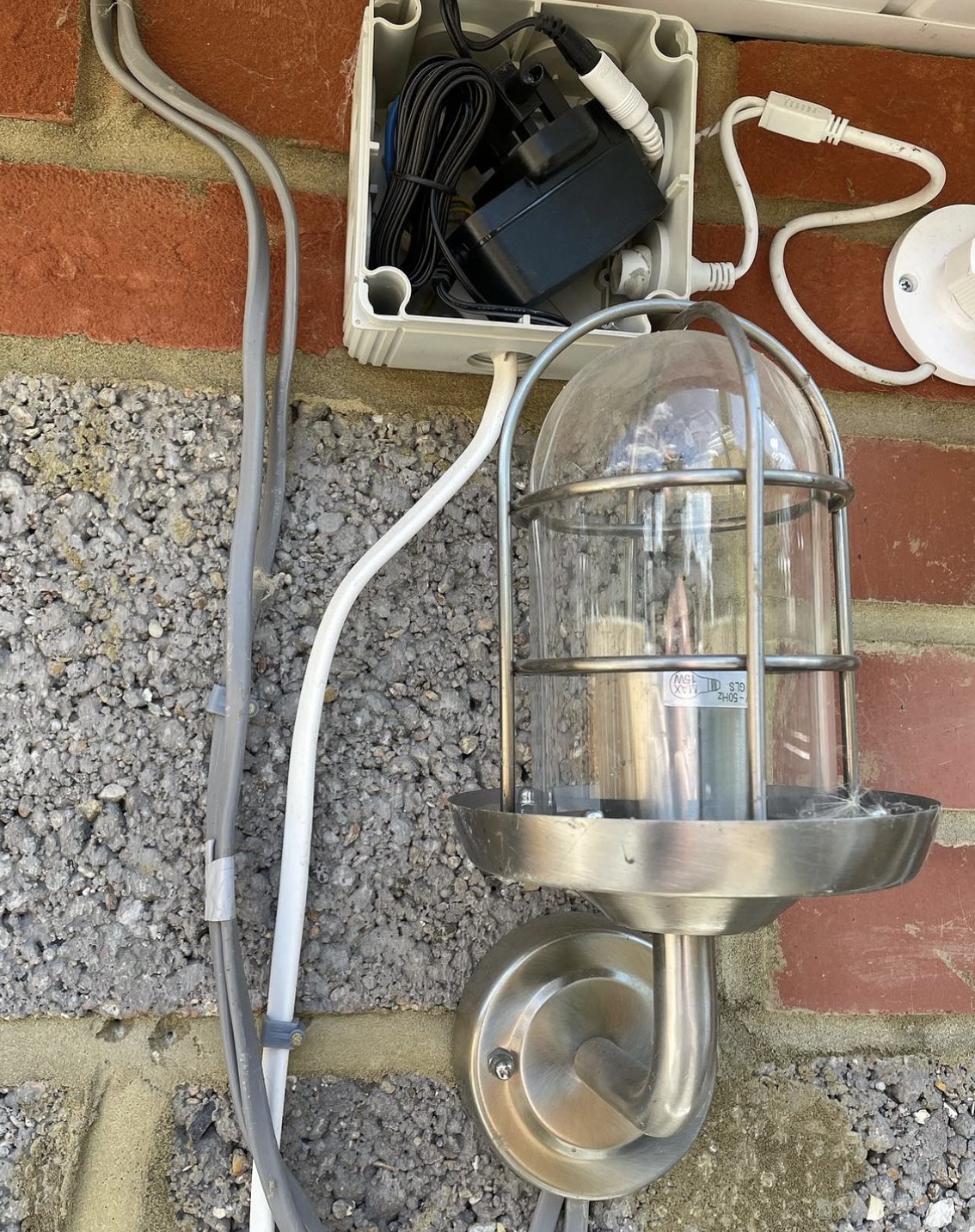

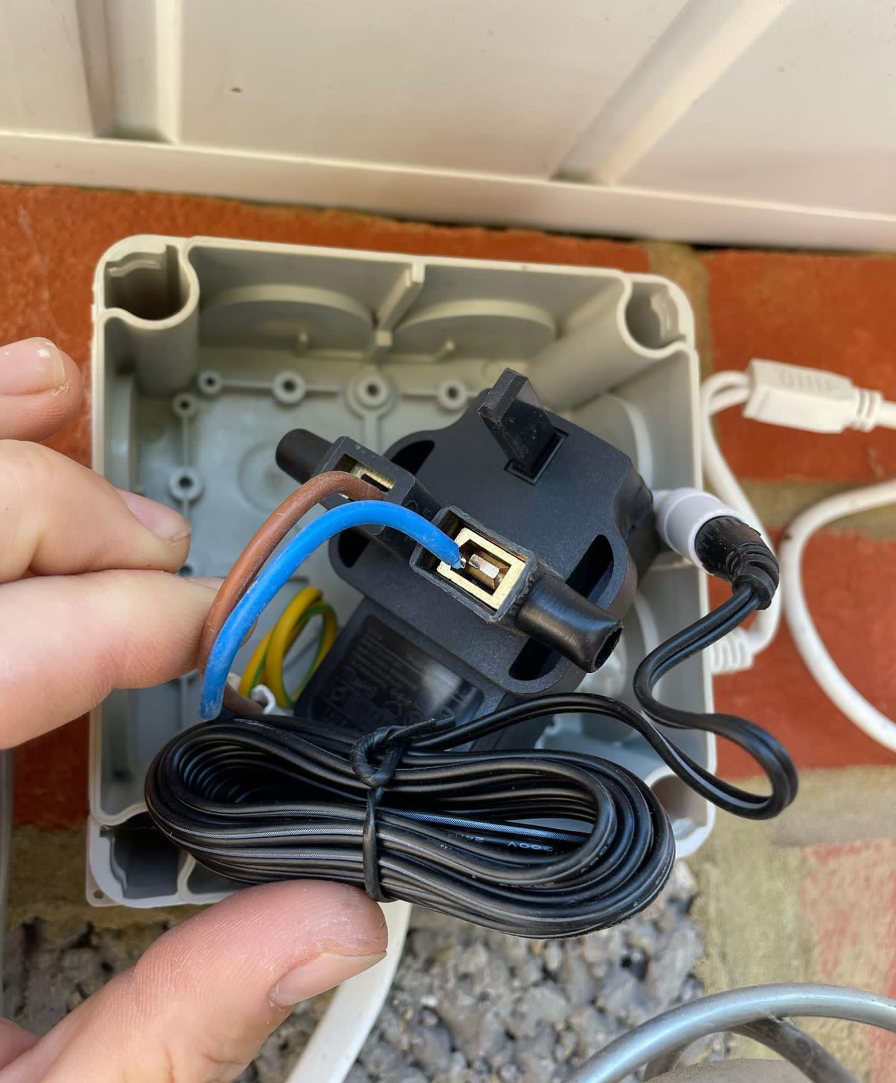

So client says "Wonder what has caused it"?
I say I'm no expert but could be a damp problem.
Client says "we dont have damp in this house"!
Need a second opinion??
All the available damp has been absorbed into the back box….
The building equivalent of rice in the salt shaker.

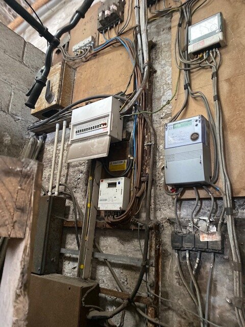

In a Switch Room.
Who's thrown that away? Code 1.

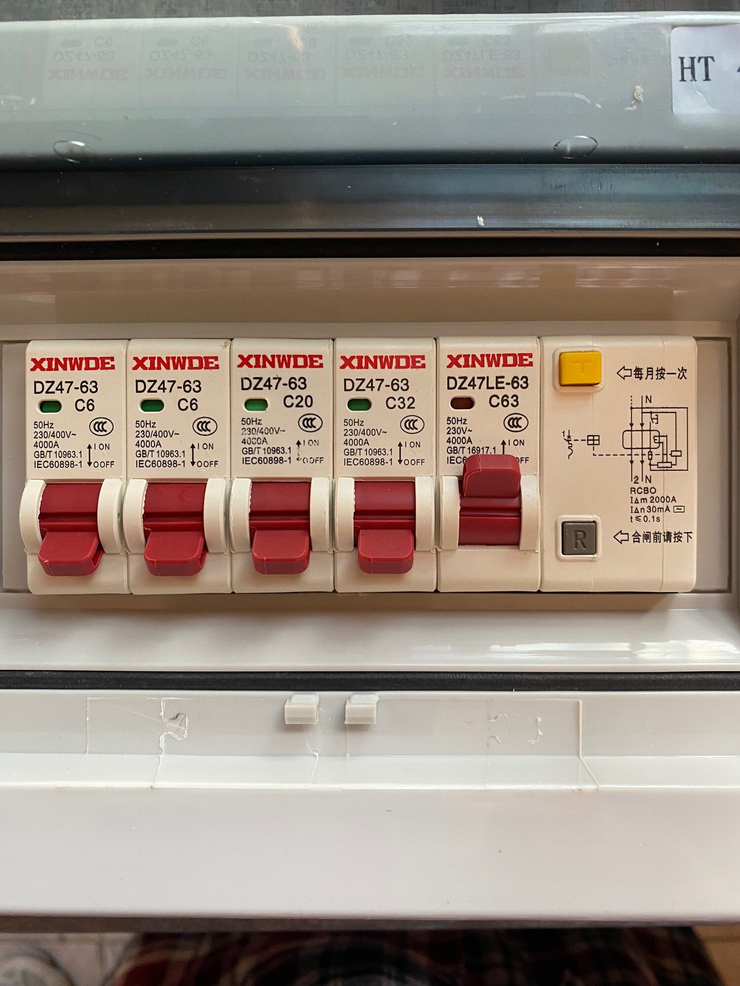

Was asked to fit this new consumer unit in a static mobile home, bought from Fleabay.
I refused.
What was your initial objection? The immediate one before all others became apparent.
The feel of the mcbs and the switch action just felt cheap and nasty.
I refused.
Tests carried out on these units on behalf of Leicestershire Trading Standards revealed safety concerns. The Residual Current Device melted rather than cutting power, some of the Miniature Circuit Breakers failed to trip, and parts of the circuit remained live even with the main power switch turned off.
