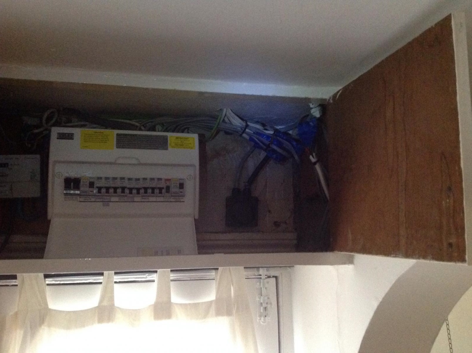

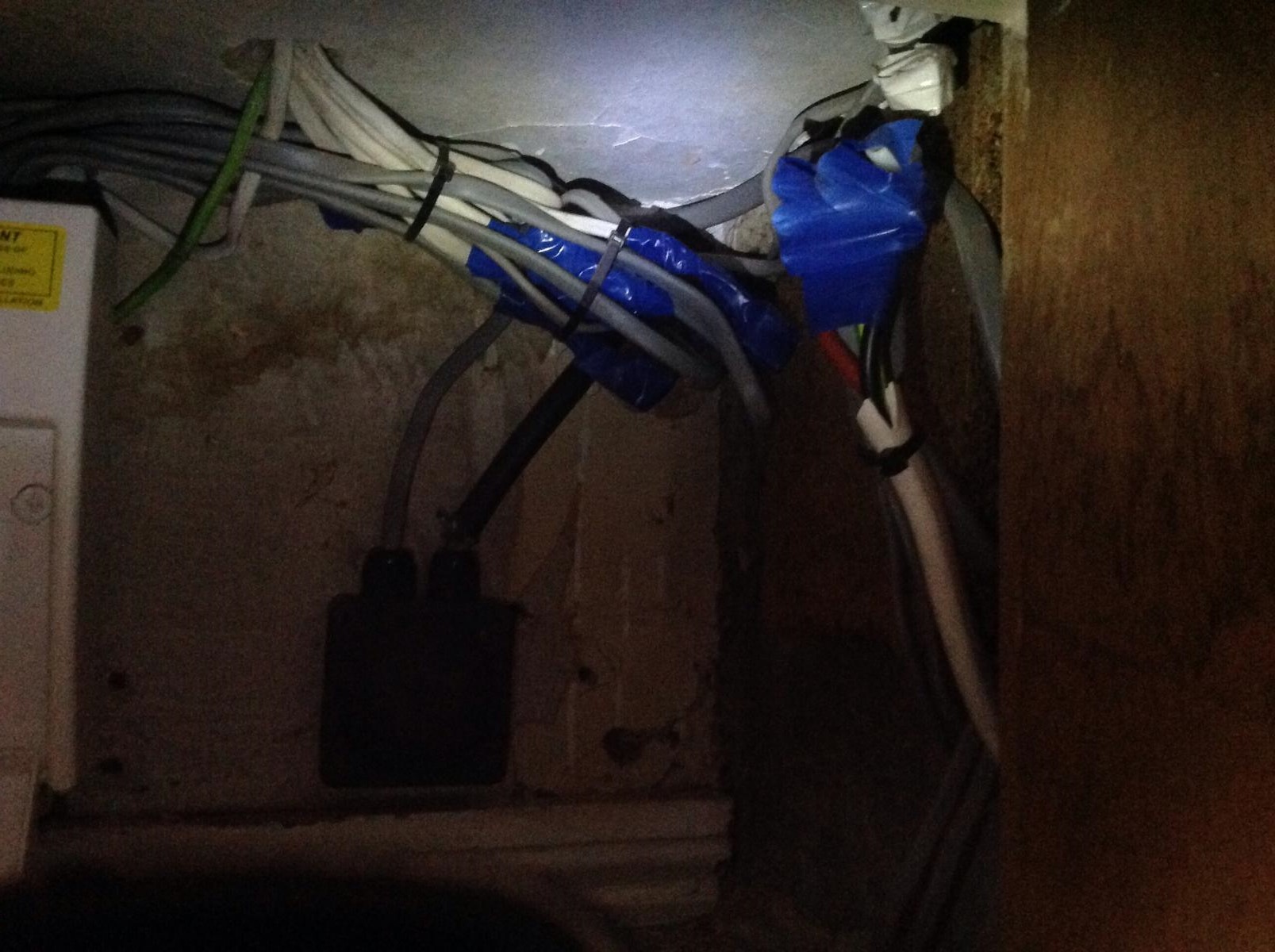

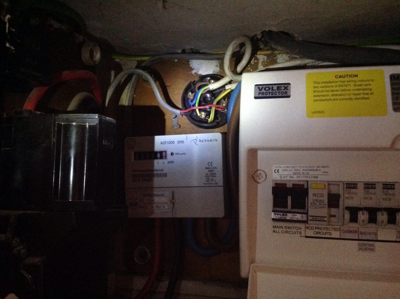

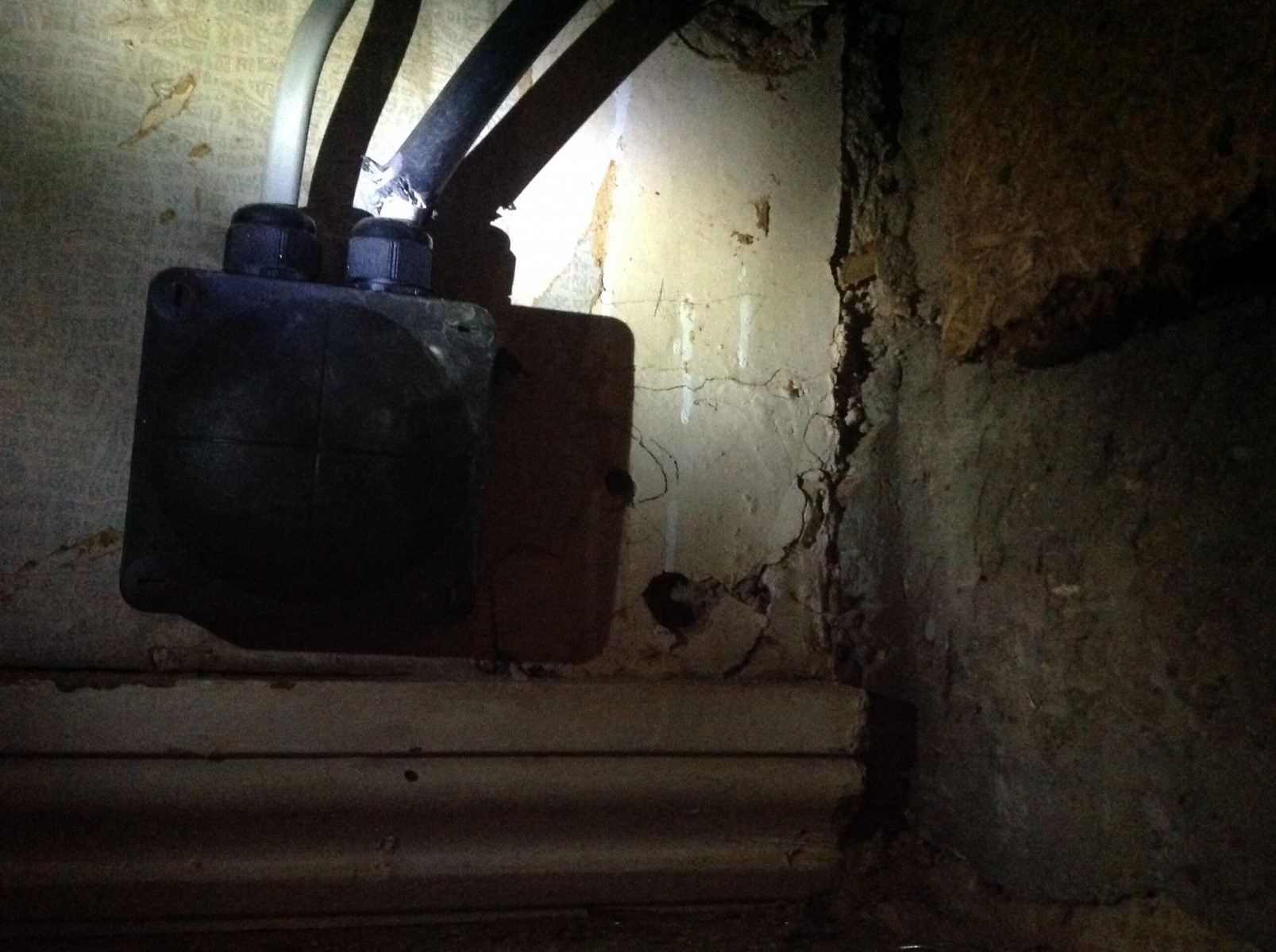

Quality DB change I come across this morning. Whoever done it has extended nearly every circuit with 15amp block including the ring final circuits. And look at the quality SWA termination in to the wiska box.
I apologize for the pics loading upside down.

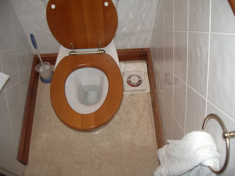

What zone is that CU installed in ... ?
Metal CUs will put an end to that kind of work.
I feel safer already :smilielol5::smilielol5::smilielol5:

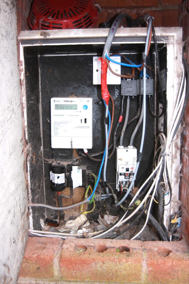

my mission....... to make this comply. apart from what you can see, the PME earthing is "exported" to 4 caravan hook-ups.

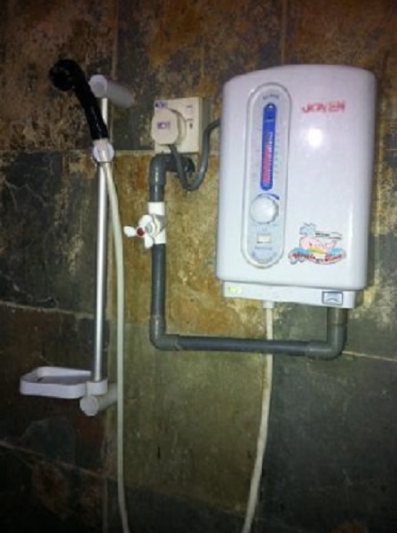

I’ve got a condition that prevented me from moving the socket out of the shower area. It’s called not giving a ****.:wink:
