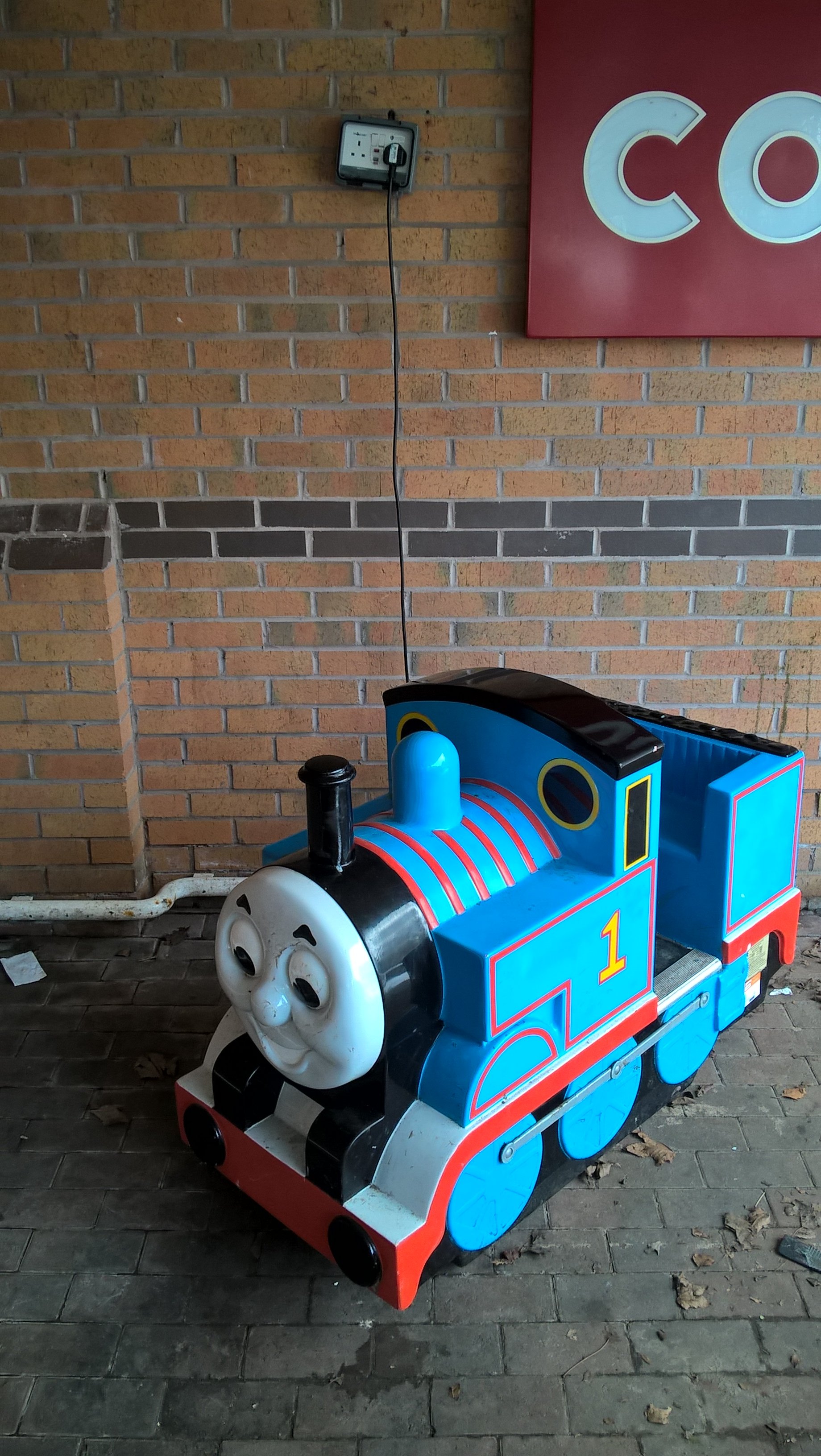

Went to Tesco today...
Was wondering what type of cable this is, and is it immune from chafing on steelwork?
Perhaps that cable tie is sufficient strain relief?
Clearly the other wires waving about are not live...

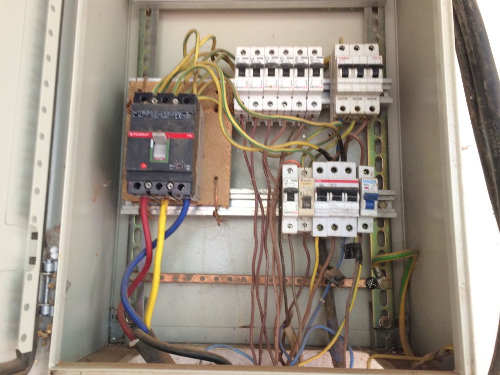

here's a good one, this was the MDB for a warehouse complex with 20 warehouses, 3 office blocks, on the right is the Utility supply incomer cabinet.
6 weeks solid work to replace and fix this up.
We replaced with a 250amp 250 TPN eaton load centre, steel trunking cable managment, new SDBs an ATI for generator, prior to this the loacl electrican removed the knife edge fuses and put the cable from the generator ( one hanging down) into the top holder of the KE fuse holders with a pliers.
To protect the utility supply all we could do was put 12mm perspecx sheets affixed to the dexion frames. Utility provider considered it safe in its orignal state and would not replace it with the unit we bought for them.

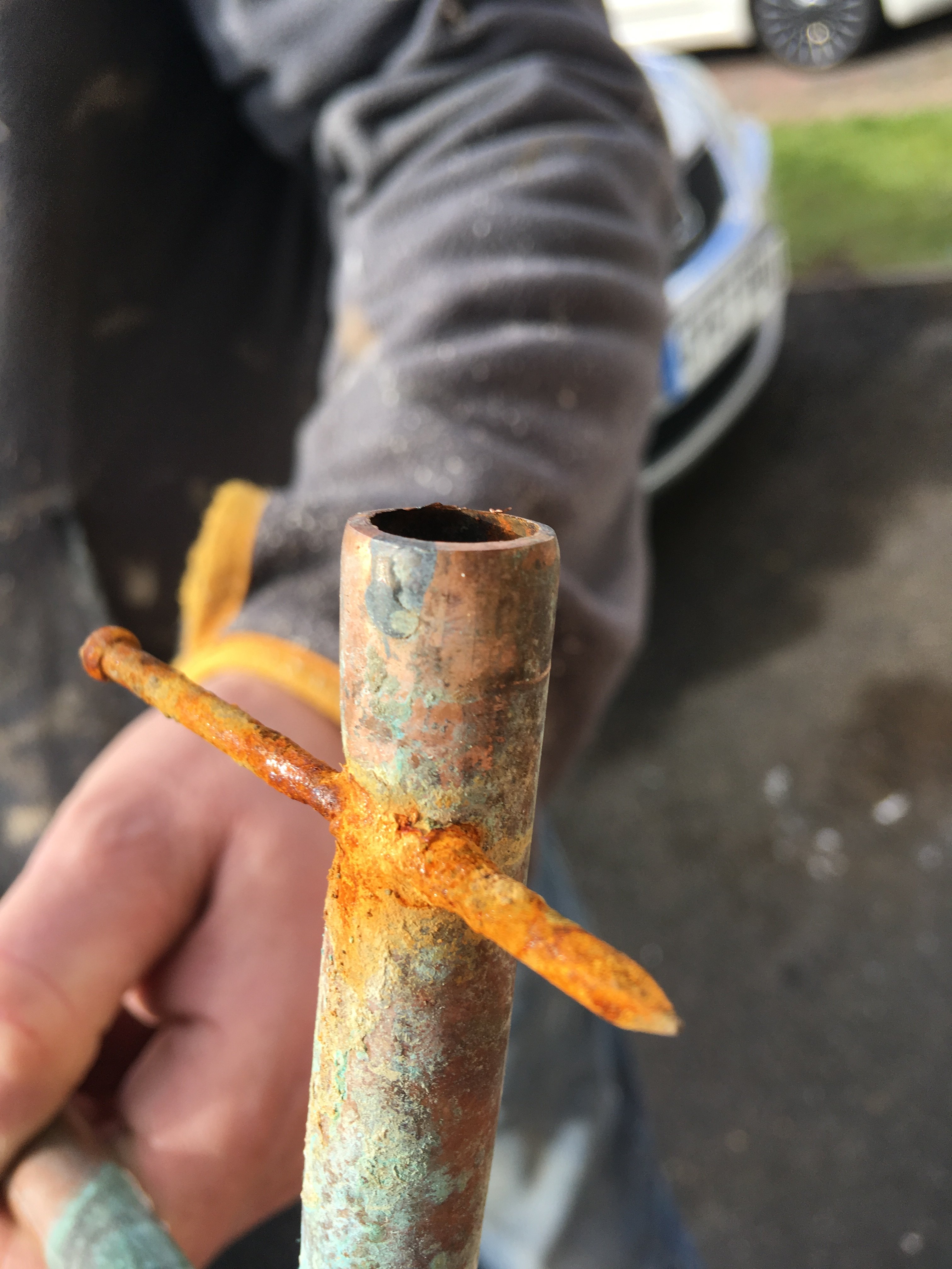

Skirting board taken off to reveal the nail had punctured the central heating pipe but NOT caused any leak. Whether it was a tight puncture and sealed itself with lime scale is unknown but no damage seen in the area.
How sweet is that!
Lucky escape there! When I got a flat a couple of years ago the "plumber" was finishing off installing a shower, and put the outside frame on and off he went...thursday night before the september weekend, so no-one was about until I arrived on the next tuesday to meet all my downstairs neighbours paddling about in wellingtons. He had driven a screw into the cold supply pipe for the shower and it had leaked all weekend...
Certainly got to meet the neighbours!
I could go on about his reluctance to use pipe inserts with push-fit connectors...but I'll save you the angst!

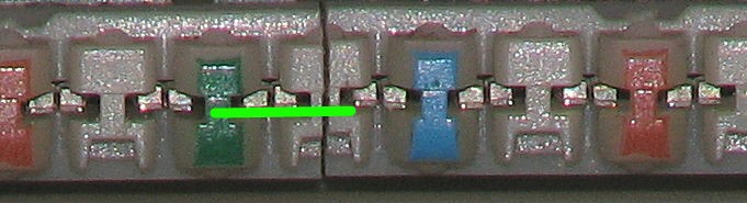

IDC totally wrong shape for those...
Anyway, not an expert on that...or on anything, but insulation displacement may be fine for 5V, but anything more and I would be worried!
Funny, but those IDC things are so prone to working loose, just a wiggle or two and contact is lost...and when you see them stacked up...
Maybe you've run into a lot of badly fitted or poor quality IDC terminations. Broadcast and comms facilities use hundreds of thousands of them because they have a very low failure rate. You can have a wall full of Krone 237A's and be pretty sure there will not be a bad connection anywhere. I have never seen one lose contact with 'a wiggle or two' when correctly fitted.
IDC is also in wide use for power cables and works fine for that purpose again when correctly sized and fitted. We have thousands of heavily loaded circuits wired with IDC DIN terminals and haven't had a fault yet.
Thank you for that Lucien...I simply was not aware of the situation, and my interest has been awakened! I love to hear about stuff I've not met before, and actually, thinking about it, I can readily acknowledge there must be billions of connections in comms relying on IDC. I expect my own ineptitude with IDC on telephone systems is the reason for my wiggle-free problems! I do have a neat inserter though...maybe time I learned how to use it properly! Off to do some research...:)

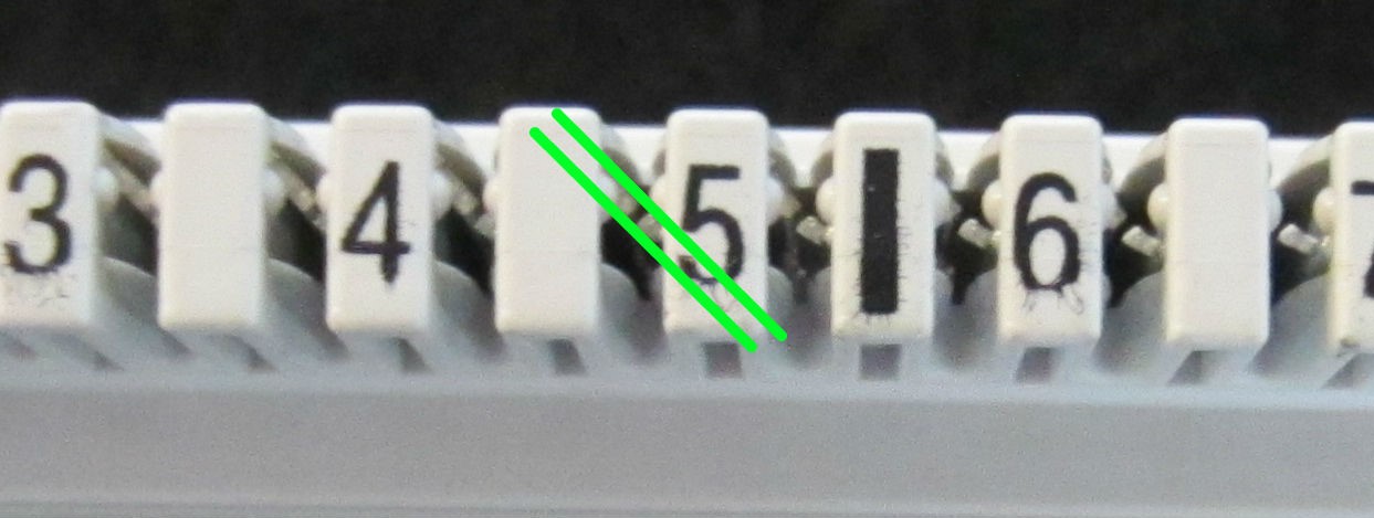

bear in mind that the IDC tools for telephone connections and Data points are different.
That's not strictly true Tel. 99% of everything you find in this country will be Krone LSA plus, i.e. the 'normal' ones. It's very rare to find the '110 block' type. More likely on very, very old equipment, or cheap tat from china perhaps.
How do they differ
The Krone ones have the IDC slot at 45 degrees...
The '110' type are at 90 degrees and need a different tool.

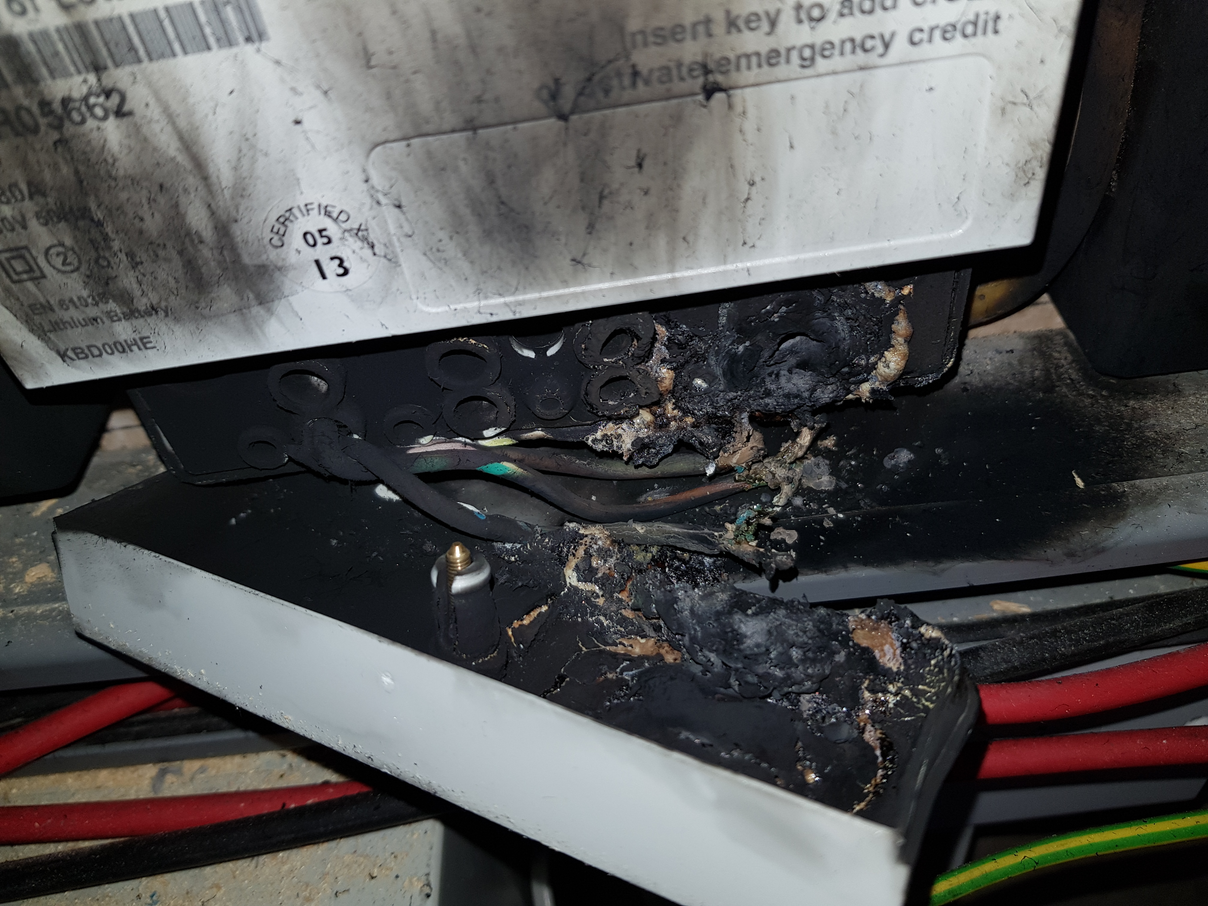

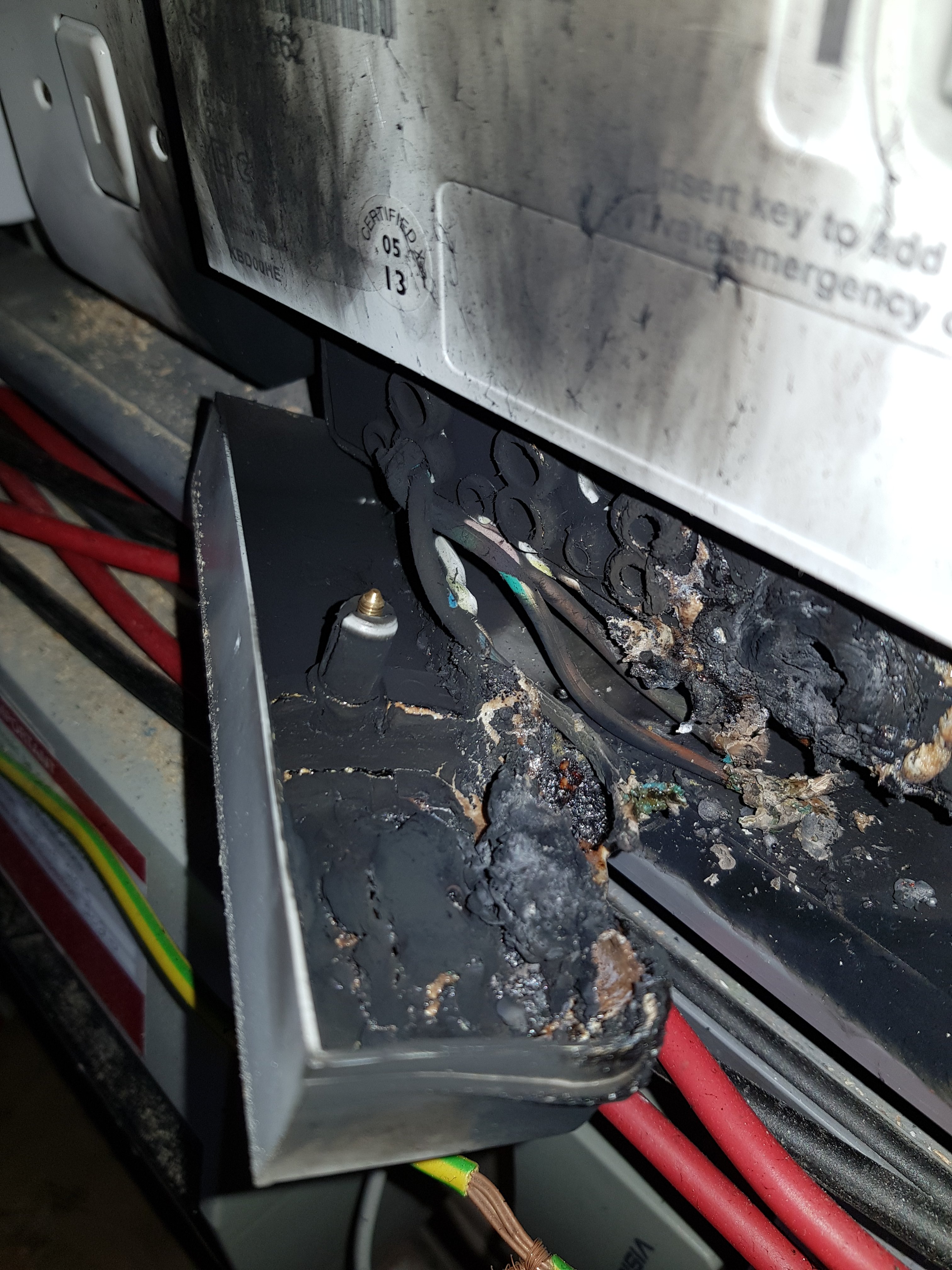

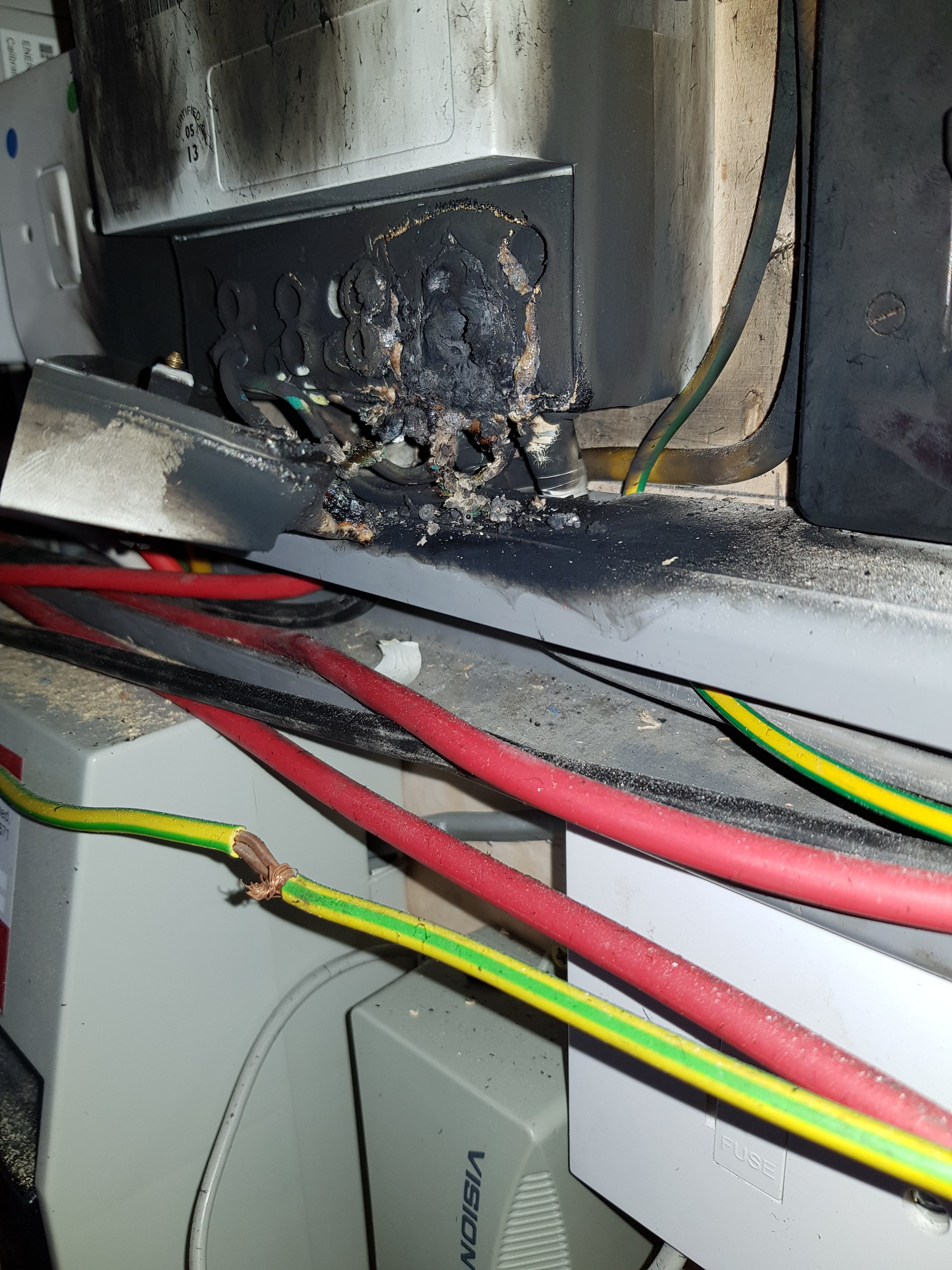

Called to a job where they had only partial power since 10pm previous night.
This had taken out one of the RCD's on a split board.
Prime example of a DIY hero installing his own shower.
Supply neutral terminal had loosened causing heat.
It had been like this for 6 years before finally going out with a bang, while DIY hero was in the shower at the time.
Luckily there was enough spare on the cables to pull through and reterminate into a new pullcord switch.
