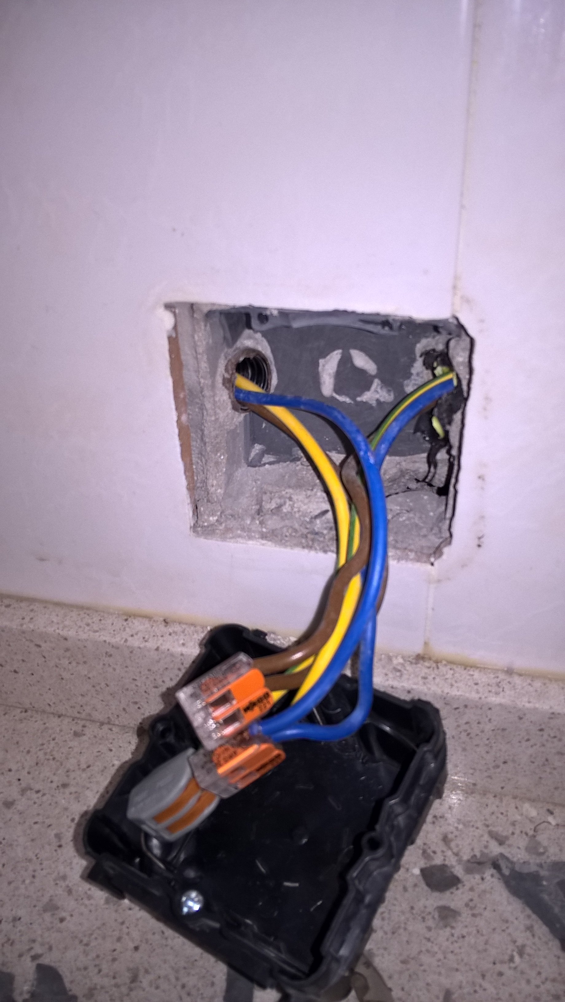

Definitely no ring finals? Daz
Nope. My son and I tested all the circuits, sleeved the earths and wrote a report for the landlord. Only cost us an hour and a half. On quizzing the landlord I established that building renovation work was carried out by an Eastern European travelling circus
Reactions: DPG

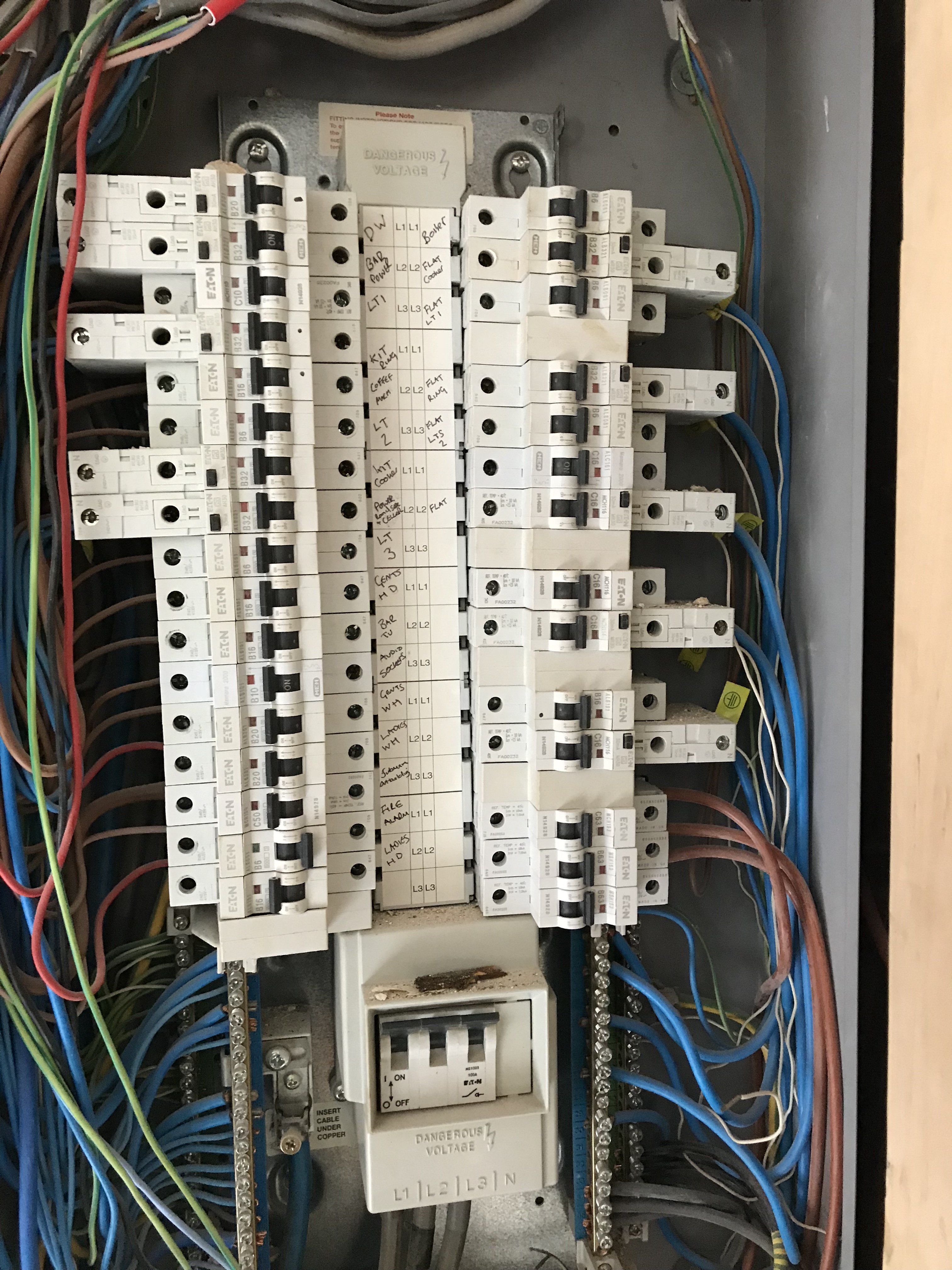

Has it all been fully rewired or have the circuits all been extended, hence the blue brown? Just wandering why there is no RCD protection on the board.
Reactions: Jamchiv01 and DPG

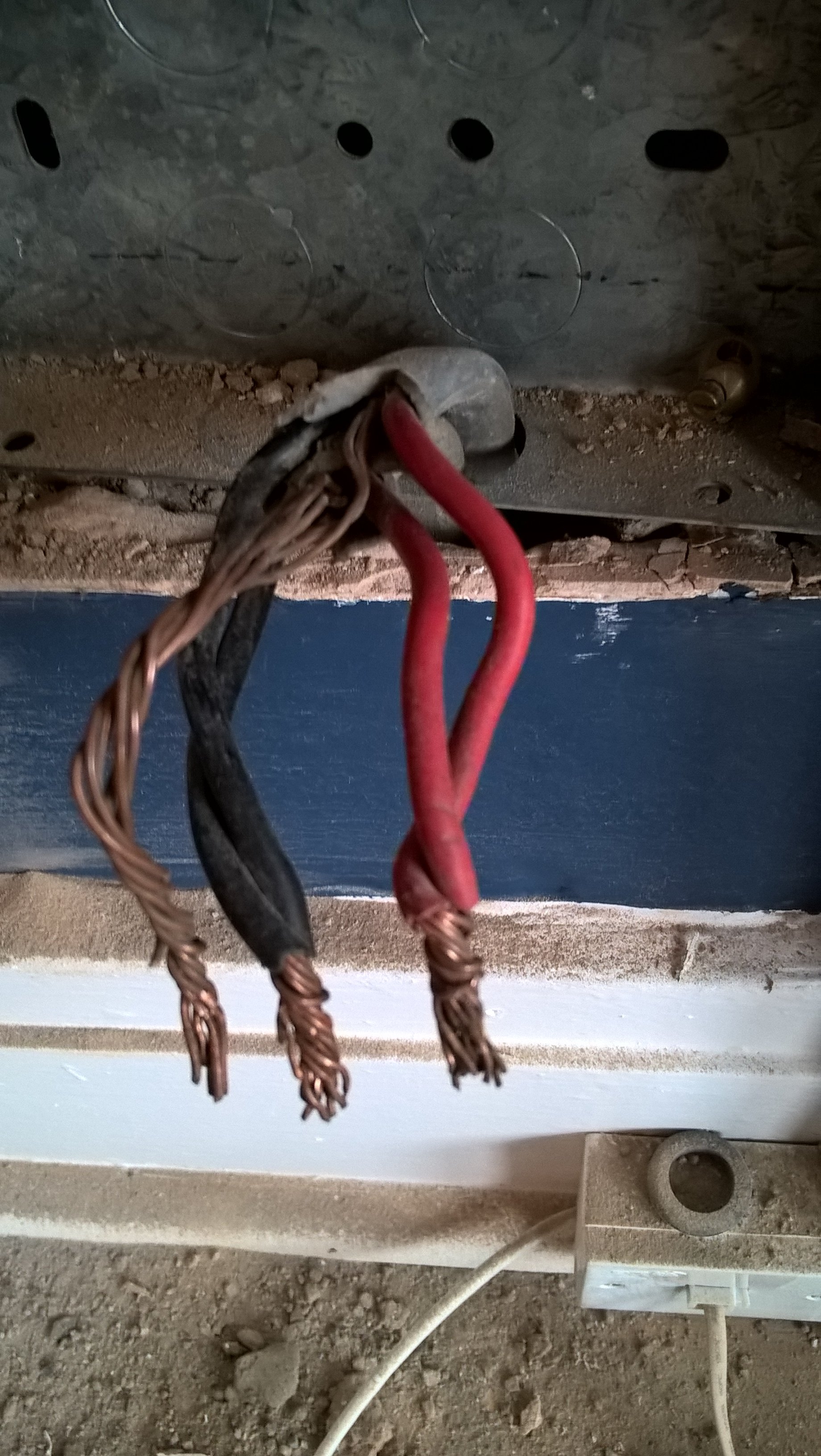

Got asked to reconnect an outbuilding that the previous owners has disconnected from the house. No problem, new swa to the outbuilding and garage C/U fitted but had to laugh when I saw the existing set up. Apparently it was disconnected to get a satisfactory EICR for the house sale rather than fix the many faults.
That's gonna take some sorting out :-) Daz

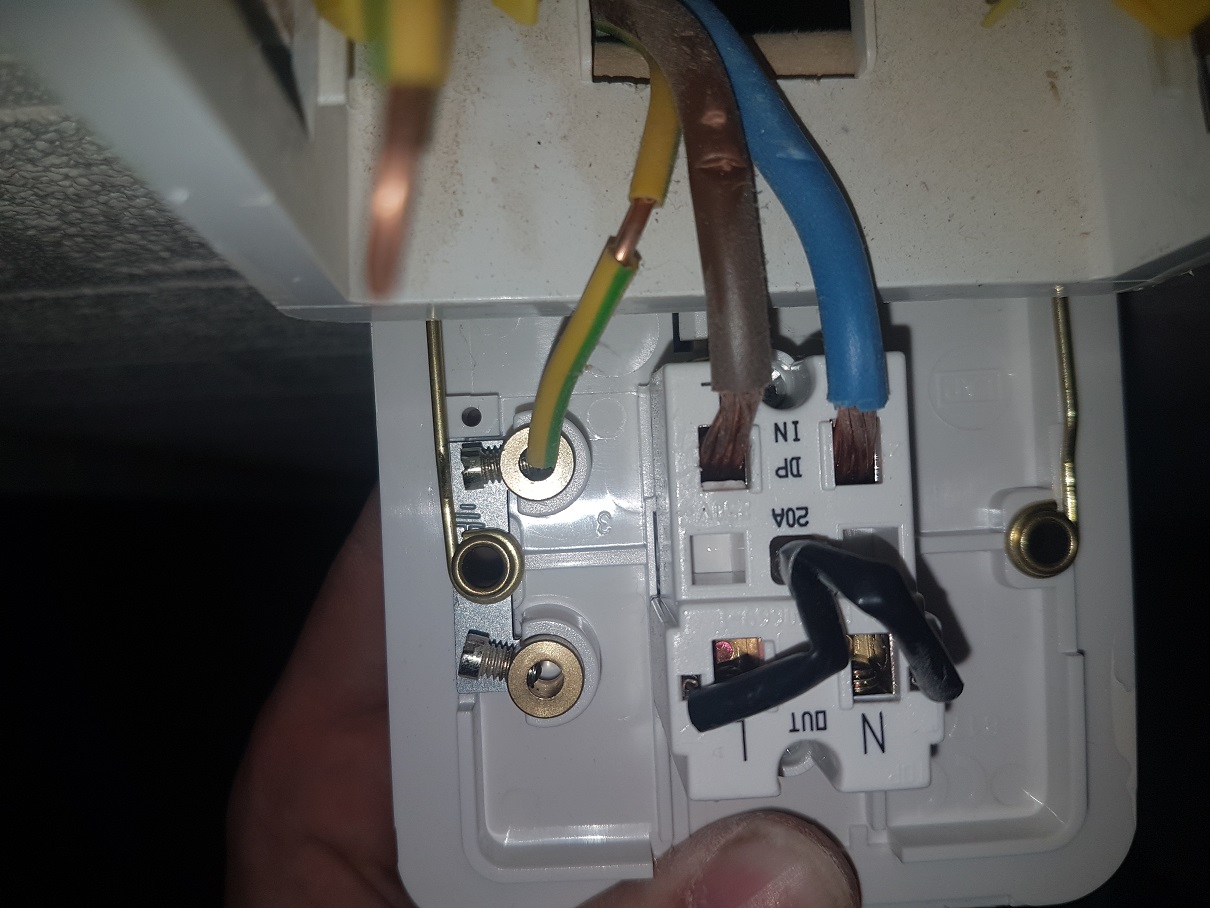

Not sure how dangerous but rather unusual http://i.Upload the image directly to the thread.com/IwTt24F.jpg
Reactions: Iain Kay and Wilko
Yeah water cooler, pulled it forward when pat testing then I noticed the lid was hanging off.

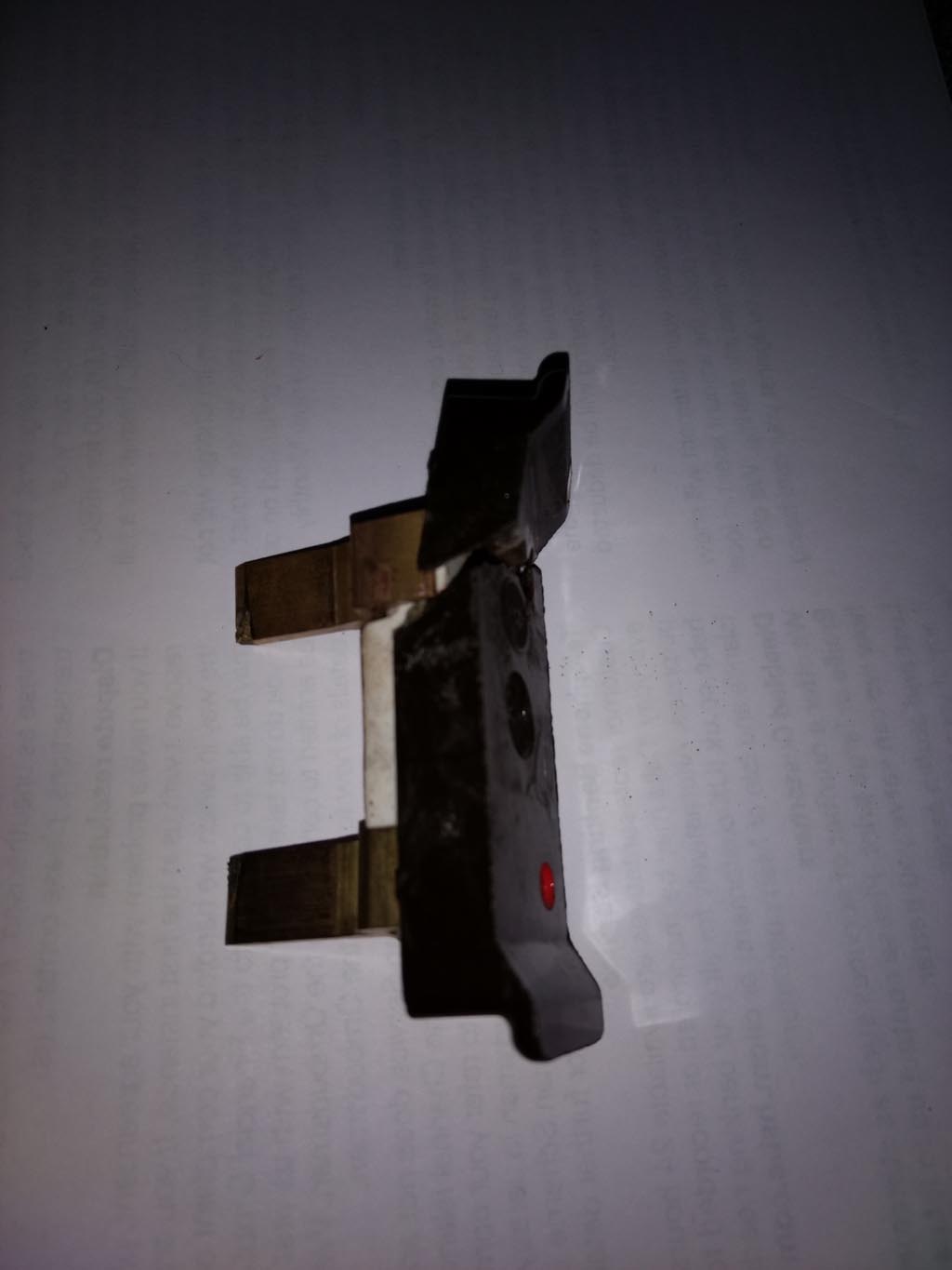

Two more
http://i.Upload the image directly to the thread.com/fELBSRk.jpg
Fuseboard had signs of burning inside and the main cable was burnt near the end and at some point I guess the original main switch burnt out and somebody changed the switch and stuck the cable back in. Luckily the property was getting a full rewire so it was all ripped out.
Working on my mastery of the bleeding obvious - I go for 132.11 Prevention of mutual detrimental influence, so water and leccie should not be in same confinement. And since water pipe might leak, IP rating not sufficient. Thoughts?

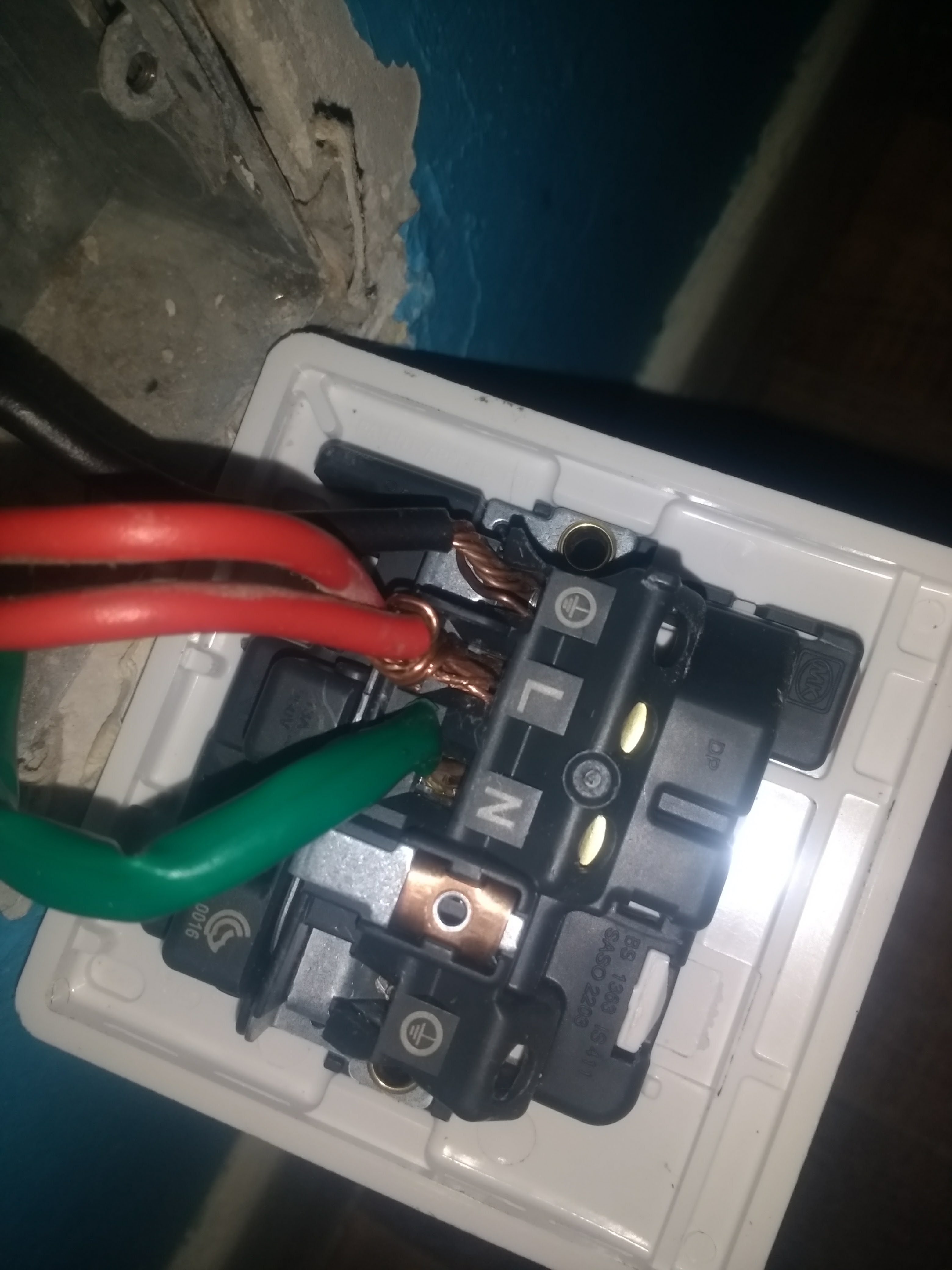

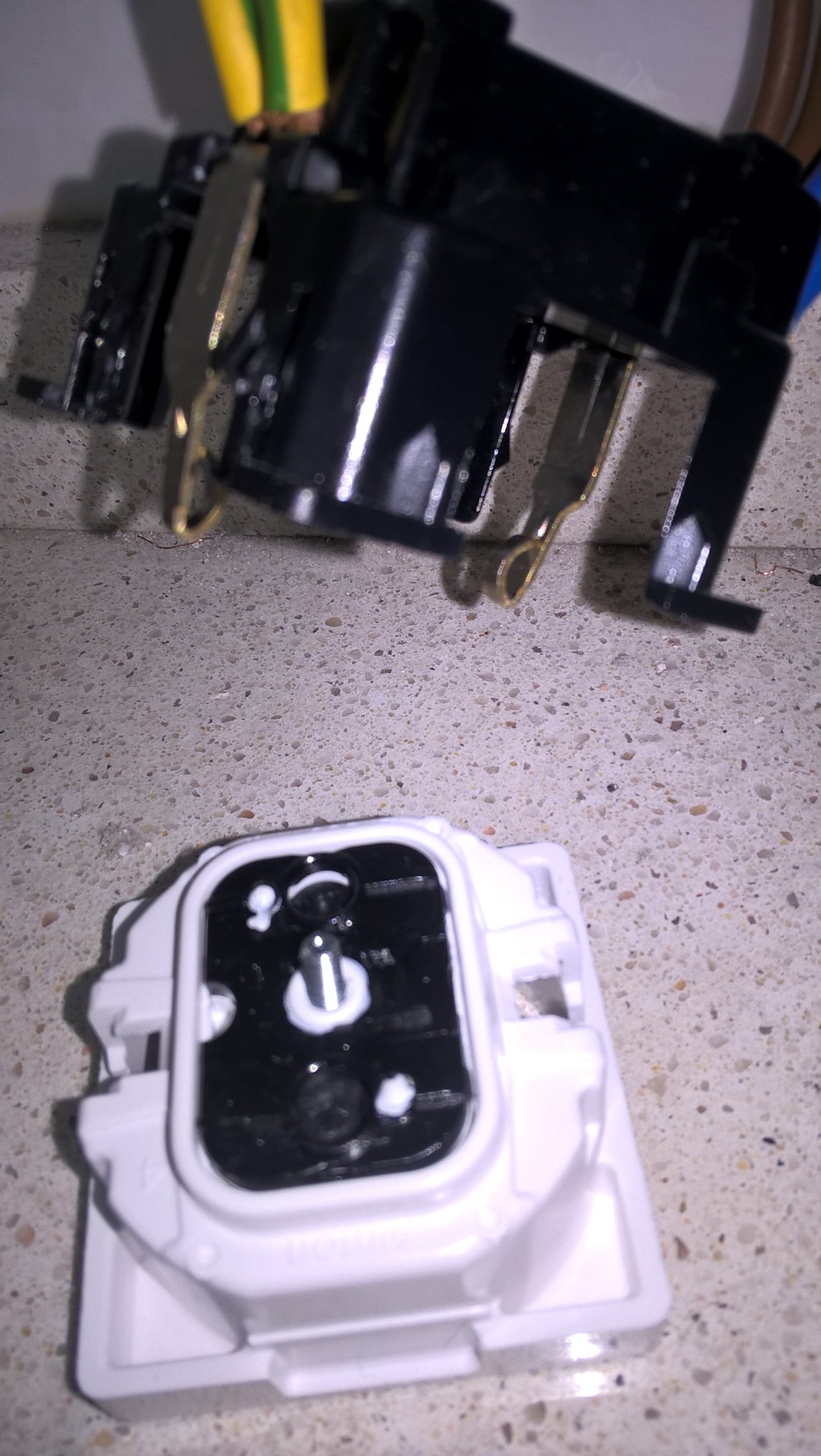

Mates on my course just been doing a house clearance on a rental property. DIY Spurs off Spurs.
Reactions: freddo and DPG
Another interesting arrangement!
Reactions: freddo

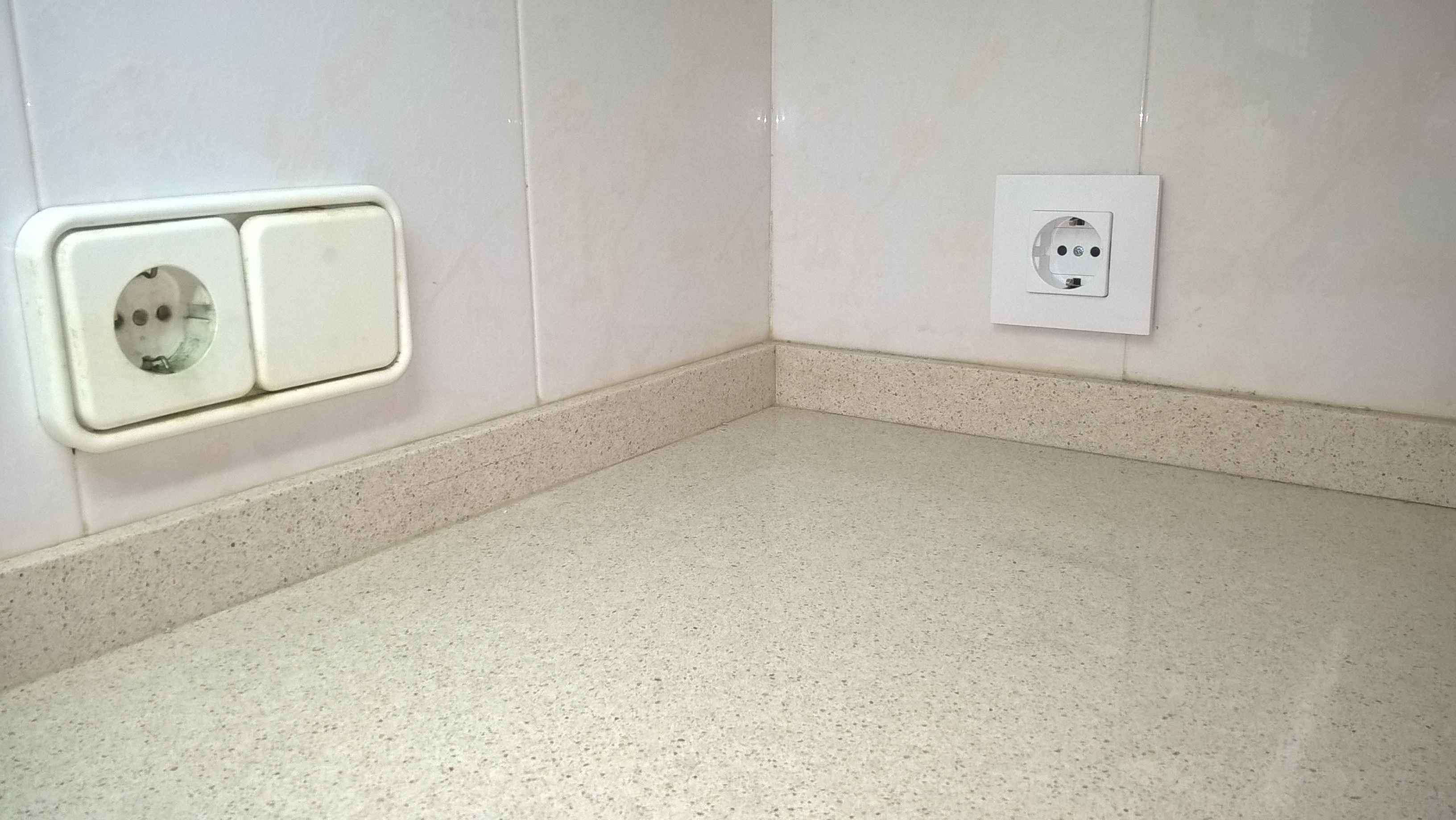

Love the upside down socket! In the first photo it's possible the 2 sockets were fed from an FCU. I'm guessing this wasn't the case though. Daz
Or perhaps were part of a radial rather than a ring? Still rough as though. I've installed a couple upside down sockets before as the need dictated.
maybe the tenant was australian.
