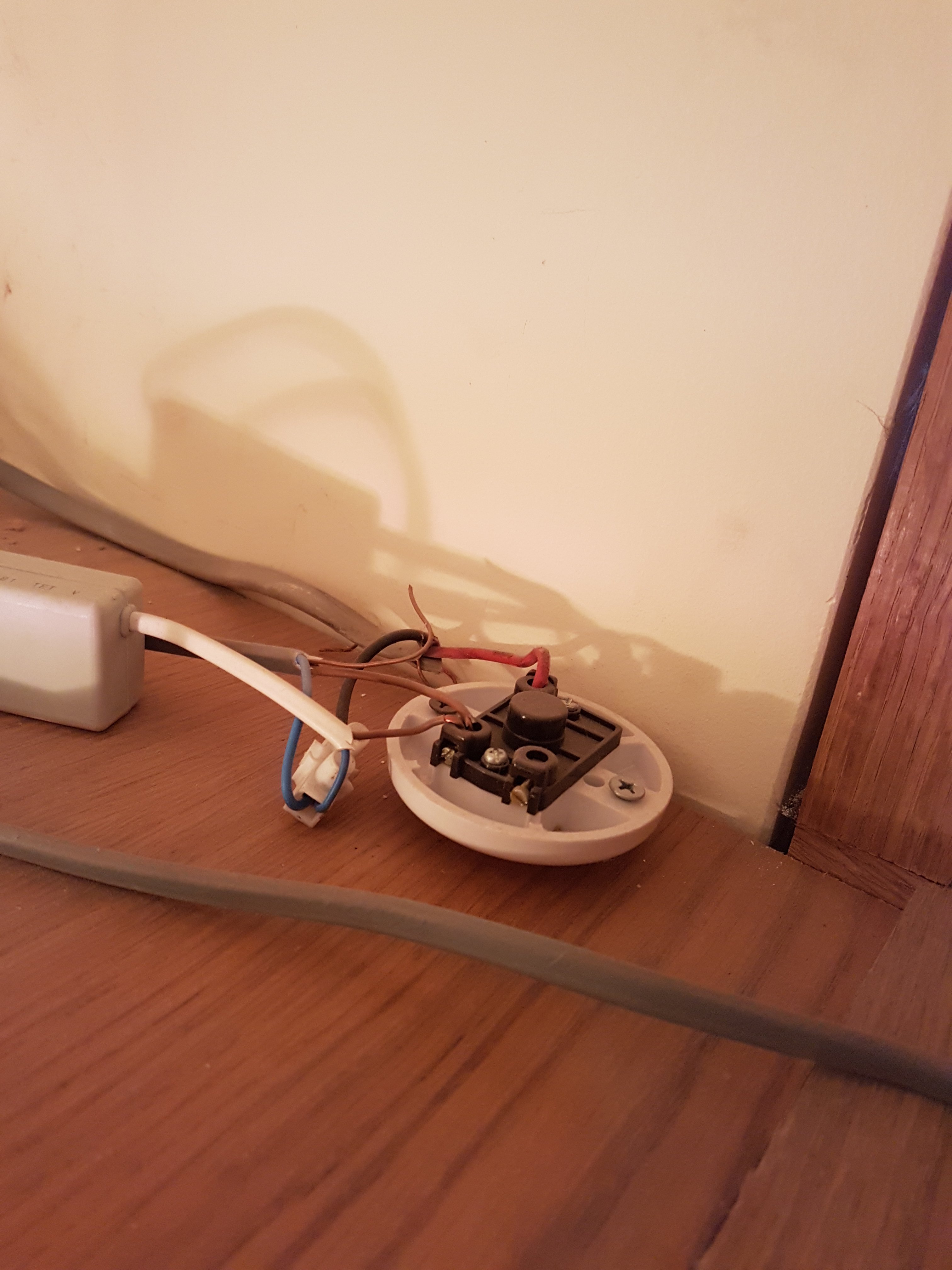

Impressed that you re-terminated that into a new pullcord switch!
I confess that I do struggle unless I have a BIG back-box...had to do it differently on my shower...
No pics, so don't worry!
It is a deep pattress, the photo doesn't quite show it. I despise fitting pullcords. Prefer a nice big 45A dp switch hidden in a cupboard somewhere close by, but beggers cant be choosers.

Westy, thanks for the explanation...I get it now. How, err, mm...ingenious to fit a pullcord that way.
Littlespark, have to agree re big 45A DP in a cupboard...much easier, to fit and maintain.

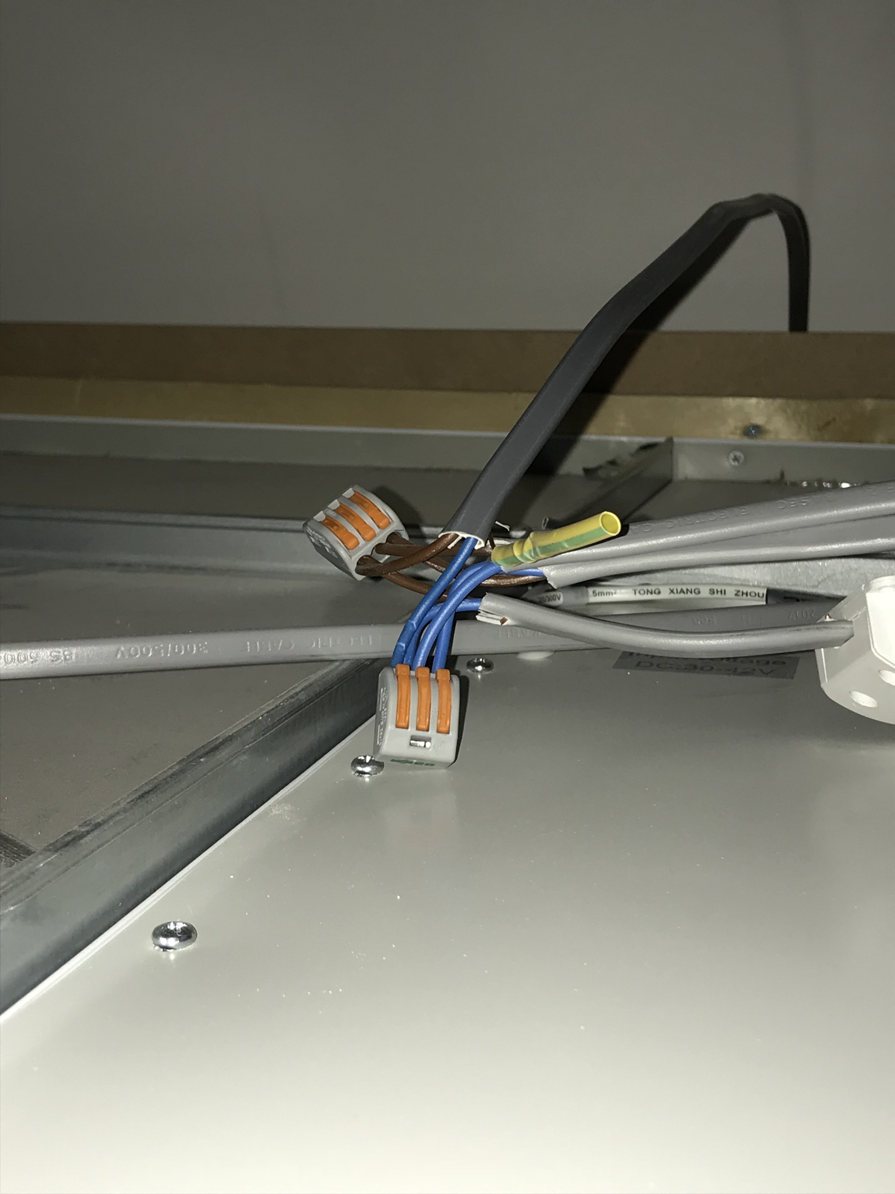

Been to a local bathroom showroom today that is less than 3 months old. I was asked to install several mirror lights into the different bays that they have assembled. Was greeted with this as soon as i lifted a ceiling tile. 600 x 600 lay in grid LED flat panels and this arrangement was above everyone. Asked the manager if they had been provided wih an electrical certificate when it was installed “ erm erm i think its all done in house “, whatever that means. Ended up walking away from the job not as a result of this picture but every bay that they wanted a mirror fixing, tiles were loose and ready to fall off. Told him i didnt want any resulting damage or injurys on my head as a result of any tiles falling. Quite literally thrown up!
I can't quite make it out but is that four conductors into a three way Wago?
Three way Wago? That sounds wrong...
a bit like trying to get 2 pints of ale into a 1 pint glass. ........ sssssimplesss. fill to 1 pint, drink, then add 2nd pint. pity wagos can't do that.
Yeah no
Yes. Not all were like this though, as this one was where an existing mirror light had already been fed from. Although as mentioned every LED flat panel had the wagos above them minus any enclosure.
