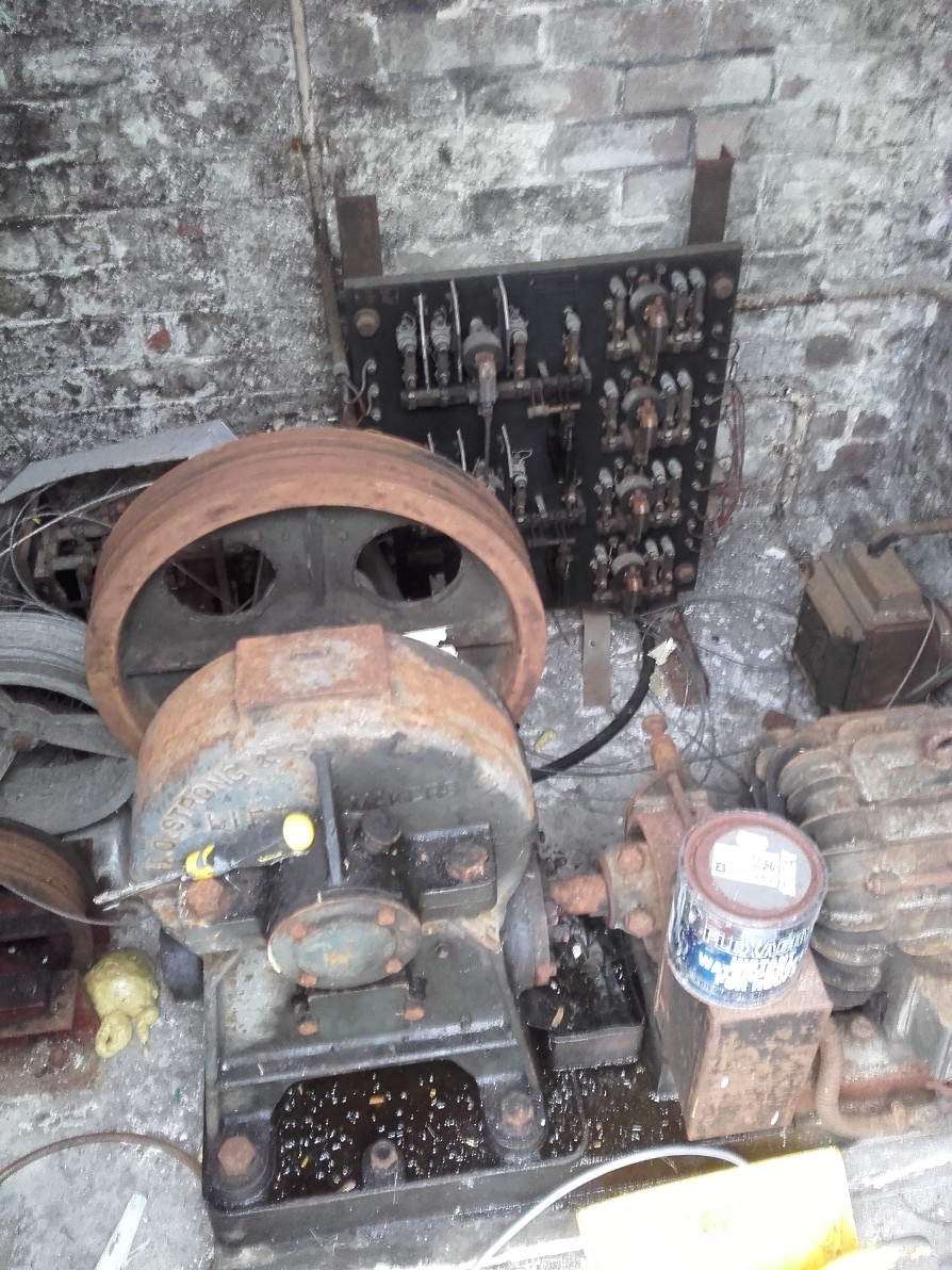

That goods lift controller could be anything up to late 50s, those doughnut contactors are pretty timeless. And yes, the Slydloks are original, they were standard on Evans controllers. Slydloks were specced on a lot of WW2 W^D kit, which I guess helped cement their presence throughout the industry.
So on the left you have the line contactors for the stator, up and down, which are electrically and mechanically interlocked (the interlock bar runs behind the panel). On the right are two rotor resistance contactors, with timing dashpots. The stator is switched DOL, with both steps of rotor resistance in circuit, and one rotor contactor is energised but the dashpot delays it closing. When it closes, one step is cut out and the next contactor is energised. When that closes the second step is cut out i.e. the sliprings are shorted together for full speed. The line contactor auxiliaries also control the brake and lock circuit.
It looks like there are both fast and slow limits for each floor in the selector, as there are terminals UP /DN / UPS / DNS. As the car approaches the floor I expect the first drops out both rotor contactors, then the levelling limit drops the line con.
Freddo's controller is older and uses doughnut contactors for the floor relays. Any clues to the make - I can't read the label and I don't recognise it. The line contactors have dashpots, presumably with a lost motion linkage so that the line and brake contacts operate immediately but the accelerating contact follows later. FWIW the fuses here look like Artic, another specialist brand found mainly in industry and ministry-spec plant.

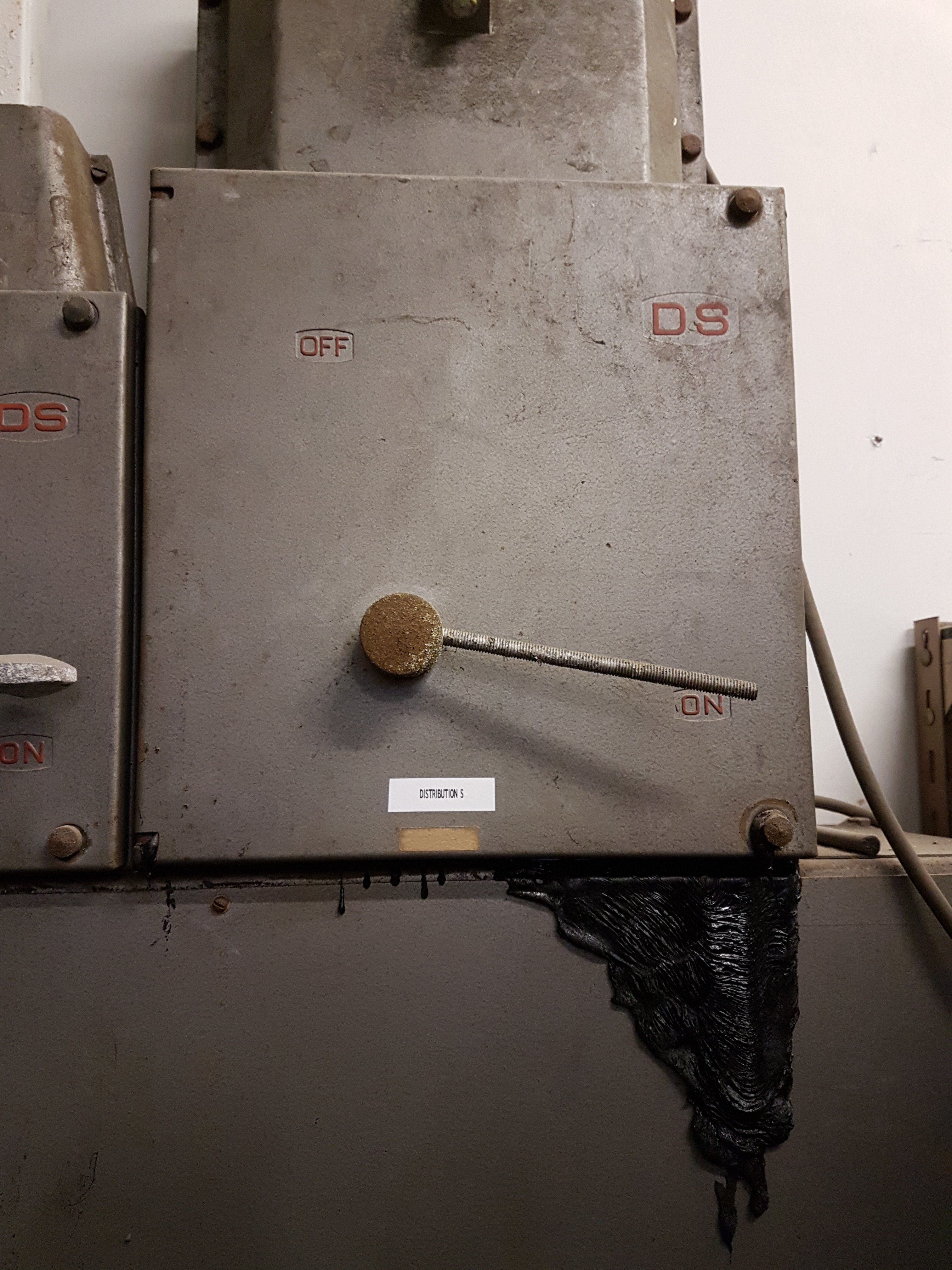

That has been hit with the ugly stick !
Isolate further upstream?
It can be but believe it or not that busbar which was assumed to be redundant supplies a server room. Back tonight to see what has come from the many meetings which have no doubt taken place today to discuss it:D
What's to discuss??;)
I agree Pete. We have been on this site four weeks doing an EICR and found this hidden away in a store room. It was a bit late as we are working nights so no doubt today people are deciding how best to remove it without isolation due to the server room which we have been scouting around. I have my phone off but I suspect when I get back this evening it will have been removed as they have a site electrician.

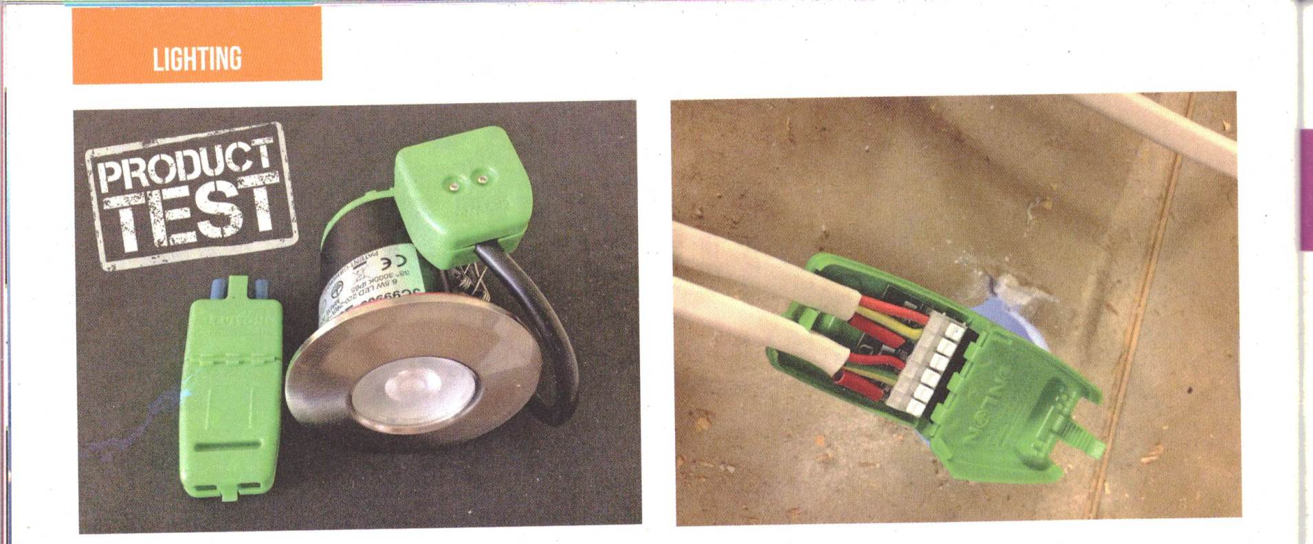

This is part of an article in the PE mag. It has been printed in more than one. I don't know why you would do that. Perhaps the lights were fed from a centre tapped supply...
It doesn’t make a lot of sense that, you’d have thought that some editor worth their salt would have picked up on it. If the downlight can’t work then . . . . ?
We fitted 9 of that range of downlights recently,2 were dead out the box, not even a brief flash or pop at first switch on. One of the 2 replacements was dead too. 2 had faulty LEDs the other had faulty electronics.
