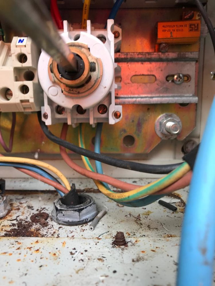

It might be my eyes, but is there a bit of thermal damage there?
Reactions: DPG
Is it it a spli concentric cable...?
looke like a standard red tail & bunched 2.5 copper singles to me
Just needs a bit of work to tidy up?
In that picture its quite clear its a split concentric feed rather than a big bunch of singles.

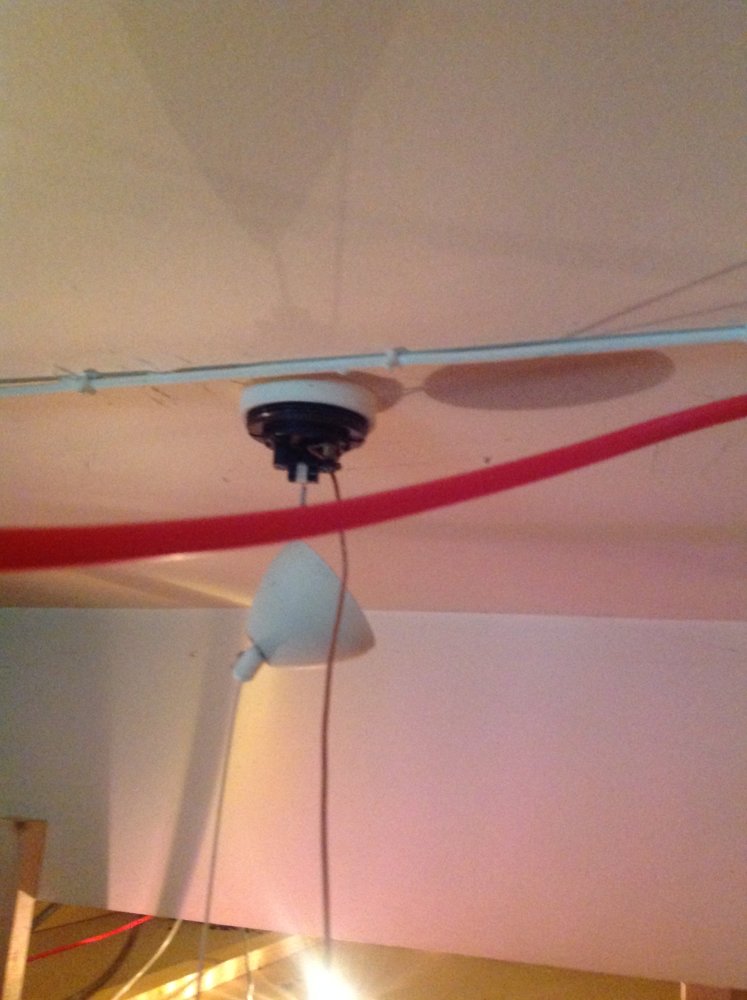

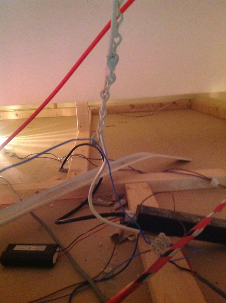

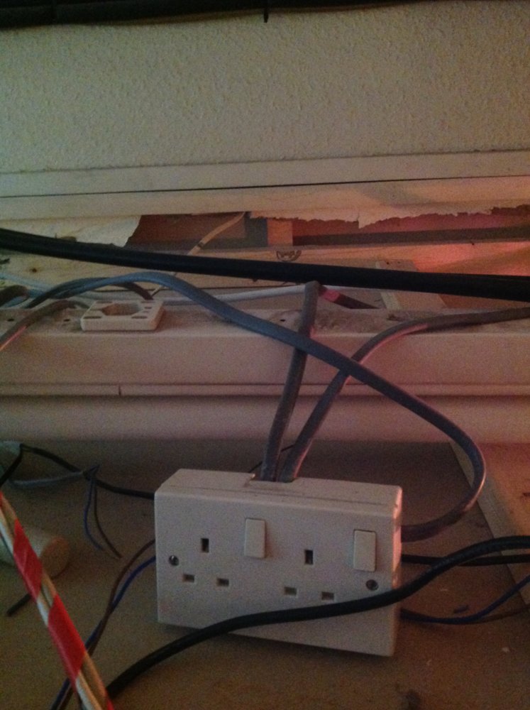

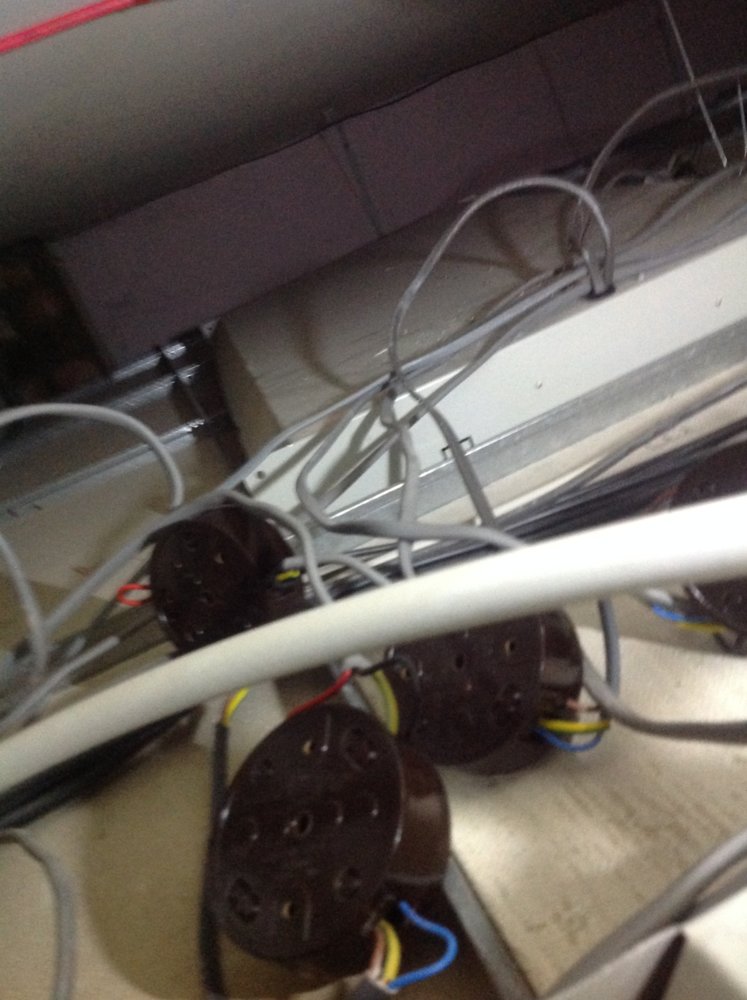

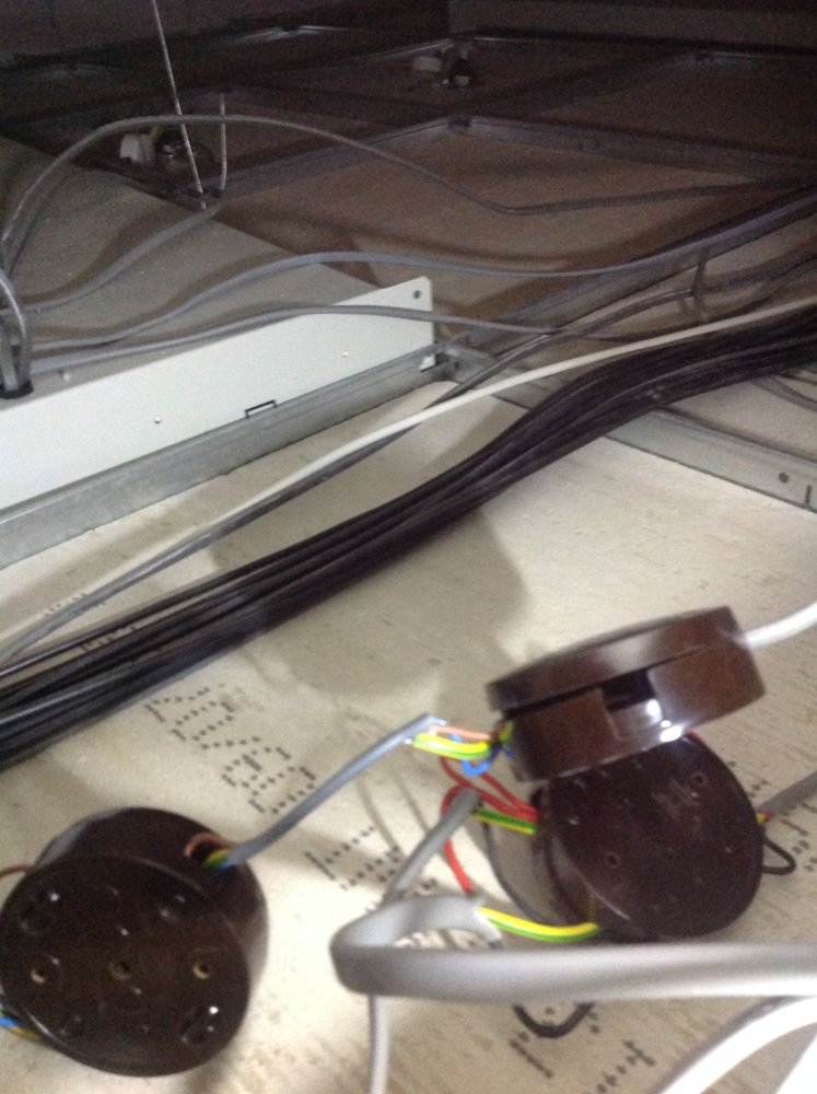

Periodic in local restaurant, guy payed 5k for this shop refit, left all the old 1200 x600 fittings above false ceiling still connected but tubes removed.

Think of the profit you could make by working to those standards!
Yes it got worse there was 415 volts at the Emergency lighting, when they connected the 12 gang light switch up they got there wires crossed sw/perm.

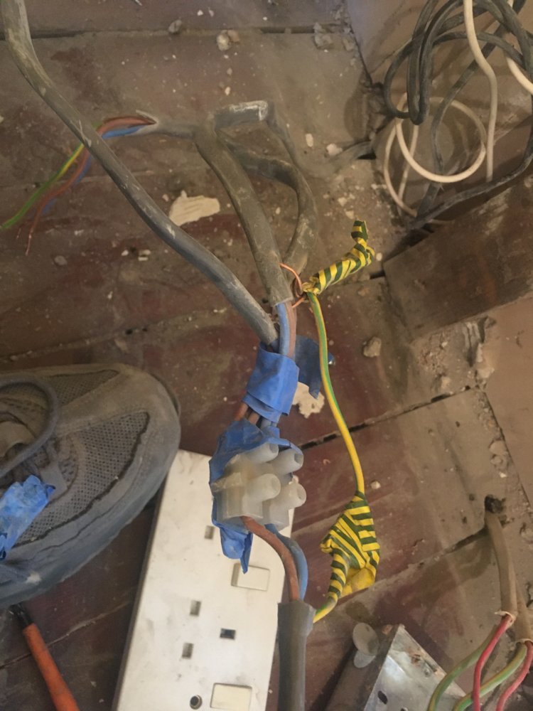

Never ceases to amaze me why people wrap an unenclosed block connector with insulation tape, like it makes a difference.

Does insulating tape not count as insulation then?;)

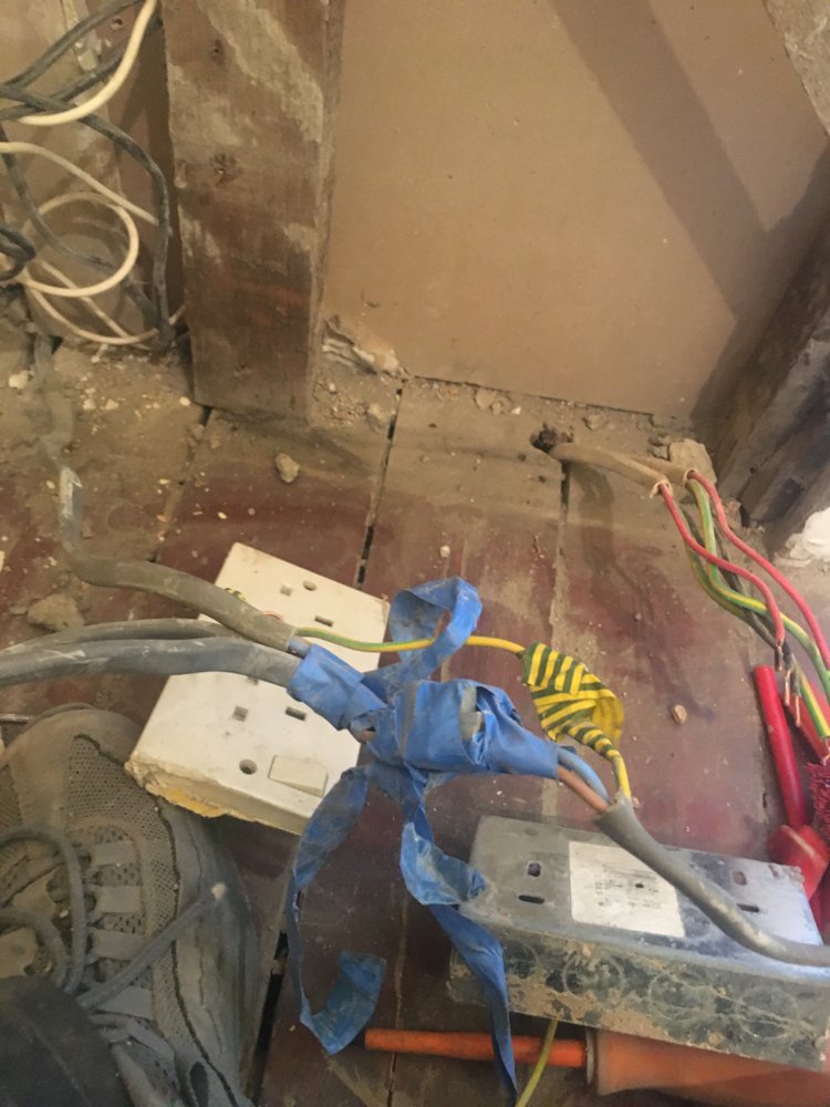

Nice tape joint found yesterday when on an emergency call for no lights working.
I like the earth connection!
What prize did you win for finding it?
I get the dubious honour of making good the lath wall #Winning

I was particularly impressed with the use of g/y tape for the twisted cpc’s. You don’t see that sort of attention to detail these days....real quality.

The 1.5mm wrapped round the pipe was been used to bond. Installed 10mm to water and gas whilst I was there?

A bit of g/y sleeving on that, it’ll be fine.

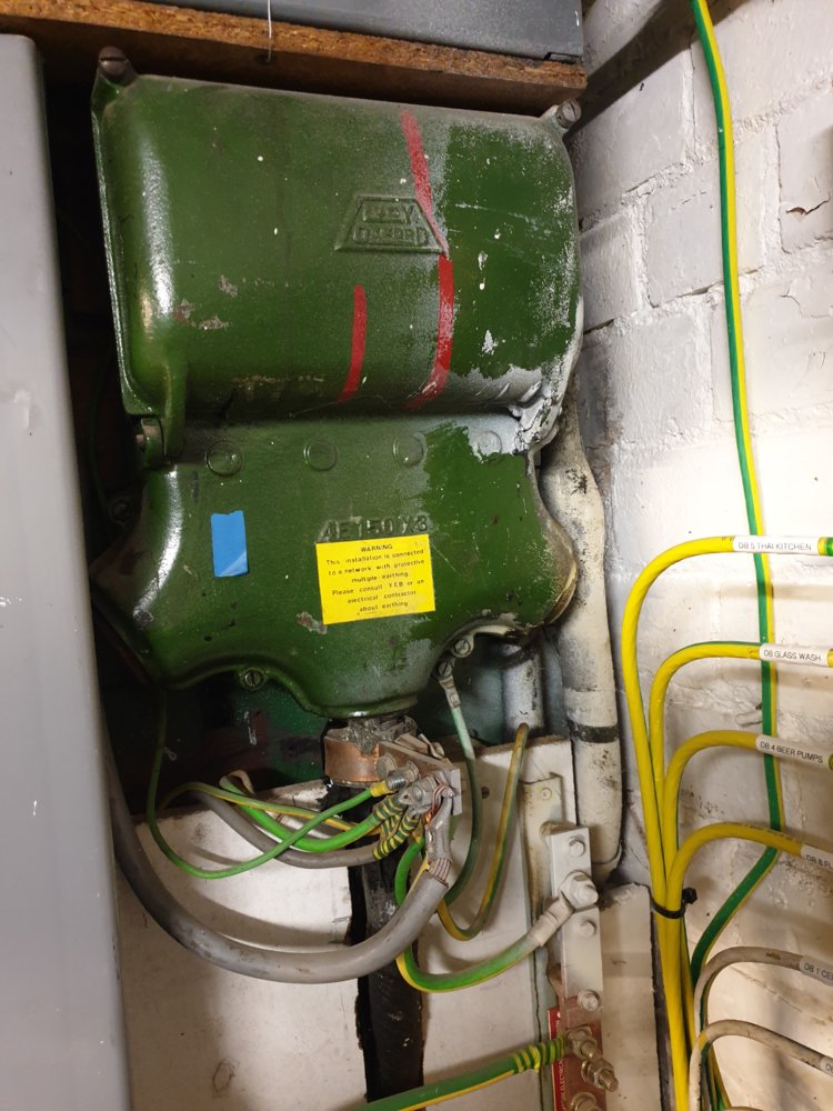

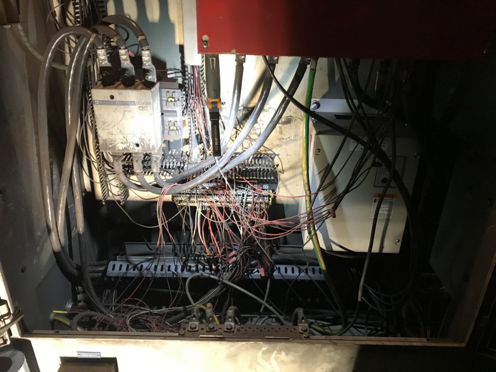

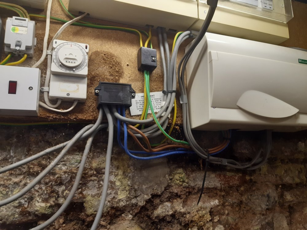

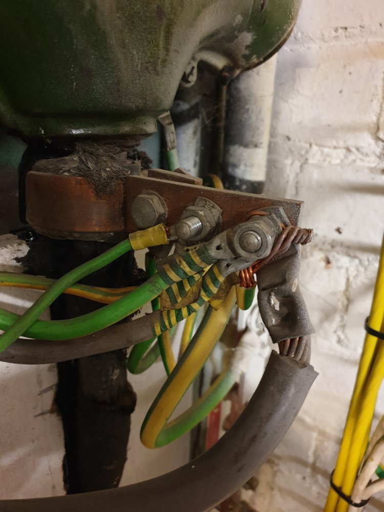

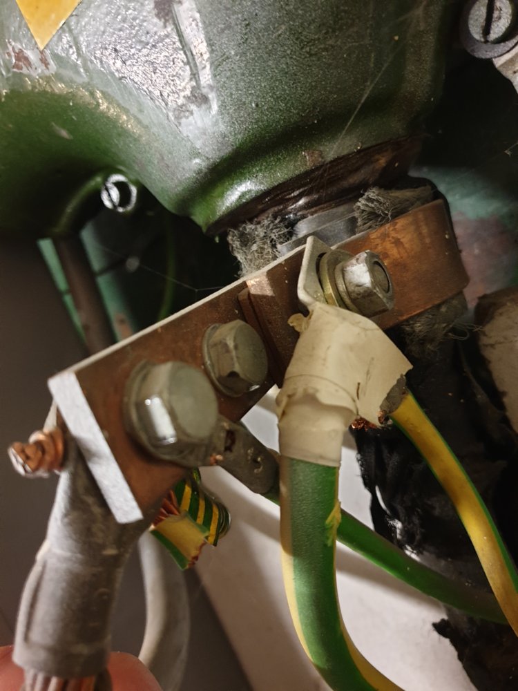

Fantastic job today going to fit a new control panel, PME the sign indicates. No earth available for me to connect to is there. Called out DNO who turned up to tell me "yes it PME, I can tell by the cable and cut out". "Thanks for that how am I going to connect my earth to it"? "That's not my problem the earth is there". "Yea awesome thanks for that, how am I going to connect to it"? "Well I could put an earth terminal in if you want but you will have to pay for it". "Thanks that what I called you out for I need an main earth terminal to connect to".
Got that sorted then go to remove old panel found this !
Yep no flipping earth at all through the lot that earth core being used as L2 is about as close as it gets. F00k it (I don't carry enough spares to sort this out) pulled the fuses and left for the weekend. I'll go Back Monday as I've got some great contractors booked in to replace the lot from the cut out on.
Reactions: westward10
Isn't that the type of cutout that has a little knockout in the side of the neutral section to connect the earth to?
I think the right hand fuse has to be removed to gain access to the screw that holds on the cover over the N-E terminals even though you can knockout for cable access from the outside of the head.
  • Agree
Reactions: ChipFanDave
you can't remove the cover for the neutral/earth without the third fuse being removed the neutral cover also has a seal through it. That's why I called them out. To be honest after a half hour conversation I just gave up the chap clearly couldn't understand what I had an issue with. I'm very fortunate that we have instant access to the DNO and they will always come out as a priority, unfortunately it doesn't include any guarantee of who they send.

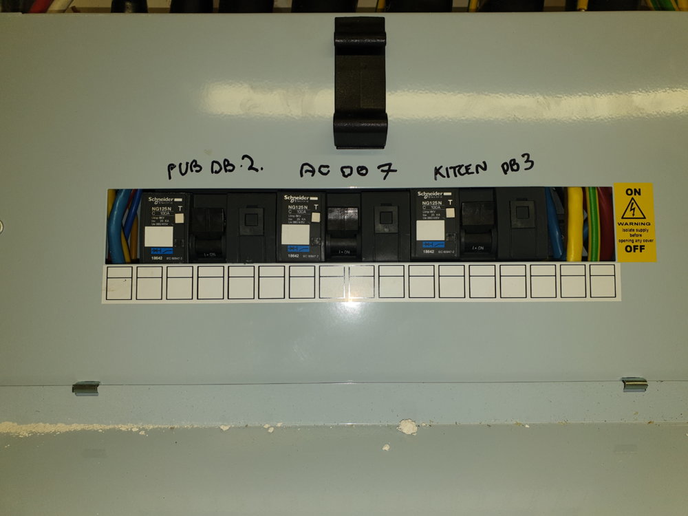

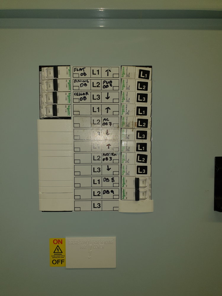

Was called to investigate no power to a DB after some recent work the board was changed by others and just some photos I took walked away and passed back as not getting involved in this attempt 20200227_172444.jpg20200227_171958.jpg20200227_171924.jpg20200227_171939.jpg
I don't think I would have used that board for that task.
  • Agree
Reactions: DT1991
I agree like I said couple of photos for the job sheet and tools packed up and gone.

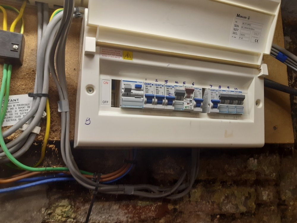

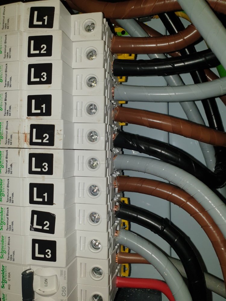

Noticed this today, newish db install supplied with paralleled 10mm2 singles. Moeller unit with only one Moeller device, no blanks. The outgoing cables were just tied to nearby pipes and cables, or just left hanging. Looking at the small earth block, it is likely strands were cut out to make the earth conductors fit, they have very small terminal holes. There is 2 large AC units, 4X 3KW water heaters, 2x 8.5KW showers, a ring final and a lighting circuit connected here.
Cable and wall look unsightly?
No worries just cover it with some trellis and it’ll be right...

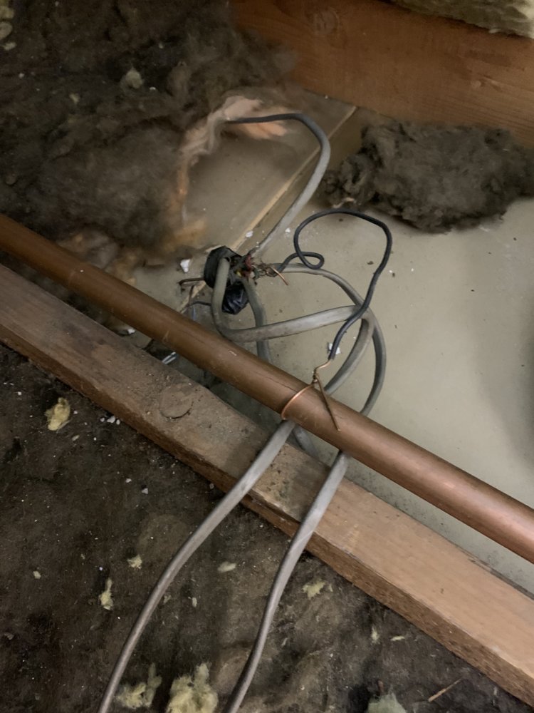

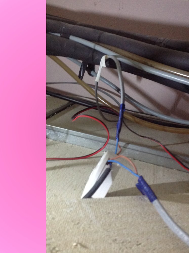

Working on a 1950s semi. Did have a dual RCD board. Upstairs and downstairs lighting circuits. Upgraded to an RCBO board and individually the lighting circuits started tripping. This is the two gang switch on the landing which is two way with switches on the ground floor controlling hall and landing lights.

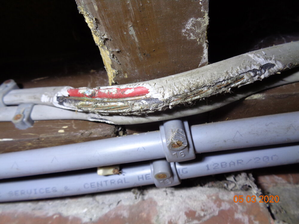

More mundane, rodent damage, the cable failed the insulation test.!
There was more damage round the corner where the cable went up into the roof.
Now replaced with SWA.
Reactions: static zap
