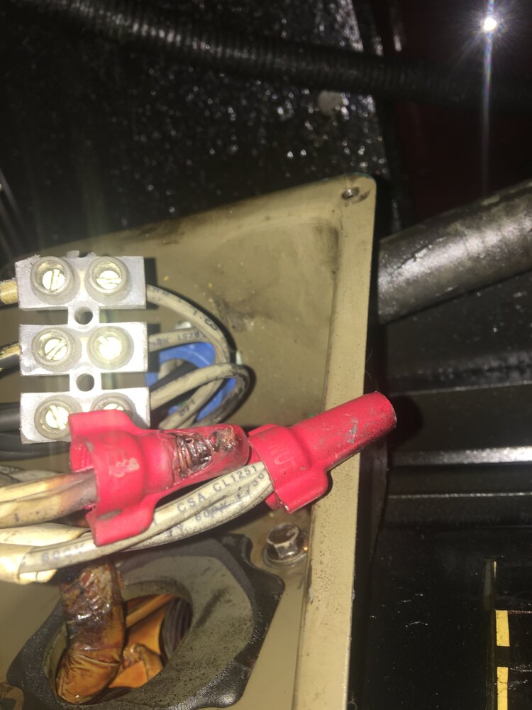

inside a 22kw motor on a machine that i was fault finding today.
strange, at panel end, all motor cables had good continuity to earth. (expected to find a well burnt out motor)
went to motor to check out there and all was fine.
opening cover had removed the short to earth.
got to love the old wire nuts!!!

Was it poor connection inside the wire nut that had caused the melt? or overload?
I still have a few from when Ideal tried to bring them back over here maybe 10 years ago? Never tempted to use them, though I have a couple of the waterproof gel filled ones in my bag for outdoor bodgery...
As far as I can tell, it was not an overload, it is inverter controlled and the current limits set correctly.
Working on the assumption that it was a poor connection as the others were ok and it is an equal load on all of them

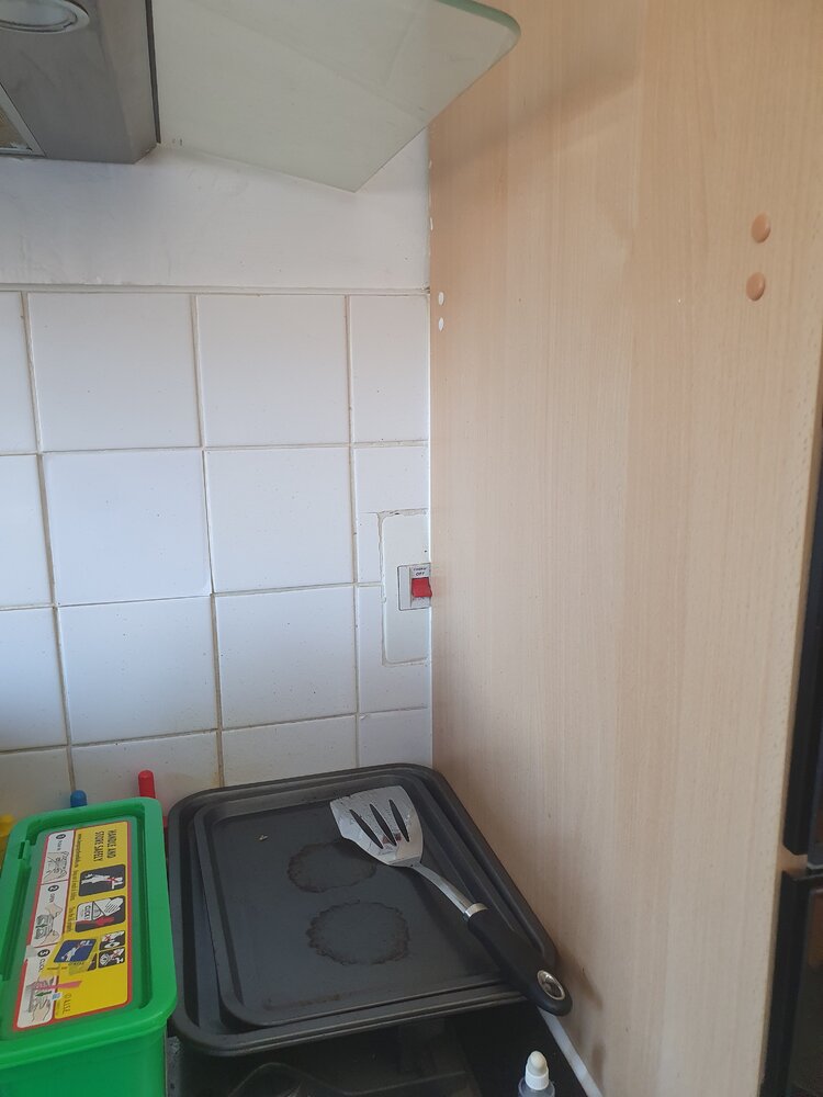

don't tell me, replace cooker isolation switch.
cant damage tiles or cupboard because they have just been installed?!!!

Good grief you would have to be either very lazy or very stupid to install the kitchen unit over the switch like that. Not to mention it looks awful.
Previous owner DIY'd it apparently, so hopefully they are planning to retile. All a bit odd - all RCD sockets in the kitchen, though a dual RCD CU was installed in 2015.
Oven that's blocking that switch doesn't seem to be run from it (might be from a socket outlet if that switch has one behind the cupboard - in which case a 4.1kW oven is running off a 13A plug)
And an Elecsa EIC for the new board that claims the 6mm Cooker circuit has ring continuity while the 2.5mm "Ring Circuit" doesn't :rolleyes:
Not to mention that it claims 10mm main earth when the feed is 16mm T&E, and the 2 10mm g/y cables leaving the CU don't go back to the MET.
Going to be a fun can of worms to open.
Still, on the plus side I installed a new Fusebox CU at the source today (adding a couple of circuits in a porch) so they have SPD for the installation and proper bonding at least.
Classic case of "job and finish" fitting a cupboard like that. No concern for the future use, no pride in workmanship, just shove it in and take the money. Makes me very angry...and seen far too often. Bet the fitter said proudly to the homeowner "Look, there you go, I've cut that just perfect so you can still use the switch".
However, it could be fun if you were ever called to rewire Kev's house...T&E clipped direct to the tiling in the kitchen, use up all your round edged socket plates on his square edged back boxes, and of course use plasterboard screws for everything, and no wall-plugs...
Except, Electricians have standards to adhere to...
