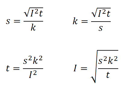

Recognise any of these equations?
That's one reason why knowing this stuff might be useful :)
