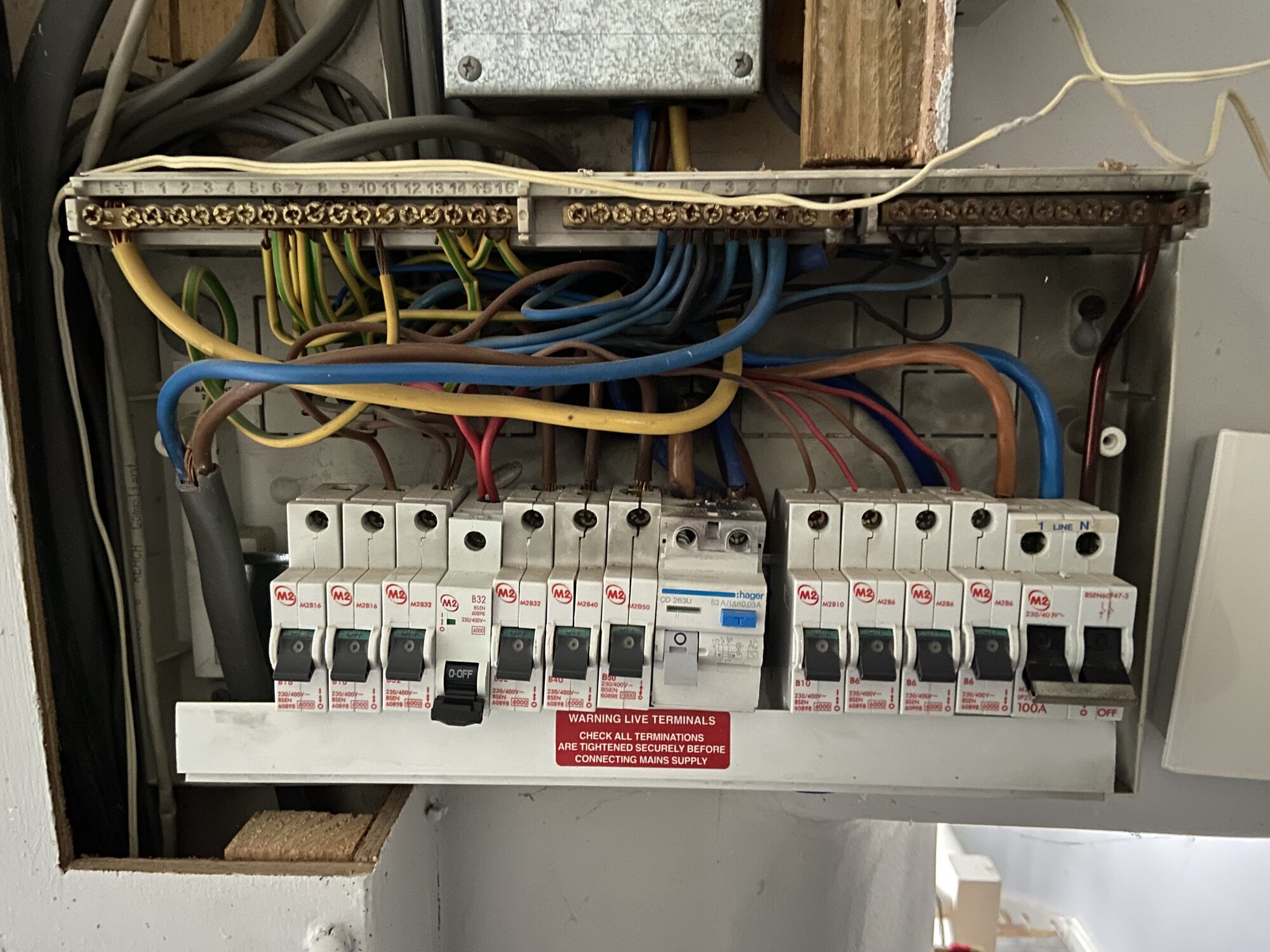

Getting on site, I see there was some details missing…. Like the other half of the board. Customer sent the first pic.

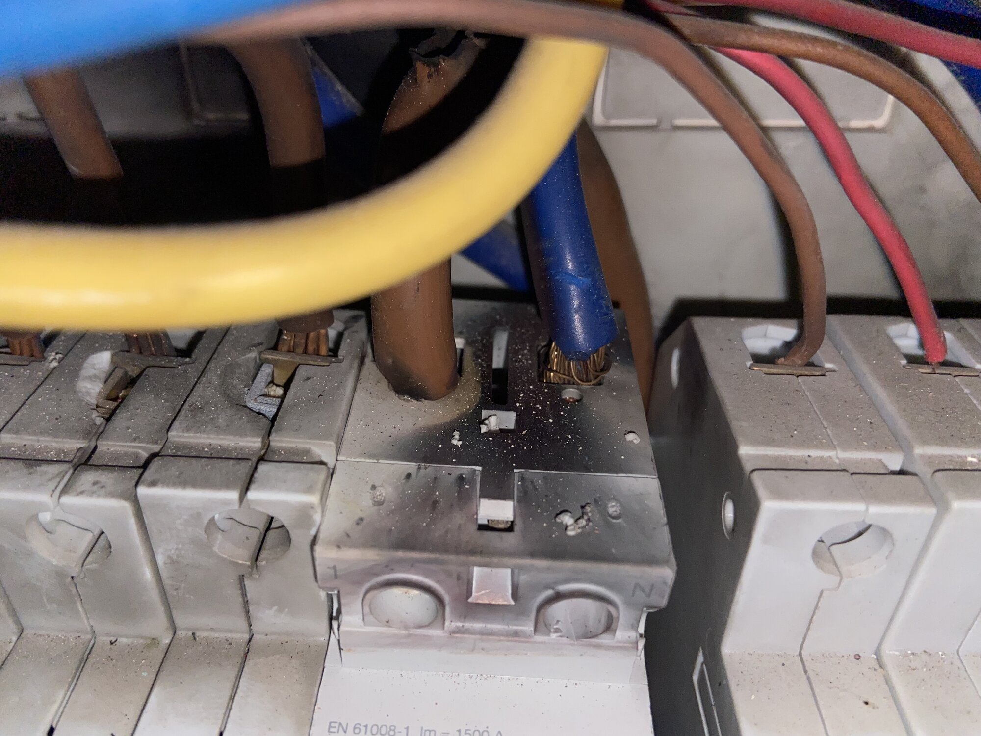

So RCD looks a bit black, as does the 50 and 40….
As a stop gap before Xmas, I cannibalised a new Wylex board and replaced everything on the left.
There was a dead short on the feed to the rcd…. Insulation melted through, blowing the main fuse. SP replaced a 100A with an 80 for some reason. The switch fuse supplying the Swa to here has a 100 in it.
Customer said the fuse blew when the shower was on, AND the oven… so I thought simple overload. Left shower disconnected as I didn’t have a wylex that size.
Turns out their boiler is electric… takes 12kW and is on same 50A mcb as the shower.
Will be getting a board change out of this, but after new year.
What was causing the dead short though?
It was the line feed. Was pressing against the neutral bar as it melted through.
Overheating due to 12kW boiler and 8.5kW shower on at the same time.
50A mcb welded closed, 63A rcd welded closed, 100A fuse in sw/fuse intact, but took out 80A main fuse….. three times!
They kept turning it on and blowing the fuse.

If the main switch has been closed on a dead short three times, I'd be checking that it's still breaking both poles.
Reactions: timhoward
You can get priority relays for electric boilers if there is an electric shower installed.
Amptec call theirs RL1 Relay. Not cheap but probably wise on an 80A main fuse.
Yes. Checked that before powering up.
Will change the remaining breakers plus mainswitch to M2, or change the whole lot (breakers plus box) to the wylex.
Depends how far the customer budget stretches
