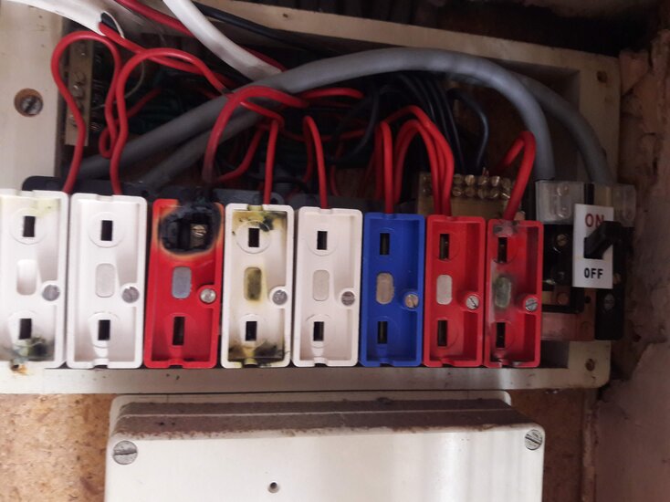

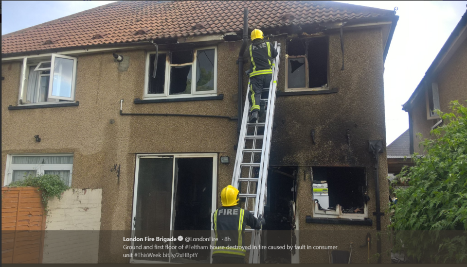

This popper up on my twitter feed tonight, shows a house gutted in Greater London from fire due to a consumer unit fire.... Make sure you double check your terminations and installs and it can almost always be avoided if you do things properly.
Fire brigades are noturious for blaming fires on electrical faults, without actually pinpointing exactly what it was so probalbly woryh taki g this with a pinch of salt.
As for telling us to double check tightness I would like to think that people do that as a second nature without actually having to think about it.
I would like to think its 2nd nature too. See far too many loose wires though.

not true, i was doing an eicr on a very new property that was about to be leased out, cooker mcb had about 15mm of copper showing above terminal, switched it off and gave it a little pull and out it came
only decent sparkies check their connections are tight

Agree Dillb, we all used to check, but today? who knows what or who is doing electrical work?
Over the course of a working lifetime, connecting & double checking thousands, possibly millions of terminations, do you not think you might just leave the odd one or two loose?
We are all human, prone to make mistakes.
But hey a fire rated enclosure or DB will help solve the problem wont it :fearscream:
Now you are taking the proverbial? best way would be to improve training.
Because in my opinion, poor training and Plastic Electricians are the main cause of consumers unit fires. Seems that the main thing these days is to make the install of CUs look pretty, cable tie all the conductors together, take pictures and post them on line, hoping they will get brownie points, rather than, ensuring the connections etc are done properly.
Saying that, doesn't mean it should look carp, but safety is the best option, By the way, good morning, have a good day.
