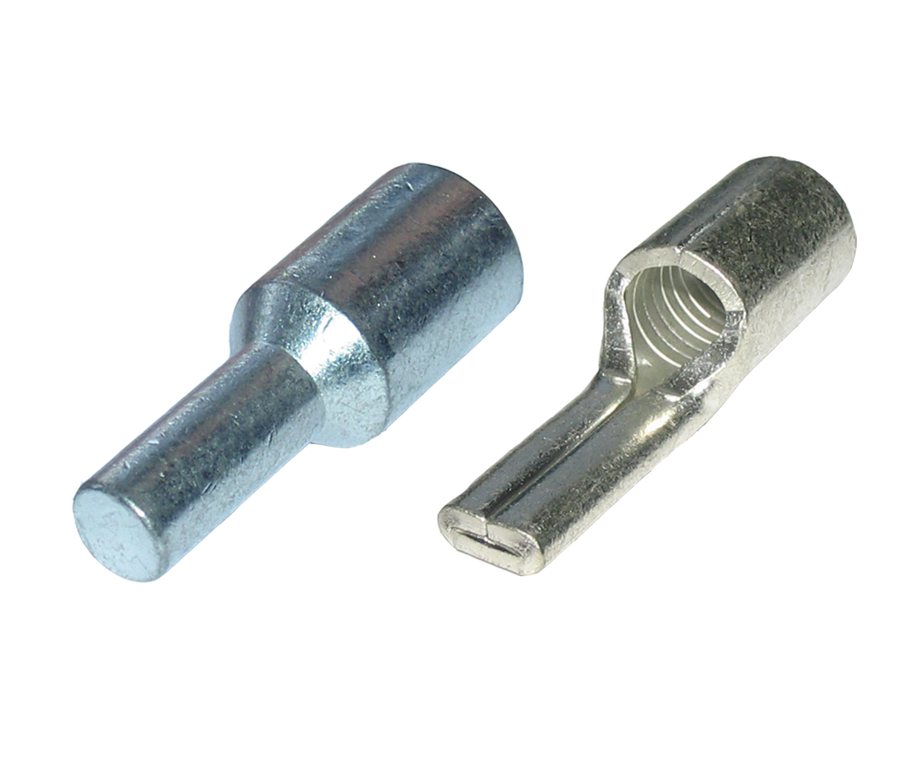

A donut of a builder has helpfully run a piece of swa two core 16mm to a small feature fountain fitted with 1.5mm flex, suggestions on best way to join, couldn’t get the 16mm in a wago!
Whats it going into at the other end? In this situation, I can't see any technical reason why just putting one or 2 strands of the 16mm into a wago and cutting the others off. You would probably still have to put heatrink over the end to insulate the rest of them. Not sure how easy it would be to justify/sign off though.

Crimps did the 16 > 6 in spec, 6 fits in SWA small gland. seemed neatest way i could think of at the time i did it. Cant remember if i wago'd it or terminal strips but 6mm > 1.5mm flex is probably Wago compliant.
Wot about using a reducing pin or lug.

What is wrong with a bit of 60A terminal strip in a moulded box and a crimp on the flex.
Gland the SWA into the box and put the 16mm² in one side of the terminal block and the crimped flex in the other.
And you could place the ferruled end of the flex neatly in the strands of the 16, that would work and be cost effective.

I've been looking in my recycling bag and have found some old CU brass connection blocks, I am thinking judicious use of an angle grinder and some heat shrink all housed in a wiska box and Bob's your uncle.......!
If the size of the conductor is going to be reduced from 16mm to 1.5mm then, leaving aside the IPxx rating, and providing its all tidy and insulated, could someone please explain why the suggestion of using a single strand into a wago would be frowned upon. To me it seems a practical way to reduce the conductor. What am i missing?
Electrically, of course, it would be fine. It's the ethics that are screwed up here. Leaving strands out of a termination violates a fundamental rule that is deeply imprinted in any (good) electrician's brain. Plus the Wago instructions would probably be disobeyed in two or three different ways.
A technically correct solution would be as suggested by Shaun1, to terminate the two cables into appropriate-sized DIN terminals and link them with commoning bars. Or to crimp on some suitable ring terminals (e.g. 6mm hole) and connect them via DIN-rail mounted insulated stud terminals. I have used that method before, for widely disparate cables sizes. There are all sorts of halfway house options, like lap crimps. Soldering, if done with skill, could make a nice job of it.
But I might still go for the 1-strand-in-a-Wago. In an outdoor terminal box, the less exposed metal and fewer things to corrode or create leakage, the better. From a purely engineering standpoint, provided the heatshrink job is well executed, it might be the most suitable technique. I leave for the reader the agonising consideration of inter-strand resistance after a few years of moisture ingress, vs. the equalisation of current between strands along the length of the cable.
