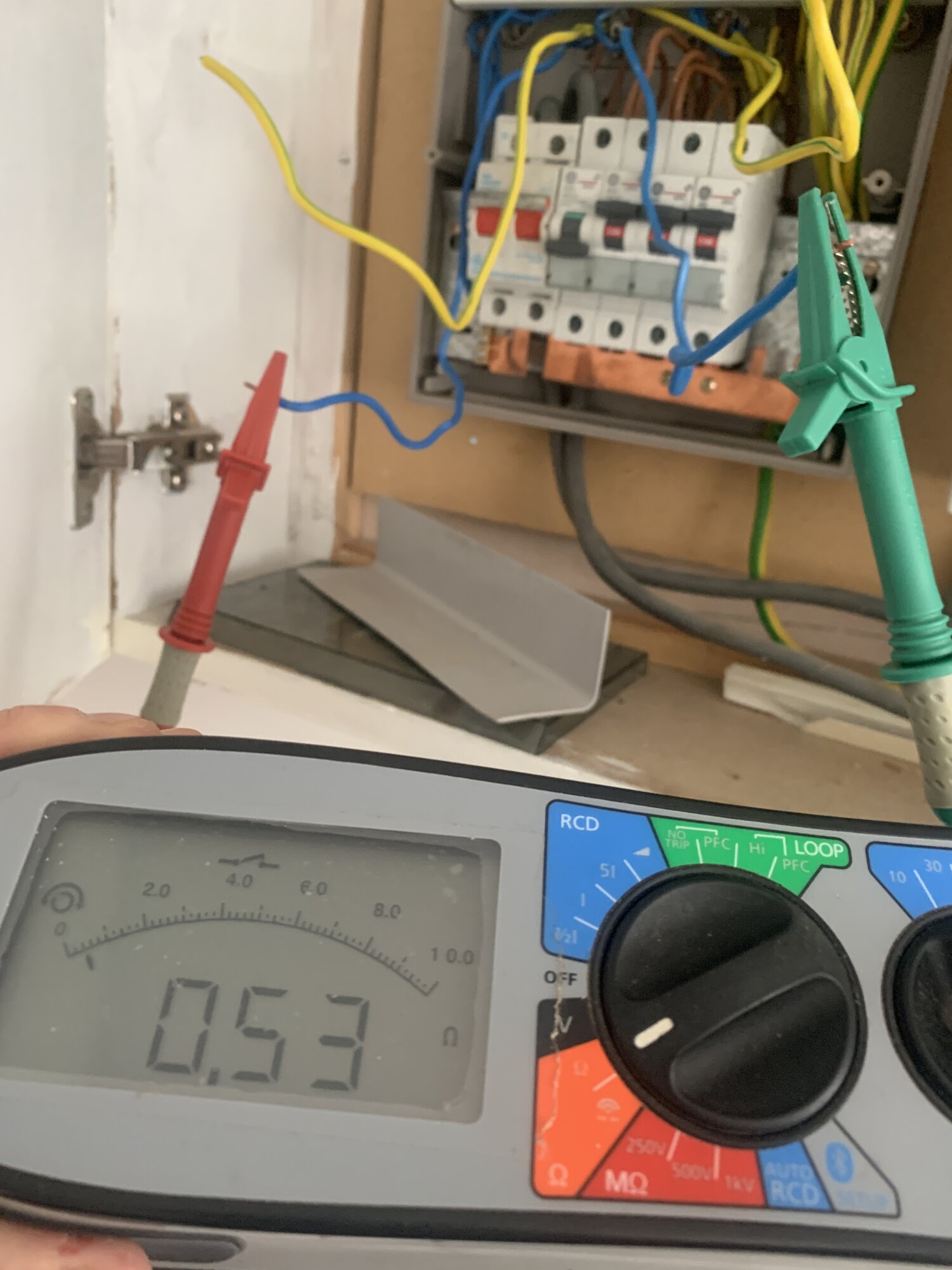

I’m doing some tests on my board at home in order to prepare it for an upgrade. It’s an old plastic GE board with no rcd protection. Doing continuity of ring final circuit on the main ring. When it comes to end to end tests at the consumer unit I’m getting no reading between neutrals. All good between L-L and E-E. Figure of eight and I’m testing L-N on sockets and all readings come good (0.45-0.50 ohms) in every room. What could be the cause of this? ? Neutrals terminated badly at a socket somewhere? Rodents? JB?
Would taking one leg of ring out and looking with a Martin dale be a quick solution to find it before I start looking by splitting the ring?
Insulation resistance was L-N >299Mohms, L-E >299Mohms but N-E only 8Mohms.
No point doing the cross-connections (figure of 8) if you don't have rn continuity. That needs sorted first. Probably loose connection on the neutral in a socket-outlet or screwed onto insulation. So it might be worth checking all connections including the phase and cpc.
I presume you've checked that the neutrals aren't mixed up in the DB?
most likely is that a N has come out of a socket terminal. any case that's the easiest check to do, just by inspecting each outlet. if not, then short 1 end L-N at CU, go round sockets mesuring L-N resistance. this will track the fault location. or you could do N-E.
Yes I have tidied up and dressed all cables so I’ve got a pretty clear view of what’s what.
Someone told me that disconnecting one leg and checking each socket with a Martin dale socket tester is an easy and quick search. Should I give this a go? Otherwise I’ll follow what @telectrix suggested ?
You suggest disconnecting one end of the ring, leaving the other powered, and going round with a Martindale to find the which are live L-N and which are dead. Yes, that will work, however it is a live test and where possible, dead tests with a resistance meter are often safer and possibly easier. If you short N-E at one end in the board and go round testing for continuity, you can open any suspect points immediately to check, without having to isolate, inspect, close up, re-energise and start testing again. The break could be at the last socket with continuity, the first one without, or somewhere between, so it could be a nuisance having to re-energise each time to use the Martindale.
Thank you @Lucien Nunes for the advice ? I found it quite fast too.

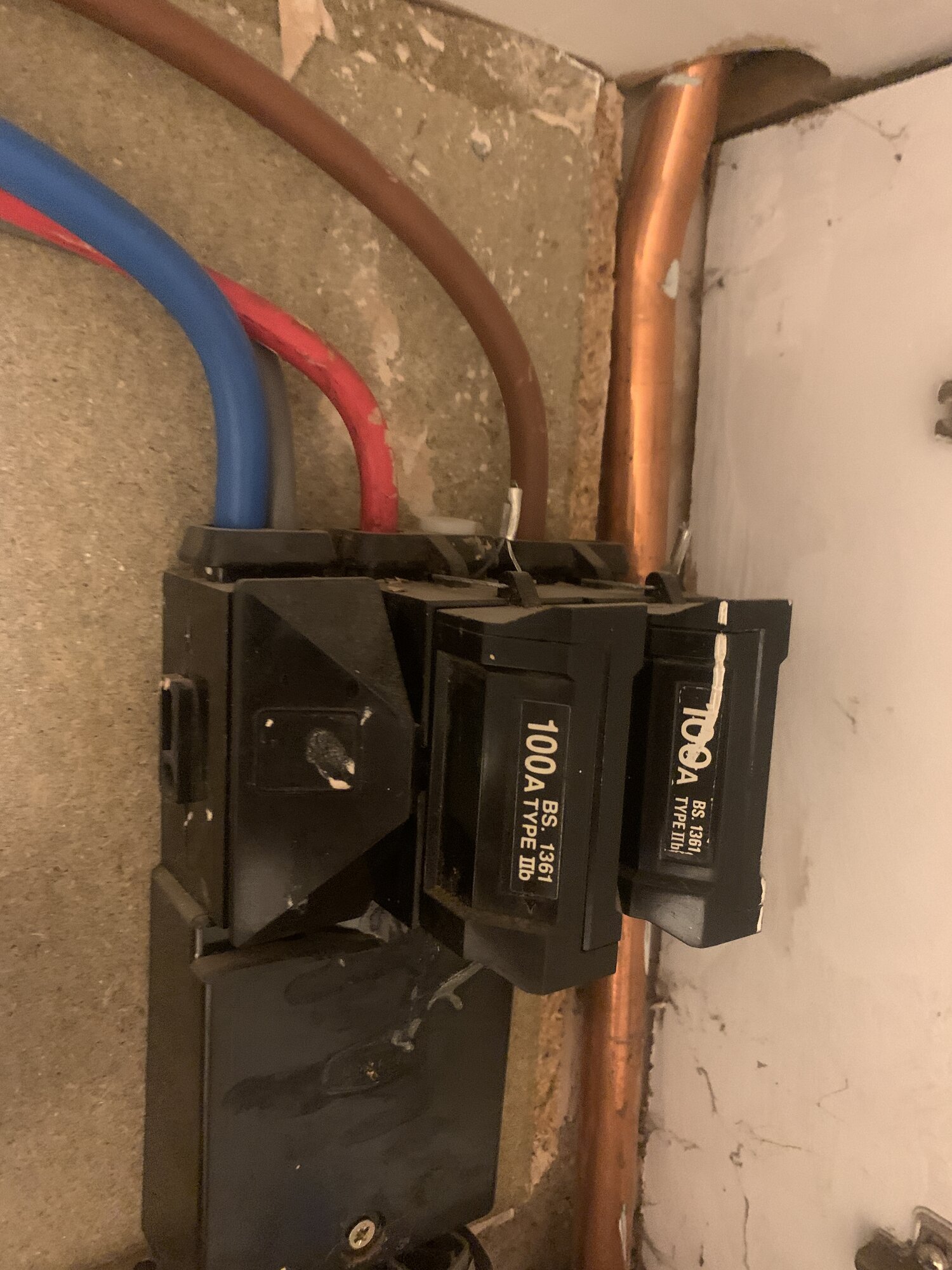

I would have changed the board if I could but that would mean I’d have to interrupt my neighbours supply (cut out has two separate lines but both neutrals go into same enclosure) so pulling out both fuses at once to do it safely would have been the way? Not to keen on bothering them (they’re both teachers and school online so need power on)... and I could just add an rcd and put a lock on my main switch, quick and easy hopefully ?
Why would pulling your fuse disrupt next door?

When you look at the picture you can see that both neutrals come from the same enclosure. If a fairy came and pulled my fuse, there would still be a potential risk of current on a neutral in my main switch through parallel paths?
Ps my supply is the brown cable and my neighbours fuse blocks the enclosure from opening where the neutral is.

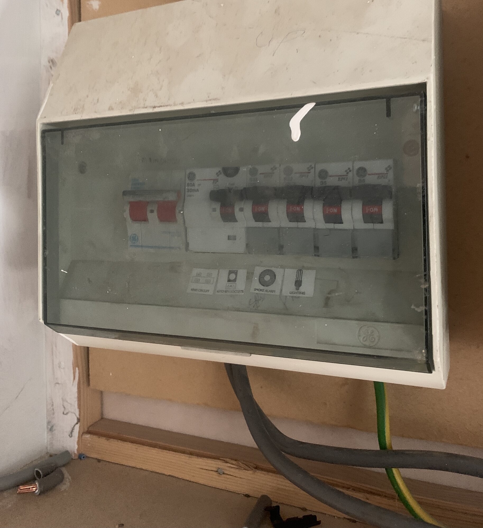

If anyone reading is interested, I added a rcd to the board. Did tests and everything came out satisfactory. Just need new labels. Ideally I would have changed the whole board but will wait with this until after pandemic when I can work in an empty house and not be distracted. Happy days ?

You don't have any selectivity now between rcd and downstream mcb's, an earth fault will likely trip your rcd which means you will loose whole installation. IMHO better option would be to install individual rcbo's
think OP has done it temporary till he can get round to replacing CU.
Exactly, yes. And I agree ? will be swapping it for a new CU eventually.
All points regarding rcd as a main switch taken on board, every day is a learning day ?‍♂️
Ps as I said earlier, isolating the board by pulling the main fuse doesn’t make it 100% safe because neutral shares same enclosure with my neighbours installation. Please tell me if I’m wrong? I posted some pictures earlier in the thread for you to see what I’m on about ?
The only way to look inside is to pull my neighbours fuse because it blocks the lid where neutrals are terminated and I want to avoid doing that.
You've posted a pic. of your CU with two grey tails going into it, and you've posted a pic of your service head with a blue, red, and brown tail leading from it. Could you post a pic of where these tails meet, please.
Should be a meter somewhere.
On a TNC-S theoretically the neutral and earth should be at the same potential as they're linked at the supply head.
On a TN-S theoretically the earth and neutral could be at the same potential as they're linked at the transformer but there may be resistance differences on the cables and sheath causing a potential difference.
On a TT neutral and earth potentials could be significantly different.
TBH with a shared supply I'd take the much safer option of dropping the tails out of the consumer side of the meter, technically these belong to the consumer so they have the legal right to do this although breaking the seals on the meter could be classed as criminal damage as they belong to the supplier... ??
If possible I would add a main isolator switch to avoid this in the future and make additions/alterations much easier and safer.
As for having an RCD main switch I try to avoid them as one fault will effect the whole installation.
Here’s a pic of the whole thing. TNS system. Quite tight for space if I added an isolator before the CU. I had to pull up my cables from the board as I had no space inside and kept the slack for future when I upgrade it. I will be using some fire rated glands. Ps, yes, my neighbours have their rcd as a mains switch I know ?
