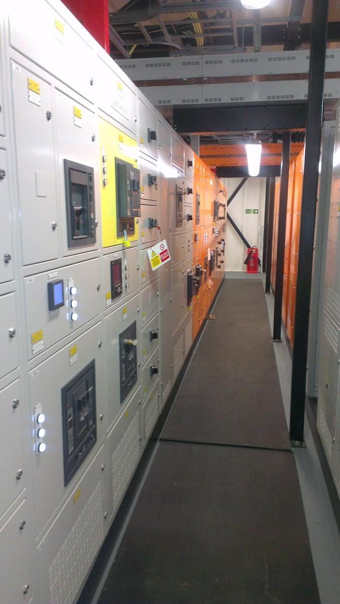

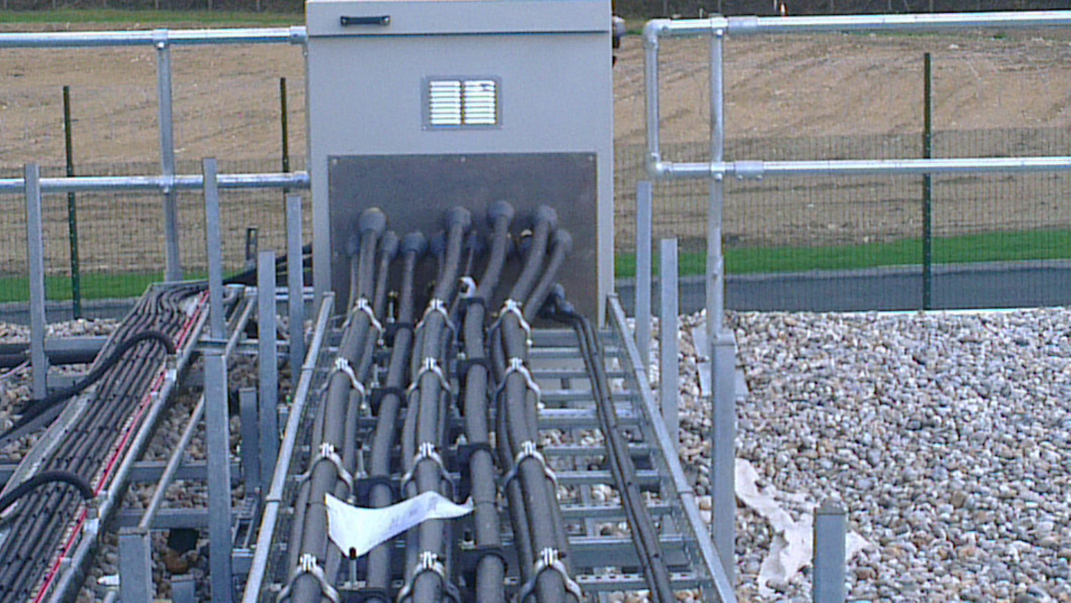

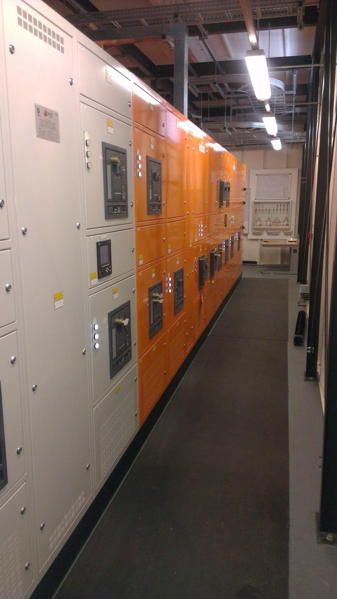

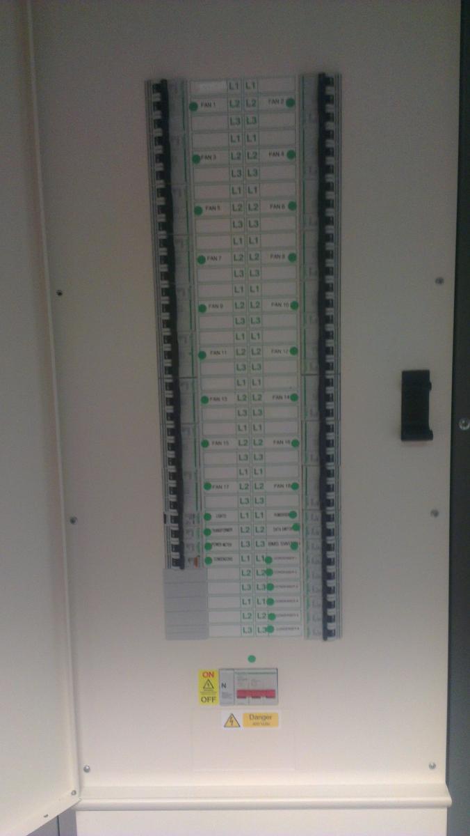

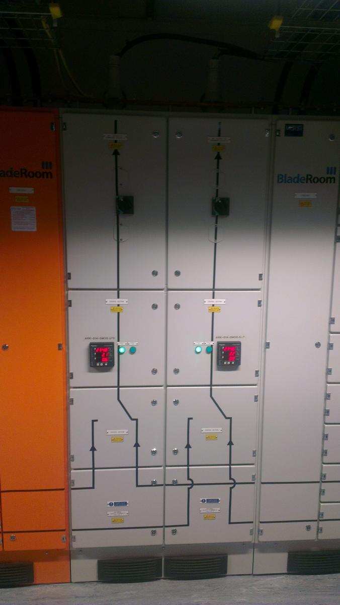

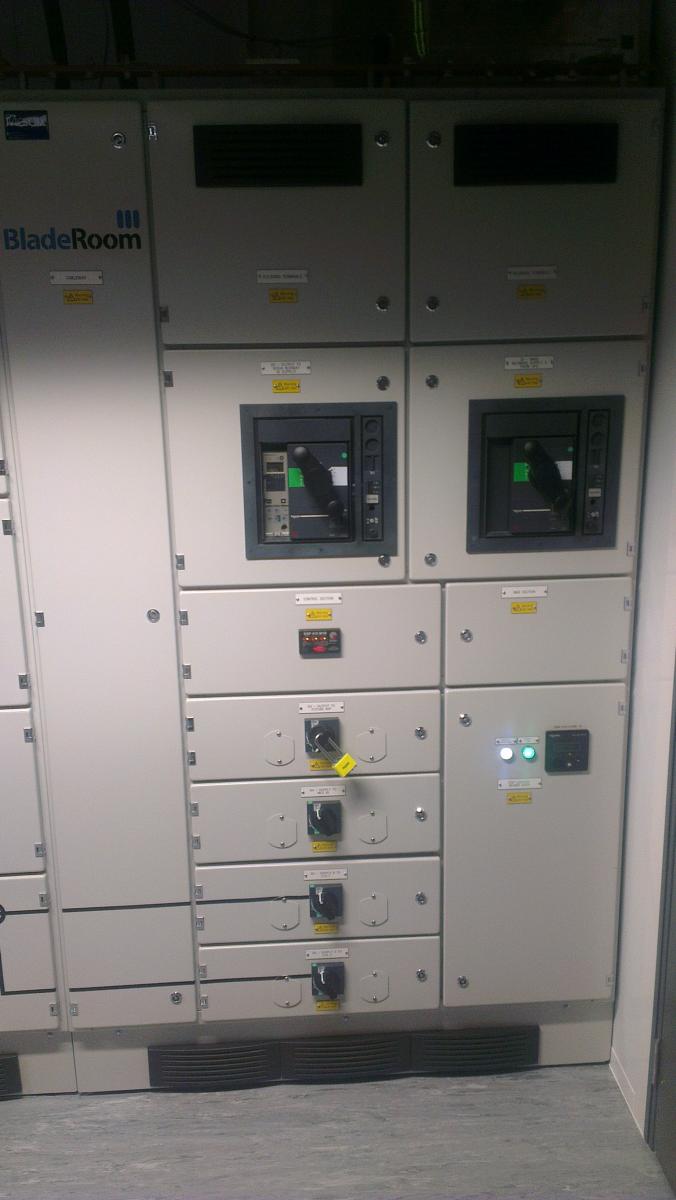

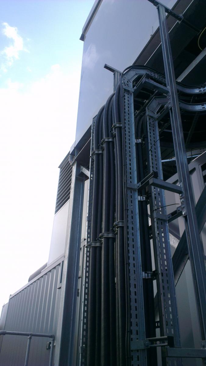

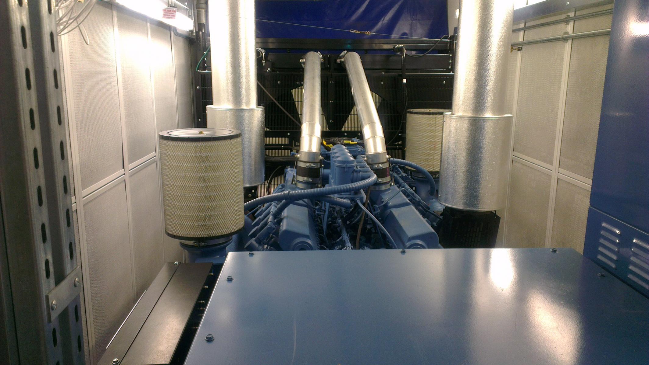

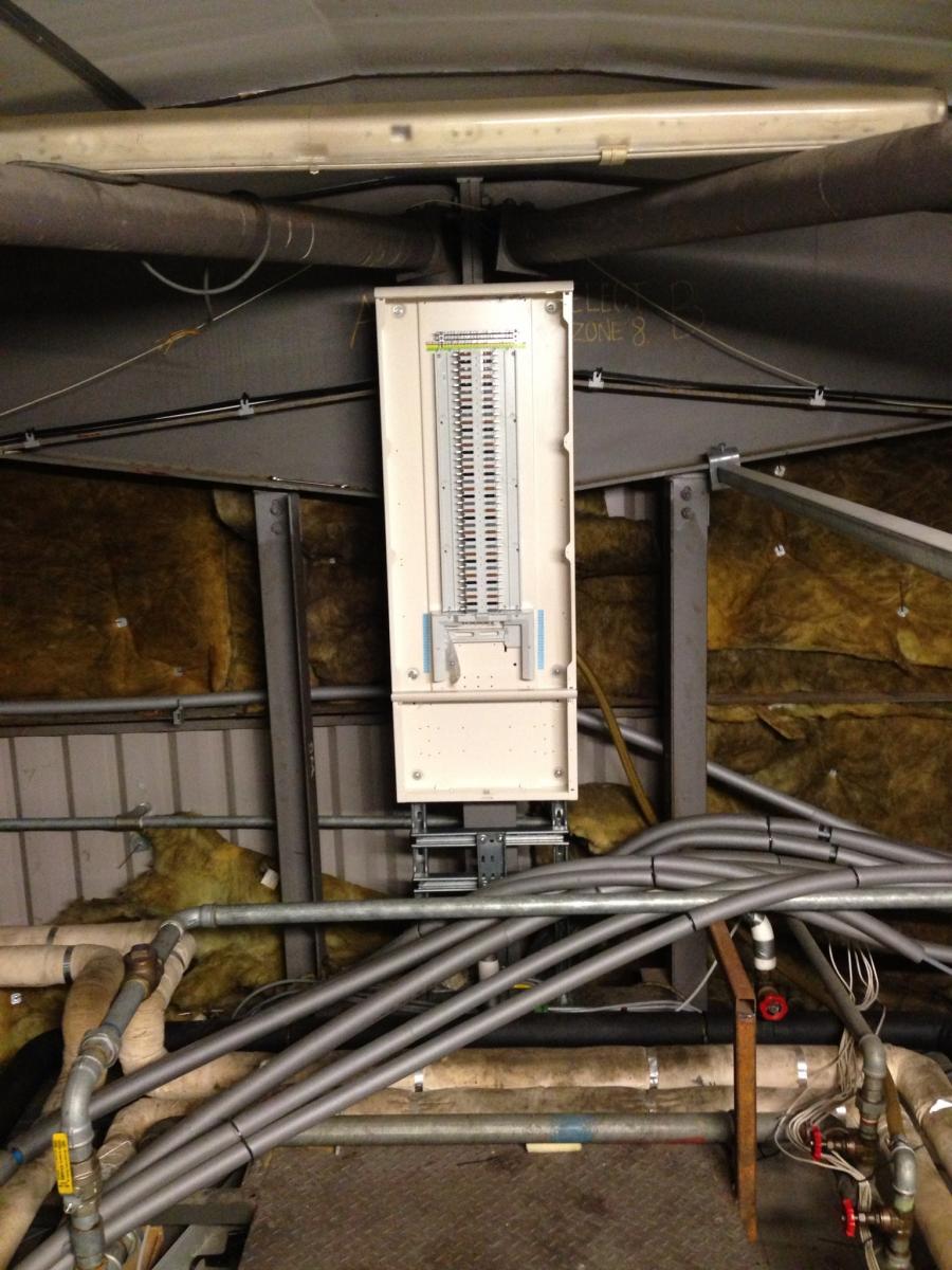

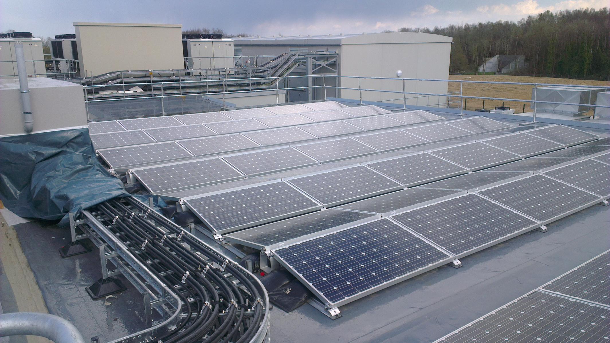

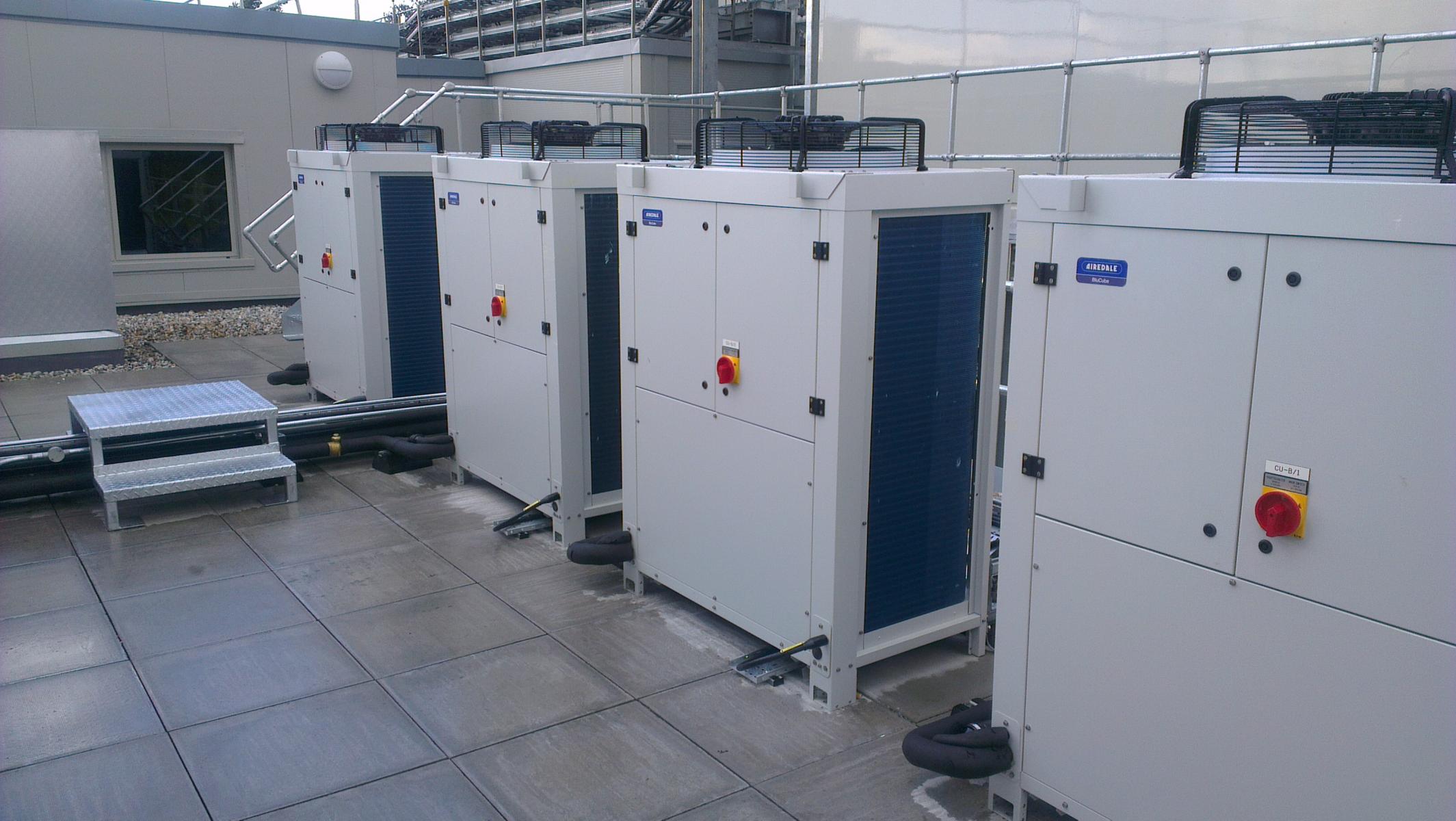

I'll add some pictures of a Job just being completed. The pictures are my snagging pictures so that I have a visual record of the snags etc and ensure the work is completed as per the program before my final report.

At last, a proper trefoil cable run! And a descent sized job to boot, what’s the MVA rating of the installation?
Thanks Tony, all I can say is that the total capacity is 14.7MVA running from 2 X 132kV feeders down to 8 11kV Tx's providing an A and B stream into the two structures so far built (which are only using some 2.7MVA). The rest of the capacity will be used by the remaining 2 main structures (4MVA each) (to be built plus a central Office block with a 0.5MVA capacity. The rest of the capacity is held for future use under ground)
