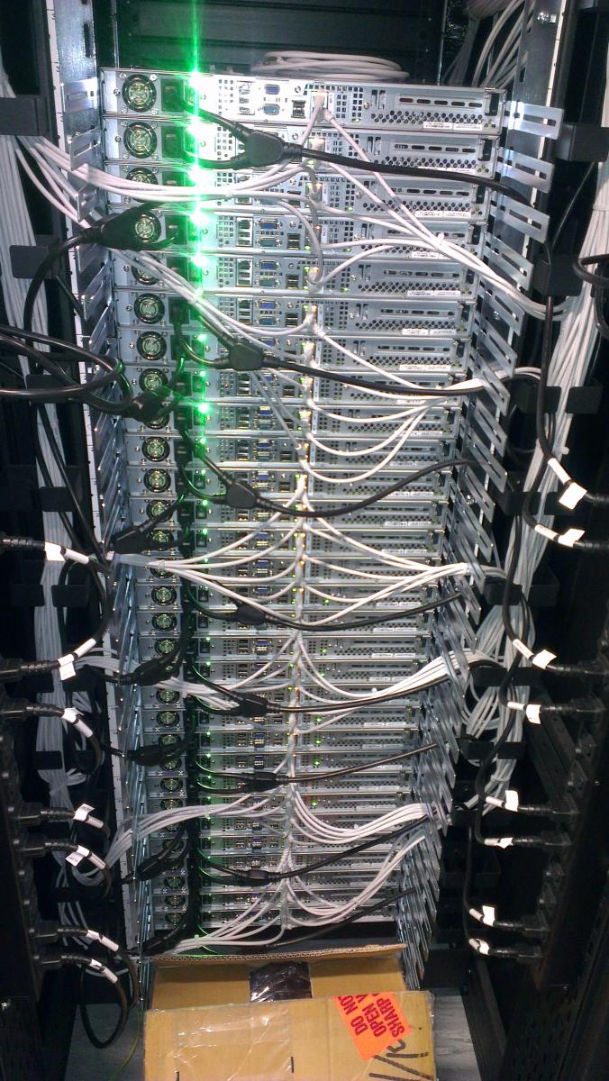

Picture 9, is that a dual bus-bar sytem?
Yes Tony, two separate feeds from separate Tx's via individual Rotary UPS systems with auto changeover in the event of failure, and this is all backed up by individual LV Gen sets but the site also has 15MVA 11kV generating capacity in case we lost the feeds from the outside world..

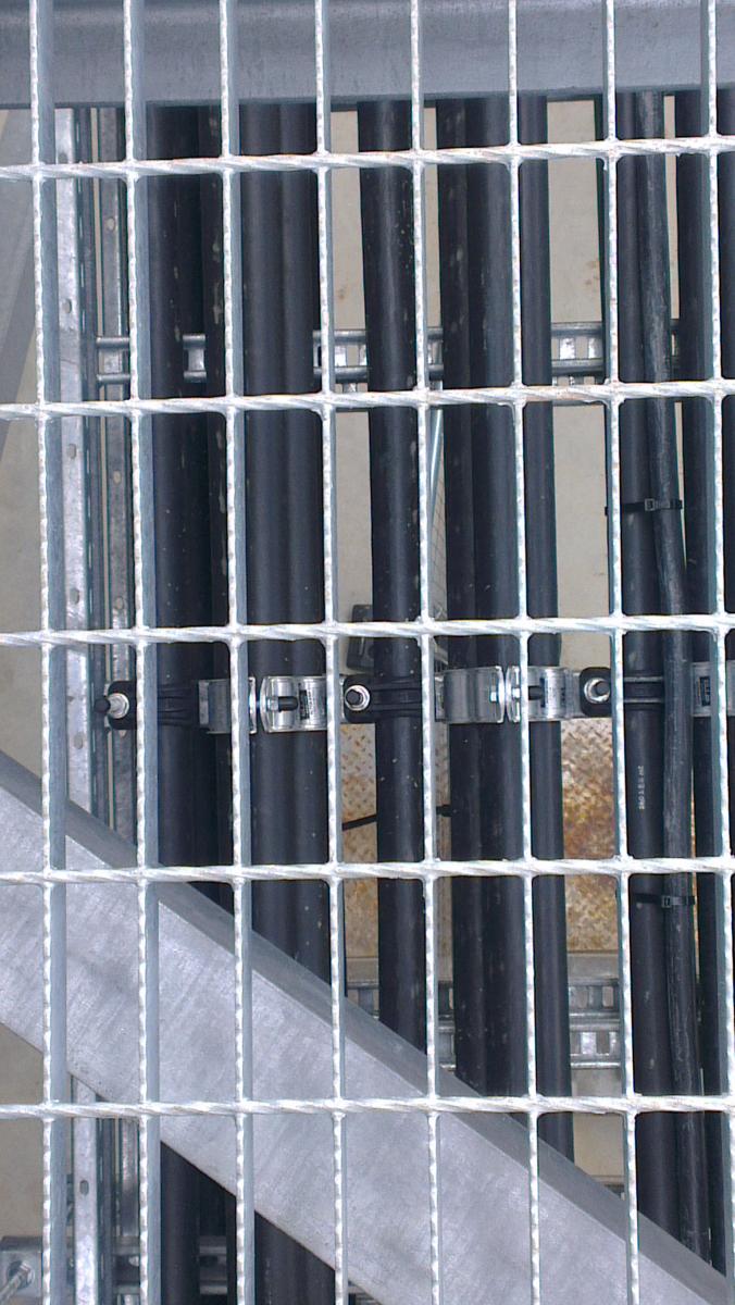

Bear in mind these are snagging pictures so these are not finished items, all the cables require identifiers attached, including the HV or they need tidying in some way, but they are OK for what you need Tony.
The comms in the top 4 pics is the HV/LV monitoring/switching infrastructure that also runs the live mimic boards we have for ACB and MCCB positions and status

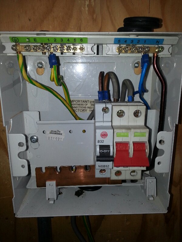

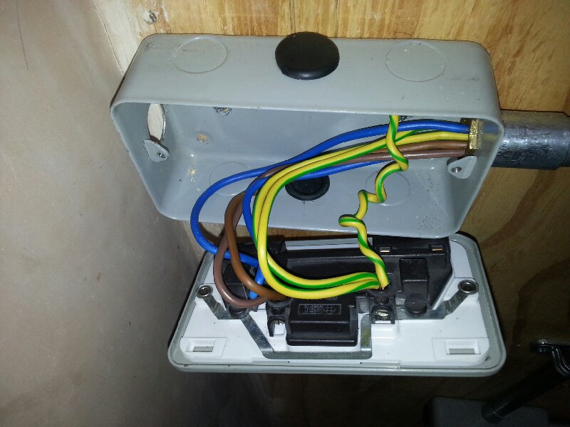

Here are some 20mm A1 ring final circuit installation. The conduit is 20mm seam welded galvanised heavy gauge steel. And the sockets boxes are metal clud surface (MK logic+ I think). For the trainees like me: :P The A1 ring final circuit should have 2.5mm cable with a 32amperes BS60898 type B circuit braker, and it can potentially cover 100m^2 of space.
Oh I forgot to mention that we have a switched fused connection unit too.. But it does ΝΟΤ feed an appliance.

Couple of observations;
  1. The layout of the conduit should have been considered so that they did not need to cross
  2. Conductor length needs attention, if you look at one of the browns in the spur you can see where it has been rubbed when the faceplate screwed back.
I appreciate a lot comes with experience, but it's things like the scuffed cable that can cause you problems both in college and the real world, I would be none to impressed when testing a new install to find that.

From what I remember, they must cross as part of the assessment, and a large portion of the marks are dependent on your ability to set the conduit neatly
A couple of things.......
If you were to leave a little more length in the CU then you would be able to get the cables a little neater.
The fly leads in the accessories shouldn't be coiled
You do not really need the fly leads as you have cpc's run in and the conduit is earthed at the CU, and the back boxes are fixed lug. The only time you really need fly leads is if you have no cpc's and you are using the conduit as your means of earthing.
These are just pointers and are not criticisms!!, overall it's a nice install and a bloody good job compared to a lot of college work I see!
I would be asking, why you have pulled CPC's into a galvanised conduit system in the first place?? All your achieving there, is filling up the conduit with needless copper!! lol!

Thank you about the observations! I understand that the fly leads are actually optional but I was instructed to do it that way and I would have been marked down for not putting them. I know you'll understand. oh! And I coiled them because... I just wanted to do so (it looked more "cool" when it was not stretched) :P. I cannot understand why not to do that.. To avoid inductance from being produced or something? avoid pressuring the cable?
