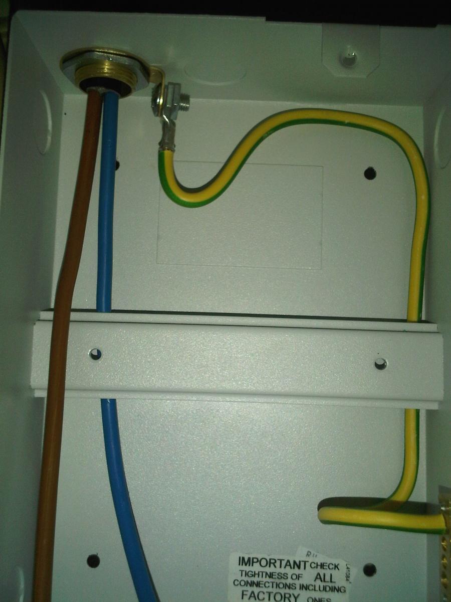

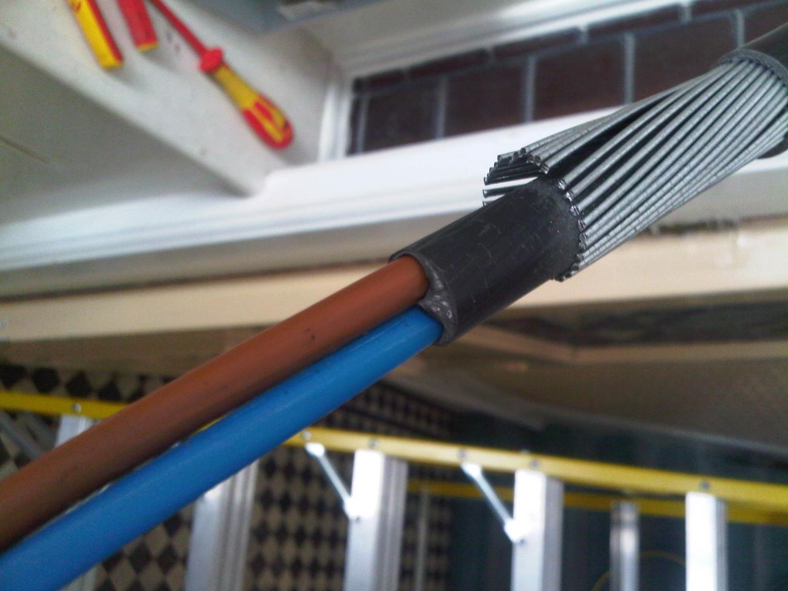

This was a lil 16mm submain I was running the other day, stripped and ready for glanding in about 60 seconds using a blade runner. I defy anyone who tells me that they can do a job as neat as this (cutting wise) with a hacksaw!!!
Slightly misleading photo, it is cut to the same length so it sits perfectly flush to the gland. Looks crap IMHO when you've got an inch of sheath showing past the gland.
Here we go, top left, you can see what I mean:
Edit: And before any of you ice creams start with the "Mehhh, the banjo's not drilled through the body blah blah bleeding blah" I don't care! :D
