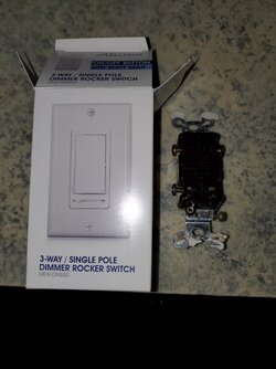

In my bathroom, ive got 2 switches that control the 5 bulb fixture over the sink. I replaced one with a 3-way switch dimmer, but not the other. When the dimmer is at the lowest setting, everything is fine, but when I raise the brightness, its flickers and buzzes. Where did I go wrong?
(pictured: new switch on left, old on right).
if the lights are LED it could be that the dimmer is not compatible with LEDs.
what's the min. and max. wattage of the dimmer?
