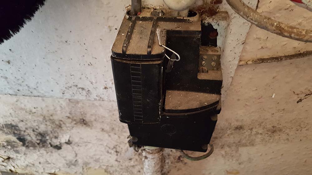

Hi all,
A house buyer here (FTB) doing the usual googling on old fuseboxes / wiring. House is a 1960s ex council house semi and hasn't been rewired. Not seen any obviously dated looking wall plugs or fixtures but would love any thoughts on the state of the fusebox. Its v.dated and I will no doubt want to replace it with a modern consumer unit. The electricity as been switched back on and I'm going back next week to do some basic checks of lights, wall plugs but are there any immediate red flags that you can see?

That is the "cut out" where the main incoming power cable terminates, and where there is the main fuse (typically 60-100A) for the property. It is called that is it is the ultimate means of disconnecting power for changing a meter or CU.
It should not be touched! Firstly it owned by the power supply company (DNO, such as SSE, etc, not the company who bills you, they own the meter), and secondly if it goes wrong it can go horribly wrong in terms of fault energy.

Out of curiosity what is the thing in the third picture?
That cut out can be made dangerous when a smart meter has been installed not uncommon for the meter fitter to break the piece under the fuse holder called the DNO out on a few jobs where the fuse was exposed underneath the fuseholder. DNO said it is caused when the meter fitter pulls the fuse down when extracting it
To be honest, the meter has been fitted with the care and finness of an angry gorilla.
