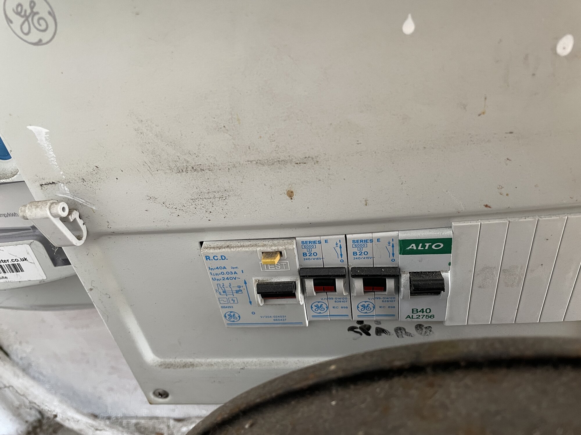

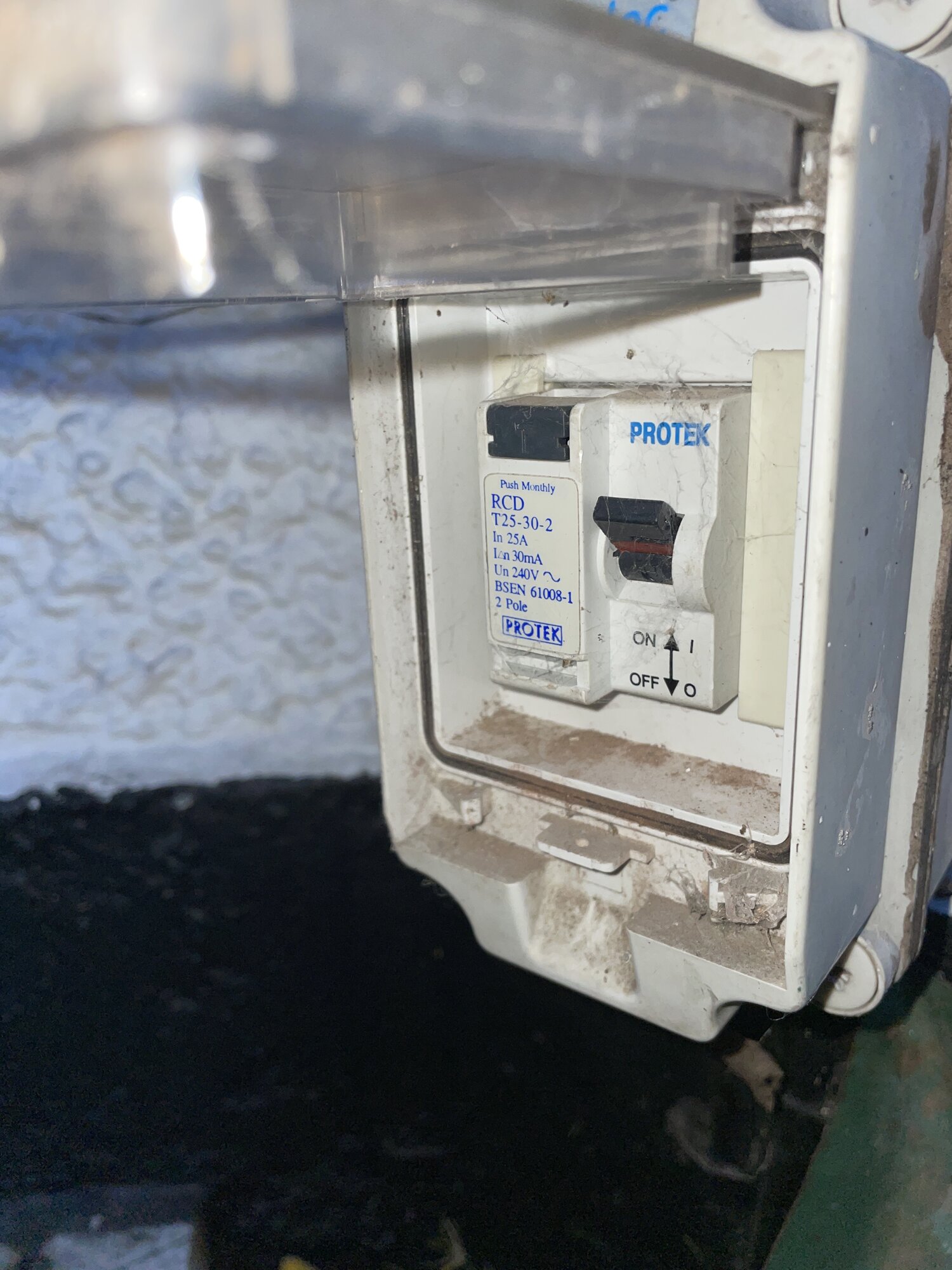

Just a follow up on the original questions I posted.
The 10 way main CU (all MCBs) has this.....
1) one dedicated MCB for the back garden where there is a small CU that feeds a garden lights, outside socket and a car charger. This external CU has all RCDs.
2) one MCB for the lounge sockets. This has a fused spur in the lounge that then feeds a single outdoor CU to the front and has an a single RCD.
Photos of the outdoor CUs attached.
The question is, if I get the main CU replaced with 10 RCBOs gather this will impact the outdoor RCDs?
Or can I have an RCBO and RCD on the same circuit?
For the back garden (1 above), it has a dedicated circuit on the main CU so we could just have an MCB rather then a RCBO on the main CU?
For the front garden (2 above), would it be wise to have an RCBO at the main CU, but replace the outdoor old RCD with a MCB?
Appreciate any thoughts.

One more....
You can but it is not good design practice. It also depends on the cable between the CU and the outdoor blocks:
  • If that cable needs additional RCD protection then you need RCD/RCBO at the CU.
  • However, if it is something like SWA, adequately glanded to earth the armour and with a low enough end of circuit Zs to disconnect on a MCB alone, then you would be best to have just the remote RCD and feed from a MCB.
MCB feeding MCB+RCD or RCBO is still not ideal as selectivity on high faults is rather poor, but slightly less troublesome than upstream 30mA RCD and acceptable for non-critical areas like a shed, etc.
If loss of lights from the common upstream MCB/RCBO presents a hazard then you need to look at feeding off a suitable switched-fuse for better selectivity, or better still install emergency lights (i.e. internal battery sort) so they come on when power fails due to any reason.
Thanks.
I'm thinking....
1) replace the Protek RCB for a MCB.....
2) replace the GE RCD switch for a non-RCD one....
Then get an electrician to put in RCBOs on all circuits on the main CU.
I'd hate to spend all the money on a new CU and end up with the odd MCB within it.
