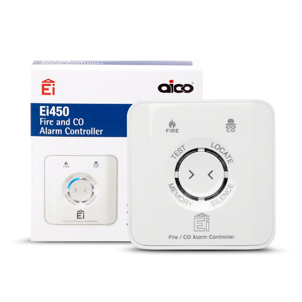

3) Smoke/Heat alarms - on the positive side it got me to check the dates on my alarms and just added a Heat alarm to the kitchen.
